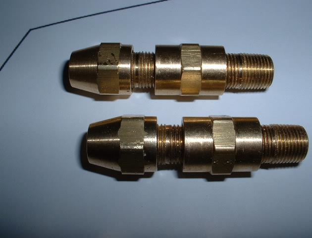

Hey Guys, look what I made. I am going to be a pre-pro ESB Ralph McQuarrie-styled suit. Are these too ROTJ?
Thanks.

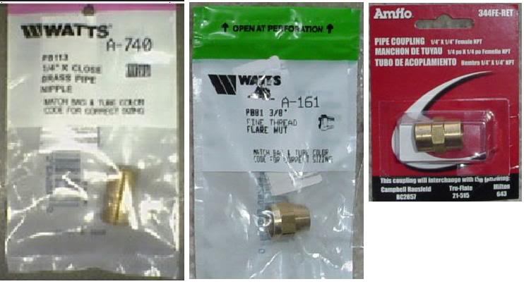

Your parts lists is:
(2) Watts A-740 BRASS PIPE NIPPLE 1/4" X CLOSE (pink pkg)
(2) Watts A-161 FINE THREAD FLARE NUT 3/8" (green pkg)
(2) AMFLO 1/4" to 1/4" FEMALE PIPE COUPLINGS (#344FE-RET)
(2) 3 3/4" lengths of 3/8" wood dowel
electrical tape
epoxy
Sorry for the crappy picture! :)

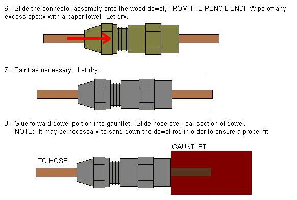

Anyone know the Correct size of the Hose?
it's 3/8" ID (inside diameter) because thats what the tutorial syas to use for the dowel, but neither Lowes or Home Depot sells 3/8" ID braided hose
The best thing to do is pick a hose diameter that you like, and select the dowel rod to match. You can usually find the hose in different diameters on huge rolls, and the sales folk will cut whatever length you need. Remember, you WANT a tight fit, so if it's a little too tight, sand down the dowel rod, but not so much that you lose the tight fit.

If you are going with BatNinja's recipe, you may want to downgrade to a 5/16" dowel or metal rod. At 3/8" it wont fit through the nipple without extensive grinding(get yer minds out the gutta foo!) which is time consuming and a pain in the ass. I've got mine all assembled except the rod. Plus the smaller rod size means less chance of error when drilling into resin pieces to mount the connections.

I could be wrong on the hose diameter, as well as the dowel rod. I was doing most of the tutorial from memory when I drew it up!
The best advice is to find the preferred hose first, as I think the more accurate size is a bit smaller than 3/8". Then take the hose over to the dowel section and get a wood dowel that provides a tight fit in the hose.
I'll try to work with it this week, and I will update the tutorial appropriately.

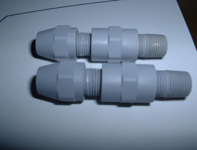

I've been looking around ... look what I found . They're 1/4" with a little primer and some aluminum paint a little mist with rust or black for weathering and ta da !

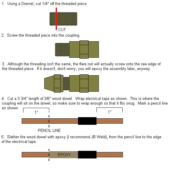

Flippin' Sweet! Here is a tutorial I whipped up...

BigaboyFett you rock ..... EXCELLENT diagram on the tutorial . Finally I know what that is . Do I leave the aluminum tube raw or paint the same as the guant ?
Mike
