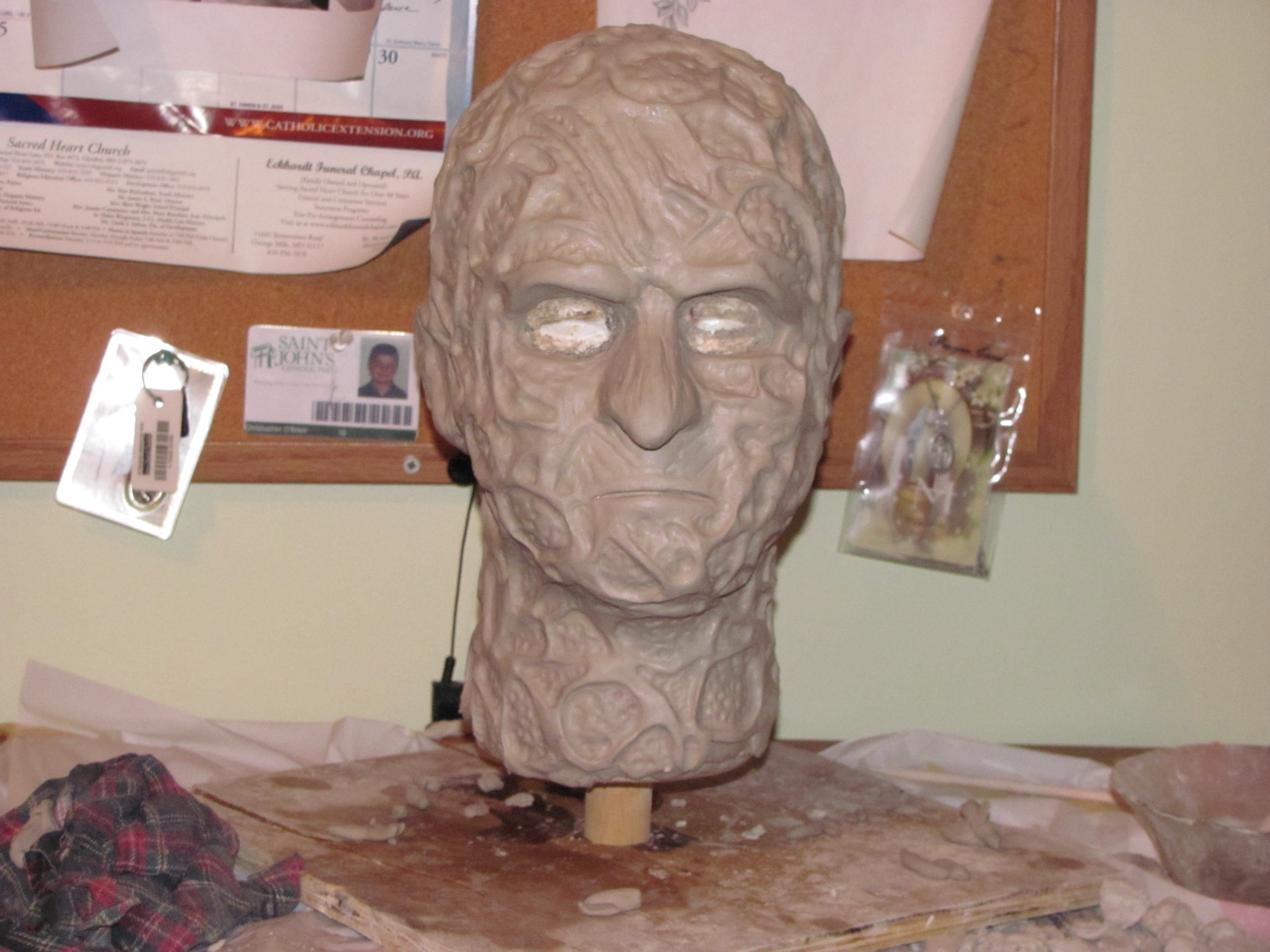

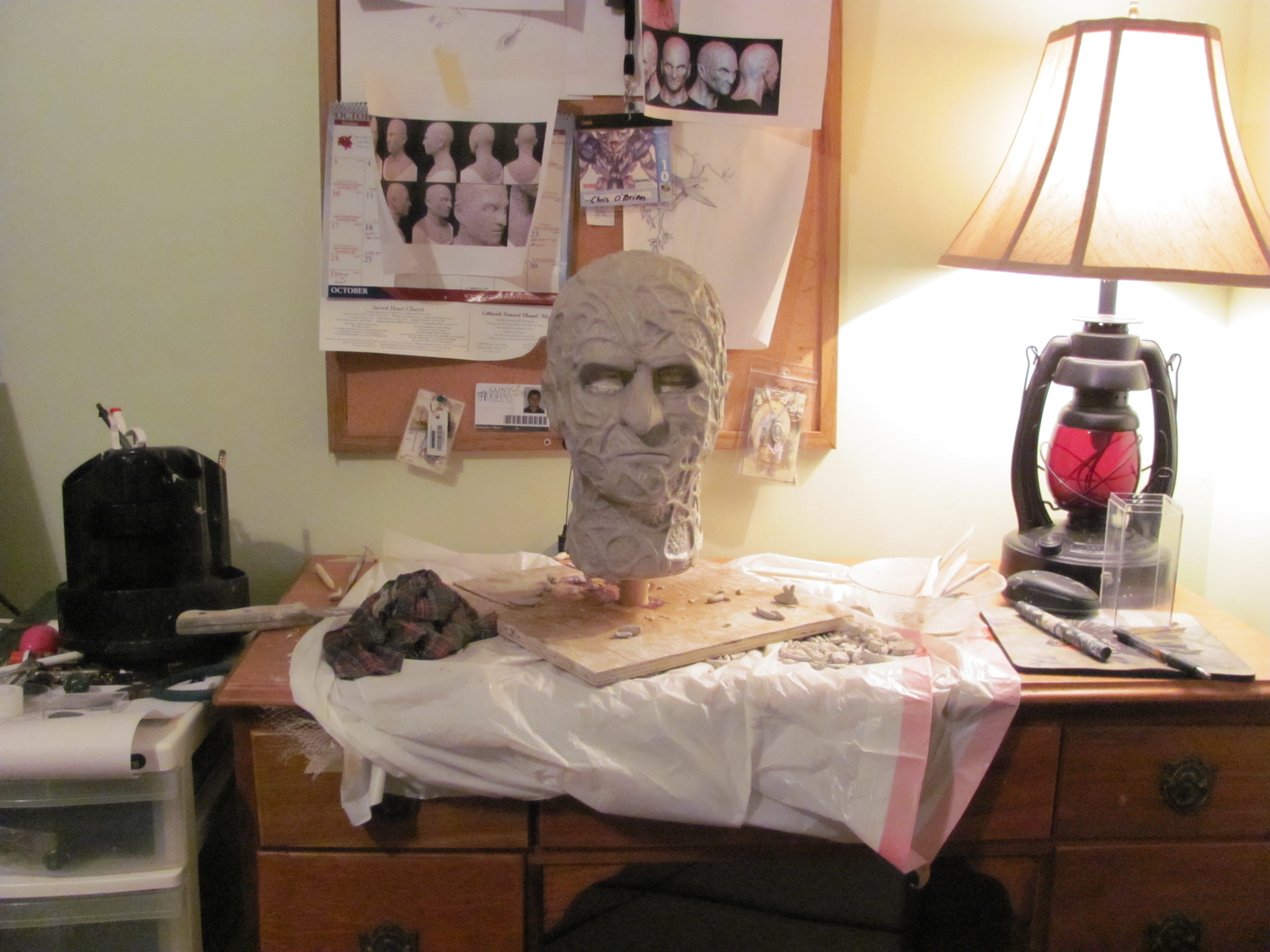

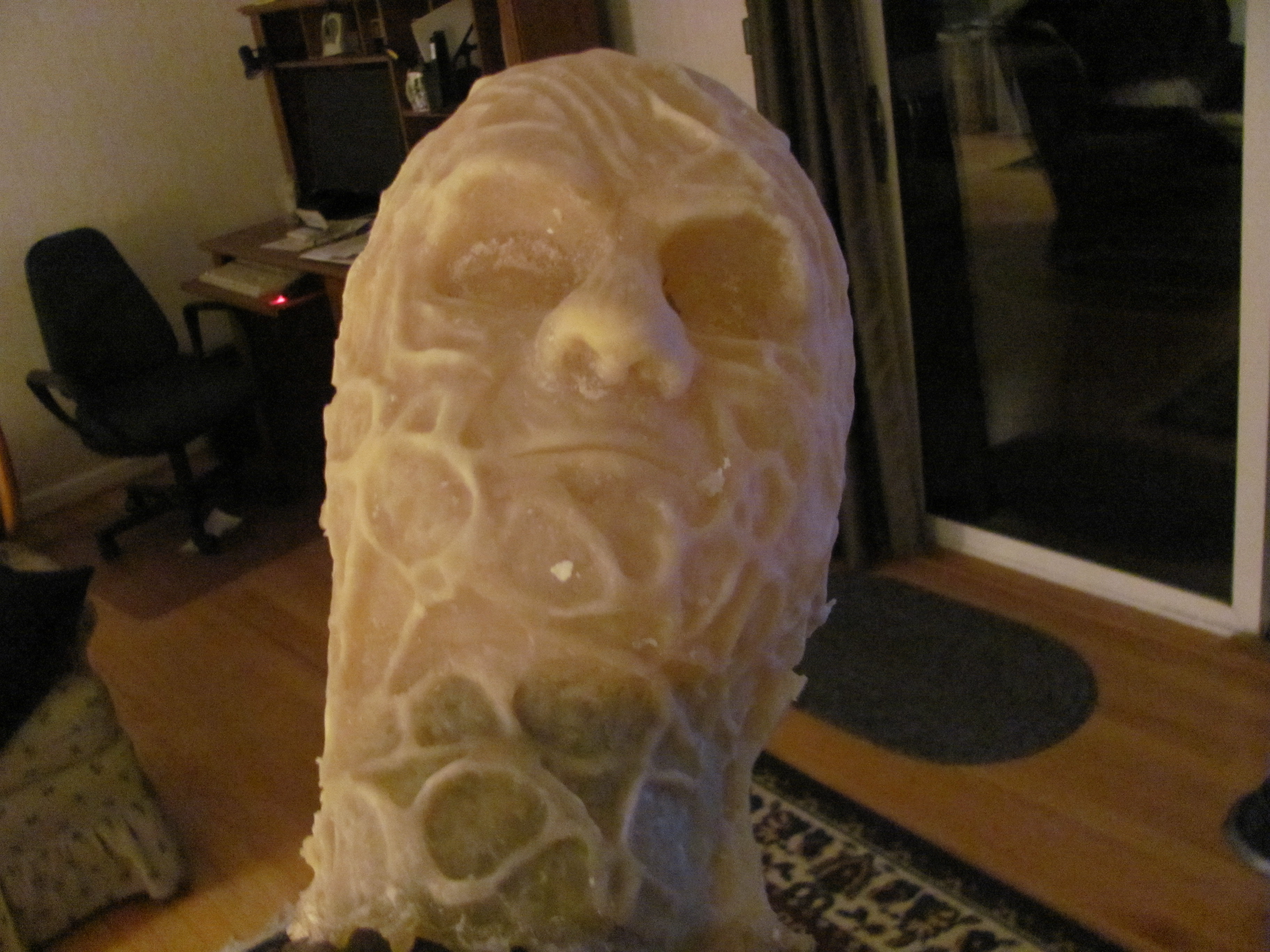

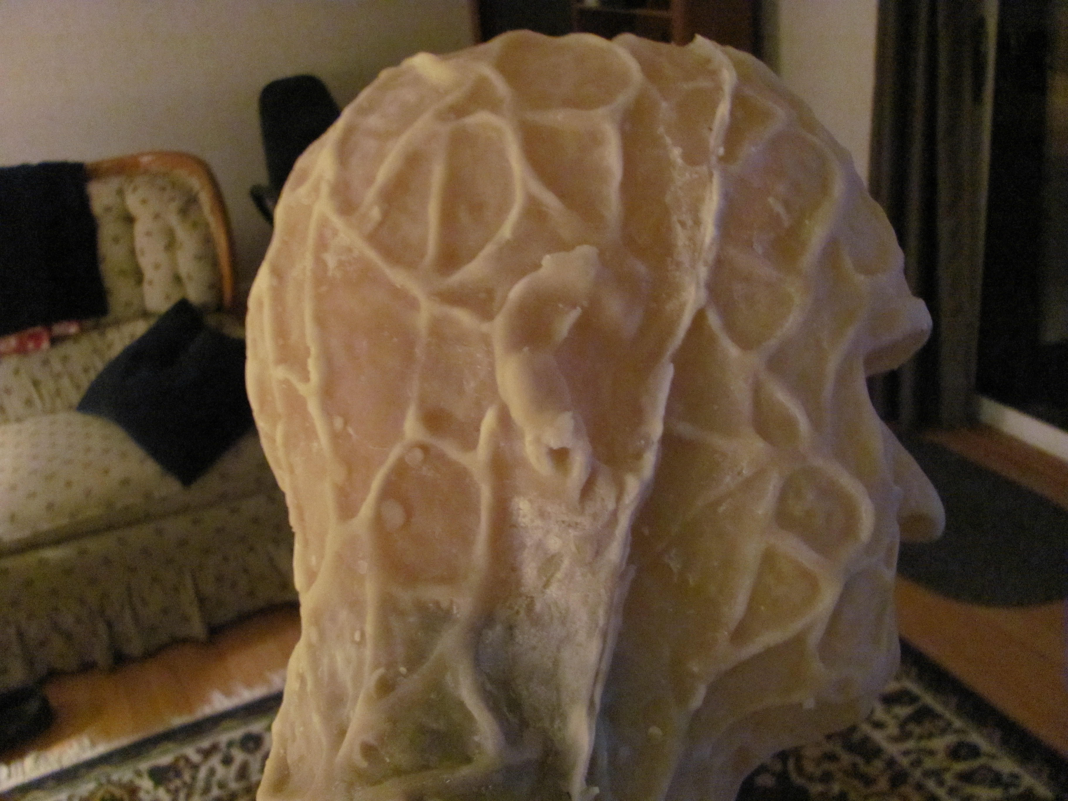

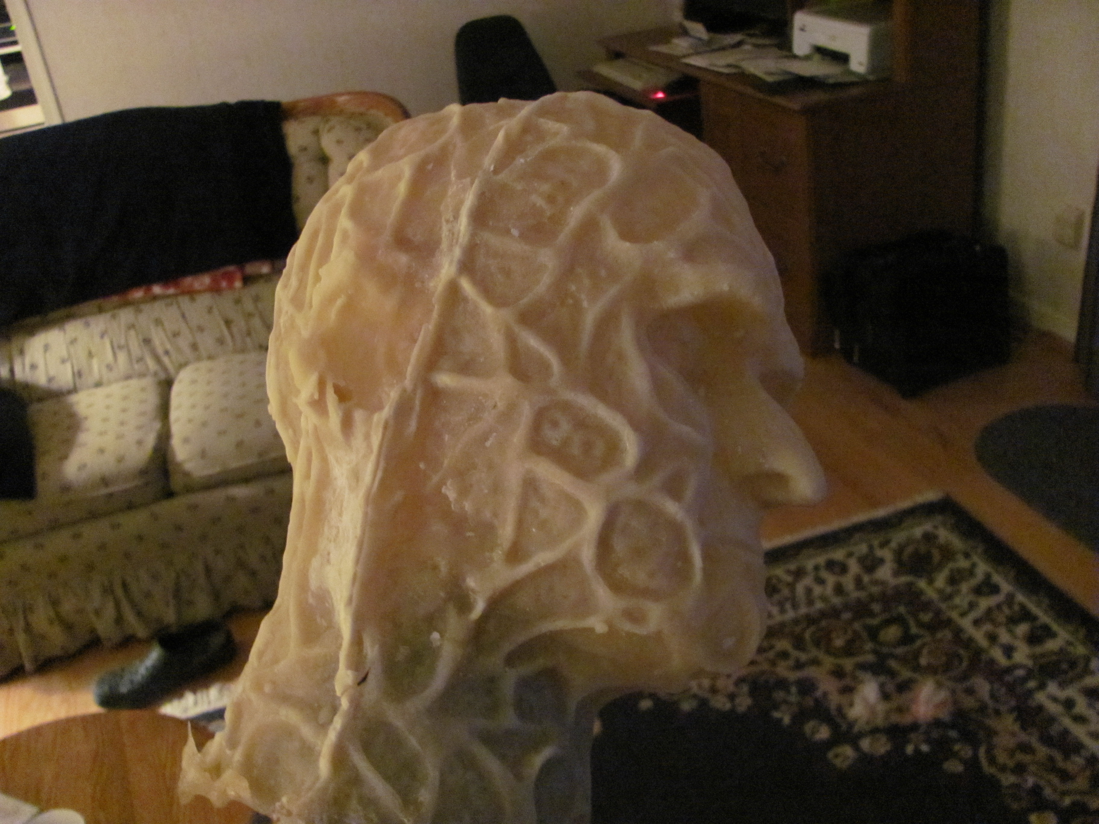

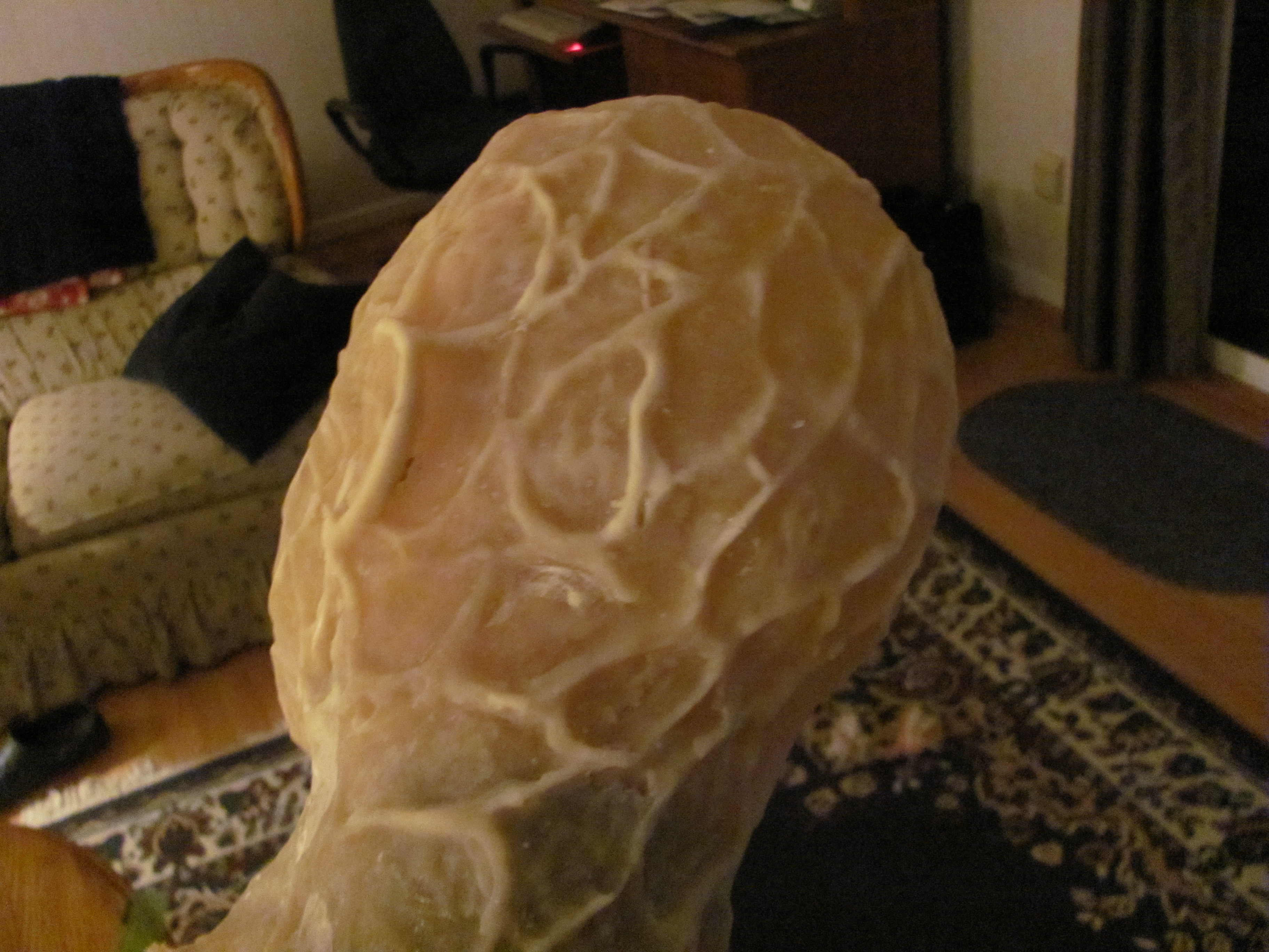

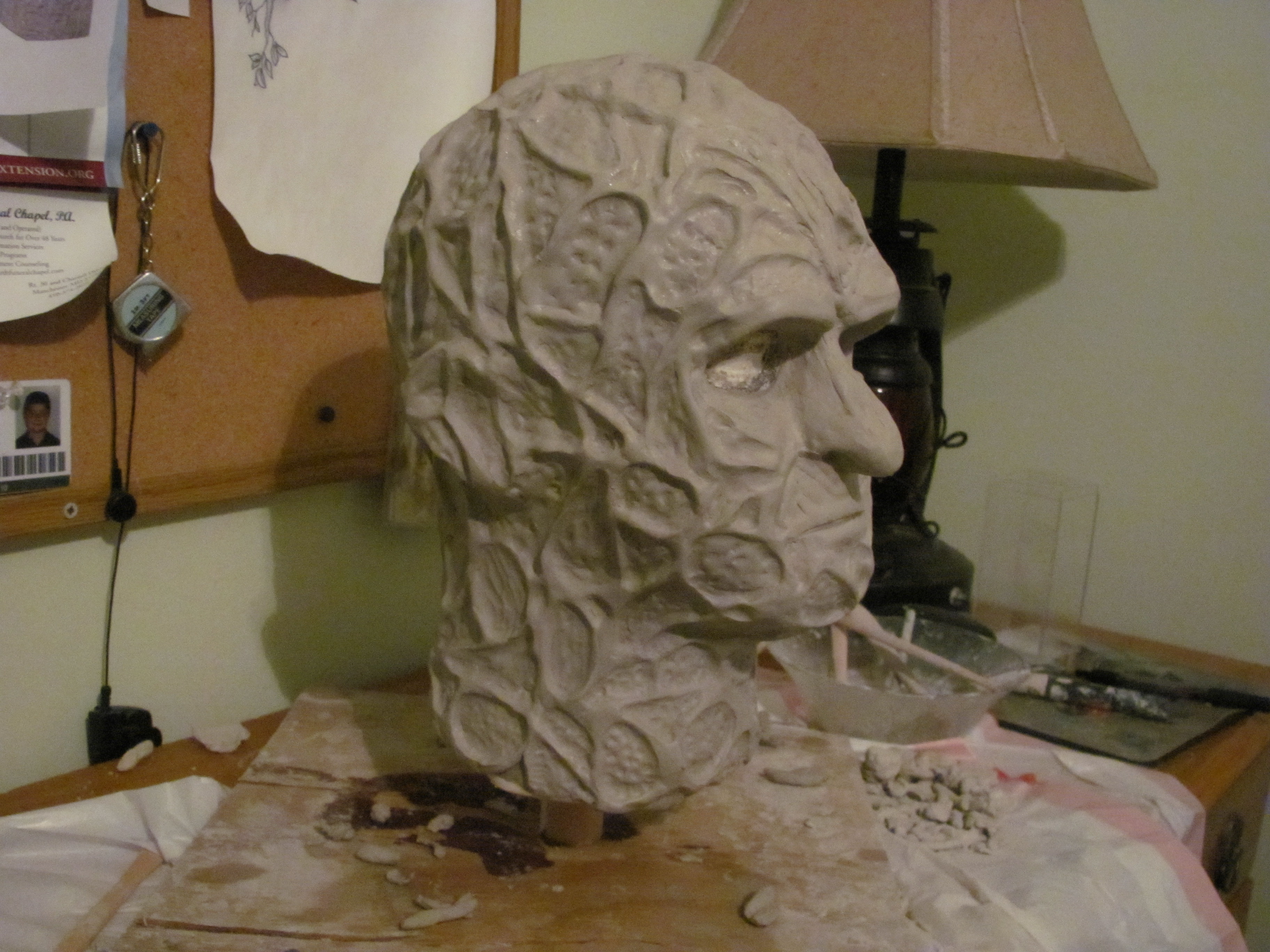

This is my Freddy Krueger sculpt so far. I'm by NO means an artist, so I was pretty happy with the way it turned out. This is based on the original Freddy played by Robert Englund, not the remake Freddy (don't get me started:angry:lol:). I know it's not perfect; the left eyebrow is alittle low, and the nose is alittle crooked (I'll fix this tommorrow).
I plan on making a cast of this tommorrow, and the mask-casting latex is in the mail.
Opinions appreciated.

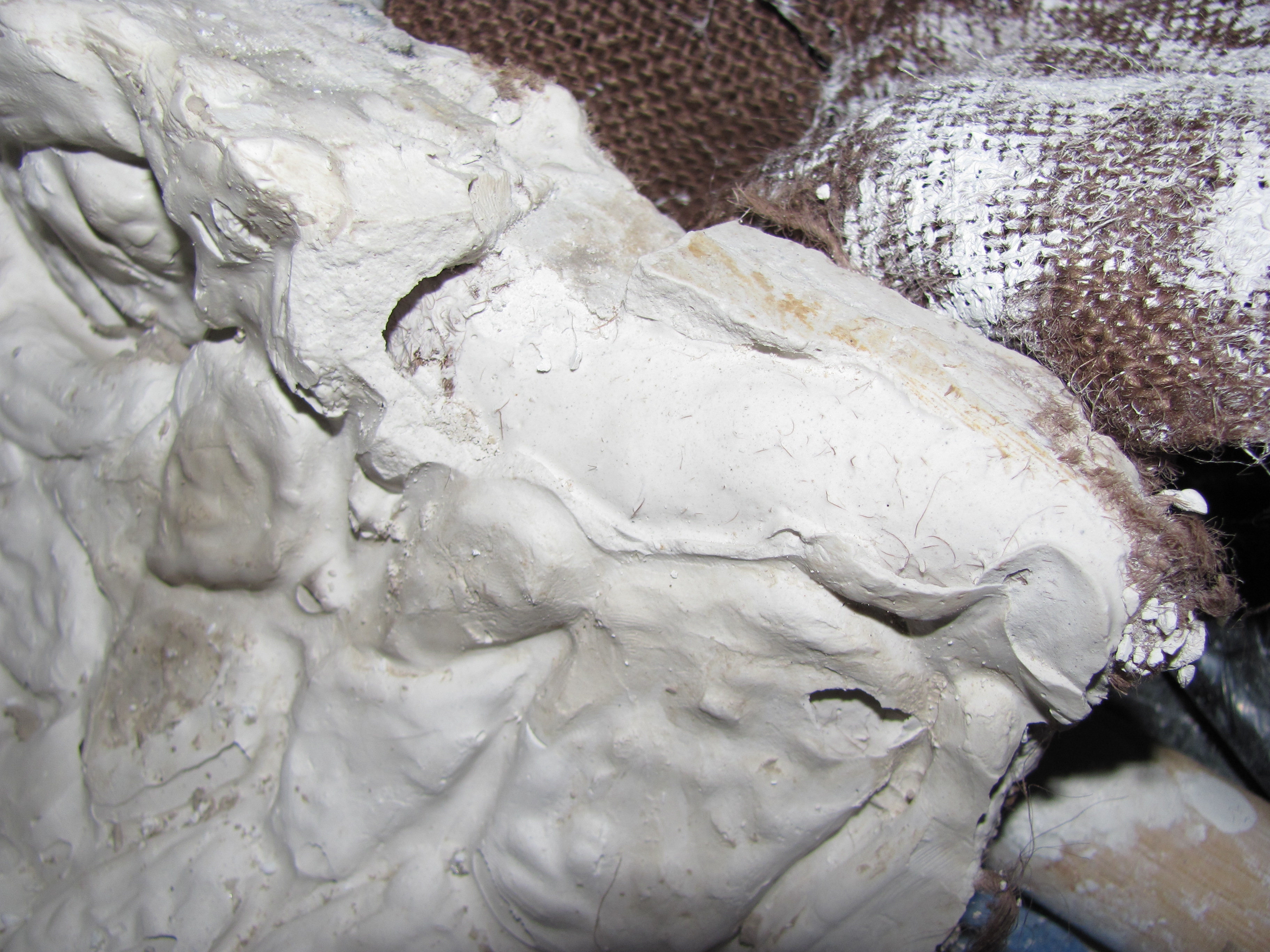

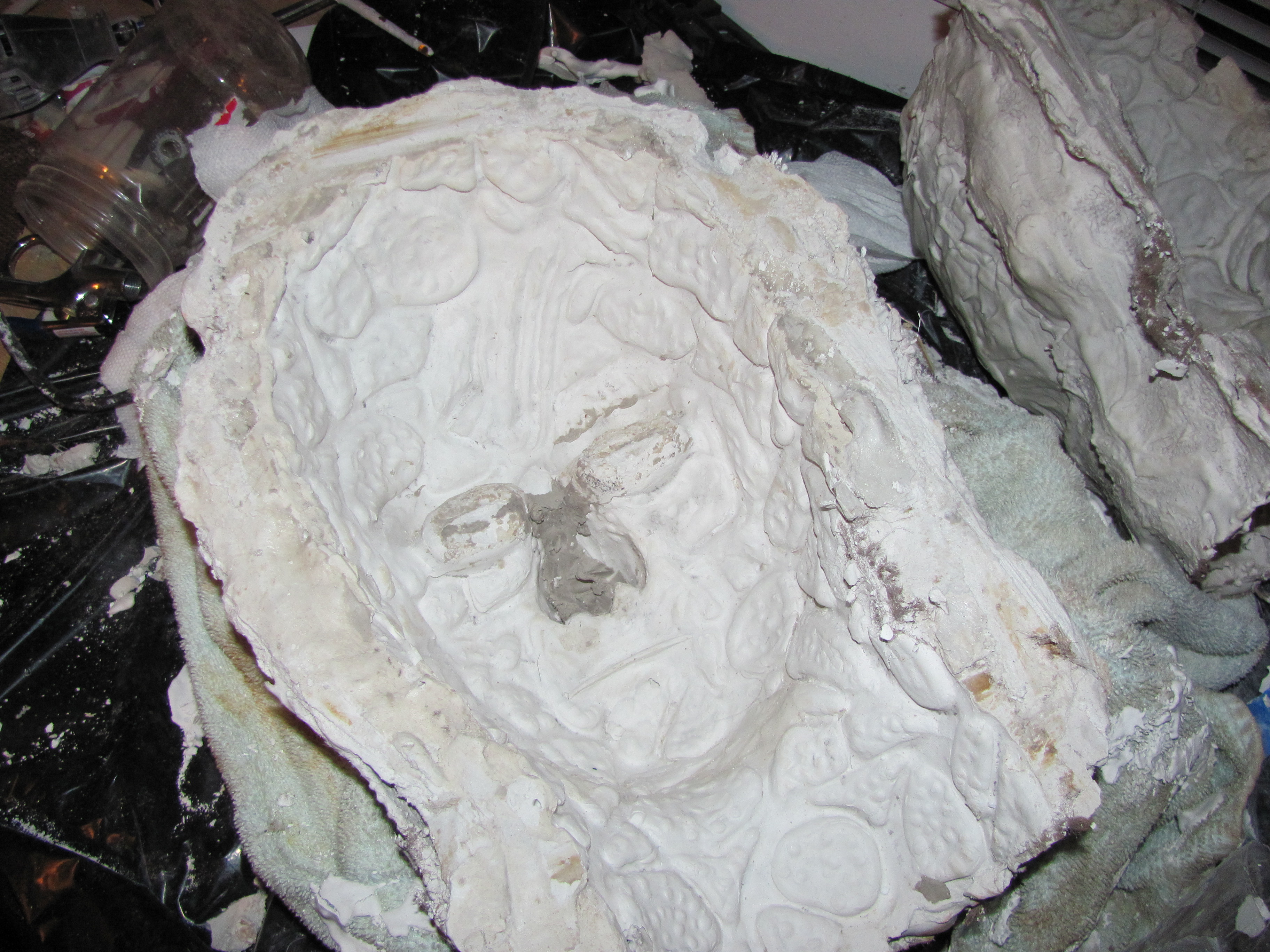

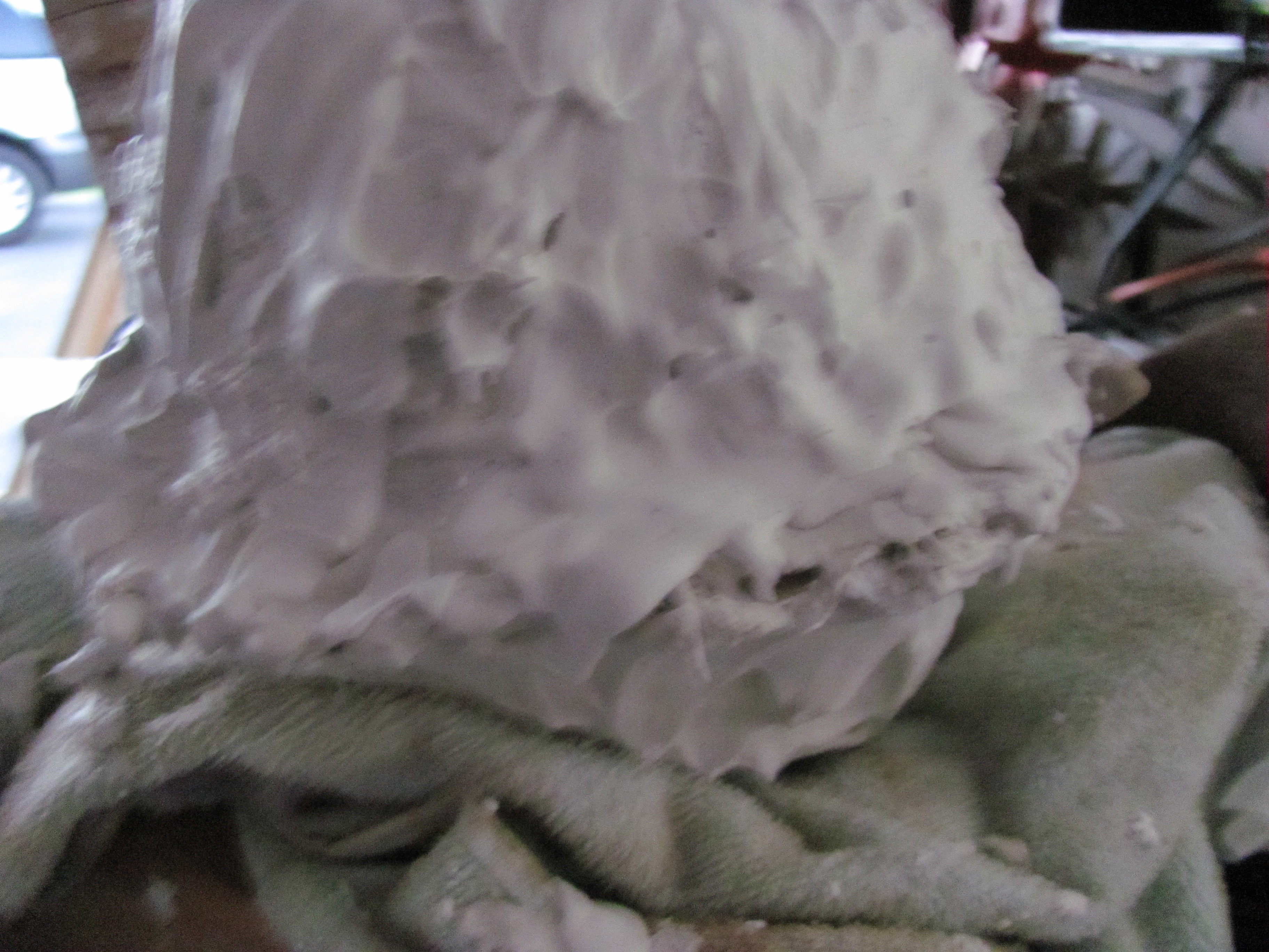

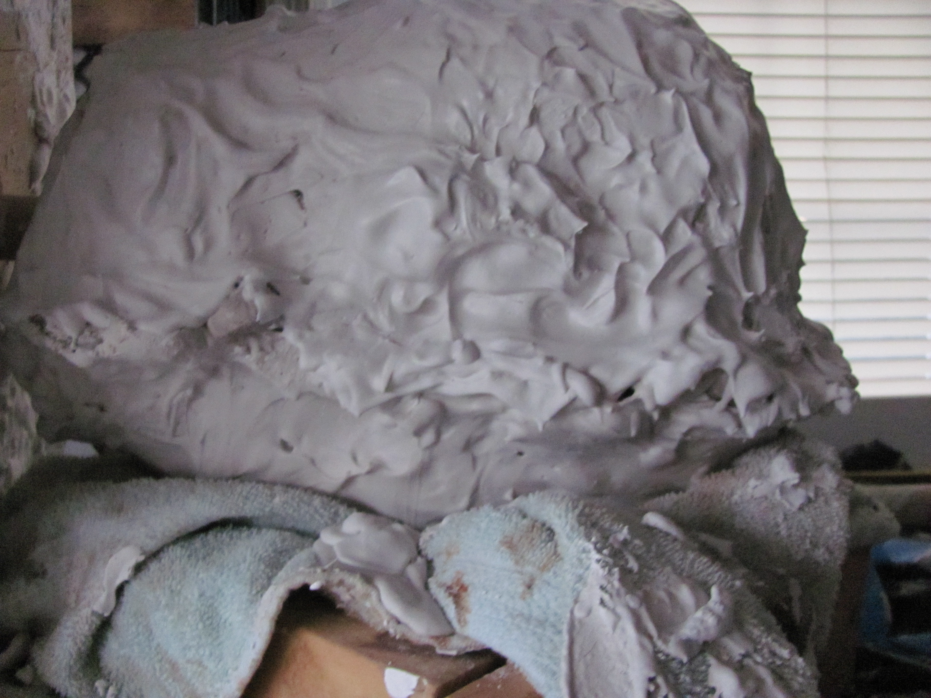

Picture 024.jpgPicture 022.jpgPicture 023.jpgPicture 025.jpgBusted the mold open today. And I mean BUSTED. I had to damage the mold and destroy the sculpt to open it. I think I'll be able to repair it, but I'm not sure how the seal will be around the seam will be.
Hey man if that was a styrofoam head you sculpted it on the neck is going to be way to small to get your head through because even though latex is flexible is isnt nearly strecthy enough to go over your head so you will more than likely need to cut a slit up the back to get it over your head. did you make a dividing wall around the front and back halves then cast each seperately? You should have used vasoline to keep the two havles from bonding.
Thanks for commenting:cheers! Yeah, I do plan on making a slit up the back of the neck, as (even if the neck was wide enough) I have a big head, and I don't want to risk tearing the mask.
I did make a dividing wall, but unfortunately I didn't make it tall enough, and even though I did use vaseline, some of the plaster did slosh over onto the other half of the mold.
So, in short, I had the right technique, but not the right experience to use it correctly:facepalm.
*sigh* lesson learned:lol:.

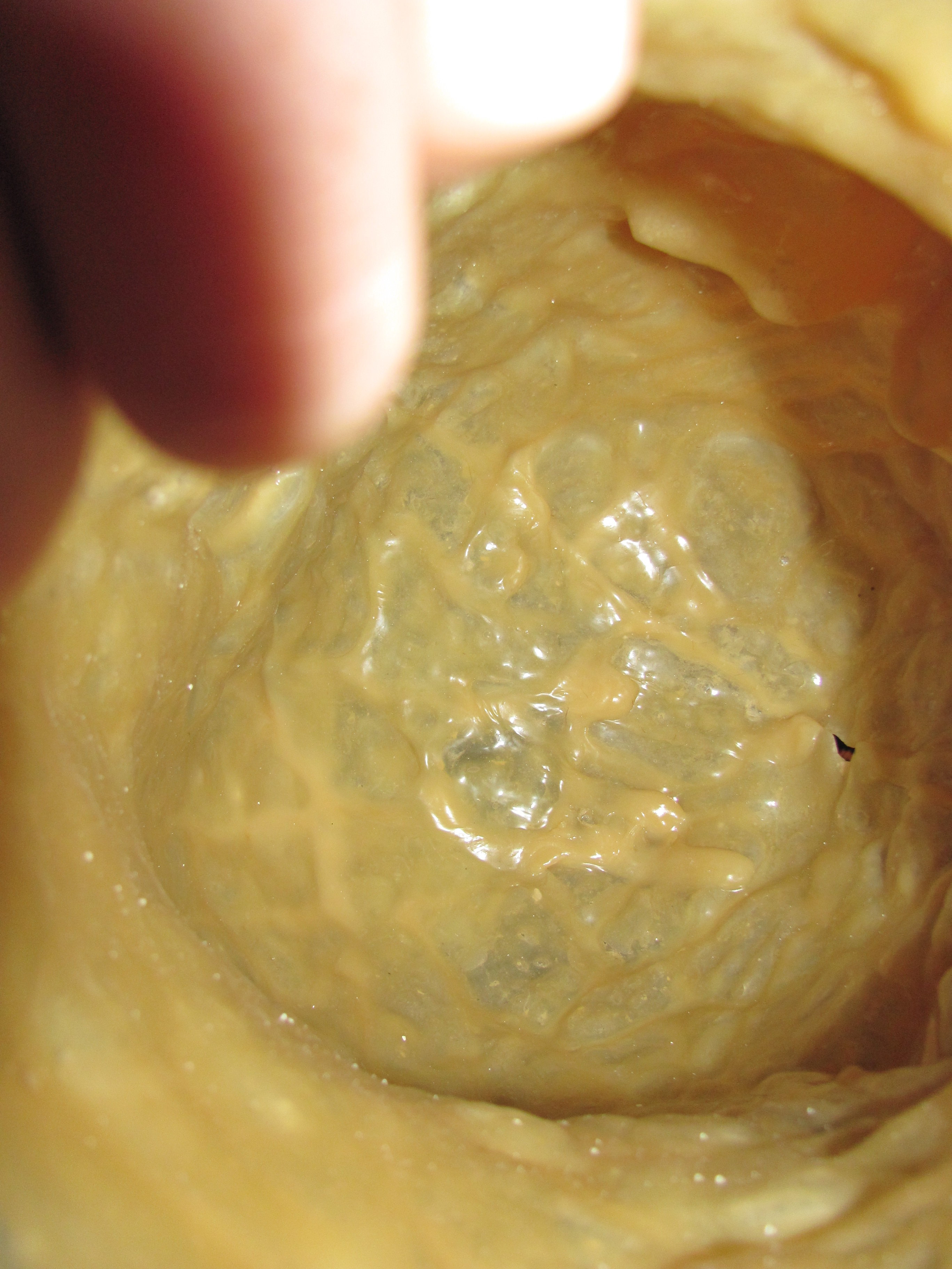

Feeling good! First pull came out pretty darn good:love! has some thin spots and the flashing is really thick, and some spots will need to be patched, but I'm thrilled at the amount of detail!

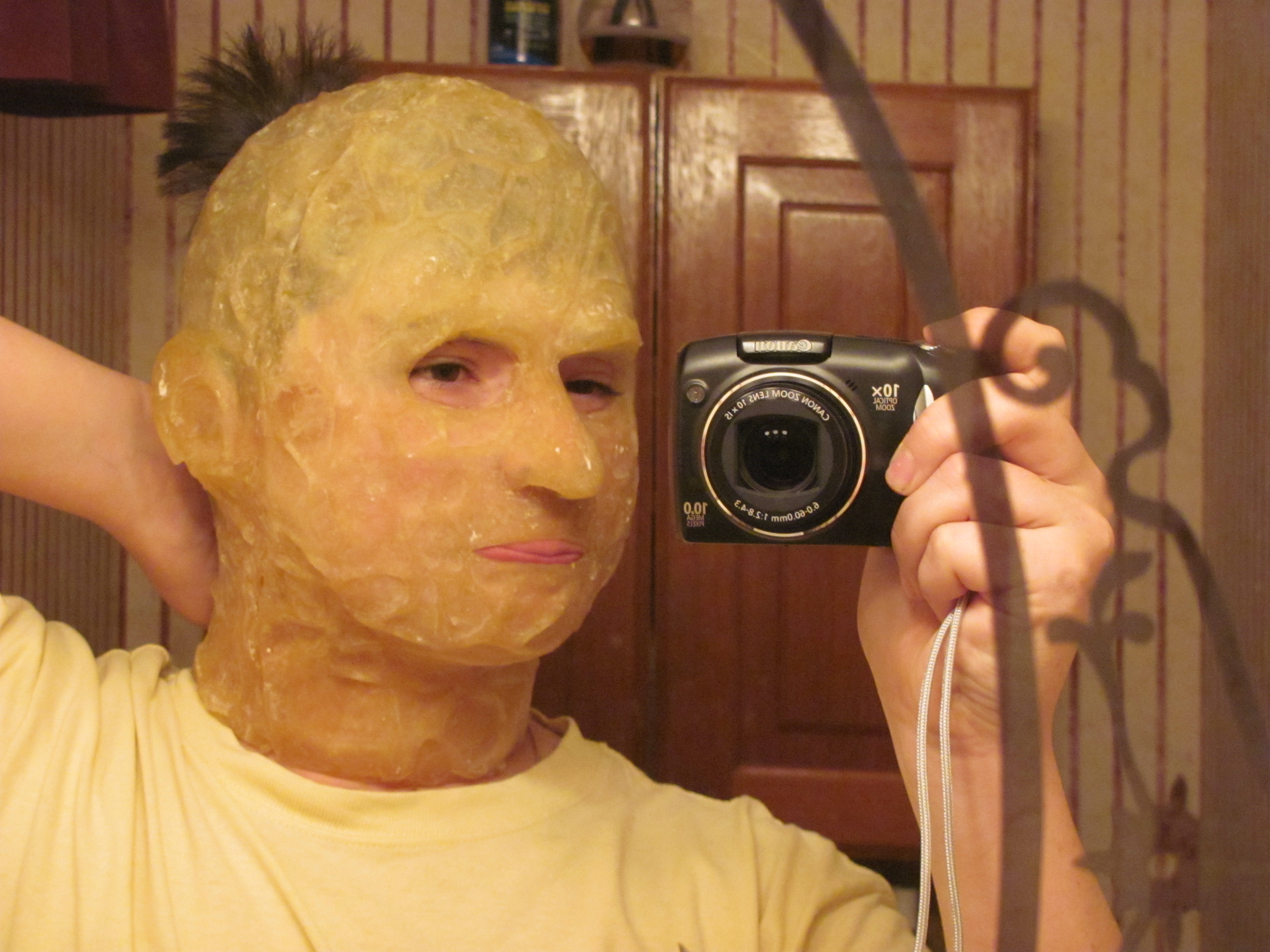

Me wearing my new raw pull! Yeah, I know that's some sexy hair sticking up in the back but I haven't figured out a closure for the back of the mask:lol:.
