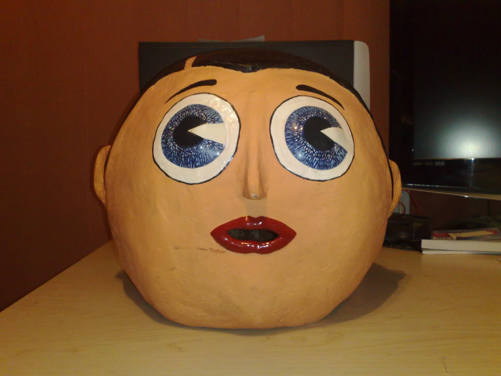

I made this head out of paper mache about 20 years ago and then covered it with fiberglass about 15 years ago to make it stronger and more like the original. It worked out fine just make sure you are in a well ventilated area as mentioned before.
