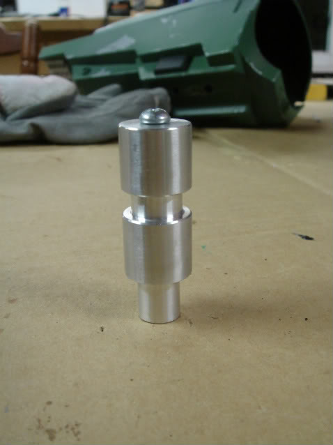

The screw in aluminum darts will need to be glued in, the dart area is solid so you can't screw a bolt on a screw from the inside. I'm thinking I could cut off the screw head, drill a hole in the rubber and CA glue the darts in. I don't know, rubber darts may be the way to go if they are possible.

I took pictures of the darts and screw and never posted them, hang on...
Not the clearest image of the mounting but as you can see the existing bolt tightens right to the dart. So a new longer threaded bolt with no head would need to be measured then threaded tightly in to the dart and then threaded tightly into the small drilled hole in the rubber mount.
i'll probably cut the head off the screw on my darts, drill a hole into the knee, coat the screw with goop, shove it in and let it dry. i doubt it will ever fall off. my first knees had the darts just gooped on and i never lost one.
Another option is threaded rod you can pick up at any hardware/home improvement store. It can be bought in foot increments, so you more for anything else.
