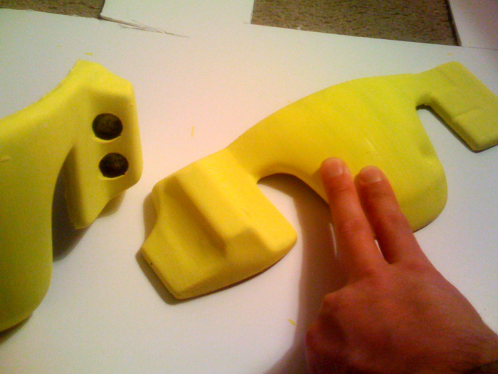

i wonder if you could use some sort of mold with a greater stretch/tear rating (something like rebound vs. oomoo, in smoothon terms...
a brushable mold with a thick jacket or something.
Thats what im usin now stormy. Rebound 25. Once I get the rubber thick (im going for pretty thick :) ill look at if i need a 1 piece or two piece jacket.
The piece is a funny shape, so im thinking ill need to make the jacket a two piece because the dart launcher area. On the other hand, there wont be a seep line on this bad boy.

The new mold is done, the glass sleeves are close, they are drying now. If all goes well, ill make a pull tonight of the new knees. And will give info and proceed from there.

The molds done, looks really good. Only issue at the time being is the mold needs something to be used as a stand, while I do the molding. Since its got a sleeve, it doesnt just sit on the counter.
Once I get that working, its off to the races.

The brush on mold, with a shell, doesnt work right. It deforms the knees. And Thats not acceptable. So wolfie and fettdad are the last two that didnt get a set.
Im going to redo the $500 mold this week. This means that ill have to re-paint the masters and mount them tomorrow. Silicone this week, pours this weekend.

I have what looks like two pristine pairs of yellow knees that are un-spoke for.
They are 95 shipped us, 100 outside.
If someone watns the yellow pricey knees, pm me. Otherwise they will go into the 'mike mason has too much **** laying around to make his own boba fett fund'.

Sorry brother, yes they sold, But ill have more pairs of them this weekend. Once I pull the last two black, im going to do a run of just yellows. So by early next week the yellow esb or slightly orange ROTJ will be ready.

I intend to have more than enough sets once I finish the mold. Right now the masters are drying (primer) then ill mount them on clay tomorrow night and pour the first half of the mold. 12 hrs later, i break it apart and do the scond half the mold. Then I clean it and start pouring.

I was fortunate enough to get a set of the yellow knees and they are SWEET!! The flexibility and durability are worth every bit of pain Mike had to deal with, and the color is awesome! They are definately the better option when you look long term on a piece of armor that is constantly flexing when walking, bending, etcetera. Great job brother, and the fact that it was done for Chris and Pam adds a little bit more value on them.
Im super sick atm. I have been trying to get this done between praying to the porcelain gods. The first half of the mold is in clay and ready for silicone tonight. Then Tomorrow ill do the second half.
