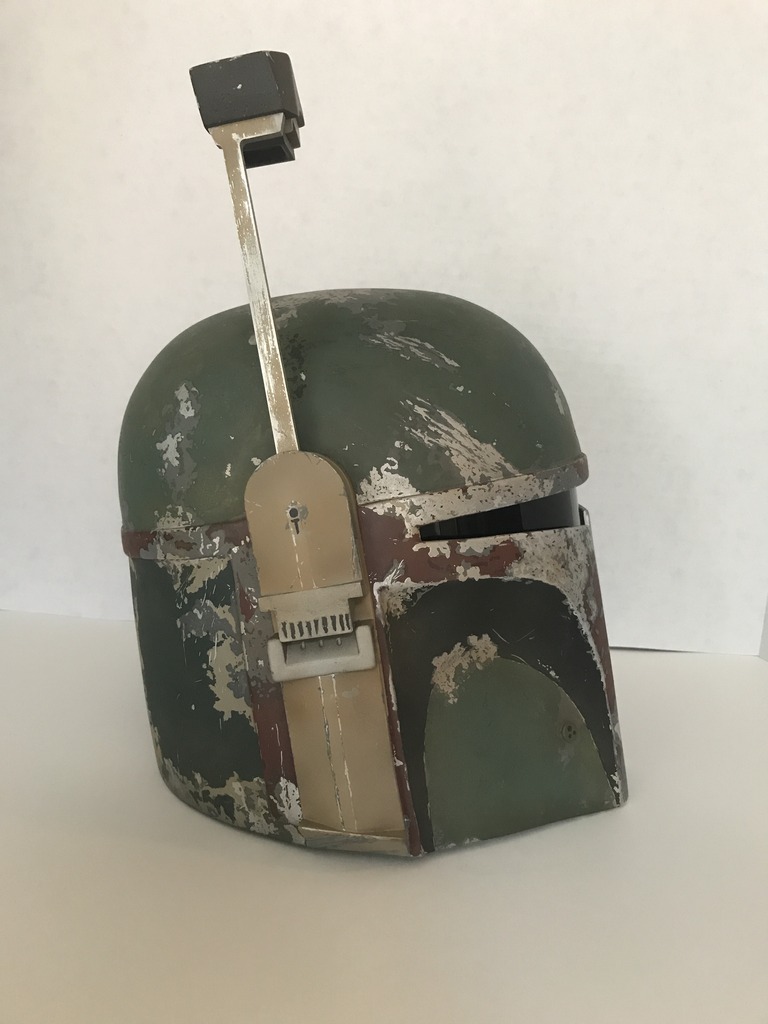

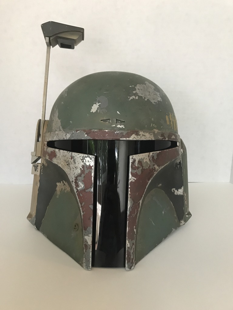

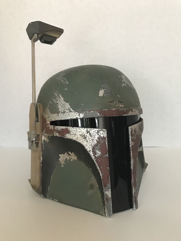

I bought this BM helmet about a year ago and it's been sitting in my room waiting to be painted. So without further ado here some photos of the final product. I still have a few things left to do. Mainly some ear decals and a green visor. I bought a dark green safety shield a while back and will make a visor template and cut it out later. This visor is just currently taped in.

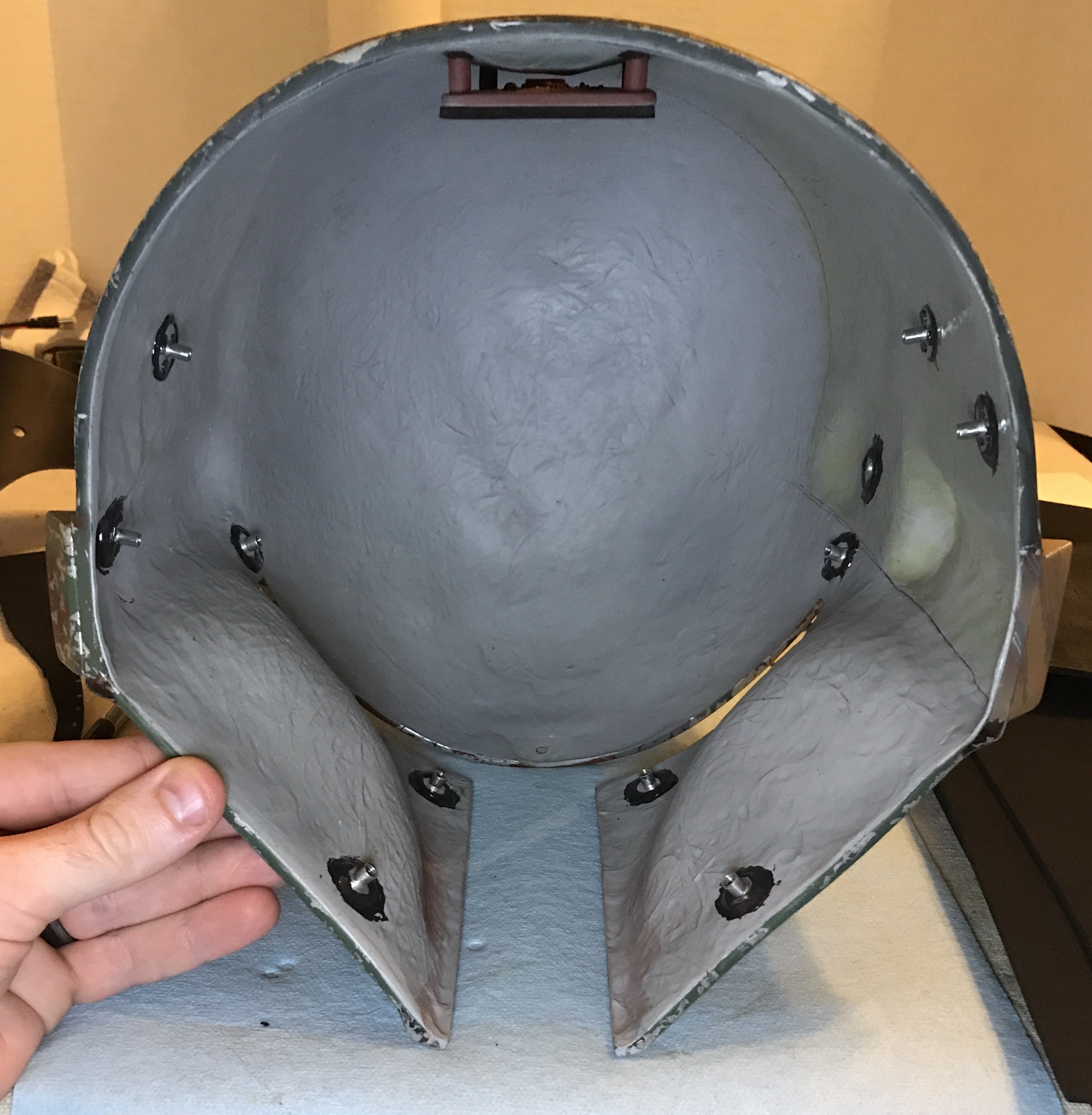

I am currently working on a few interior things and wanted to share some other things I found better help me with this build. First off while at Hobby Lobby I found these really cool aluminum brackets that were in the jewelry section. They are strong but pliable. My goal is to mount the visor using Chicago screws and use these brackets on the bottom lip of the visor. Here is the link to the ring pieces.

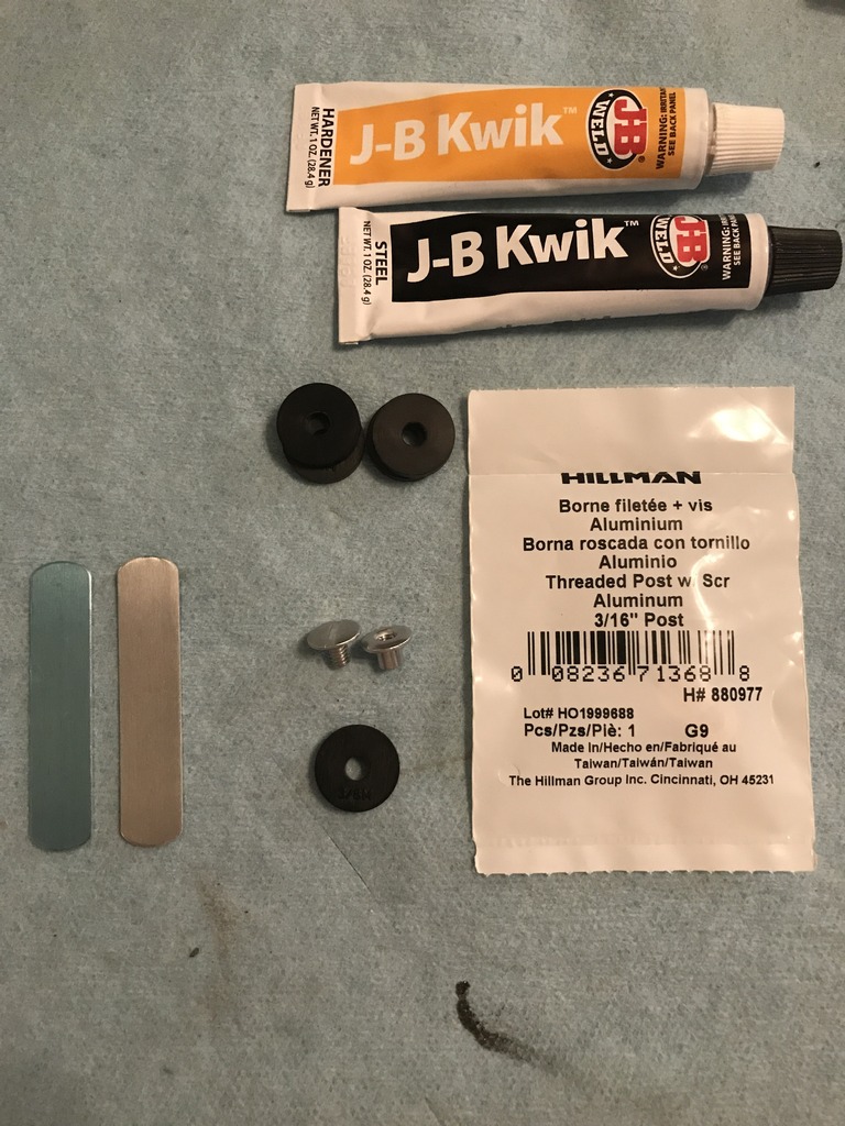

I have a few Chicago screws, some rubber washers that are located in the plumbing aisle and some JB Weld Kwik. I have to say I LOVE JB Weld. I trust this stuff with my life. It holds great, has a quick working time (sets up in about 5 mins) and has a quick cure time (around 6-8 hrs). I'm not a fan of epoxy glues. They just always seem so watery and hard to work with. If you prep the surfaces right, this stuff will never come off!!!

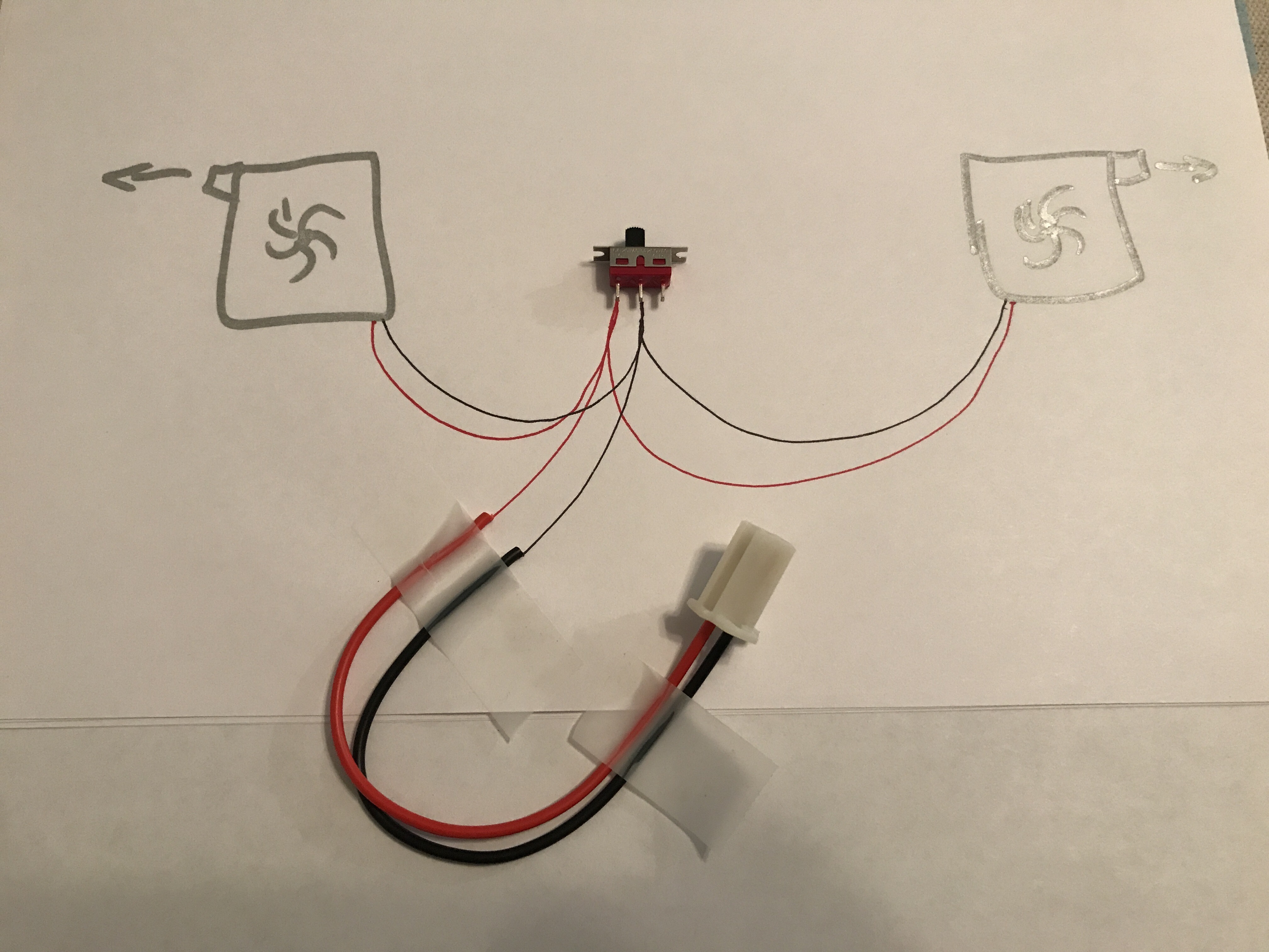

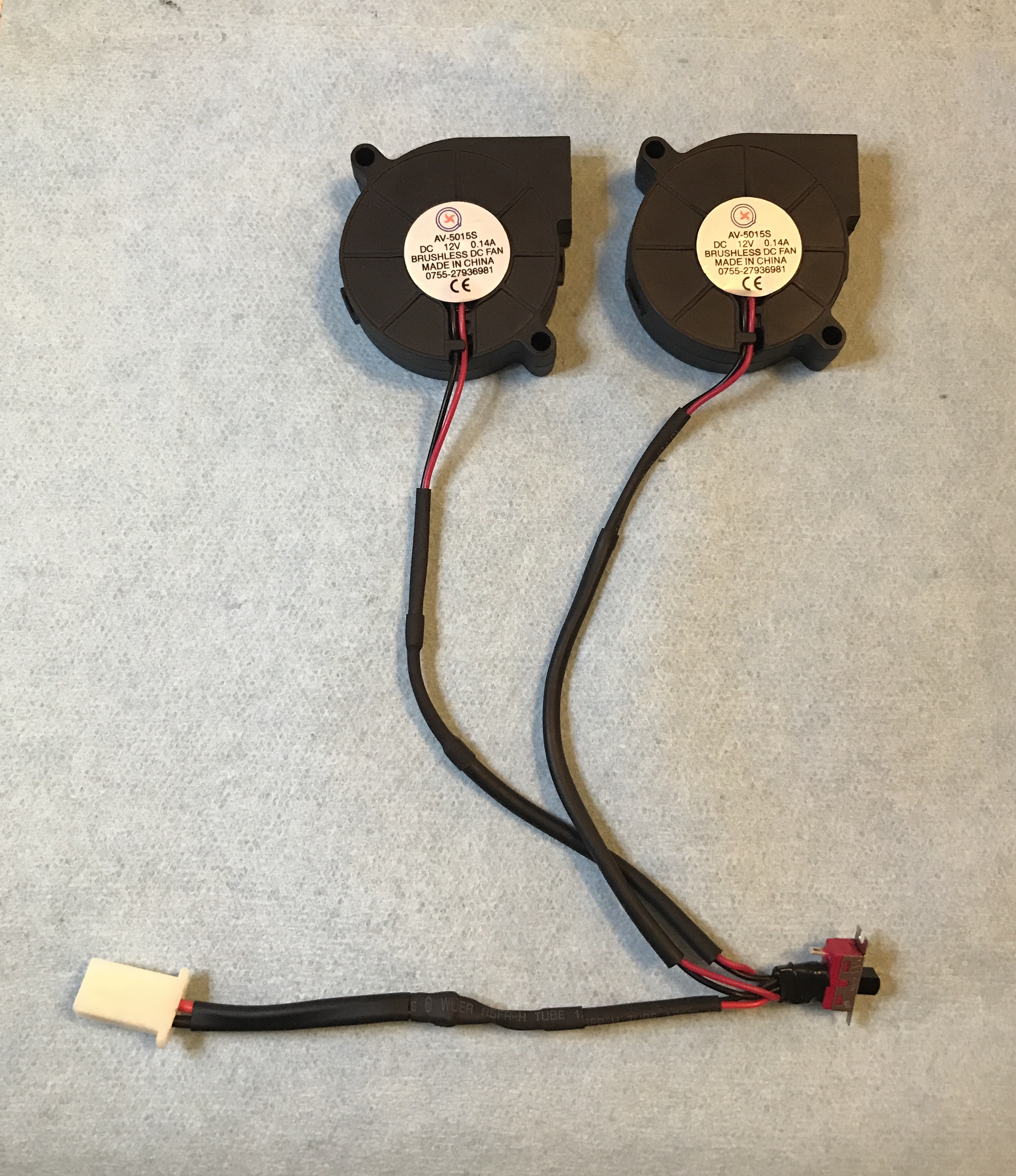

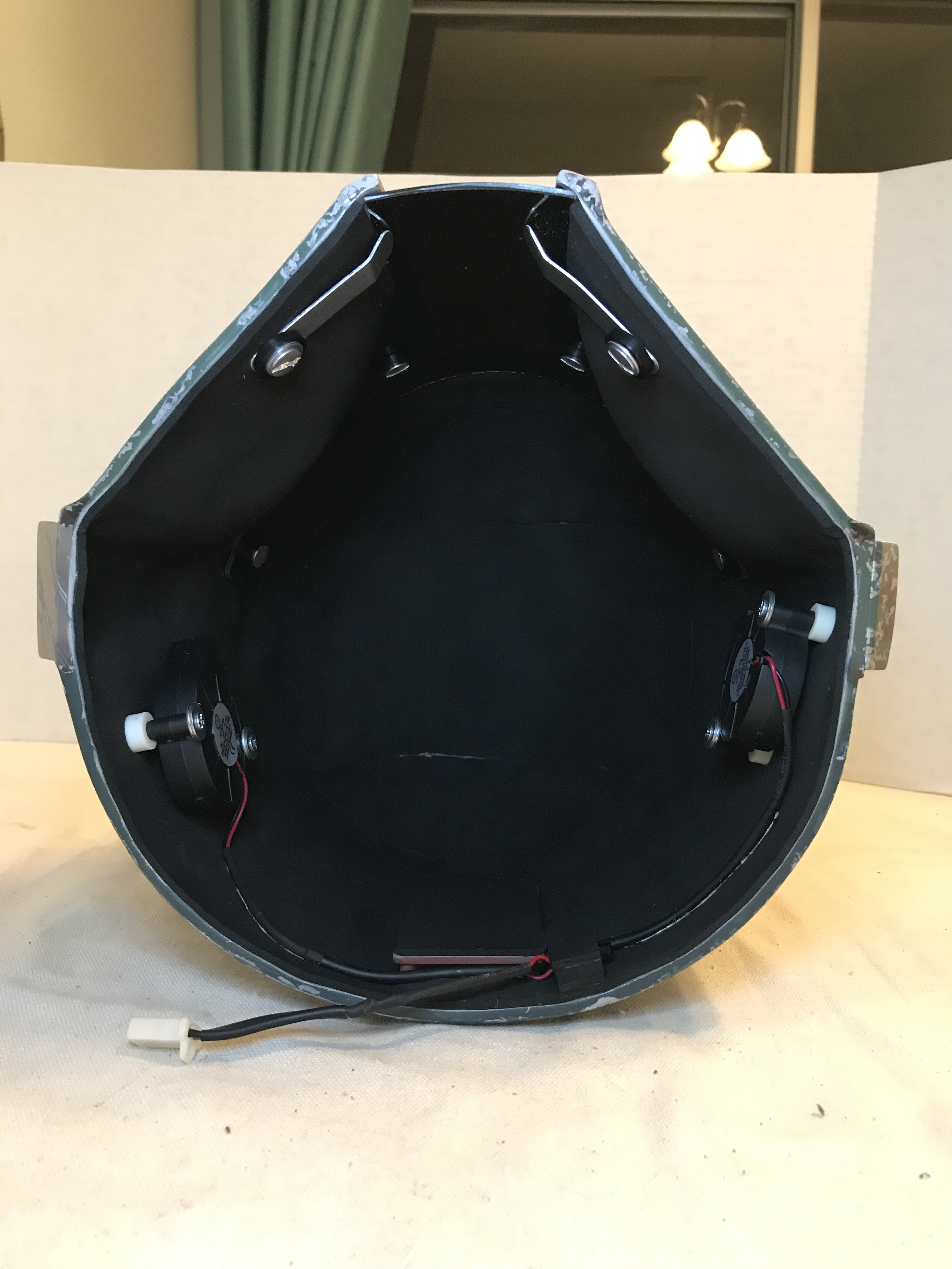

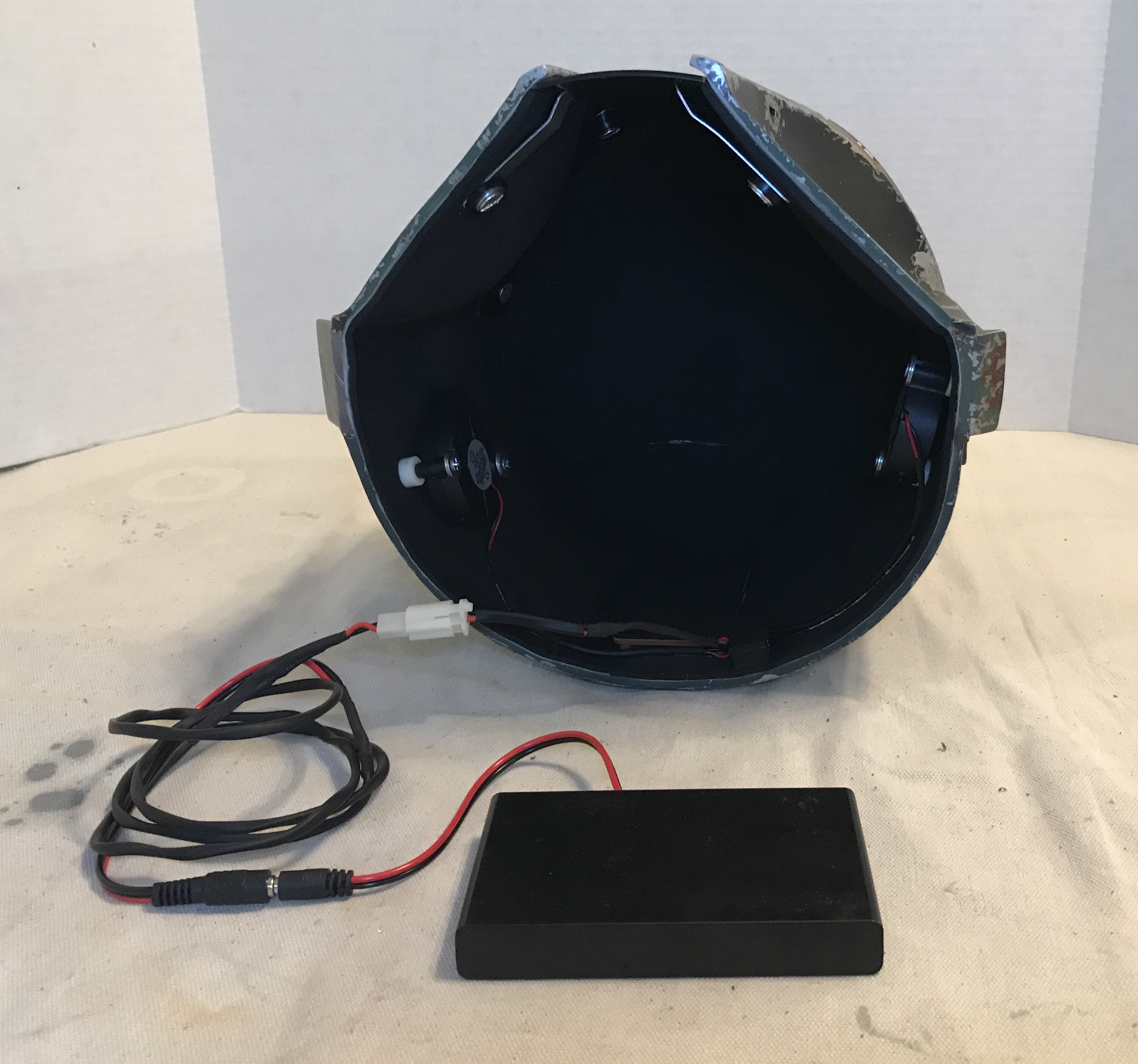

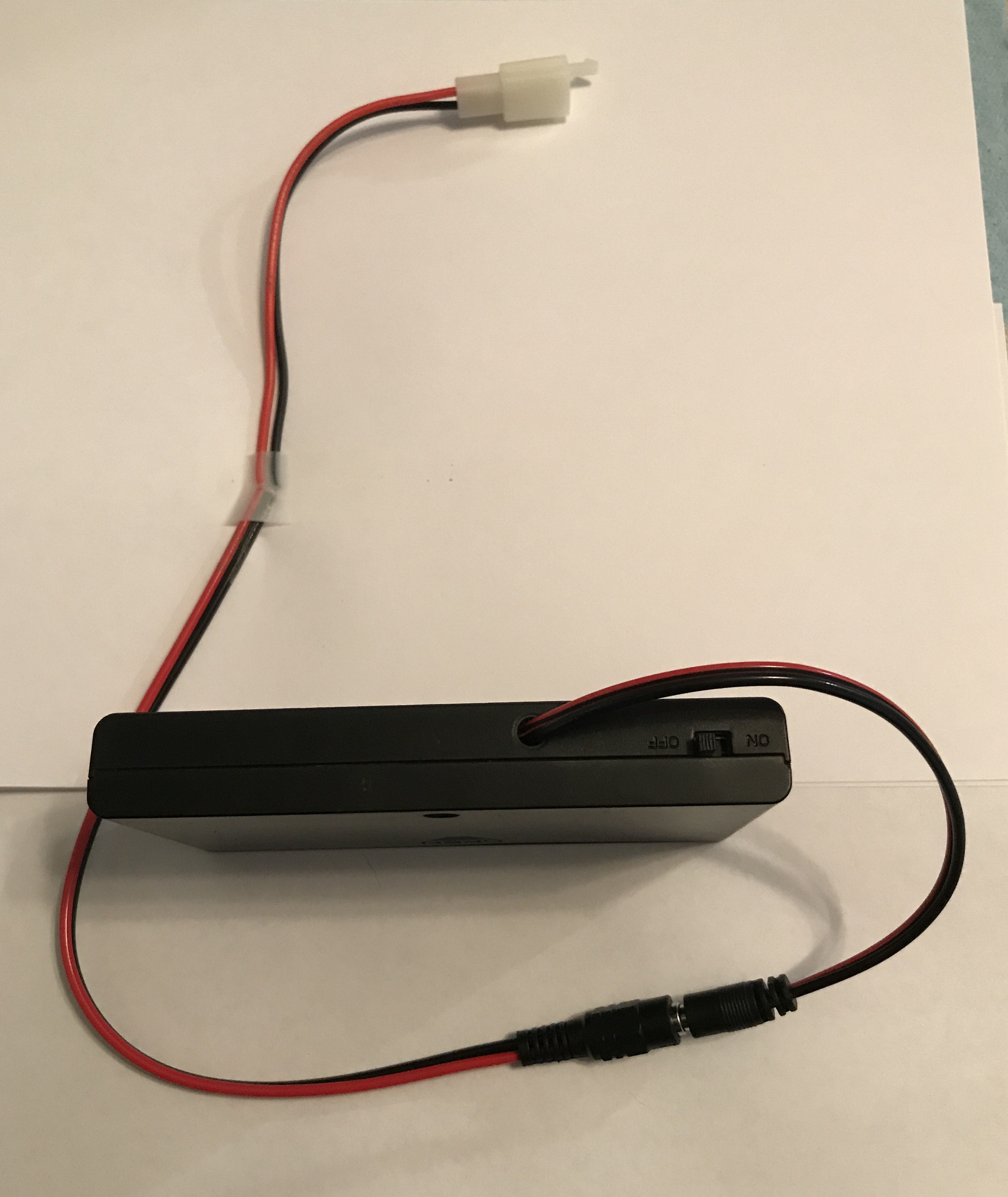

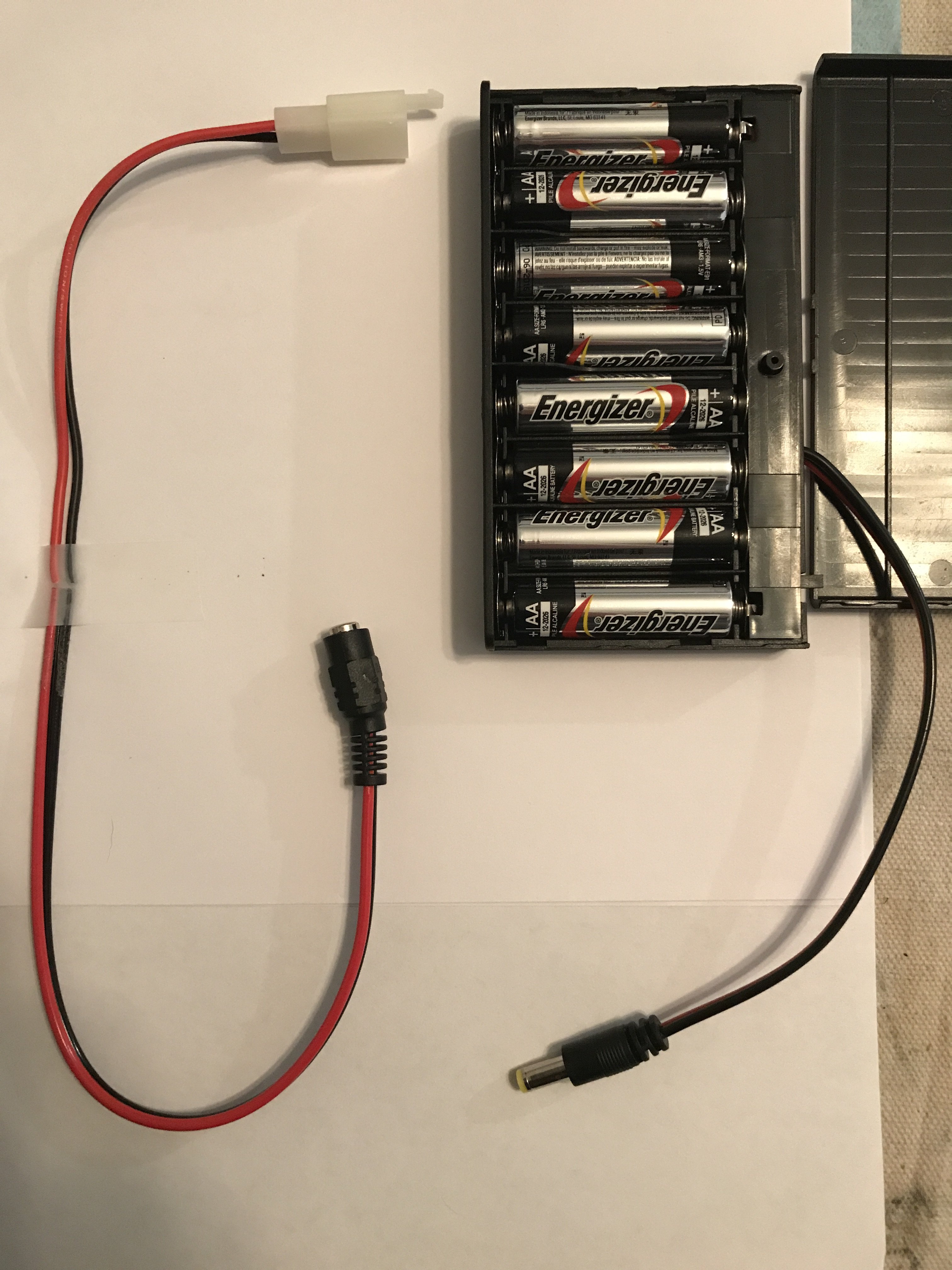

I will be installing a squirrel fan (probably just one but maybe 2) inside. I decided to place it near the ear cap inside so that air will blow over my visor keeping it from fogging up. Nothing worse than trooping with a fogged out visor. lol. I found these fans off amazon for fairly cheep. Hooked it up to battery packs that have on/ off switches and has a quick disconnect in case I need to change out battery packs on the go. I will attach them using the same method as the visor using Chicago screws and rubber/ nylon spacers.

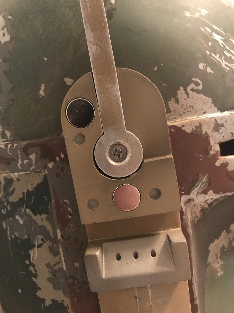

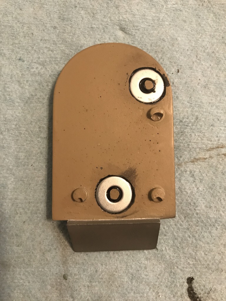

Here is a quick thing I learned the hard way. I use to attach my ear caps with 4 total magnets. 2 on the helmet and 2 on the cap itself. However the problem I've had in the past was getting those 4 magnets to line up perfectly or else they don't "snap" together right. So a solution to my problem was embedding washers into the cap. The magnets adhere to the washers without any problems and the best part is they don't need to be spot on for the to snap and line up.
