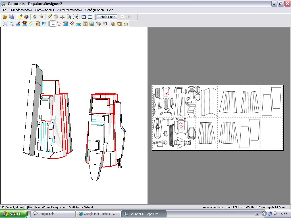

I've loaded up the Gauntlets now and I'm tweaking the models. Making the changes that they needed.
With some luck, I'll have them finished tonight. Please don't hold me to it, in this house one can never know what's round the corner! LOL!

The tweaking is done now and I can unfold them later with some luck. This figure will help me get them to your guys sooner. ;)
Got them ready for you guys. ;)
I had to come up with a scale for them since no-one answered my question about sizing. :( I've based the scale on the gauntlet themselves being 19cm long. I can alter this if someone steps forward to help with dimensions??
Anyway, I've only done the A4 version so far but doing a Letter size won't take long. ;)

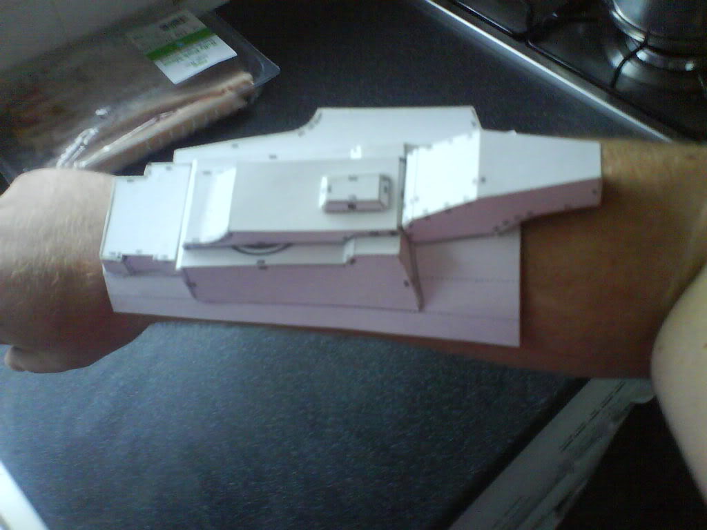

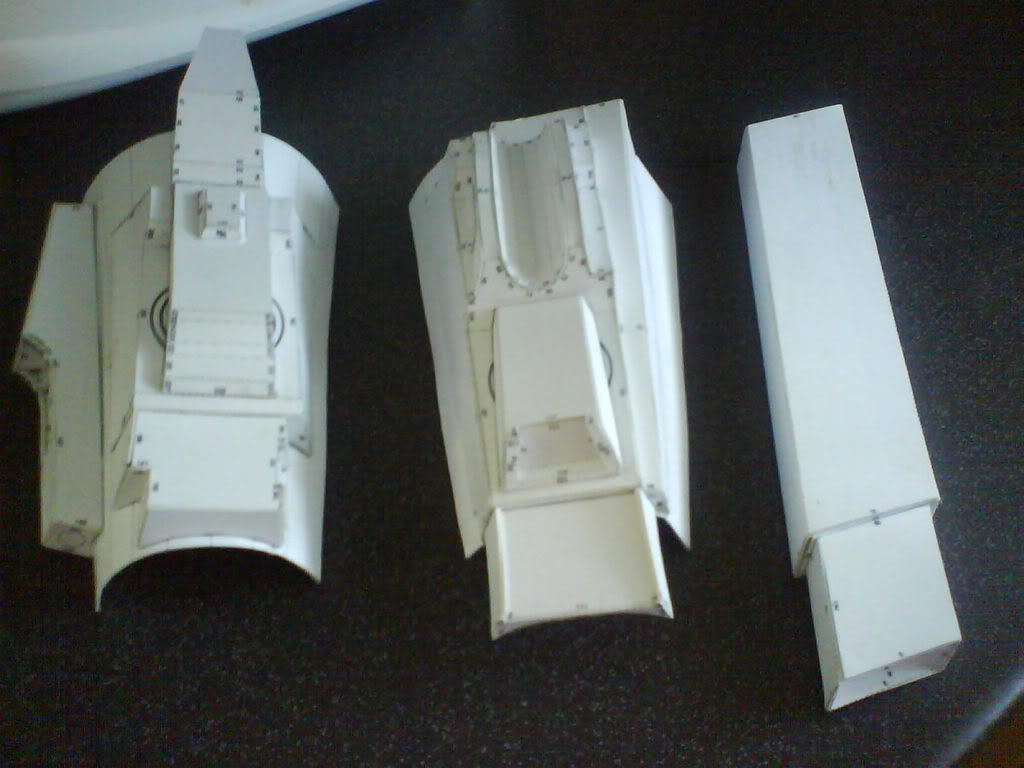

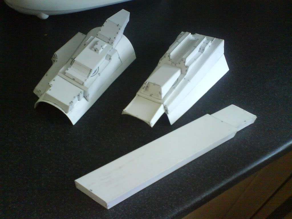

I've finished the builds. :) All except shaping the lower cuff for both gauntlets. That's just bending them into shape though. The build was really nice, no stress involved or major problems.
Now, I'm not sure, but I think they're a tad small. Not kids size or anything but maybe not full size?? Having never owned a set of gauntlets before I don't have a real world reference here. They do fit my arms though and look Ok so I could be worrying over nothing?
Anyway, here's some pics for you. ;)
Hope they look Ok to you? The filler will fill the small gaps and whatever but overall I'm really happy with them.
I took some pics of them on my arms. Maybe you guys could give me some input? They seem Ok on my arms but look too small when they sitting on the work top???
I don't know, maybe I just expected them to be bigger??

As for size, the ESB gauntlets seem to always look a tad smaller to me. The jangos are def' bigger than the esb bobas. The rotj may look bigger because of the big flame box on it, but not sure.
The bottom line is, yours are really close, its all up to your forearm size. If you have big forearms, you may be in trouble. Rememer youll have gloves and sleeves at the wrist, and sleeves at the top, your going to need 1/2 to 3/4 inch clearance on the naked arm.

Confusing?? That's probably down to all the glue tabs that come with a Pepakura design. Though for these gauntlets I cut them all off as I laminated the cardstock to thickr 1mm card so the tabs would have messed the fit right up. They went together really well I think.
I have a PDF program similar to the one you described but I don't like PDFs for this kind of thing. With a PDO you have the 3D windw for reference and instruction. Though with PDF you don't have that so I'd need to make notes or instructions for them, plus you couldn't rescale the gauntlets as easily as a PDO. I guess I just prefer it because of my papermodel design background.
