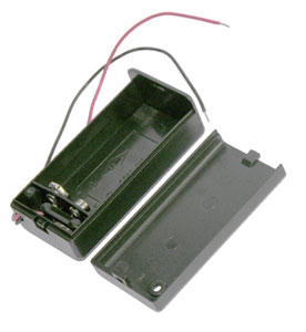

Hey Monk...I suggest using squirrel cage fans and soldering the wires to a nine volt battery holder with a switch. This type of fan directs the air through an air duct much more effectively than a regular, run of the mill CPU/VPU fan.

connect one 9 volt negative to one 9 volt positive to another via the snaps
will make the fan run faster and last longer but you will have to build custom housing for it. it should look like this :cheers
