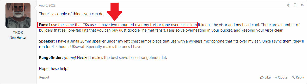

There's a couple of things you can do.
Fans: I use the same that TKs use - I have two mounted over my t-visor (one over each side) It keeps the visor and my head cool. There are a number of builders that sell pre-fab kits that you can buy (just google "helmet fans"). Fans solve overheating in your bucket, and keeping your visor clear.
Speaker: I have a small 20mm speaker under my left chest armor piece that use with a wireless microphone that fits over my ear. Once I sync them, they'll run for 4-5 hours. UKswrathSpecialty makes the ones I have
Rangefinder: (to me) NeoFett makes the best servo based rangefinder kit.
Hope these help!

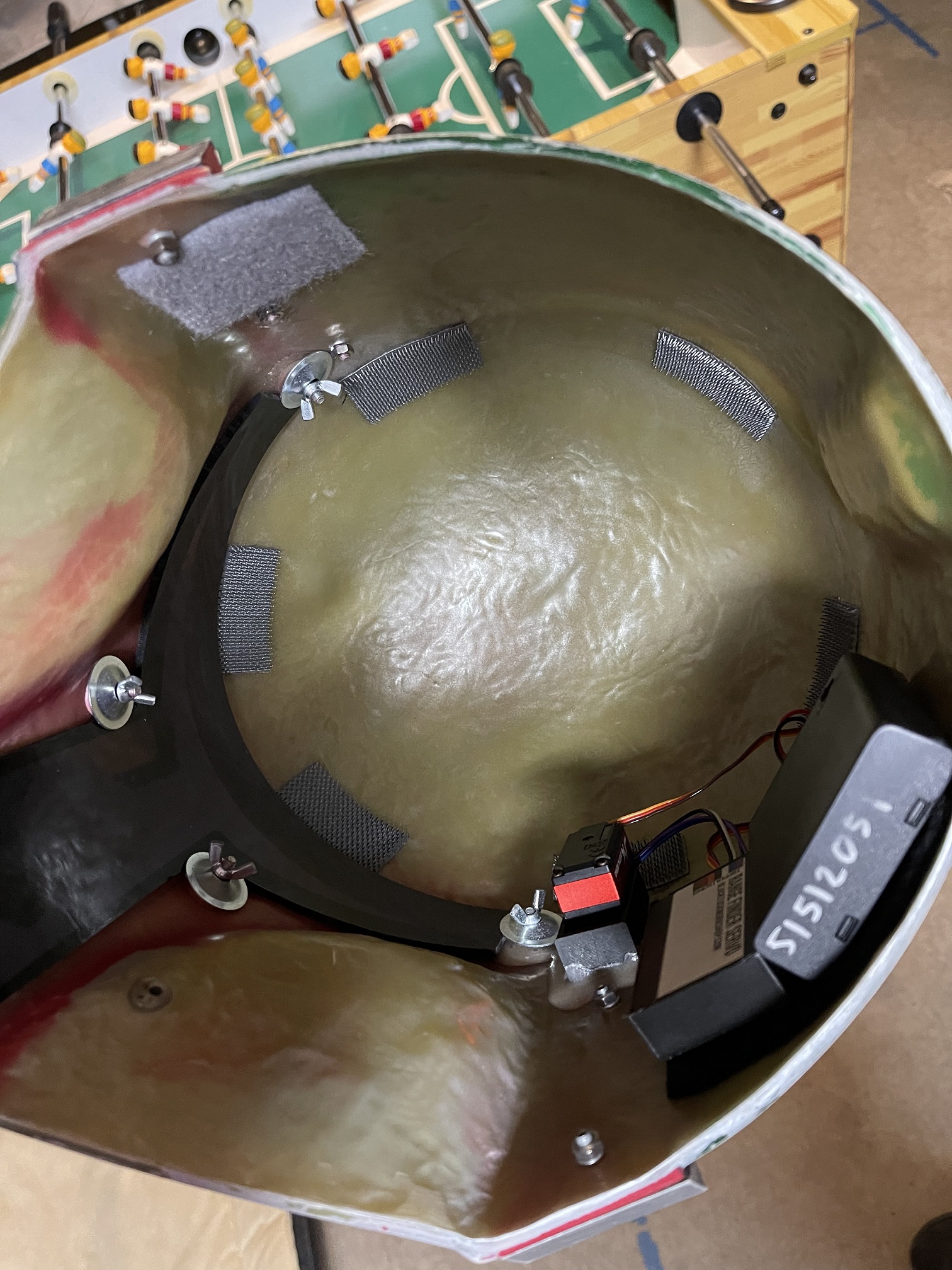

JasonTheConner - I use the ones like the pic below. I mounted them with two threaded posts JB Welded to the inside of my helmet, then I slide the fans over the posts and use a nut and washer to keep them mounted. I point them facing to the bottom right, and bottom left of my helmet so it doesn't blow right at my eyes and dry them out.
I use the same power bank as Irongladiator and velcro it behind my chest armor and run the cable through my vest and up my neck piece.
Dumb question: Do you have pics of the posts you have mounted? I have the same pair and am not really able to picture your mounting.

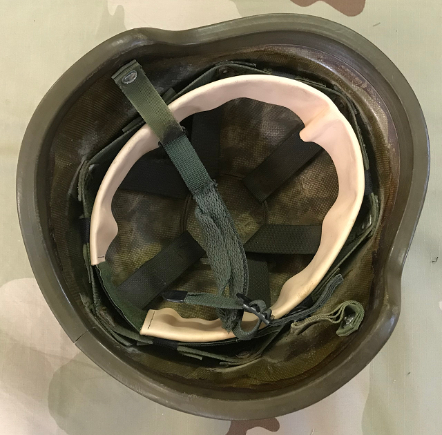

I'm actually on the fence about using my fan. I've been to plenty cons and really haven't come across an issue to where I need the fans. I think it is because my Boba Maker VX helmet is pretty open. I don't use foam pieces to keep it on my head. I use what's known as a PASGT (Personnel Armor System for Ground Troops) Head Suspension System. Kinda like this....
I only use the Helmet Liner and Sweatband (Two items - cheap and easy to acquire - mine was under $12.00 for both) and found that it holds onto my head very good. I'm a former US Army Soldier, and I figure that the US Department of Defense probably went to some lengths as to making Combat Helmets as comfortable as they can be for soldiers. And in the 10 years I served, I never had an issue with mine and felt it was comfy enough to wear for extended periods. I can even turn my head very quick in my Boba Fett helmet and you don't get any bobble head effect. It stays precise - where my head turns, the helmet follows!
I think because I don't over crowd my head in my helmet that I get decent airflow without fans. I've kept my helmet on for 3 hours once and hardly broke a sweat.

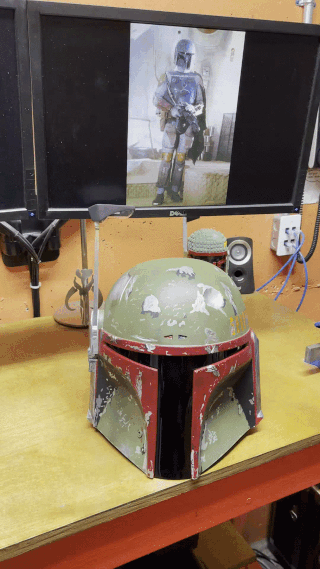

Presently my helmet looks like this....
Go ahead and laugh, but the 6 AA batteries I have mounted in there actually is dual purpose. They serve as back-up batteries in case I need them and also act as a counter weight to the Servo and batteries I have installed on the other side. Otherwise, the helmet goes all lopsided.

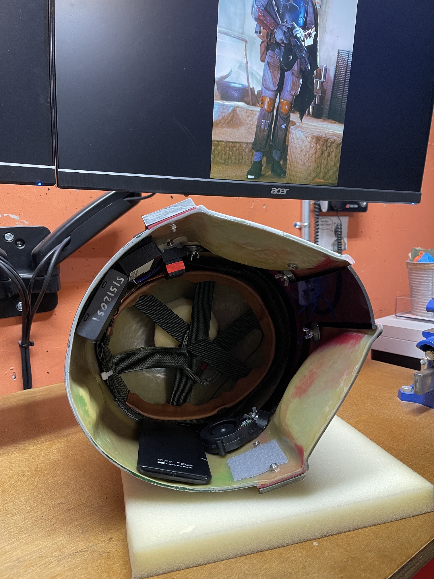

I have to play with it a bit more, but here is my idea with the fan.
Hope this kinda helps you.

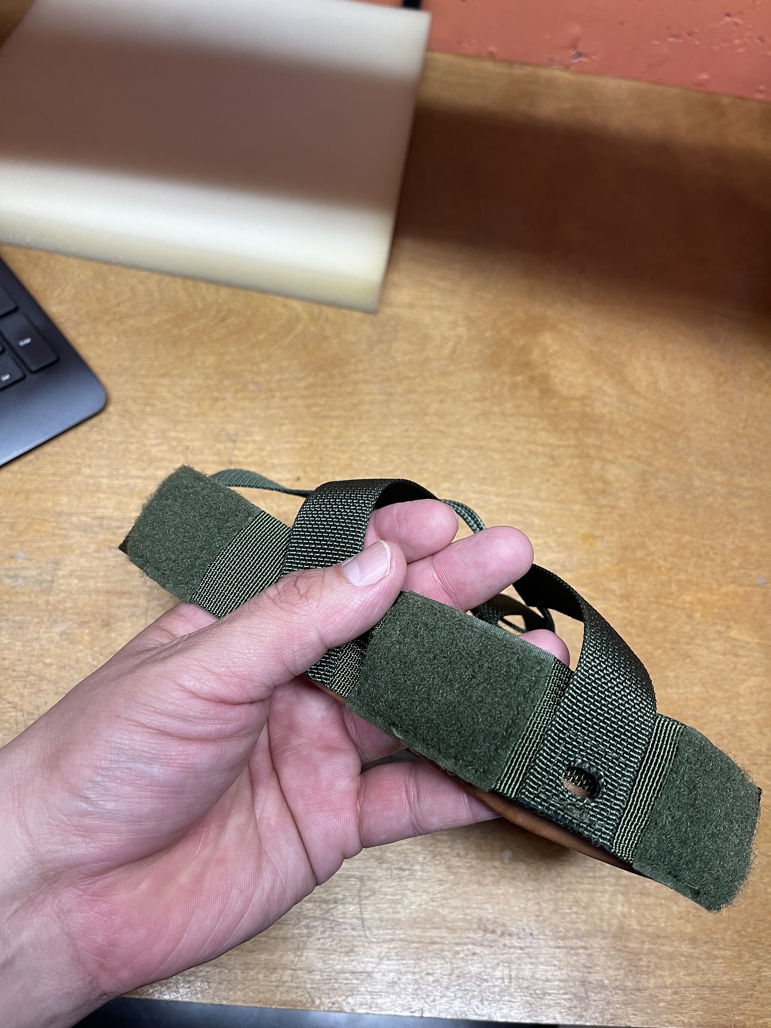

That was actually pretty easy. I just ran down to my local Home Depot and picked up this....
I then cut up the rough sides of Velcro into pieces that matched the size of the soft sided Velco that is pre-sewn onto the Headstrap Liner....

Cheap, easy and effective in my opinion. And for three years now and a couple dozen troops underneath me, it has held up nicely with nothing having needed to be replaced.
