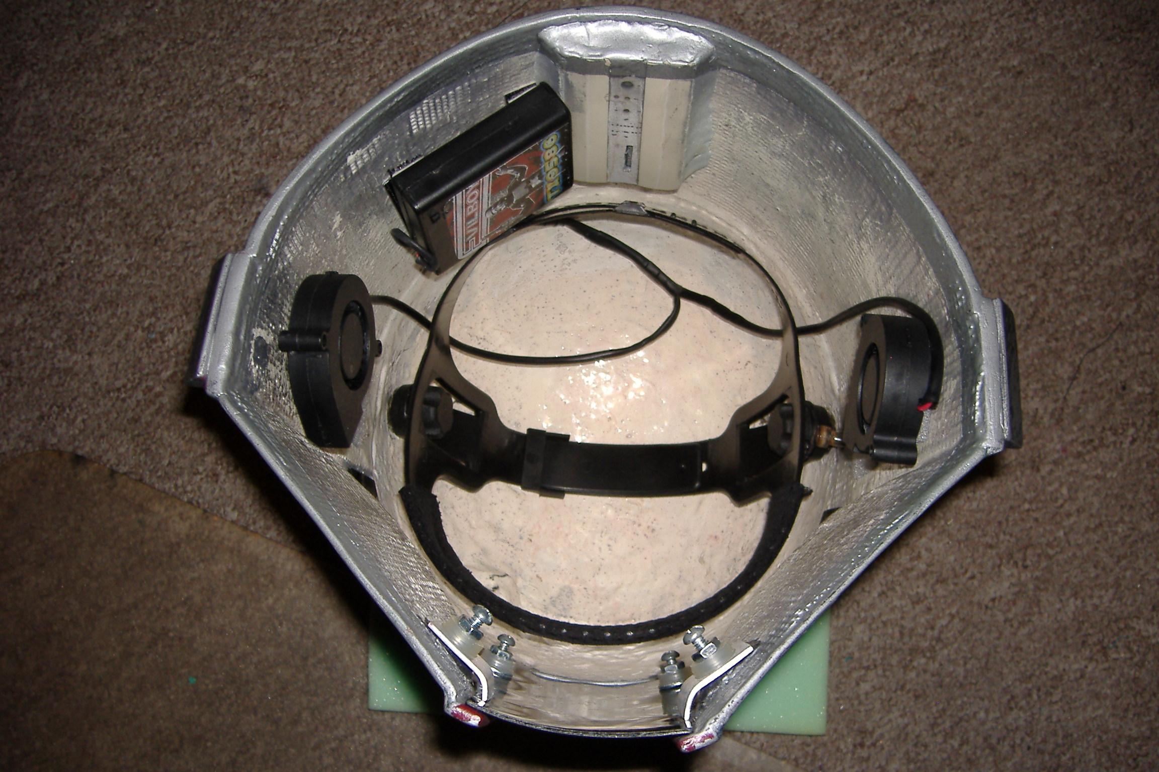

What Necronaut said. I did the same set up just this Tuesday. Used velcro to hold the fans in & put a longer strip on the inside of the helmet to allow for some moving of the fans if need be. Also mounted the battery pack on the left rear of the helmet next to the key slot recess to keep the helmet balanced some.

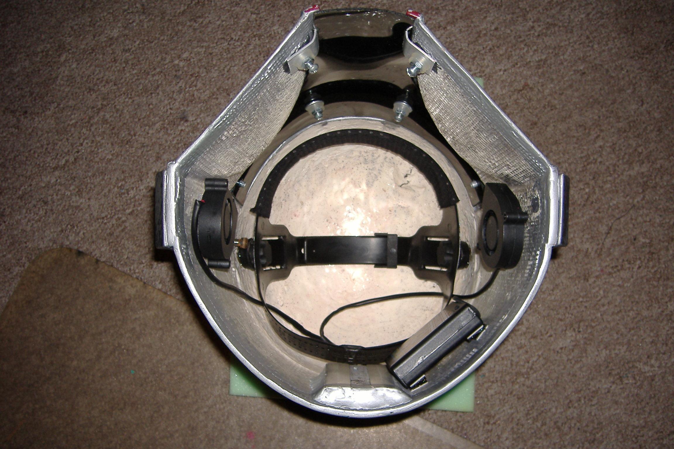

As promised here are some photos of how I placed the battery pack & fans in my helmet. This is the kit from Evil Boy. The fans are pretty quiet but there is a little hum but nothing too bad. I would rather have the air circulating.
I used double lock velcro for the battery pack to keep it in position & an industrial velcro with "T" hooks that is used for hanging things on imperfect surfaces. Evil Boy does send velcro with the kit I just opted for something I thought would be more secure. Hope this helps.
Thanks Chris! Looks snug, but probably worth it! We don't have that hot of summers up here, so I'm still debating. My Rocketeer helmet was pretty hot, but I also have a thick liner for padding.
It is a little snug but everything clears. I can actually put my my fingers between the fans & my head. Had them higher but were too close. Can also reach the on/off switch on the battery pack when the helmet is on. Would be nice to have the batteries separated & split them on each side of the key slots in the back to help with the balance. Though the balance isn't all bad. With the hard hat ring the helmet sits securely on my head & doesn't rattle around, very secure & helps distribute the weight.

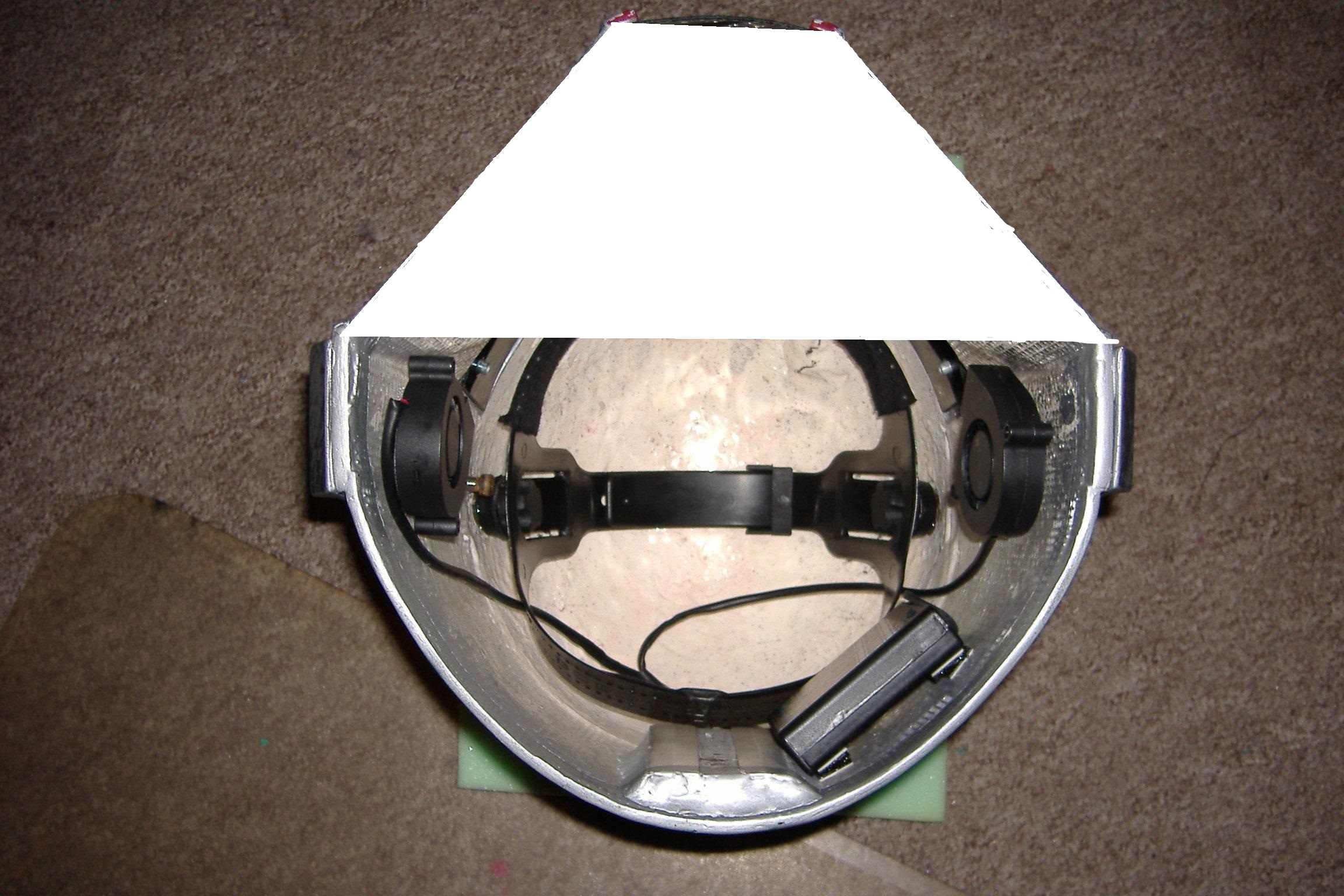

That looks like the setup I'll opt for. I'm thinking about two micro squirrel fans on either side pointing air towards the visor as in the picture, but closer to the bottom of the helmet and angled slightly in a custom housing that should pull air in easier. But I may yet need a chin-skirt to hide my chin which would prevent fans sucking air from the bottom. I'm considering a half-skirt; a piece of lycra velcroed to the cheeks that covers the forward half of the helmet, but leaves the sides open to allow for a fan to pull in air. Like this:
