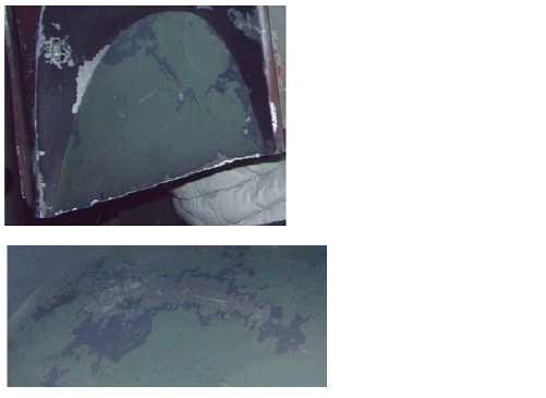

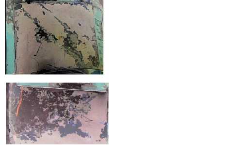

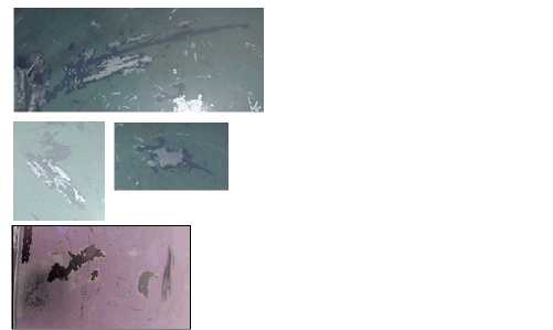

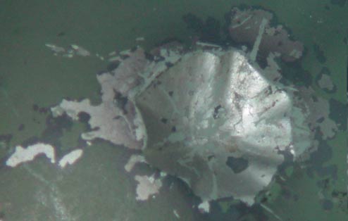

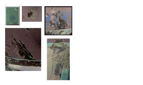

I spent this afternoon collecting the screen captures that I used as stencils for painting my BKBT helmet and thought I would post them here for anyone wanting to paint their own ESB helmet. Mind you, this is not all of the scratches and dings on the helmet, just the larger more signature marks. Also, this is not necessarily an easier method for painting a helmet as it requires you to print off the templates, trace them with a pencil, cut them out, and then use them to trace directly onto the helmet. I, however, found them immensely helpful for maintaining consistent size and spacing of the scratches. Some of the captures have had their colors inverted to the 'negative' to make for clearer printing (at least it helped me since my printer ran out of color ink and I had to resort to using b/w images). They should be sized pretty close for using on an MS or BM bucket. Those wanting to use them on a DP bucket might want to reduce their size by about 15 to 20 percent. This can easily be done using Windows 'paint'.
