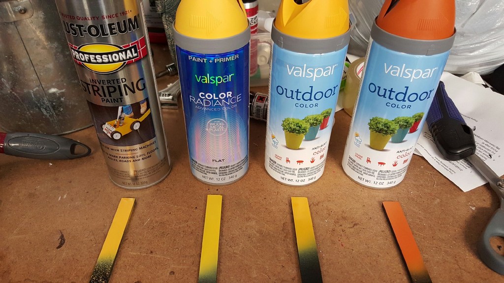

I'm going the rattle can route on my repaint. I picked up most of these at Lowes... but hesitated on the yellows. Valspar has a few new yellow/orange selections, so I purchased a can of each and will be experimenting with them all.
The two most intriguing:
Valspar Bright Yellow Satin has a slight orange tint to it already.
Valspar Carmel Honey Satin has a (obviously) honey amber color in it.
I also picked up "Valspar Dried Pepper" which is a kind of rusty bright orange. I'll be spraying these on some test pieces to see if I can get a match with these.

Here's the color comparison after the sticks dried.
