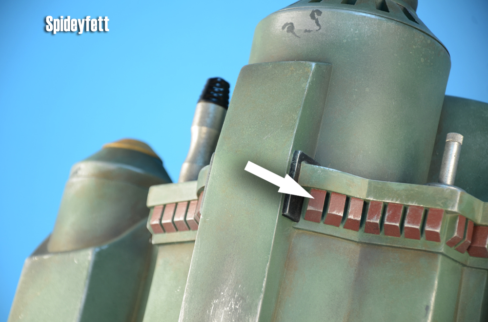

The red colour on the piano key area? I assume that this is the same colour used on the bottom of the thrusters, the part near the collar on the rocket and the horizontal stripe on the bottom right tank.
Yes, the same color.. weathering should make it look different, as the collar on the rocket does appear to be darker. But the same base color would be right. :thumbsup: Caboose (Floquil)

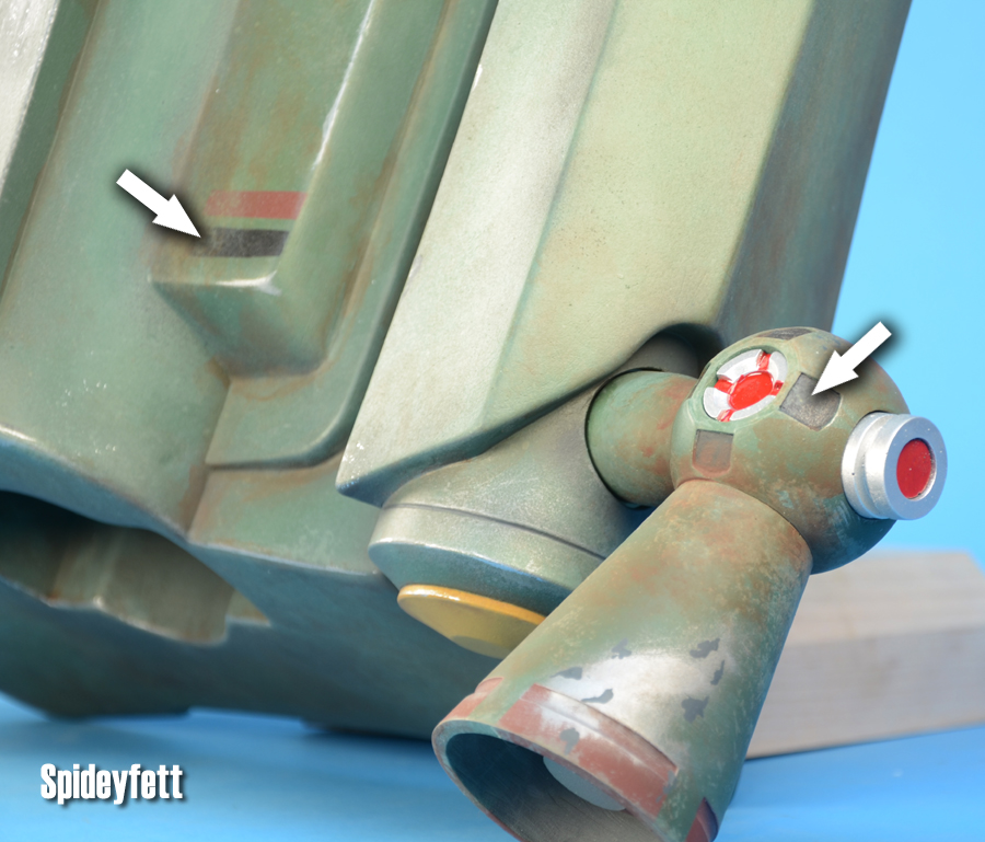

The other colour I am not sure if it is a blue or black. The colour that appears on the thusters around the centre silver/red part and the horizontal stripe on the bottom right of the tank.
Yes, it appears black, prob is.. but the color I used was Brunswick Green (Floquil)

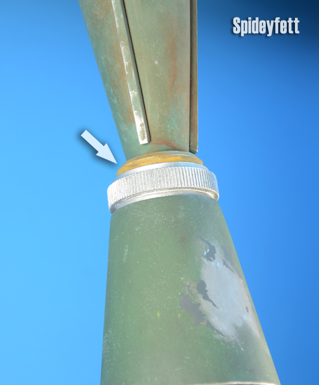

Looking at a ref pick, the yellow colour on the sivler collar on the rocket. This looks to be the same colour as the yellow on the top and bottom of the tubes, do you see it that way as well?
Yup, in the earlier pics I just forgot to add it on the Rocket... but yes. SP Armor Yellow (Floquil)...

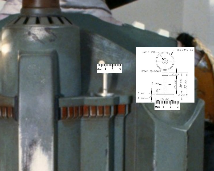

One minor point, I am trying to figure out the size of the white dot that is behind the stabliser? I have put one on it is about 5mm in diameter but it just looks a little small. Can you let me know ths size of the white dot please.

Judging by the images while using Seven's template for the jetpack stabilizer I may say it's around 9 or 10mm in diameter:
But these measurements might be off a bit...
