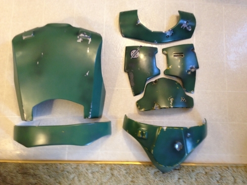

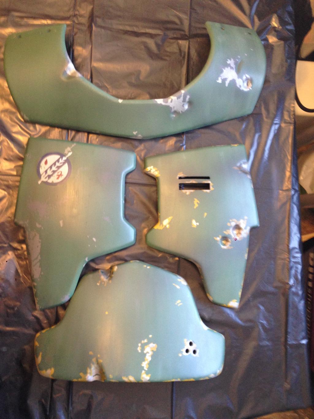

Armour's almost done cooking!

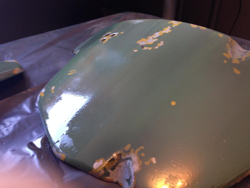

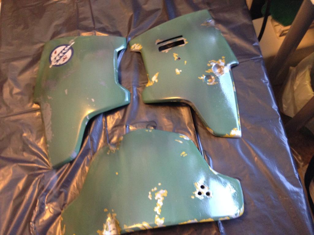

I gloss-coated the armour in preparation for some oil-paint weathering. I shot a couple coats of Future acrylic floor polish through my single-action Badger that has the big glass reservoir. The acrylic gloss coat is smooth so the oil paint will spread smoothly, and it provides a non-soluble barrier between the turpentine I'll be using with the oil paint and the green enamel paint underneath.

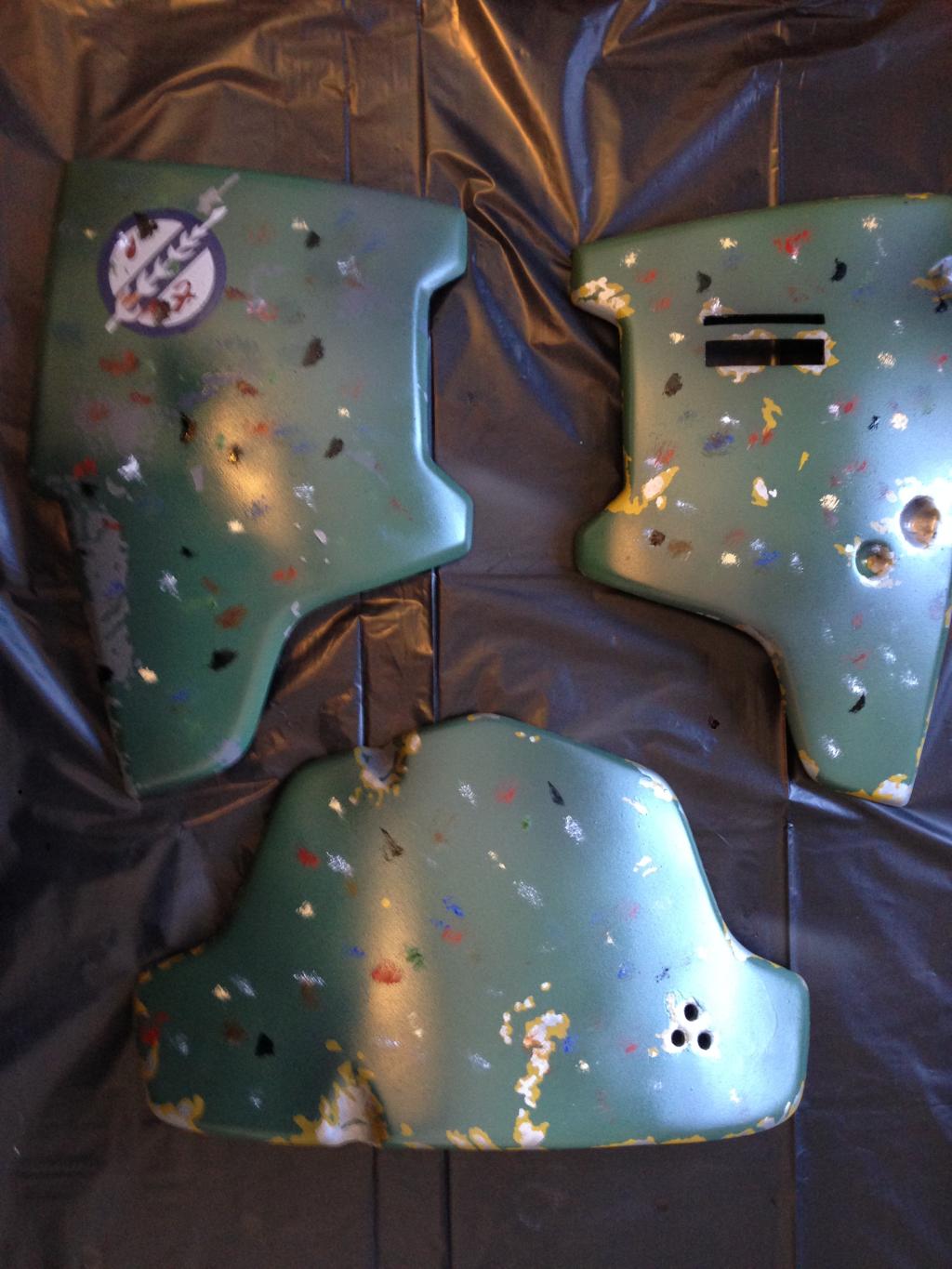

I dispensed some oil paints in various colors onto a piece of cardboard. I left it to sit overnight.
By the morning, the linseed oil in the oil paint had seeped out. This will allow the oil paint to cure much faster. Oil paint can take weeks or months to cure, so this really helps speed it up. I have a small stiff bristle brush for applying the oil paint to the armour, a wider brush to spread the paint out on the armor, and a tub of turpenoid oil paint thinner to clean the brushes.

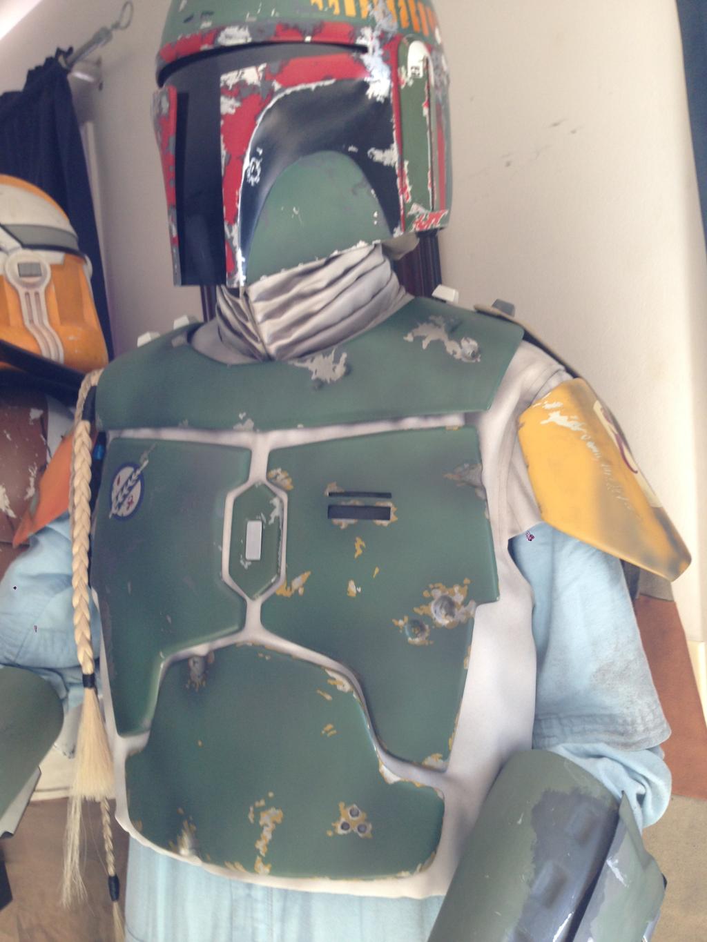

I dot the armour randomly using a variety of colors. I use brighter colors for the lighter toned armour pieces (right chest, abdomen, codpiece, and kidney plate) and tend to use darker colors for the darker toned plates (left chest, collar, and backplate).
Using the wider brush, I load it with a little turpenoid thinner, then spread the oil paint dots around, tending towards a downward stroke to simulate rain marks and dripping stains on the armour. The terpenoid thinners dissolve the oil paint. Most of the oil paint will end up on your brush. You want to take off most of the color.
The variety of colors adds some different tones to break up and add interest to the wide swaths of green paint. The stroke of the paint resembles rain marks and oxidation of the paint. Combined with the airbrush acrylic weathering I had applied over the green, it creates lots of visual interest and realism to the armour paint.
Here's the armour after only a half hour of drying. I'll let the paint set up for a few days before I do a couple final protective coats of Testors DullCote. As well, I might use a terpenoid Q-Tip to clean off some bits of the paint chipping to bring it out from the weathering on top of it.

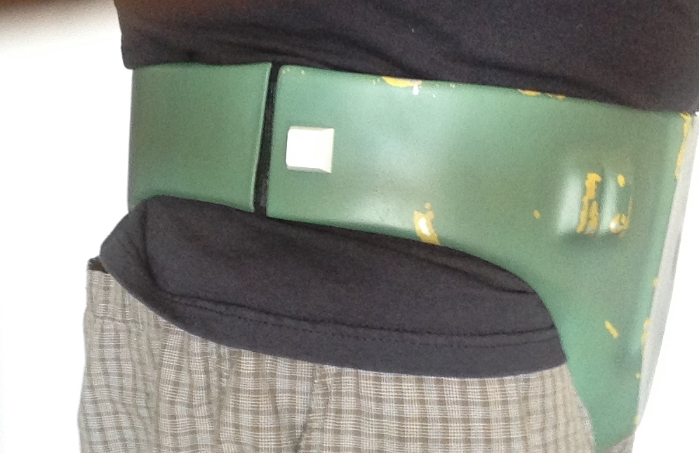

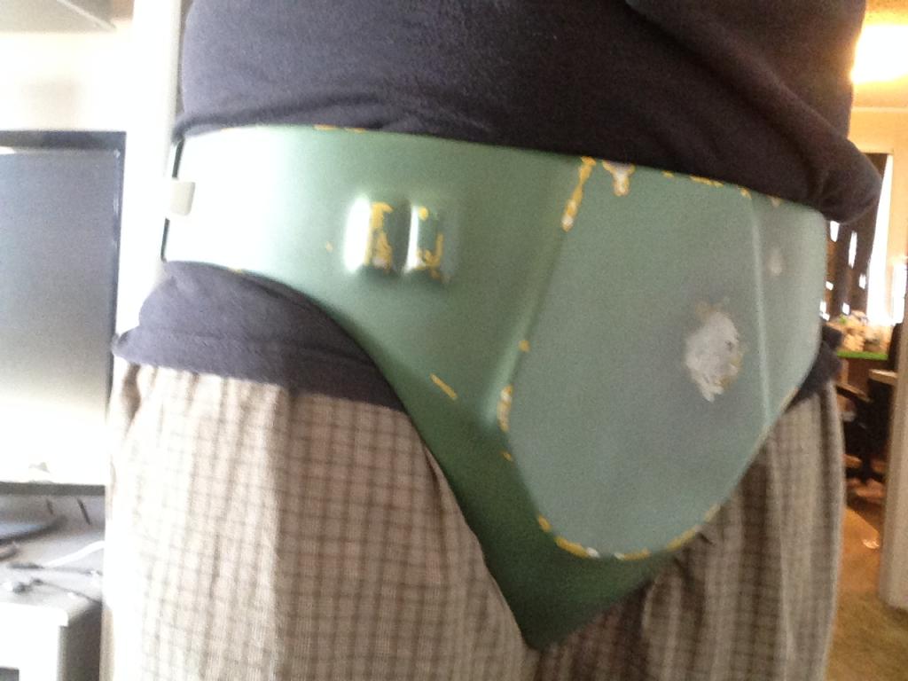

I also did the kidney-cod connection too. I ordered a set of keypad bolts from DarkSide that I've been using for the chest-back connection. These two have been sitting in the spares bin until now. I glued longer ABS plastic flaps behind the ends of the codpiece; these flaps will velcro to the kidney plate to connect them. The keypads are bolted through the codpiece and the ABS velcro flaps.

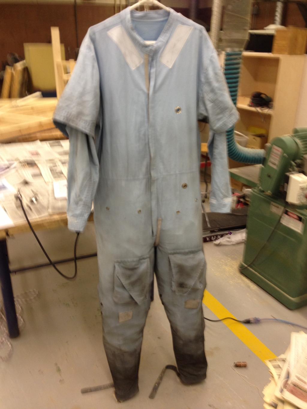

I weathered my flight suit over this long weekend we got from work. On Thursday after work, I went to the shop, threw a rope over the steel refers in the shop area, and hoisted up my flight suit. I had stuffed it full of newspaper to bulk it out, so I wouldn't get any sort of weathering 'seam' (different on the front vs the back).

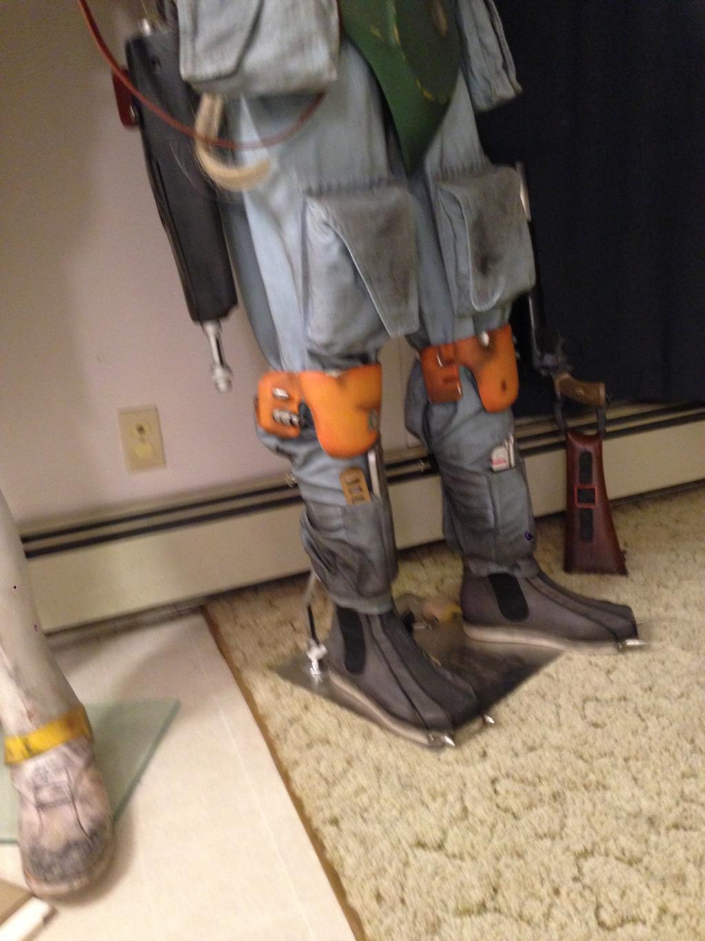

Over the course of the next 3 days, I used my big single action airbrush to spray some craft acrylic paints (thinned with airbrush cleaner). I had printed out several pics of the ESB suit from our gallery here. I did have it pointed out to me that on the calves, I needed to darken between the Velcro cuffs and about half-way between the shin tool pockets. As well, I had to got higher on the sides of the legs, versus keeping it lower in the front and back of the legs. I used mostly gray on all the pockets and upper legs. The lower legs were mostly black, with a few mistings of brown. The torso and arms were evenly split between brown, gray, and black, but I kept the weathering much lighter in these areas.

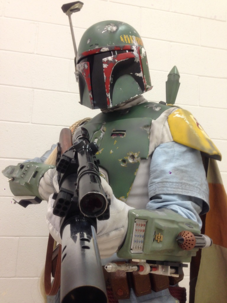

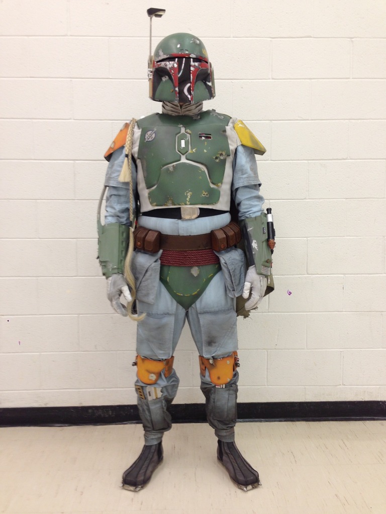

I think it's done! Opinions, changes, etc. are most welcome, TDH-er's. Barring any issues, I'll be taking my 501st Submission pics next weekend.
'Done'. Famous last words... ;)
It looks great! If you want a little feedback the cod looks kind of low I think because the girth belt is not over it. It may be the lighting, but the ammo belt could probably be a little darker brown. Those are minor things. Great work.
Yeah, I can't get the girth belt properly around my cod and kidney when they're assembled, since I'm a little larger than the mannequin around there :D. Trust me, it fits me much better than the matchstick mannequin, LOL.
I already have the dark brown leather dye for darkening the belt. I had totally forgot about doing that, great suggestion!

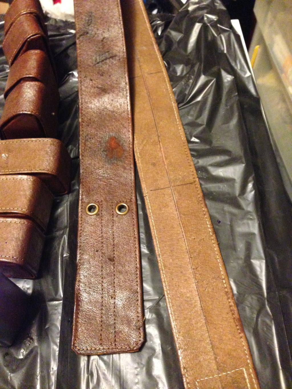

So I dyed the ammo belt tonight after I got home from work:
On the right is the original leather color on the belt. The left is after a coat of Fehling's medium brown leather dye.
Again, the un-dyed backs of the ammo boxes are on the right. In the centre are the ammo boxes after their dye job. On the left is how I corrected the problem of the dyed laces seen on the centre ammo boxes: using a fingernail polish pen applicator, I hand-painted each individual stitch on the already-dyed left two ammo boxes.
