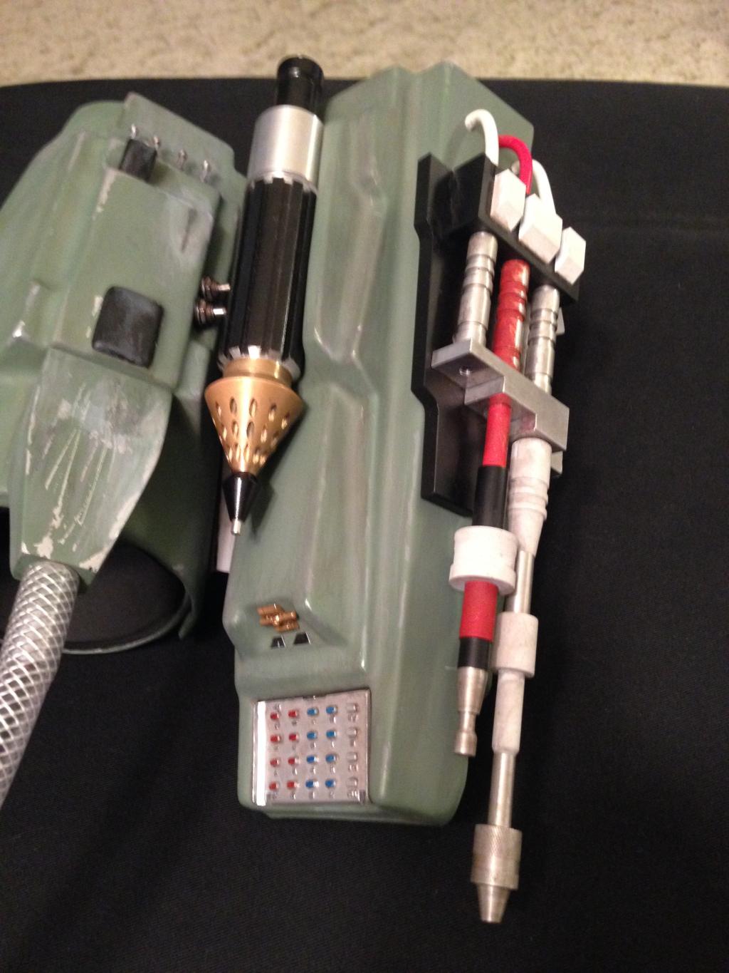

The he left side gauntlets have an aluminum flamethrower and a full metal gauntlet rocket right now. Definitely as heavy, maybe heavier than the original gauntlets. I will paint up the resin RKD gauntlet once I can open my window to airbrush the paint safely.
We have a warm spell coming up this week, so I'll be able to airbrush my gauntlet rocket. I'll also finish the silver on my Pulce sidearm while I have the aluminum paint in the airbrush.

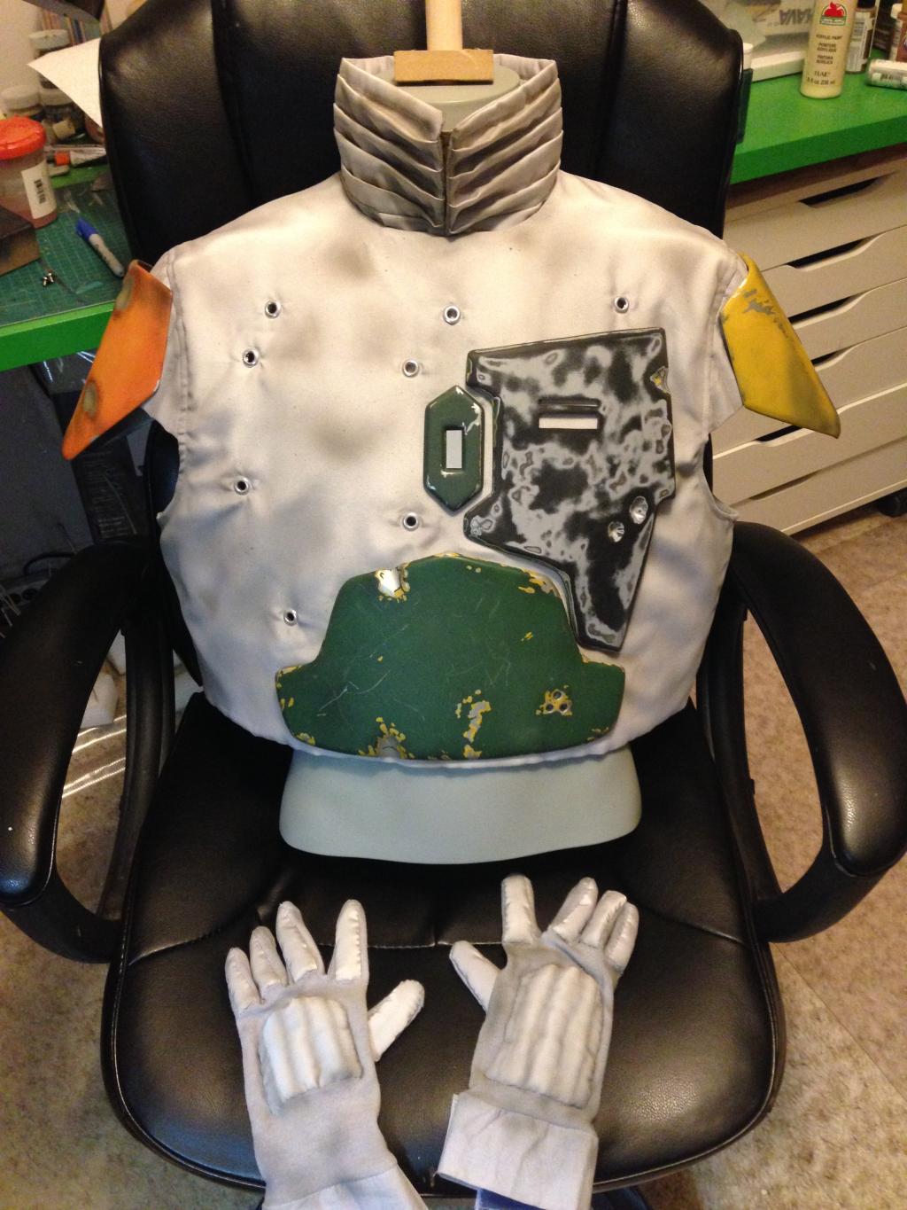

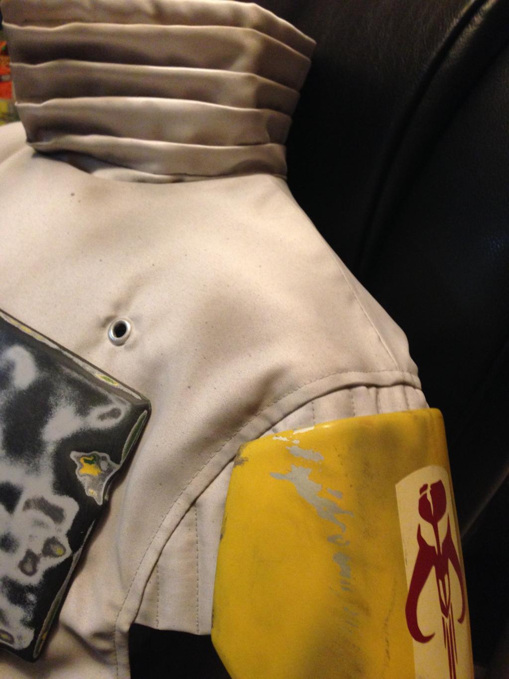

I will ill use this opportunity to weather my gloves and flak vest. The Armor is removed, ready to get sanded down. I weathered my old Arkady vest with black and brown through the airbrush. I went in between the quilting on the shoulders, and darkened the cloth around the armor plates a touch. Should I replicate this, or try to get it to look a little more like the PrePro2 vest? It's been weathered with gray, applied in a really blotchy pattern, as seen in SW Costumes.
i just airbrushed Mr Hobby's copper metalizer paint. When it dries, you can buff the paint up with an old shirt, microfibre cloth, or eyeglass polisher cloth. I hope it's durable enough to leave this cool satin finish.

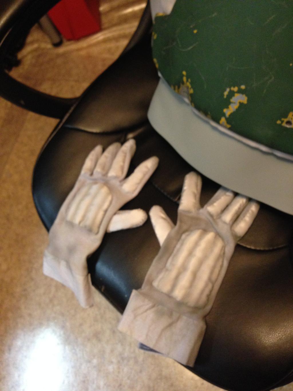

i decided to just go for that blotchy gray finish to my flak vest. I had not weathered the matching neck seal yet (both made by bat ninja shortly before his retirement) so I weathered it as well. My ESB gloves had no weathering yet either, so it all got done tonight. I airbrushed a light gray, a medium gray, and a brownish medium gray randomly over the vest. I did line the quilting on the shoulders and the quilting on the gloves, and dirtied up the glove palms and fingers.
i added some splatter to the vest, just for a little texture.
Gloves!

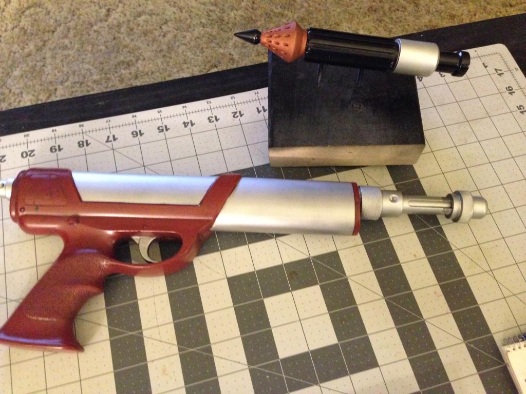

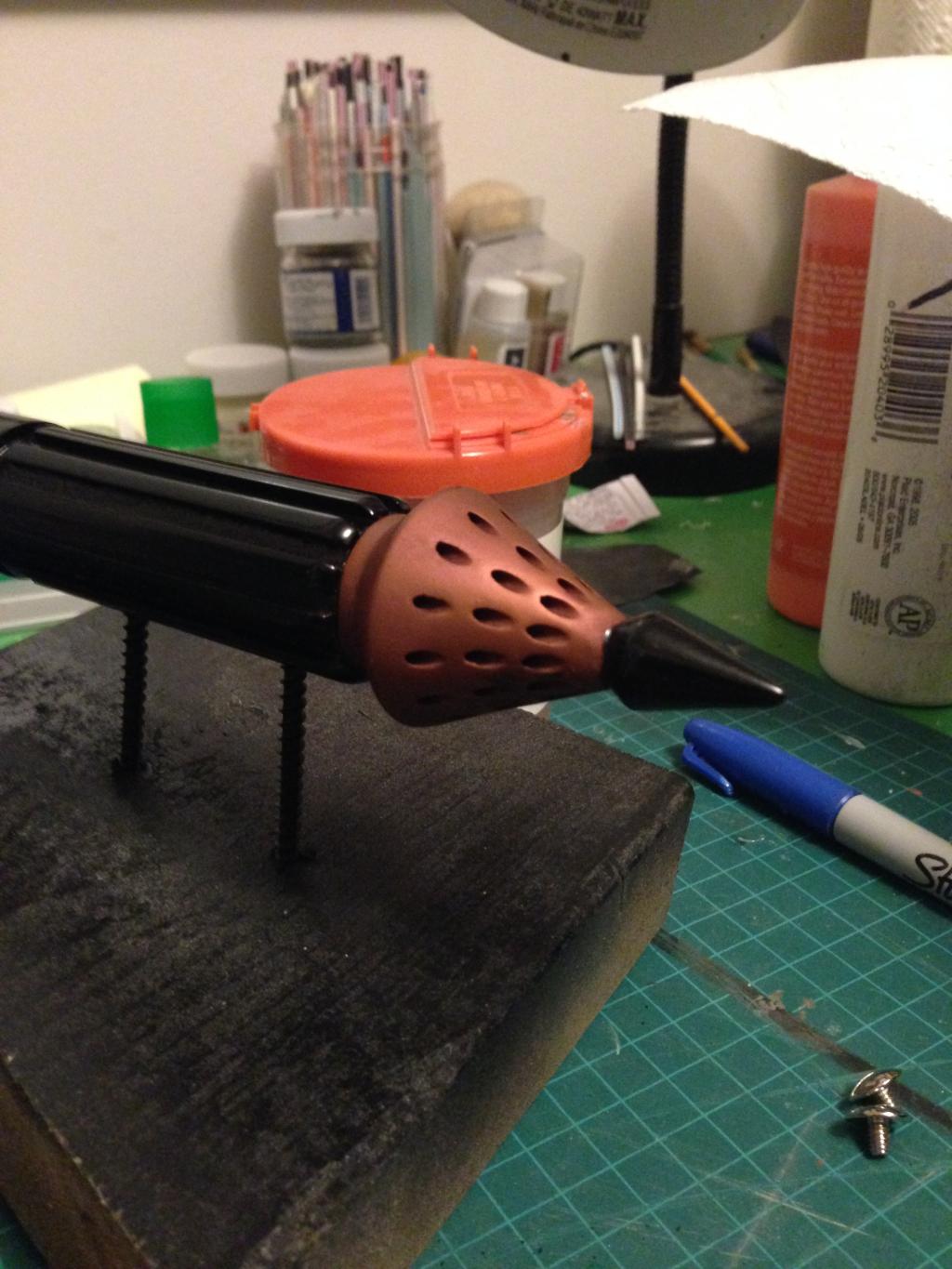

Here are a couple plastic parts that I finished. I finished the gauntlet rocket with the silver at the back of the rocket. As well, I finally finished up my Stormrider foam-filled sidearm. I had it painted with regular (red oxide) primer, weathered it, then painted a couple coats of gloss black where the silver paint would go. After I polished all that black paint, it kind of sat around since around May. I finally masked it up and painted it with a chrome silver Mr Hobby metalizer paint. I left it un-buffed, for the brushed look. Both parts need a little touch-up and weathering.

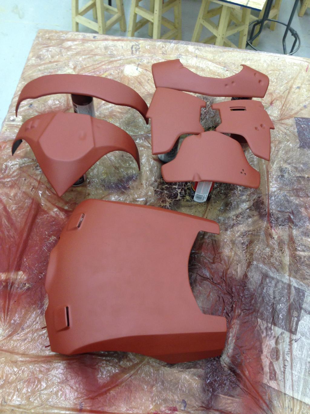

All my armour is now ready for primer. I sanded a piece or two every night this week by hand down to primer/bare plastic, finishing with the giant back piece tonight. As well, my Lucksy31 chest decals and stencils arrived in the mail today. I'm going to try painting the chest emblem on, but I bought backup vinyl decals, just in case.

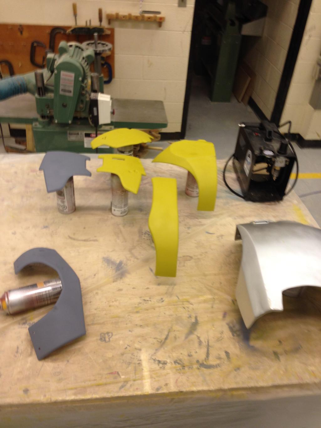

I use DupliColor adhesion promoter whenever I can when I am painting over plastic. I used to use it over resin as well, but it's a habit i need to get back into, IMHO. I sprayed two coats of it a few minutes apart before laying down some red oxide primer. It dried for about 24 hours.

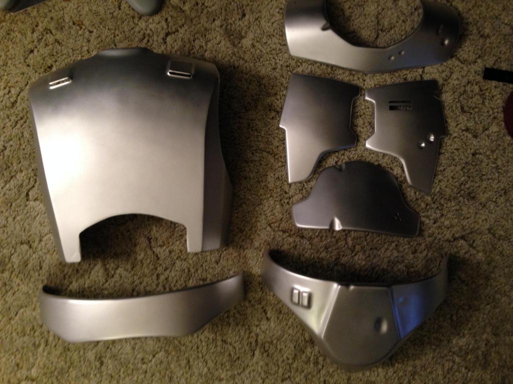

24 hours later, I shot all of my parts with Tremclad Silver spray. It coats really well really quickly, and creates quite a nice shine. It fools the school custodian into thinking it's aluminum or steel. I truly hope that that is a sign of how good the paint looks, and not something else... :unsure I let this harden over the course of the next five days.

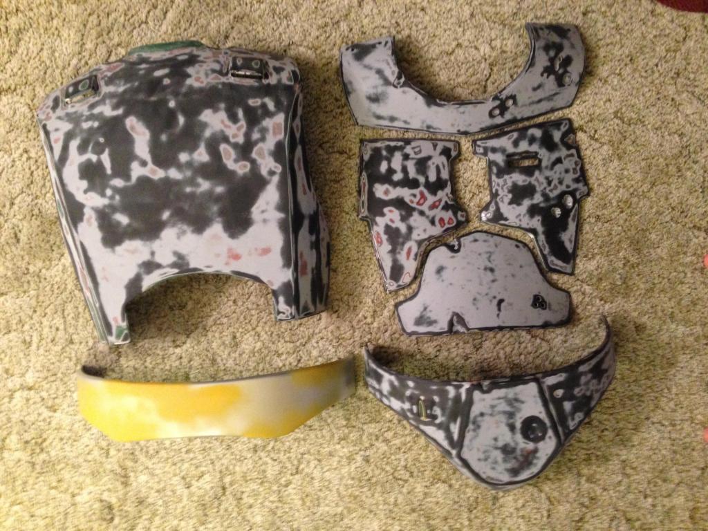

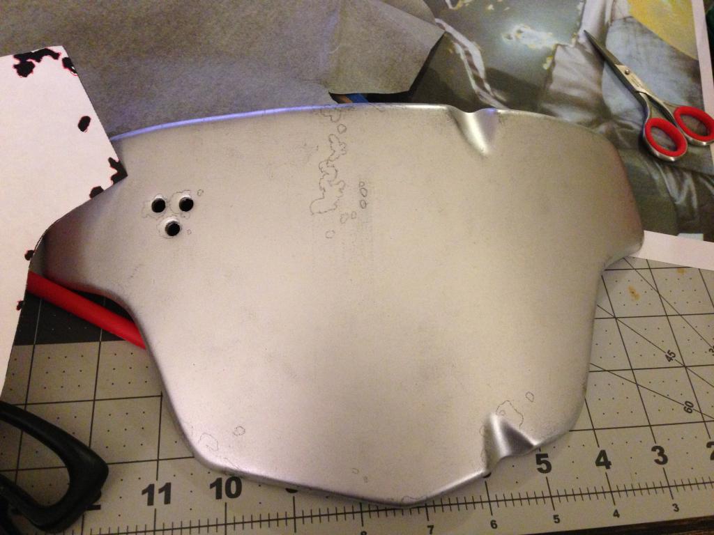

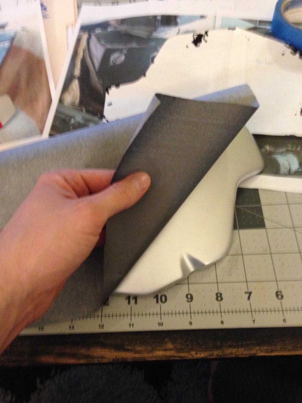

Over that 5 days, I go out the paint templates from RafalFett and started masking the silver paint chip damage. I first taped down a piece of Saral transfer paper to the armour piece, then taped down the paint template. I used a ballpoint pen to trace out the damage outlines. Unfortunately, the transfer doesn't stick to the glossy smooth silver paint underneath.
The transfer is barely there. In the right light, it is sort of visible. These areas were masked in using Winsor & Newton latex masking fluid. I had the template and several reference photos around to aid me.

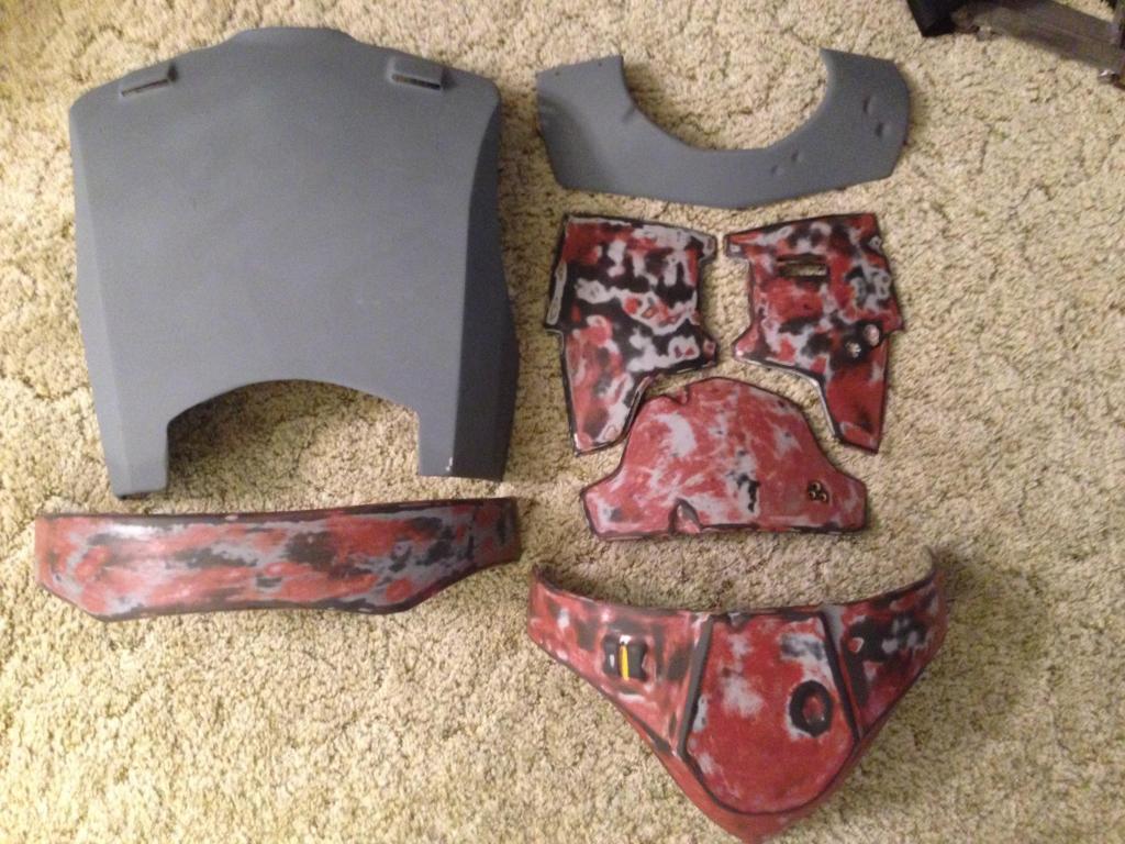

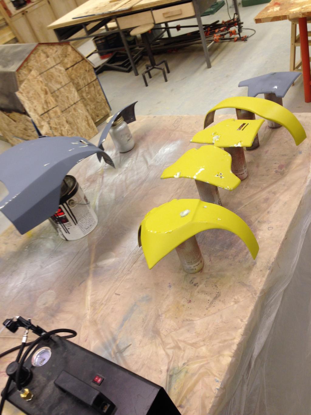

I used Testor's Zinc Chromate paint on the codpiece, kidney plate, left chest, and belly plate. Not just where it will show through the paint chips, the entire piece. It's like $1 a bottle, so why not?! I am hoping that it will slightly lighten the green paint that will go over it.
The right chest, collar, and backplate are getting a Testor's medium gray coat. It's a pretty near perfect match to Humbrol 117 Gray, as used by Darth Voorhees on his summer ESB repaint (Now for sale in the Cargo Hold). I just checked, and it's really close to SP Lark Dark Gray, the recommended color from the paint stencils.
I thought that the gray paint I had chosen here would make a great 'base metal' color, but it looks like it will need a little lightening first. I'll spray that, and finish spraying the backplate tomorrow. I'll likely let these colors cure until after Christmas. I will unmask them and re-mask for the green paint stages, which will happen after Christmas.

Well, that didn't work. While the gray paint stuck on the silver layer okay, the yellow would scratch and peel off if you looked at it wrong. So I sanded those parts back down to bare plastic:
Warning signs that the silver paint wouldn't take layers on top started with the tracing paper residue not sticking so well. Warning sign #2 was the liquid masking agent would bead up, not conforming to the stencilled shapes on my armour pieces.
This time around, I'll try RKD's trick of a shot of DullCote over the silver layer to make everything else on top stick just a little better.
I sanded down the right chest piece because I had sprayed the dark gray first, when I probably should have done the lighter 'base metal' gray first.

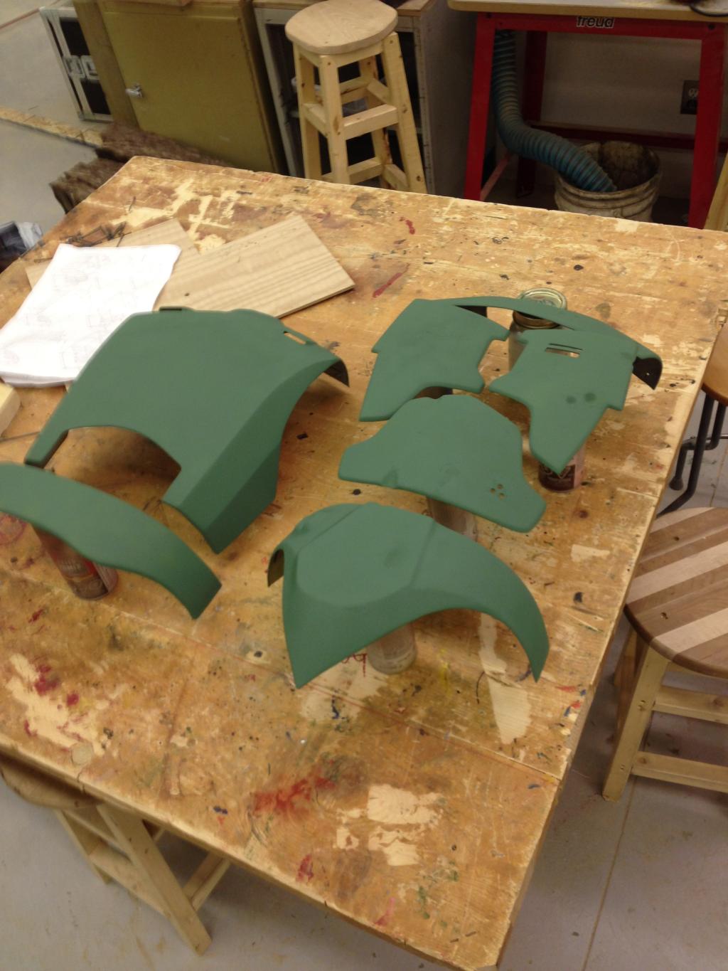

It's still Testers Yellow Zinc Chromate and Medium Gray from the rectangular glass bottles. I spent about 3 hours in the shop this afternoon, masking the battle damage for every piece.
This is Darth Voorhees' ESB green recipe: I used two bottles of Humbrol 76, 2 bottles of Humbrol 78, and an equivalent volume of lacquer thinner. This makes over 100 mL of paint, plenty enough for all of the green armour. It was airbrushed through my dirt-cheap siphon-fed single action Badger airbrush.
I love the colour! I have a crap-ton of Humbrol 76 and 78 left over, in case it needs a misting of 76 or 78 to adjust the color. I know Lou added just a tiny bit more Humbrol 76. Suggestions are welcome, members!

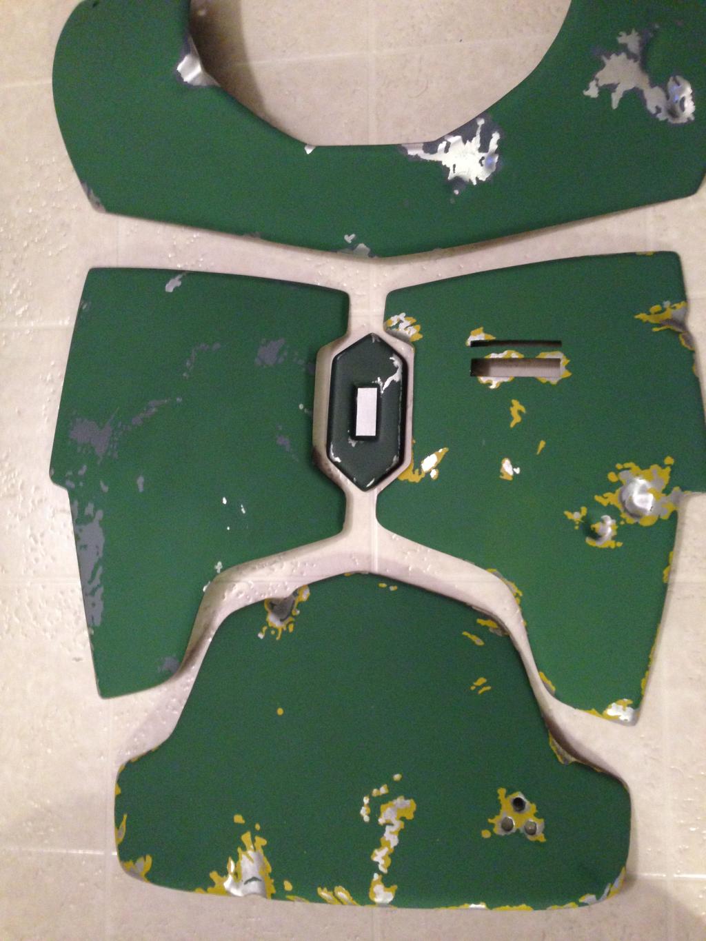

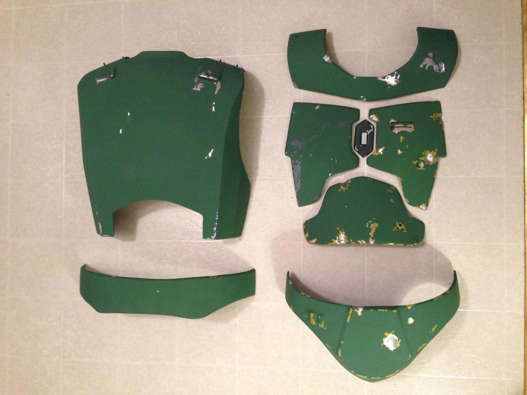

Here's the results of the repaint:
Overall, the color & tone is pretty good, but I am hoping that the weathering will darken it a little more. I spent the last couple days touching up the yellow and green, trying to match screen and Raf references as closely as possible. I'll clear-coat it and start on the weathering this weekend.
Looks like I'll need to repaint my centre diamond. It's straight up rattle-can Hunt Club Green, but it looks WAY too dark, compared to the armour. I do have some CNW Green around here... However, I'll wait until the armour is weathered before I commit to that.

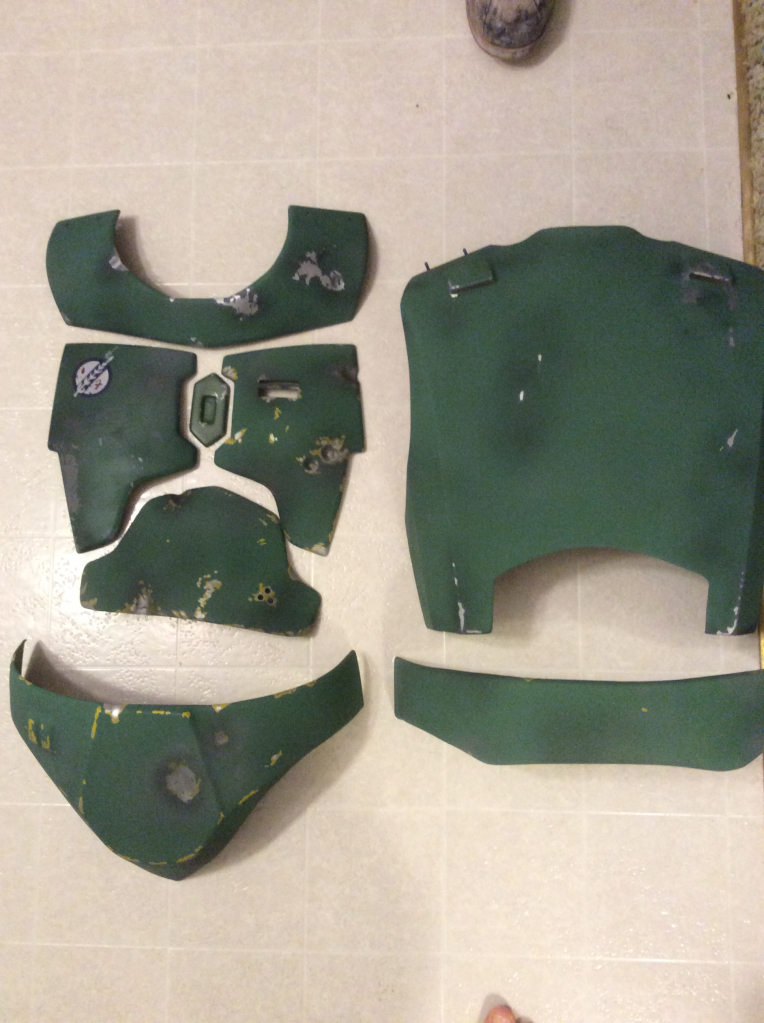

So I used Humbrol silver on the right chest & centre diamond, then went as usual from there: light gray, dark grey, then the green mix. I then gloss-coated the right chest plate before applying a Lucksy decal. I did a little green paint weathering on it before sealing the decal on with some Dullcote.
Tonight, I did some black and grey airbrush weathering. Do I need to pull it back with a little more green again?
