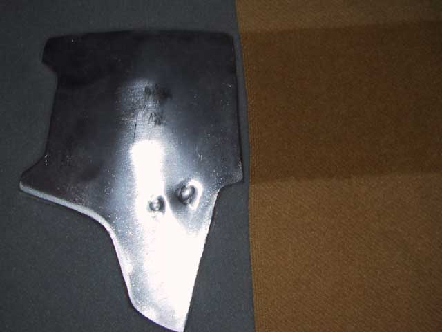

ESB Cape...could this be close?
Hey all. I've got this blanket that kinda has me wondering if it or something like it might have been used for the ESB cape.
Here's a shot of the stripe laid next to my unfinished aluminum armor for size reference:
Things that bug me about it are the fabric texture and color. But then again, the ESB cape looks different in the movie and every promo pic I see...
I don't know, I'll probably just go back to dying the stripe on flannel again...
...but what do you all think?
It actually looks pretty good to me.The lighter areas could be a bit more lighter,but it's not too bad,and it's near impossible to tell the texture of the ESB cape so some creative liberties are certainly expected :) I'd use it if I were you.
Steve
Hey, that does look good, and if it's not 100% ESB accurate, it would still work for Jodo. Where'd ya get that MaxPlague?
Oh, forgot to mention...it's a vintage Hudson's Bay blanket. Got it on Ebay awhile back.
I think I saw that auction, or one extremely similar. The one I saw wasn't too long ago, though.
I have seen pictures of old Swiss army blankets that look like Boba's. I've never seen one in person, though.
The blanket itself is 72"x90". If I were to cut it to cape size it'd be about 27.25"x35".
Just my two cents, but if it is indeed a vintage Hudson's Bay, it is worth more "as is". This, of course, depends on how "vintage" and it's condition.
