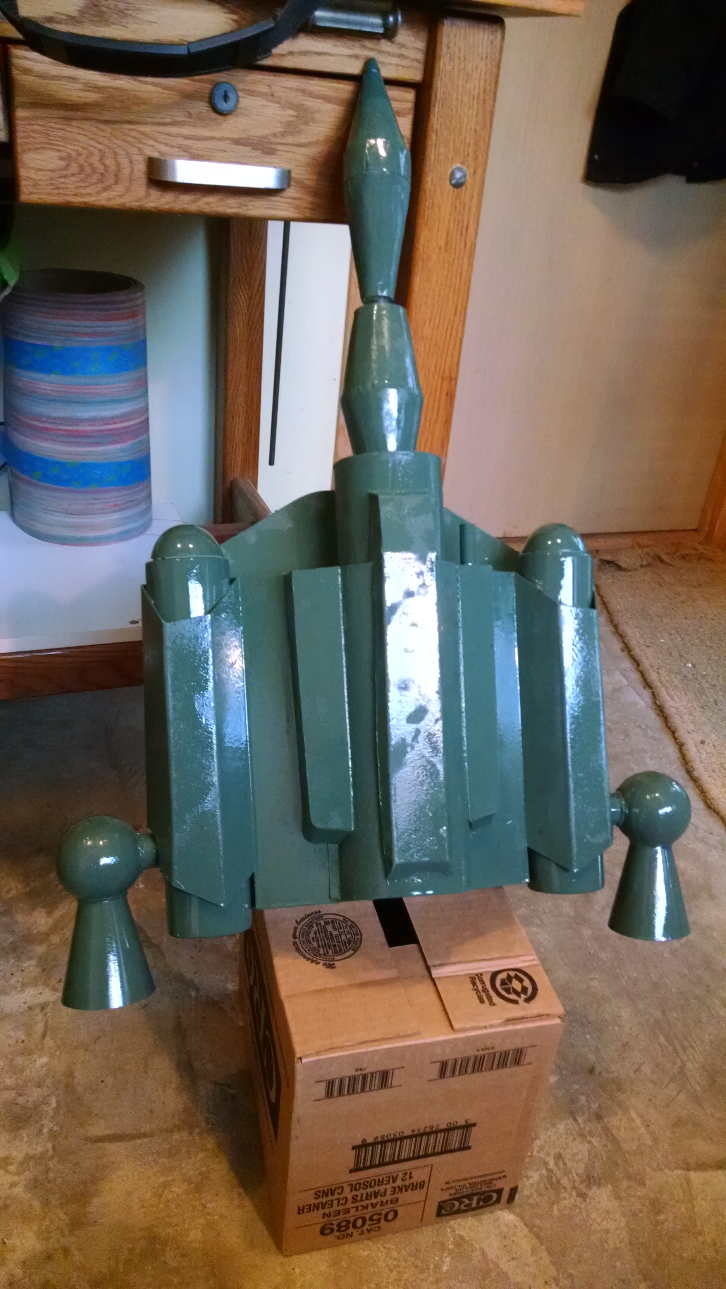

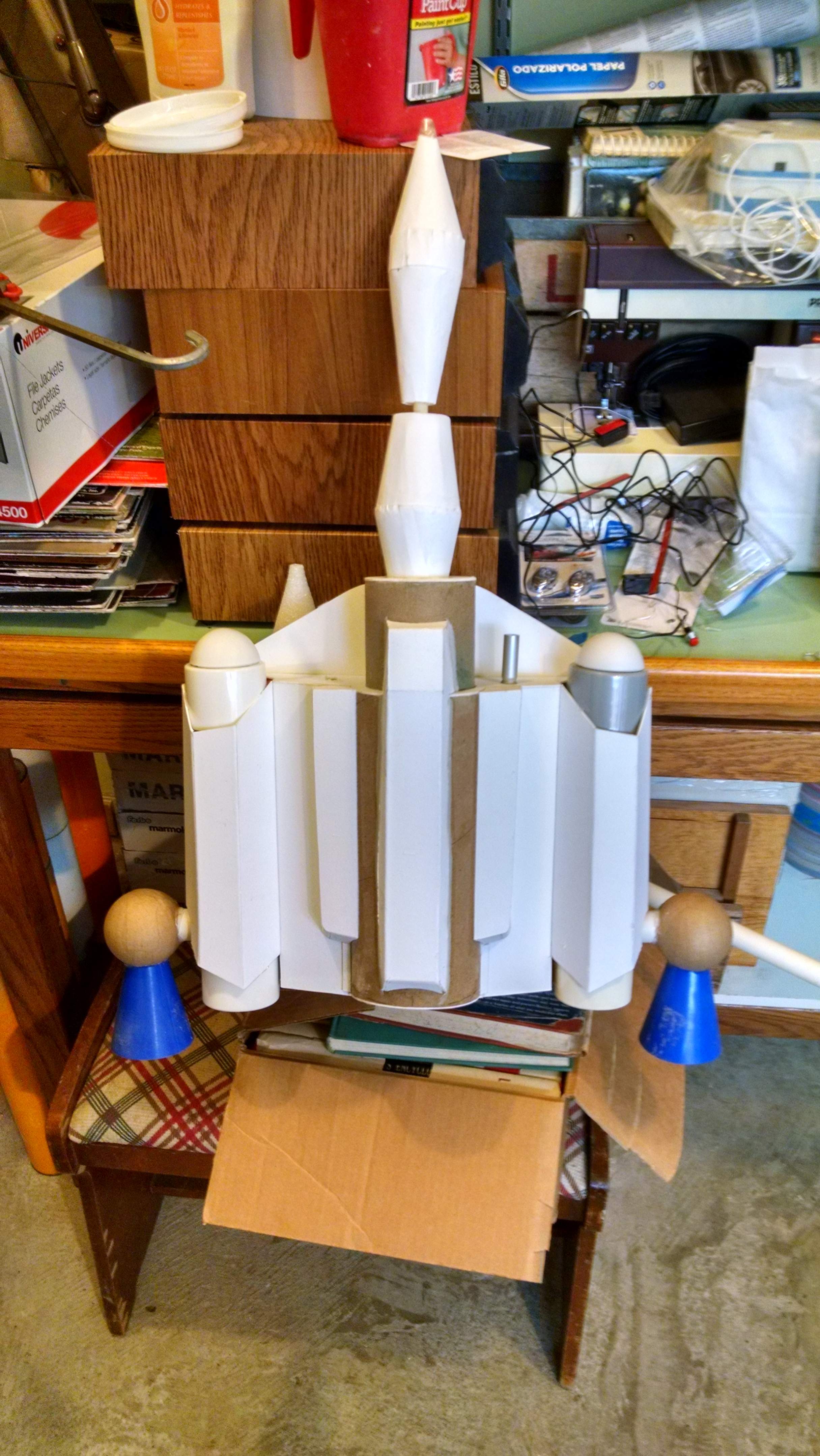

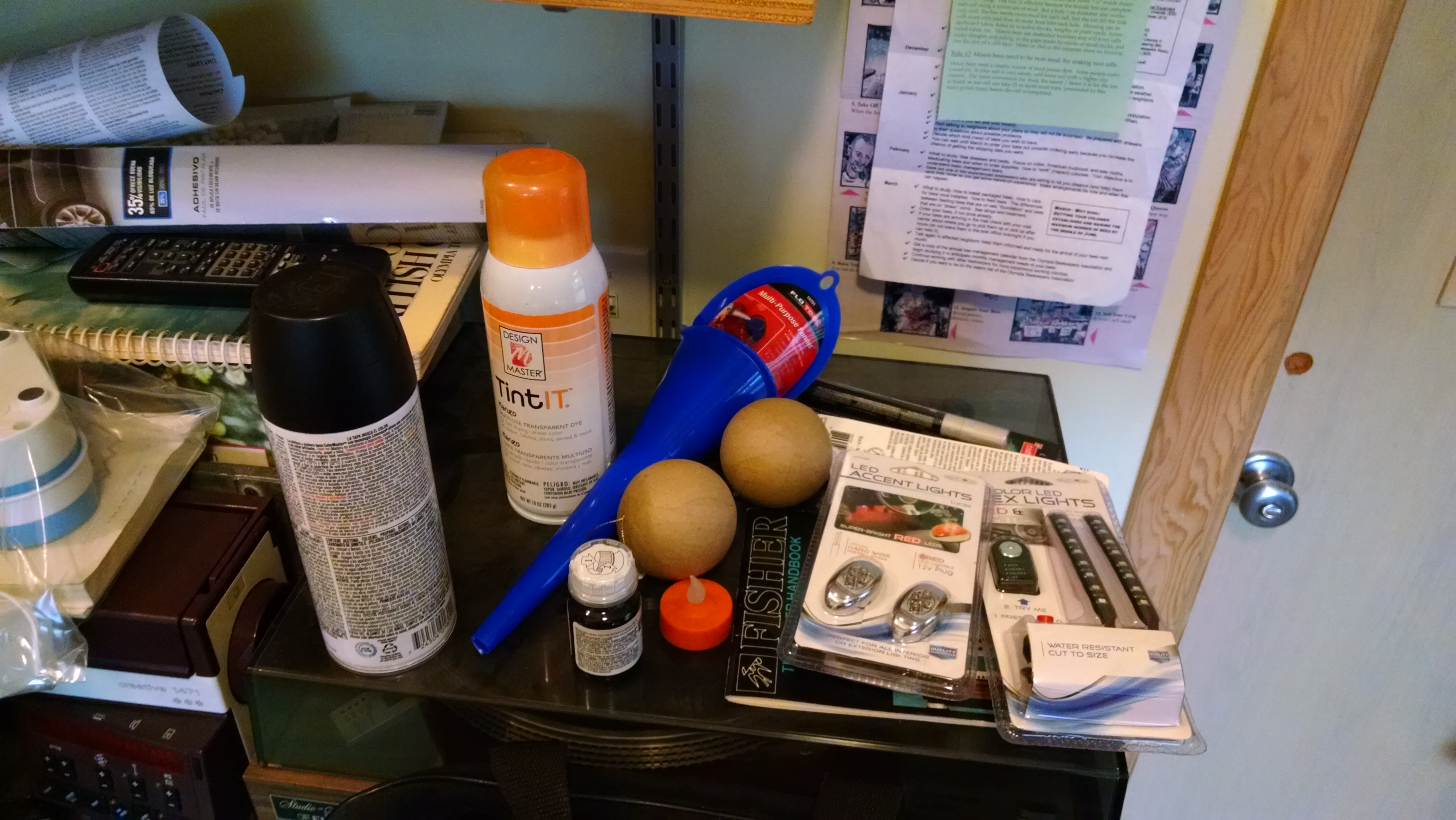

I built my jetpack in 2 days using Alan Sinclair's templates. I used a mix of illustration board, foam core, and cardboard shipping tube for the main structure. The missile(?) cone parts are styrofoam craft store cones wrapped with crardstock. I was in a time crunch and so used spray paint can lids for the top/bottom tanks, with rubber wall door-knob bumpers on top. The jets are 2.5" craft balls (for ornaments) with auto fluid funnel cones, affixed to a 1" pvc pipe using a mix of hot glue and poly spray foam. Painted using the same colors as my armor. For now it's worn via a strap around my neck, not comfy but it only weighs 2 lbs, 13 oz.
For some fun, I added a metal tube with slots for the beacon to the top, and found a LED light kit at the auto parts store to illuminate it and my right gauntlet. The kit is designed for 12V but works just as well on a 9V battery. I carry the battery and control in my right hip pouch. The control allows both red and white, just red, just white, or none.

Some of the supplies I used:
My jetpack before painting:
Hunter Green base coat:
