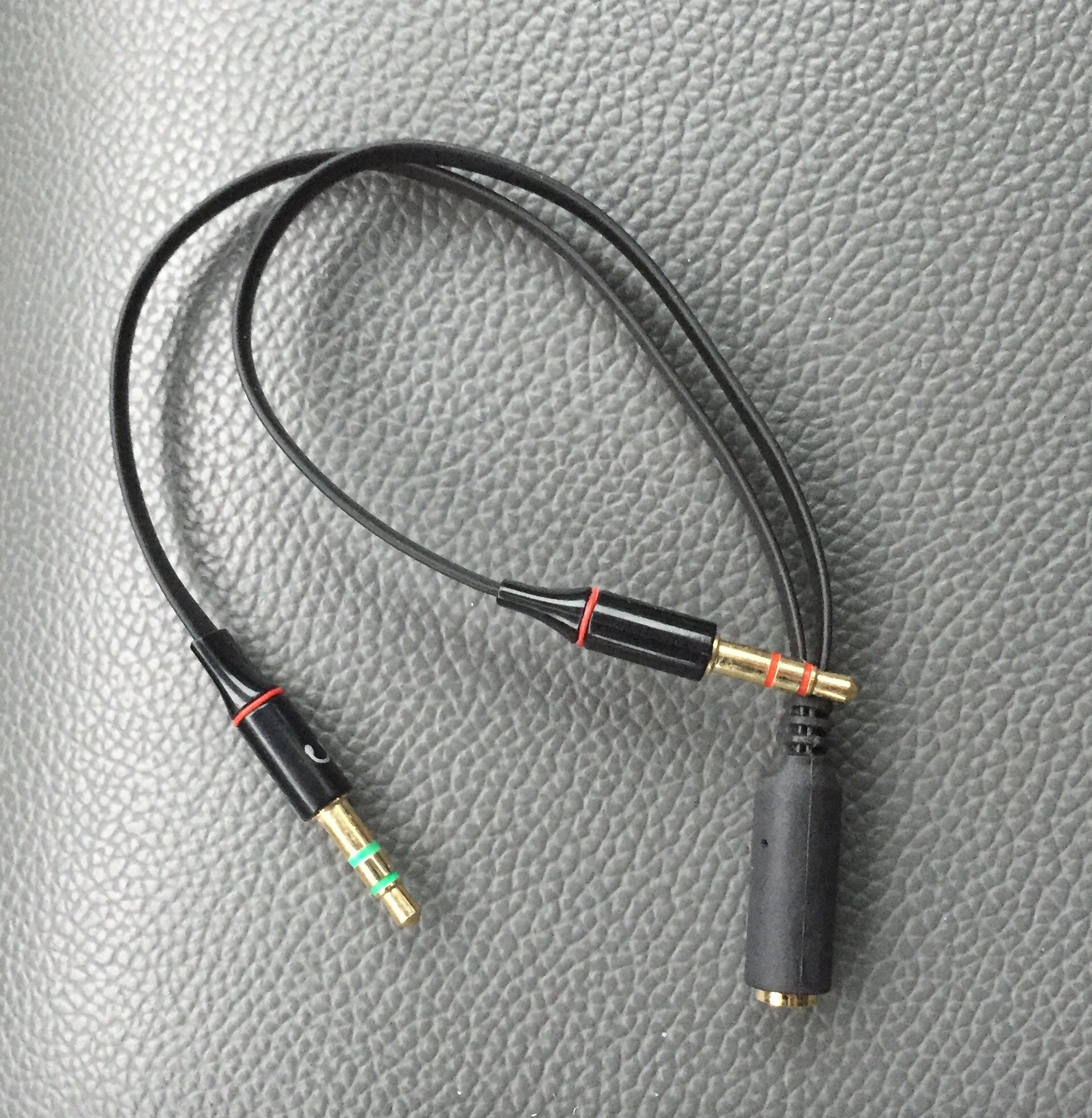

I ordered a 3.5 Y splitter from Amazon but I think I ordered the wrong kind. It has two male plugs and one female:

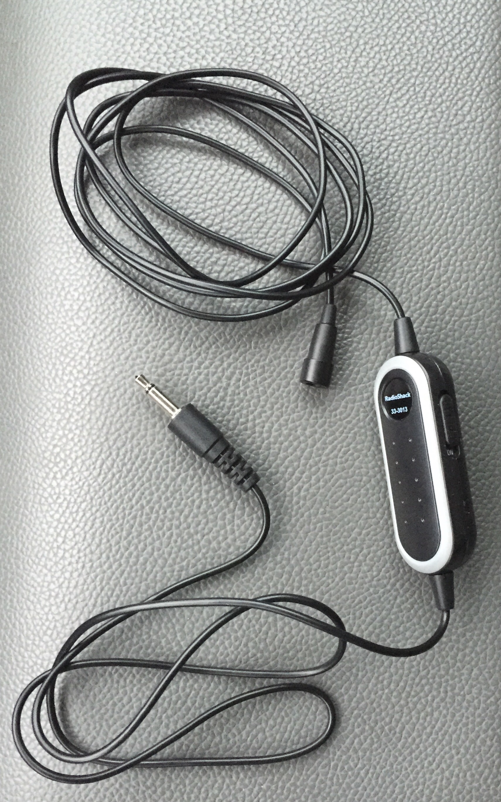

I went to Radio Shack and picked up a 3.5 clip mic:
I tried to put it all together, even with the Y splitter as it is and it all seemed to work except the sound coming out of the external speaker was so quiet, even with its volume and the volume on the phone all the way up, I could barely hear it!

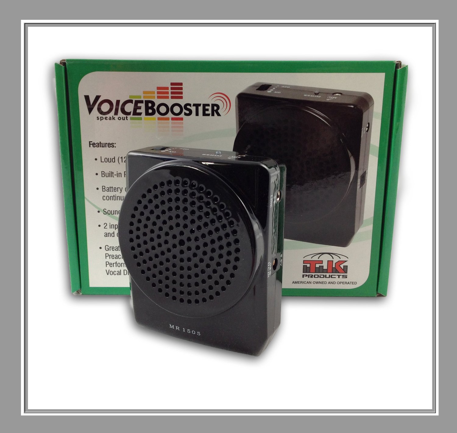

For the speaker you honestly want an Aker...hands down. It comes with a rechargeable battery and puts out a lot of volume. If you want absolute screen accuracy Boba Fett's speaker was actually strapped to his chest behind the armor as stated in the prototype screen tests...something that would be hard for you to do with your bluetooth speaker.
Aker link
I got mine off of fleabay with shipping for about 27$.

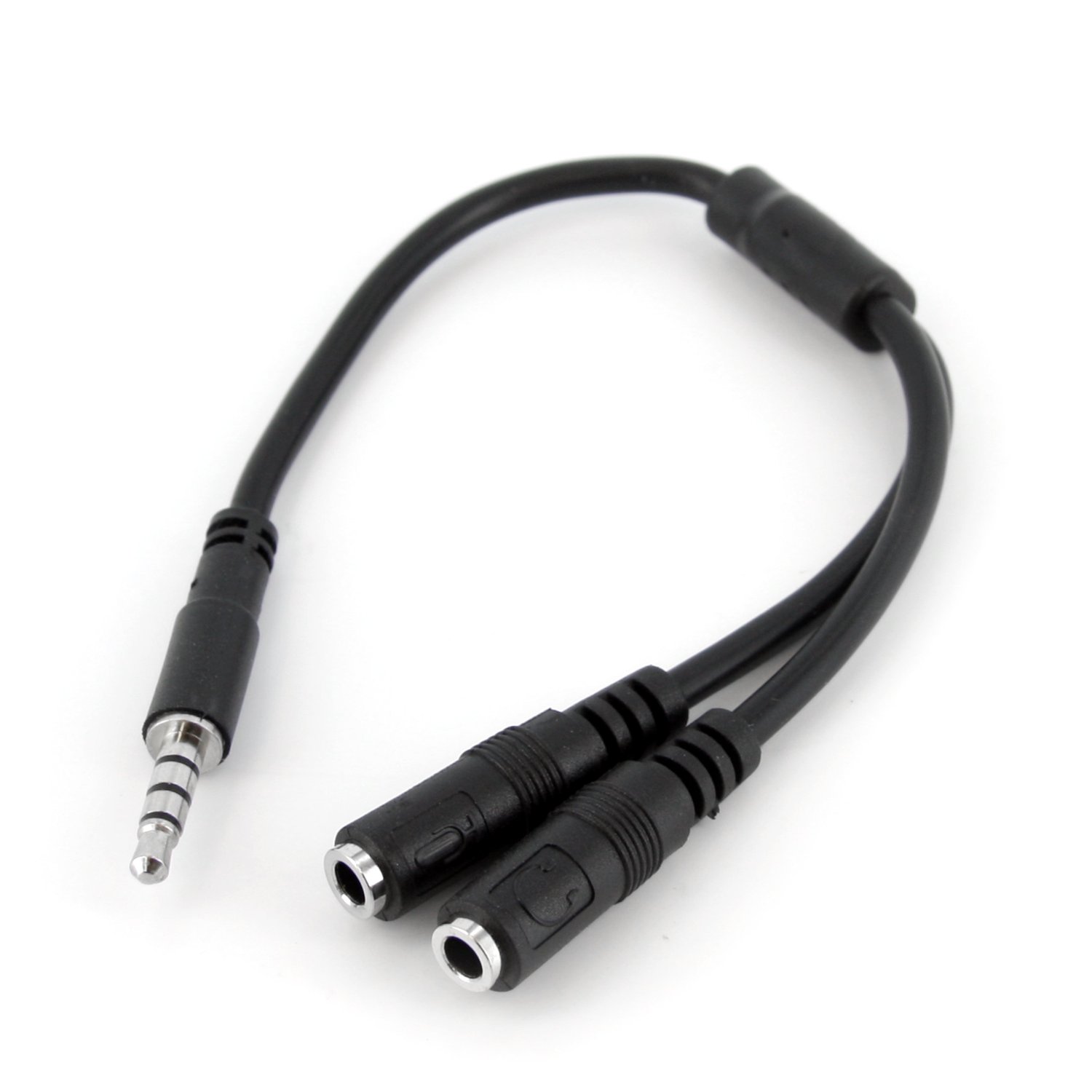

You got the wrong spliter from Amazon. You want something like this (link)
The Mic from your headset goes to the mic female connector on the splitter. If you want to hear what you are saying get a Y splitter like the following and attach it to the headphone connector on the splitter above (link). One of the female plugs would connect to your headset piece, the other would connect to the Aker audio cable.
The aker comes with an 1/8th male to male audio cable which plugs into the Aker. At that point you are off to the races.

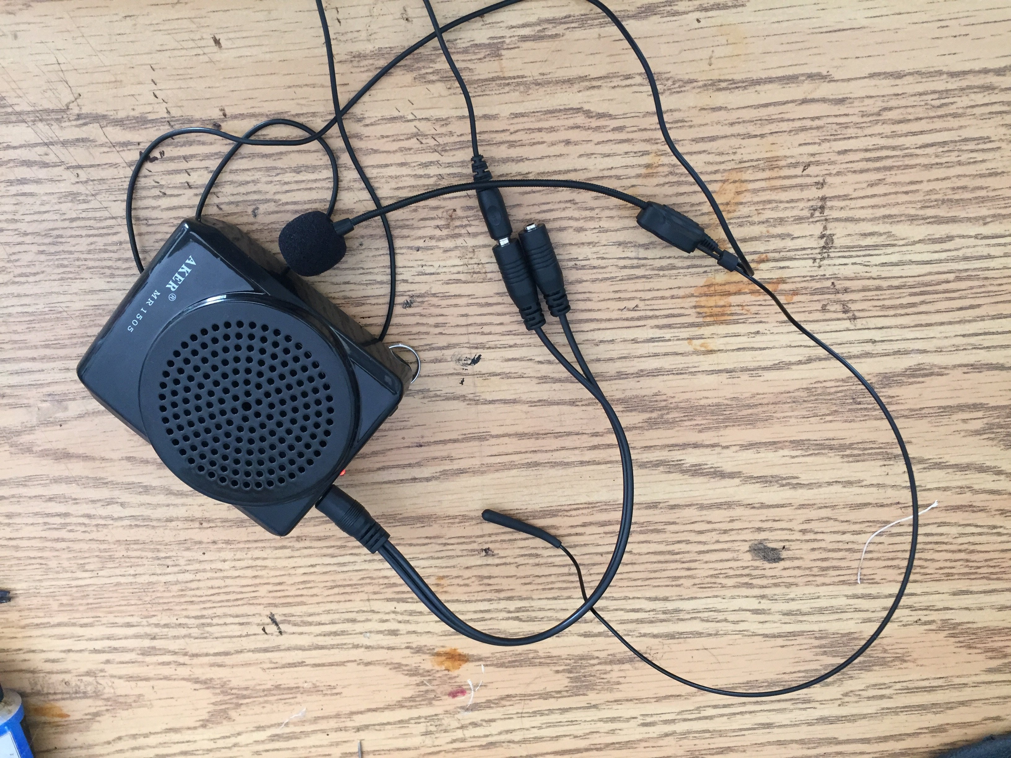

So I have:
- an iPhone6 running the Pro version of the VoiceSynth app
- a 1505 Aker
- a single male with two female Y splitter

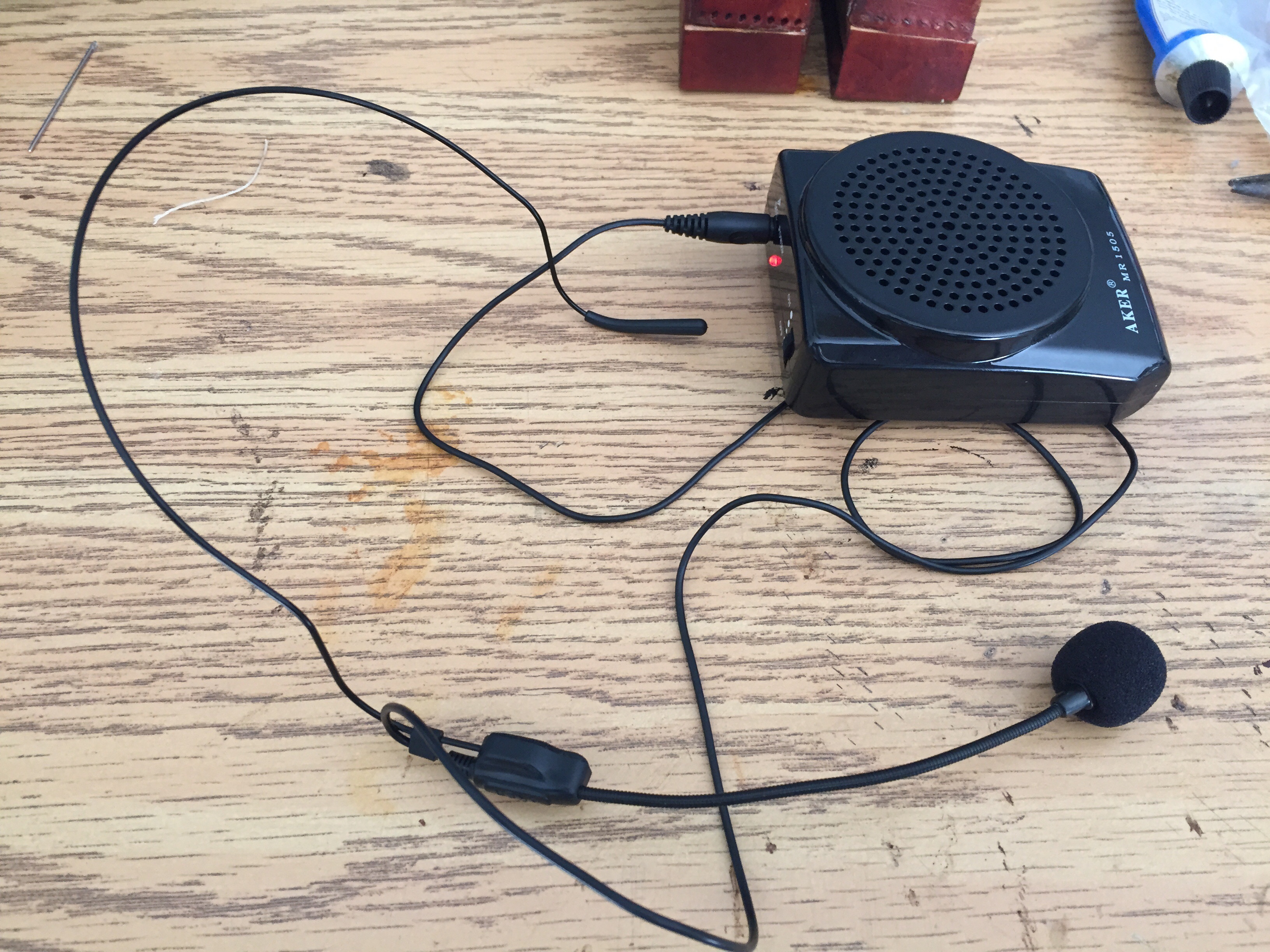

- both the under ear headset mike that comes with the Aker
- and an under ear earphone/mic head set with a built in volume control and answer phone button
I went with you previously posted suggestions exactly. It seems that the set up should work beautifully if I knew how to eliminate the feedback but alas, mondo feedback.

Ok. I used the simple under ear mic for testing. I hooked up the mic directly to the Aker. It worked.
I hooked up the mic to each port of the Y splitter and the splitter to the Aker and it worked as well.
This would seem to indicate that the Aker, the mic, and the Y splitter are all working.
I then hooked the mic directly into my iPhone6 and tested it on the voice memo app and it seems to work.
I used the Y splitter as well with the iPhone and it still worked. I'm stumped.

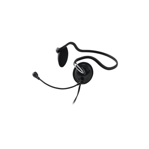

Hey,
I told you before what you needed and you did not purchase it. You instead bought an Audio Y splitter which is incorrect for your needs. You need a splitter that has a separate Headphone and Microphone jack like the one I linked a long time ago in this article. The Y splitter you have has two black lines as opposed to the three black lines that should be seen on the correct cable.
Incorrect
Correct
Again notice the three lines shown above.
If you have the correct splitter (Note again there should be a separate headphone and microphone jack as pictured in the image directly above) then the splitter you have is bad and you will need to get a higher quality/different one AND/OR the microphone is jacked up. If you have no feedback when the microphone is directly connected to the aker then it's the splitter.
Simply put the splitter's male end ONLY gets connected into the Iphone. The headphone jack gets connected to the AKER via the audio cable (male to male) that came with the Aker. The splitter's microphone jack gets connected to the microphone jack on the Y splitter.
Another note I see you are using the microphone that came with the Aker. It is garbage and will cause feedback due to how poorly shielded the cable is, that is why I linked a headset above. There is a huge difference.
