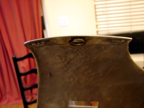

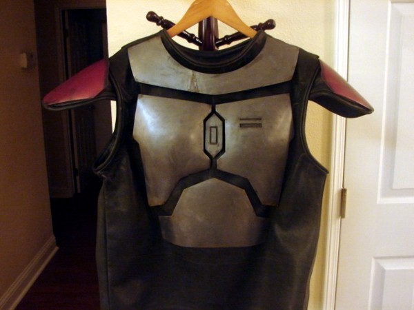

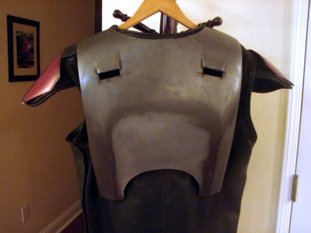

Spent a few good hours tonight putting this fastening system together for my backplate so it kept me from finishing and running a test fit. It looks like it's going to be pretty secure. I decided to give it a try after closely studying the Hammerhead ref. cd pics. and noticing this is how they affixed the original backplate and vest.
A test drive at CIV this weekend will tell me if it works.
Absolutely perfect my friend... that fastening system is THE most accurate, with no doubt ;) exactly the same on the movie, well done.

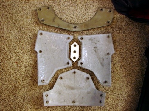

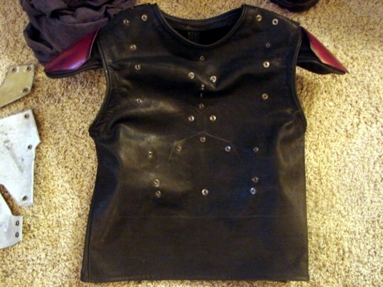

Any chance of a few more attaching pics. I'm interested to see how you attach the BKBT collar. Then I will copy that method! :)

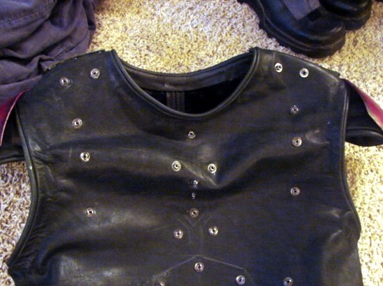

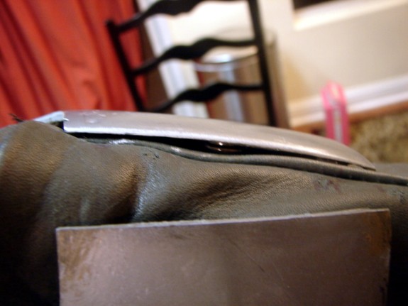

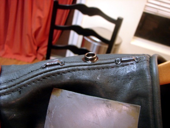

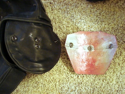

Sure, no problem. I actually had to relocate each tab once which was a pain in the butt because I had placed them too far up the first time. So, I'd recommend setting the snap first on the backplate, then test fit it to someone's back as they are wearing your vest and kinda position it where you'd like it. Then lift just the top off a little, smear some R&B on the snap heads and then press it back down so the R&B leaves a little circle where the snap contacts the vest. Then set the snap on the vest. After that, you can set the hook parts on the backplate, and do the same R&B application for them, using the snaps as your guides.:thumbsup:
Here are those pics. On the chest armor I used Line 20 snaps from Tandy because they hold strong, are smaller in size than the Line 24s, and because they hold the armor close to the vest. On the back and shoulder armor, I used Line 24 snaps because the backplate is a bigger piece and because the shoulder armor will get a lot of movement (the bottom center snap is there because I had the shoulders too low the first time and decided to move them up and just haven't taken the extra snaps off the vest part). I did rough up the backs of each glued snap head by rubbing it on the floor on a piece of 60 grit sand paper. And I also recessed the 3 snaps on the center diamond about 1/16" so it would be flushed and not buldge out.:thumbsup:
Anything else, just let me know.
they are called hem loops or pant loops, something like that. I picked em up in the sewing department at walmart, so any fabric store should have em.:thumbsup:
