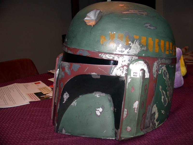

I'm pretty sure those of you who have MSH buckets know what I mean. When fully assembled the mandibles tend to flare out a bit. Not much just a tiny bit.
Is there any way to deal with this?

You might be able to correct that when gluing in your visor. My helmet had a bit of a warp that was easy enough to fix this way. If it is more severe, you can use a heat gun & warm up the helmet & coax it back into shape. I have also had luck with this method.
I don't think heating it will help, since it's fiberglass. I have the MSH2, once I put the visor in it, it straightend up. I just looked a pic of mine I acutally made mine reverse flare, the top is out farther than the bottom. Exbit 1.
Heating it up will soften it even if it is fiberglass. I thermoform polyester plastics all the time & that is essentially what fiberglass is, glass fibers interlocked in a polyester resin. ou can still do this after it is painted if you carefully heat it from the inside. Just go slow & don't heat it more than you have to. I would still try adjusting the warp with the visor hotmelt glued into the proper place first though.
Once you get your visor in place it should pull everything together straight. It was pointed out to me that there was a flare in my MS2 but once I put in the visor everything was straight.

I'm about at the LAST stage of painting and as my original MSH sits on my desk ready for visor I just measured and got 1 15/16" a the very bottom of the mandibles and 1 7/8" at the top....a difference of 1/16" and not noticeable to the naked eye. Surely the fiberglass is durable and flexible enough to take the tweak....as I hold mine in that slight bit I'm sure it won't be a problem......I'm still planning on using the as yet untested "Tape method".....

Here is my bucket. What I'm talking about should be immediately apparent:
Its a big image so be prepared.
Now I know what your talking about...
Mine did that as well.
Here is what I did to fix it...
After the Visor is installed, I took a thick piece of styrene, .80-.90 mill, then epoxyed it with 5 minute 2 Ton Epoxy to one side near the top of the visor ONLY where it is warped out. DON'T DO BOTH SIDES AT THIS TIME YET!
Let it dry fully to get it's maximum strenght according to the pacakages instructions.
I then covered that side with 2 part Plumbers epoxy stick putty.
Now do the same with the other side with the epoxy the other styrene side to the visor and hold with all your might by pushing that other warped section to get the warp out and hold for a few minutes past the 5 min epoxy set time.
then cover it with the plumbers putty for more strenght.
It will hold strong and fast and it will remove the warp.

When I did my MSH1 it had pretty bad flare after I had painted it, so I heated it up carefully, reshaped and instantly installed the visor.
It held it's shape pretty well. :)
