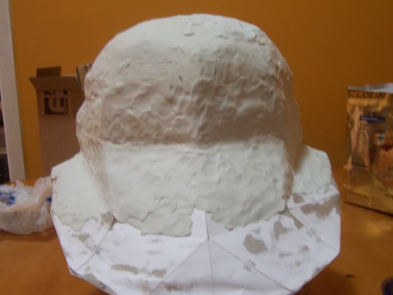

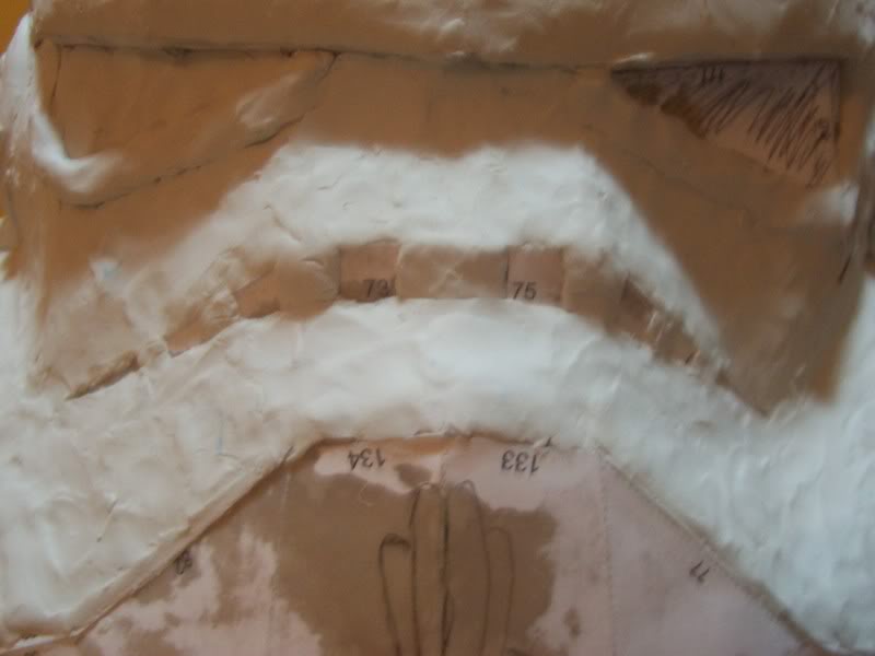

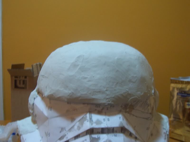

I added more clay to try to level out the dome
lol this takes awhile to put on
Just some pics of the helmet sculpt progress. I think it's actually starting to shape up a bit. Just need to try out the various smoothing techniques, and I'll be good to go from there.

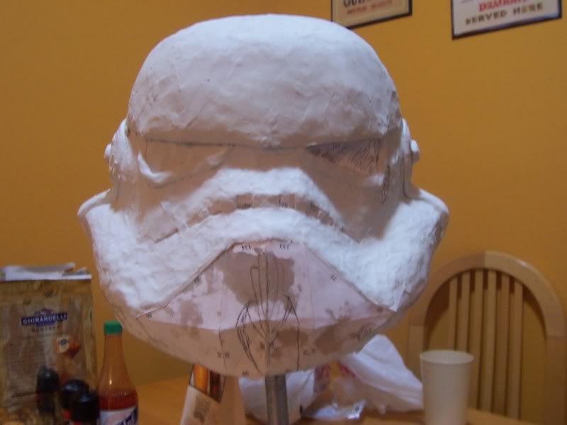

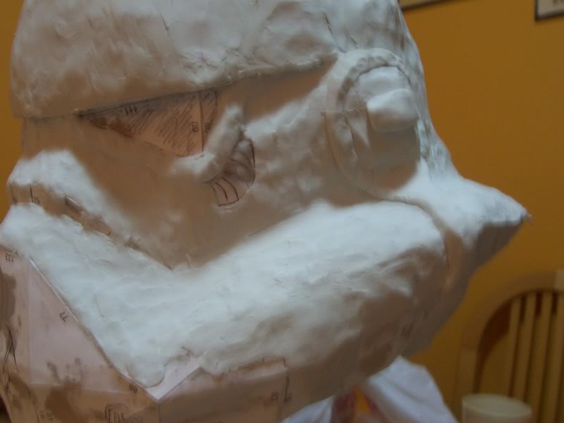

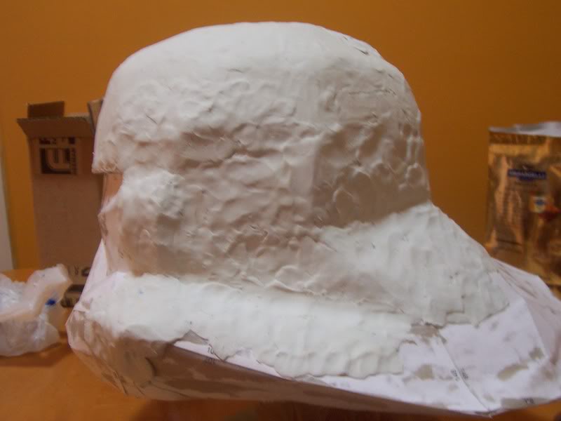

Heres some more nightly progress. I started smoothing out the clay a bit. Its not where I want it, but it's alot better then before. Seems to work best with water and sponges.
-TC

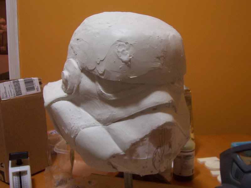

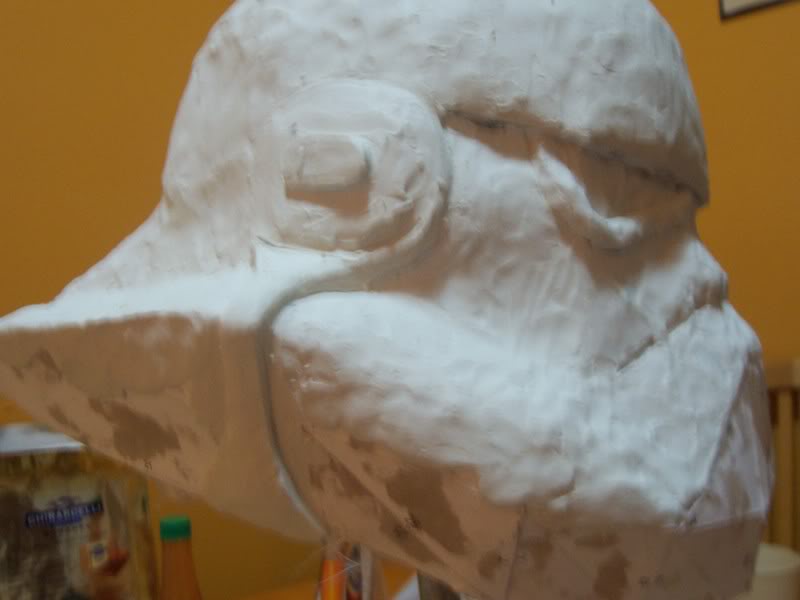

I couldnt sleep, so I did a bit more work, trying to detail and shape the left eye, and giving the "overlap" detail, thats present on stormtrooper helmets. I also started building up the upper nose area, between the eyes. The tear drop is just there, a rough version. Im hesitant to cut out the lower chin piece until I really have to.
-TC
I say put the lump in the eye, like other Trooper helmets have.
Im thinking about doing that or not. Not sure yet, because I'd be cutting that out after I would cast it anyways.
Im not sure yet if I'll make it bubble or just keep it flat. If I do bubble, I'll probably sculpt a set of lenses, mold it and make hard resin bucks to vac-form over, hopefully, be able to find a good color PETG or acrylic sheets to use.

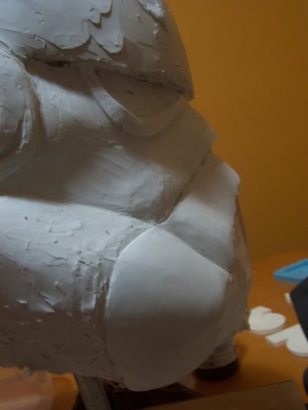

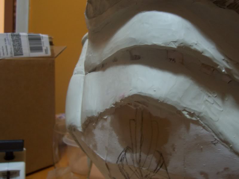

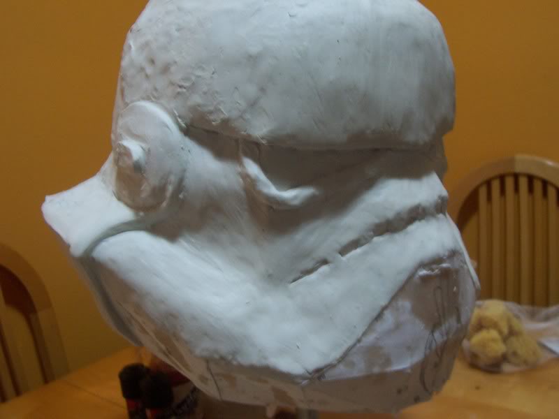

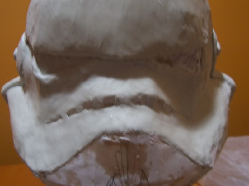

Some more progress on the sculpt. Man, I tell ya, once I started today, I just lost track of time! lol

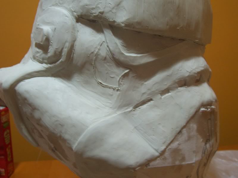

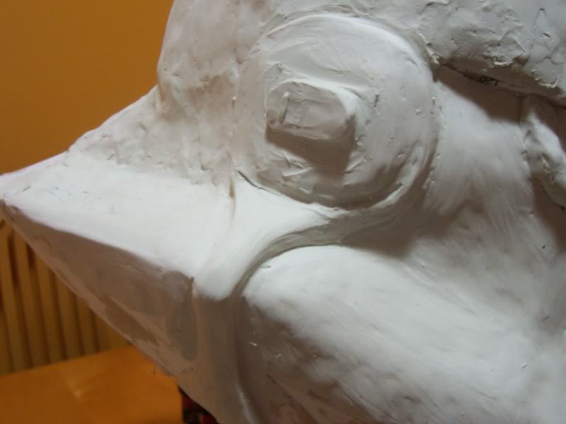

Im using my FX faceplate as a reference for how it *should* look. I gave one side the correct depth, that is present on TK helmets. I also started to shape up the mouth or "grin" as well. These pics are at certain angles to show you those details.
I also found a somewhat good smoothing technique, using a flat piece of styrene plastic..however, its very difficult lol You can see, I used it for the newer sections, and I feel that I will leave those smooth sections alone unitl molding.
