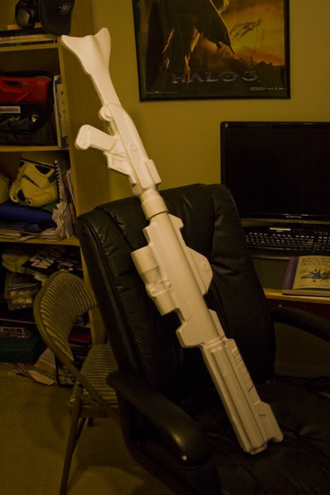

Hey everyone, I purchased a Cushman rifle a long time ago, and am just now getting to work on it. I have some PVC pipe inside it running the length, but that's about it. I got two questions . . .
1. Should I use "Great Stuff" to fill the hollow areas?
2. Should I use bondo to cover up the seams? Or is there an alternative that's considered easier/better for this particular task?
Thanks everyone!
I would recommend filling it with foam so that you don't accidentally puncture the plastic or dent it. I guess that isn't a huge worry, but I can't help feel like it needs a little extra support. I also like that the foam gives it just a bit more substantial feel. Just make sure you give the foam somewhere to vent by drilling some hidden holes so that it doesn't ruin your gun as it expands. You should glue all the seams down so they don't pop the bondo later. I see a lot of people using the glazing type of bondo, but I am using the regular type on mine.
to echo fettfanatic a bit...
i'd probably fill it myself. if you use great stuff, there's a blue can and a red can... the blue can doesn't exert as much pressure on the sides... less likely to explode it. either way, you need some room for it to vent out. maybe fill it in batches.
you can attach a long tube to the great stuff nozzle and feed it all the way to the butt of the thing, and fill your way back out. basically extend the nozzle all the way down into the far end of the piece.

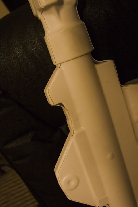

connecting the seams REALLY well before bondo will save you a lot of heartache. anywhere the 2 parts can shift, your filler will chip.
these guns are definitely projects, but i have seen them finish up nice!

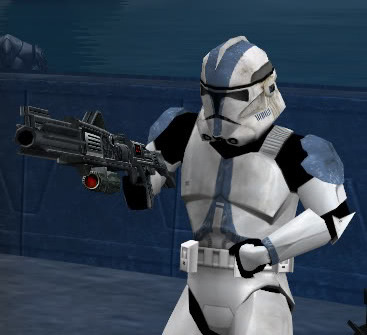

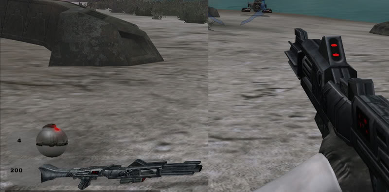

And one more question to finish everything off! What kind of setup has anyone seen with these having lights built into it? If I'm going to use "Great Stuff" I may want to do all the interior wiring and such now, before everything gets filled in. Maybe I can wire the batteries for everything to be in the underside scope looking section, and make that removable. Any ideas? Here's a screen shot from Battlefront II showing some lighting on the gun aside from the end of the barrel...
You can see some lights on the center sights, as well as the side of the gun...
And here you can see what looks like some red light coming from the front end of the underside scope thing.
Has anyone attempted any of this?

When I get out of class I'll take a quick video of the blinking on the gun. The lights on the sights are the only part that blinks, from what I can tell.

I do not use Bondo Glaze any more, though you could. I just use CA gel all around the perimeter. The gel usually fills the seam gaps well. Palm-sand, and it will be quite smooth as well as very stiff. After painting, a touch of weathering, and these look great.

There are a couple of spots on the V1 where you can take an exacto, and remove the small voids. CA Gel, and palm-sand... paint and weather as I said before.
