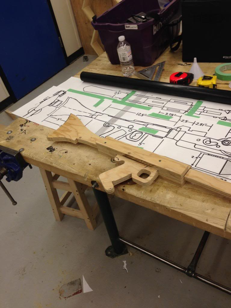

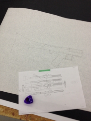

I started with what I think is a template originally made by wizardofflight for the old SW blaster builder boards. It had to be enlarged almost 600%. After putzing around at the school photocopier for a few hours (did I mention we're on spring break right now?), I had my templates. Time to start cutting some wood...

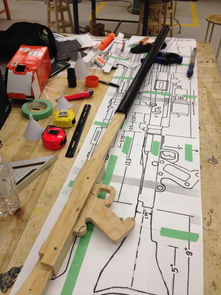

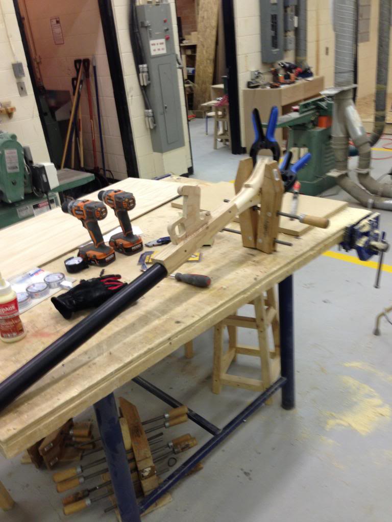

I've seen a lot of DC-15A builds that look like they could use a little Viagra, if you know what I mean. Because the rifle is so long, they tend to bend and sag. I didn't want that to happen to mine! I used a 3/4" plywood for the core of the build. I used the template to trace the back half of the rifle onto the plywood, then cut out as many of the straight and long cuts a I could on the table saw to ensure parallel, straight cuts. Everything else was cut out on the bandsaw or with Forstner bits for any tight curves.
I cut a 1 1/2" shaft sticking out of the front to mount my PVC pipe to. I am hoping that this will eliminate any tendency for the rifle to droop when held up.
I used the same sheet of 3/4" plywood to cut out the sides for the breech. They were screwed on.

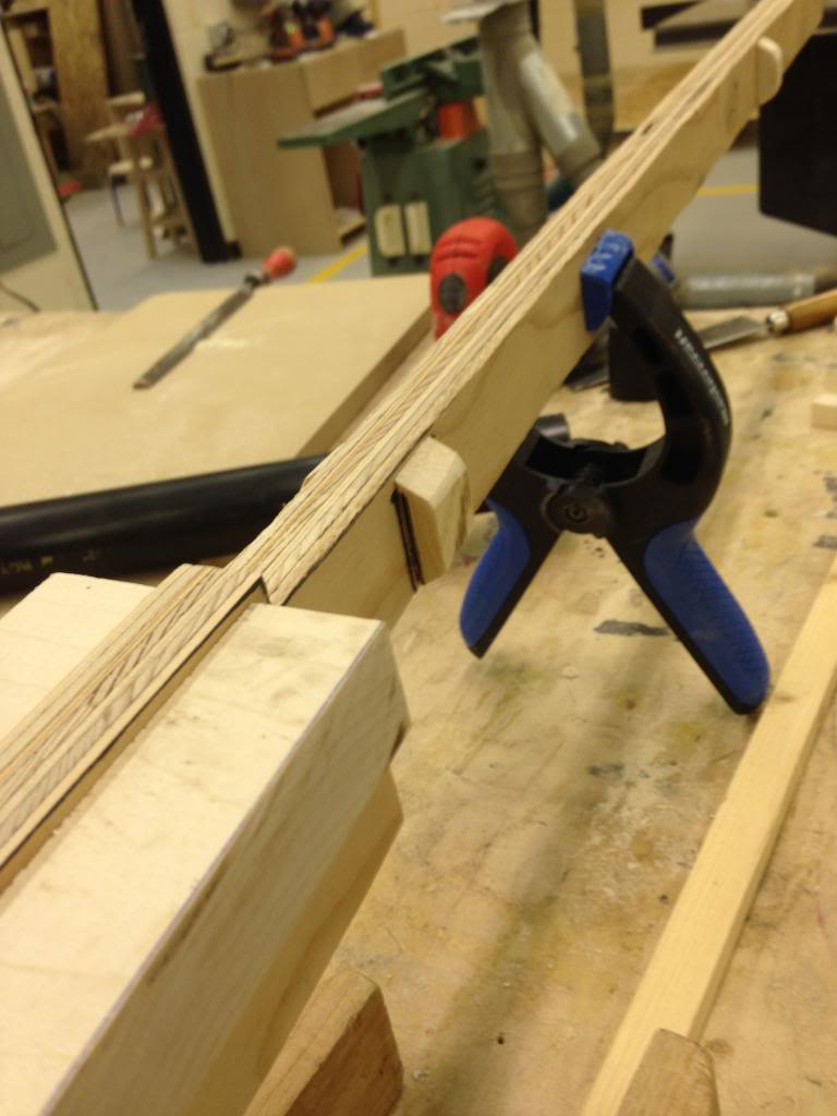

Here's a pic of the PVC sleeve for the front of the rifle. I used a rasp to round off the edges of the front part so the pipe would slide onto it. It's a pretty tight fit, which is exactly what I wanted. A couple screws and some epoxy ought to keep it from moving.

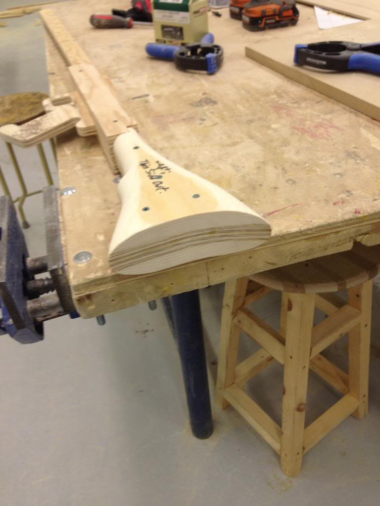

Pretty much every sander in the shop is out of commission. That's kinda bad for this because the rifle stock is really contoured. To overcome this, I used some pine (a soft, easily shaped wood) to block out the sides of the rifle stock. I contoured the shape using a hand rasp, then sanded it with a drum sander on the drill press and a mouse/detail sander.
It's screwed and glued onto the rifle. I'll let it set overnight, then I'll start blocking out the detail parts all over the rifle.

It allowed me to give the rifle butt a little more contour and blend in the 'slices'.

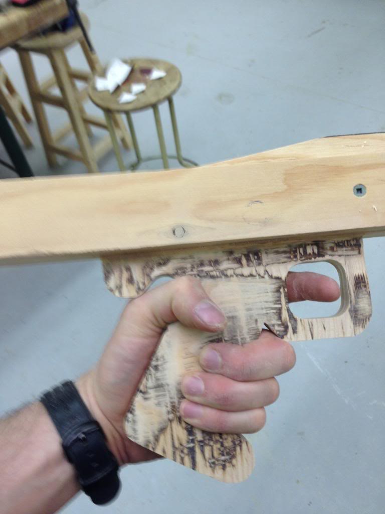

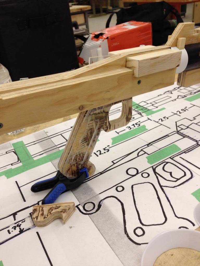

I had cut the pistol grip far too big. I had to slim it up with the belt sander. Next, I cut out the detail at the back of the grip. I then took off a little at a time from the back of the grip until it felt skinny enough.
For some extra detail, I cut out the pistol grip shape from some acrylic I found lying around. I also cut out a hole in the middle of these pieces, just for a little more depth to the part.

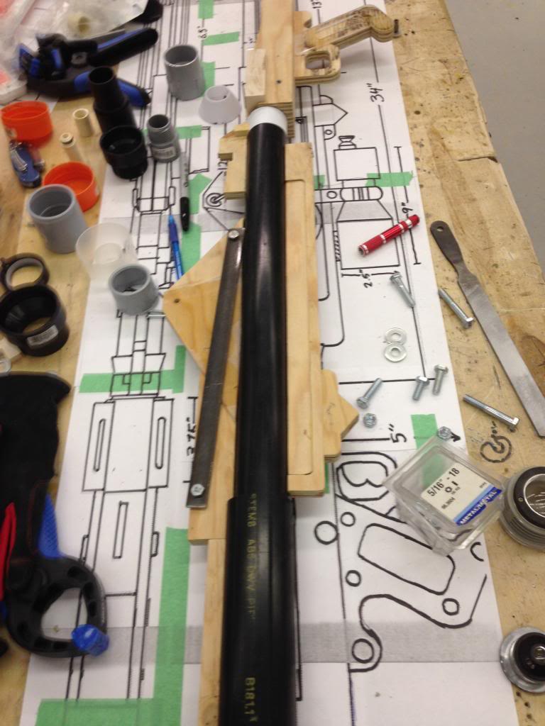

I glued on some fill pieces to the end shaft before securing the PVC barrel. In those same spots, I would be screwing other pieces to the top and bottom of the barrel. As the screw bites into the plywood inside the pipe and pushes it apart, these pieces should push against the barrel for an even more secure hold.

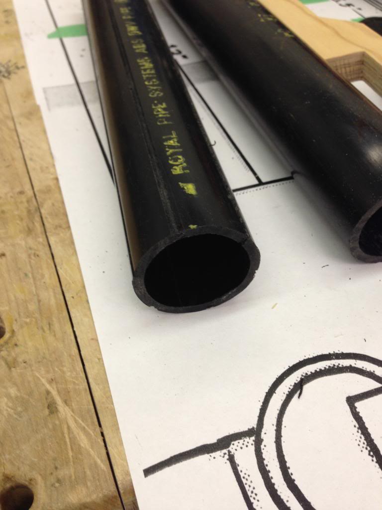

After mounting the front sight/bayonet mount/gas return line/whatever the part on top of the barrel in the pic is, I could move onto the handgrips around the front of the barrel. My barrel is 1 1/2" PVC pipe. I had some 2" PVC pipe laying around. Unfortunately, it is a little loose when you put the smaller pipe into the bigger pipe. I needed to cut out 5/8" in a strip along the length of the barrel to make room for the wood parts at the top of the barrel anyways, so I cut out the strip using a dado blade on a table saw. I then cut in the grooves into the barrel with a table saw blade that was almost fully recesses into the table. This cut out a shallow trench into the plastic that's only as wide as the saw blade itself.
Here's the handgrip mounted and secured to the barrel. I needed to widen the 5/8" cut a little to get the barrel to curve tightly around the 1 1/2" barrel. The handgrip was secured to the barrel with a couple deck screws recessed into the bottom of the handgrip.
The screenshots of these angled strips around the triangular rifle magazine look to me to be some sort of bipod for the rifle. I used some thin steel strip from the welding area's scraps bin, drilled a couple holes, and fixed them in place with a couple bolts and washers. It is definitely supposed to have the crooked, offset look.

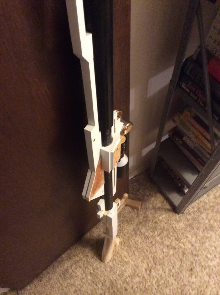

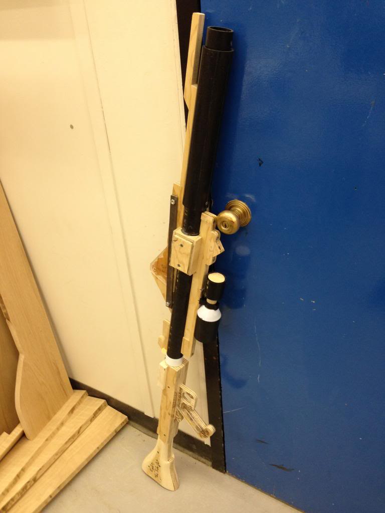

Here's a beauty shot. Almost all of the major parts are now blocked in. Once I finish the barrel tip and the underslung sight, I can move onto skinning all the wood pieces with some thin plastic sheet for a consistent finish, and adding all the buttons and small detail parts.

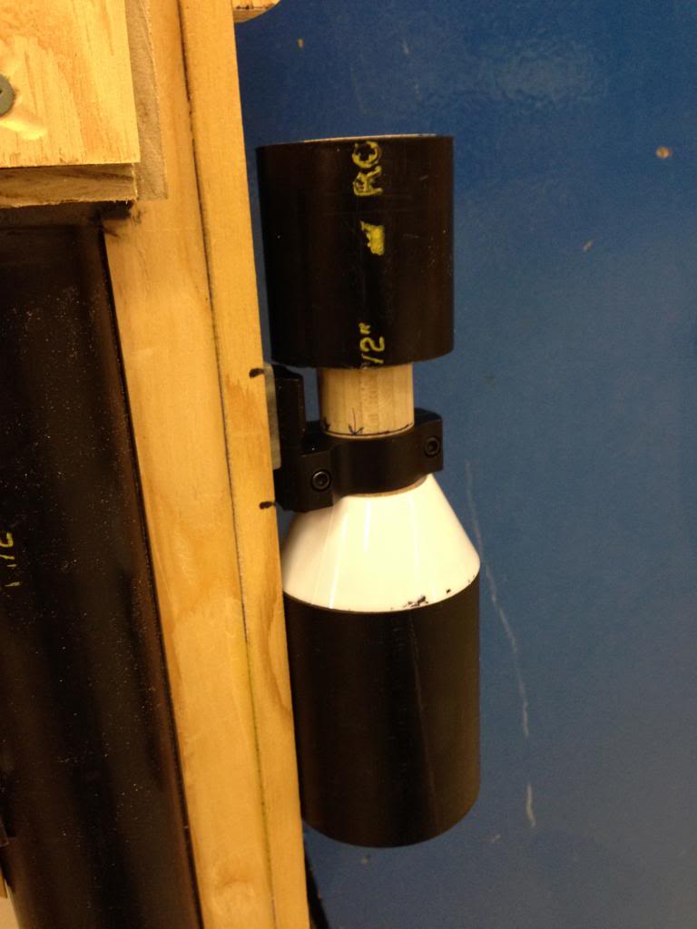

Someone on the Clone Trooper boards said that this part is a flip-up sniper scope that rotates into position if needed. With that tidbit of info, I went all the way down the rabbit-hole, starting with the fact that the front of this rifle is inspired by the E-11 stormtrooper blaster, upside down. The actual scope used on the prop weapons from the original trilogy that corresponds to this part is actually an M38 or M40 optical sight that is WWII vintage. It may also be an M19 sight from a British Chieftan tank? You can start yelling at me now, everyone. Anyways, I looked up resin copies of it from stormie weapon kits, looked on the archived Blaster Builder Board threads for some scratch-built scopes, and even had a look at the local Cabela's for a rifle scope of similar design. However, if I wanted to stay true to the size on this weapon, I would have to scratch build the part.
While at the Cabela's, they managed to scrounge up a spare scope ring and a scope mounting plate for me. But not before they gave me this face:
"What do you mean, you don't know what brand of rifle it's for? Wait, you're doing WHAT? Yeah, we don't have anything like that here."
I don't know about the rest of you, but I seem to run into that all the time. It gets tiresome.
Anyways, the diameter of the scope ring was 1", so I cut a 1" piece of dowel that would connect the large rear 2" PVC to the smaller front 1-1/2" PVC through the scope ring. I used some 3/4" plywood to join the PVC parts to the skinny 1" dowel. I first cut 1" holes into a piece of plywood with a Forstner bit, then I cut out holes that matched the inside diameter of the PVC pipe I was using. Don't use a hole saw, just trace the inside of the pipe onto the board. It's not perfectly round inside. It was cut out on a bandsaw and sand-finished on a spindle sander. I also mixed up some epoxy plumber's putty to cement the funnel shape I had cut out of an actual funnel to the large PVC pipe.
BTW, the cost for the spare scope ring and plate was only $10. :thumbsup:
I did have to put in a spacer between the scope mounting plate and the rifle bottom. This is for the larger diameter back part. There's supposed to be a small gap between the scope and rifle body, but that would make this whole sub-assembly way too easy to break off. I mounted mine flush, and drilled some pilot holes to put screws through the rear part of the scope and into the rifle body itself. As of right now, the whole assembly can come off and come apart for further gap filling, painting, etc.

I think it's ready to come home for a skinning of styrene plastic over all the 'metal' parts. I'll be using For Sale signs & CA glue for that.
Cheers!
Update:
Measure the area. Transfer the measurements to plastic sheet. Cut. Glue. Repeat. :wacko
In all seriousness, it's around half-done. Maybe more? I don't need to skin the areas in acrylic, at least.

The first step was to draft up the plans for this build. I took the original printed drawing file and used it as a guide to draw myself a full-sized physical blueprint of the piece.
While the original file had several included inch measurements marked out, a lot of the build was not measured up in the drawing. Using some fine measurement and ratio scaling math, I found that a measurement in centimetres from the drawing would yield the corresponding measurement in full-scale inches if multiplied by 2.13175. Using that, I was able to draw up some plans with the measurements I wanted to know.

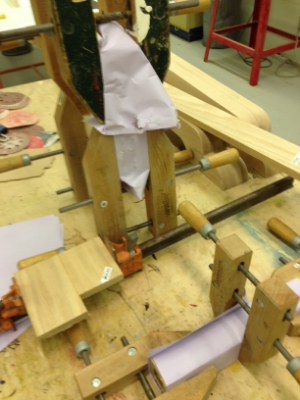

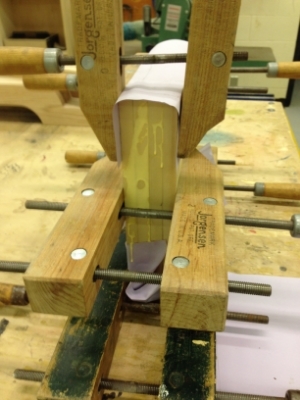

I glued the boards together, using a lot of glue and clamps.
I wrapped the piece in paper so that the excess glue wouldn't bond my piece to the wooden clamps. In retrospect, I probably should have used wax paper. But for this piece, it's not a big deal. We'll be cutting out the general shape of the rifle stock from this block.

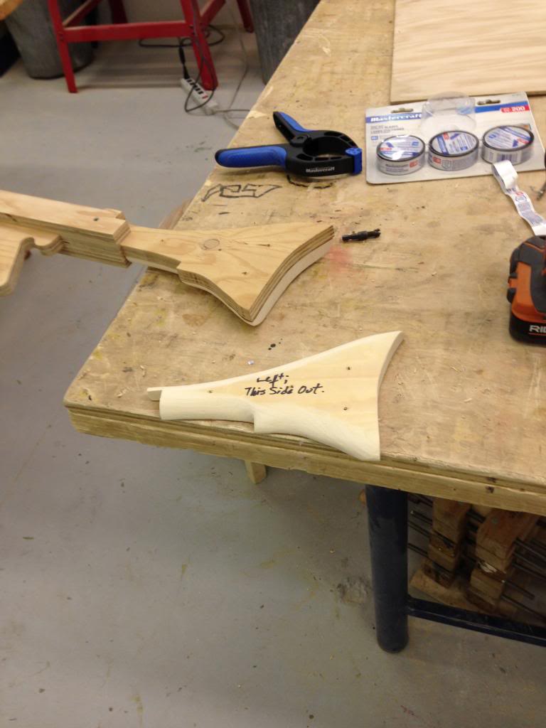

This morning, I unclamped all of my pieces and started laying out the cuts I would need to do for the rifle butt before sanding it to shape. The first cut I made was to square up the bottom of the block, using the table saw. My next cut would be on the top of the block, and this will be for the 3/4" hole for the dowel to sit in.

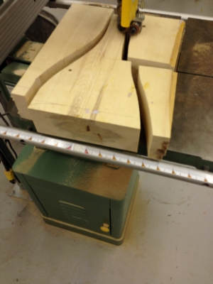

Next step was to cut out the general shape of the rifle butt.
This was done on the bandsaw, and it was not exact. All I want is a shape that roughly matches the profile of the rifle butt. It will get taken down to shape and size using a rasp and sanding.
