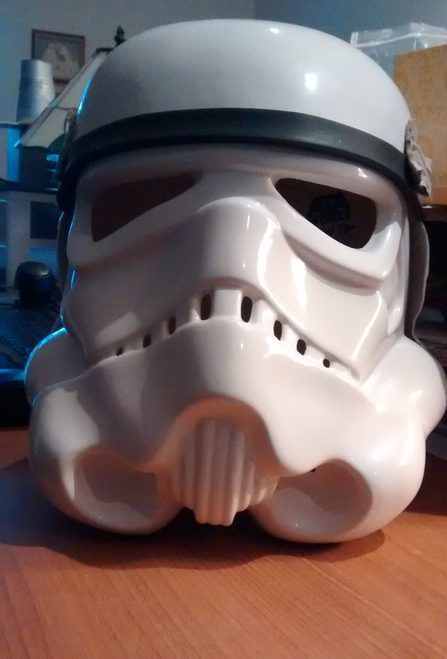

I was following pandatroopers tutorial, he seemed to make the teeth shapes rounded, I kind of like that look better, I might make them bigger and a little less round, but Is it very important to change the shape to rectangular?
No, some go with the Twinkie teeth style like yours are. Just more important to get the sizing right. This mainly focuses on the bigger teeth.
Teeth should definitely be square.

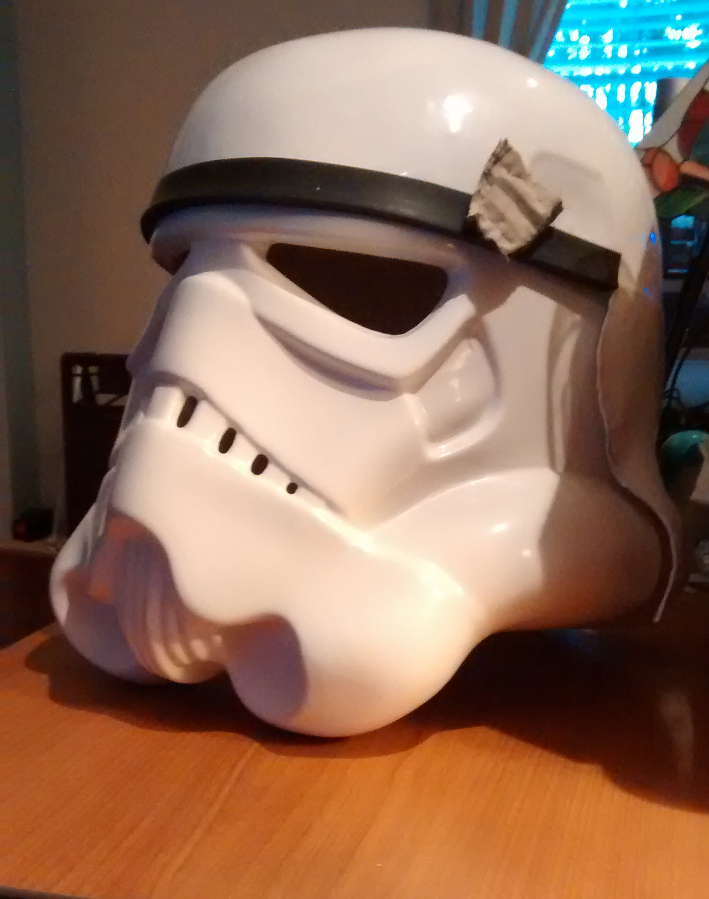

I'm starting to fit the front and back together with rare earth magnets.
I'm also not going to use rivets, Instead I will use a bolt and a nut to hold the front and back together.
The side does seem to pop out a little too much, but I've read that the ears will cover that.
I also cut down the black rubber to fit the "Brow".
Any kind of thoughts?

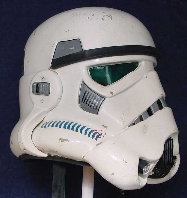

Need to look at some good reference pics. ANH lids were hand painted, so there's probably some variance, but I'd say all inside the shape, not past the lines. Have a look at Bobamakers page in his "other projects" tab. He has a nice TK lid paint up. Not really instructional, but you'll get a good glimpse of the paint detail. The original lids were made with a greenish plastic, and painted white. He adds nice detail to his paint up by using a little masking fluid to allow some chips to show thru under the white for a nice aged helmet. You could of course go more subtle, or no weathering at all. Personally I've always found the brand new look to be kind of cheesy.....

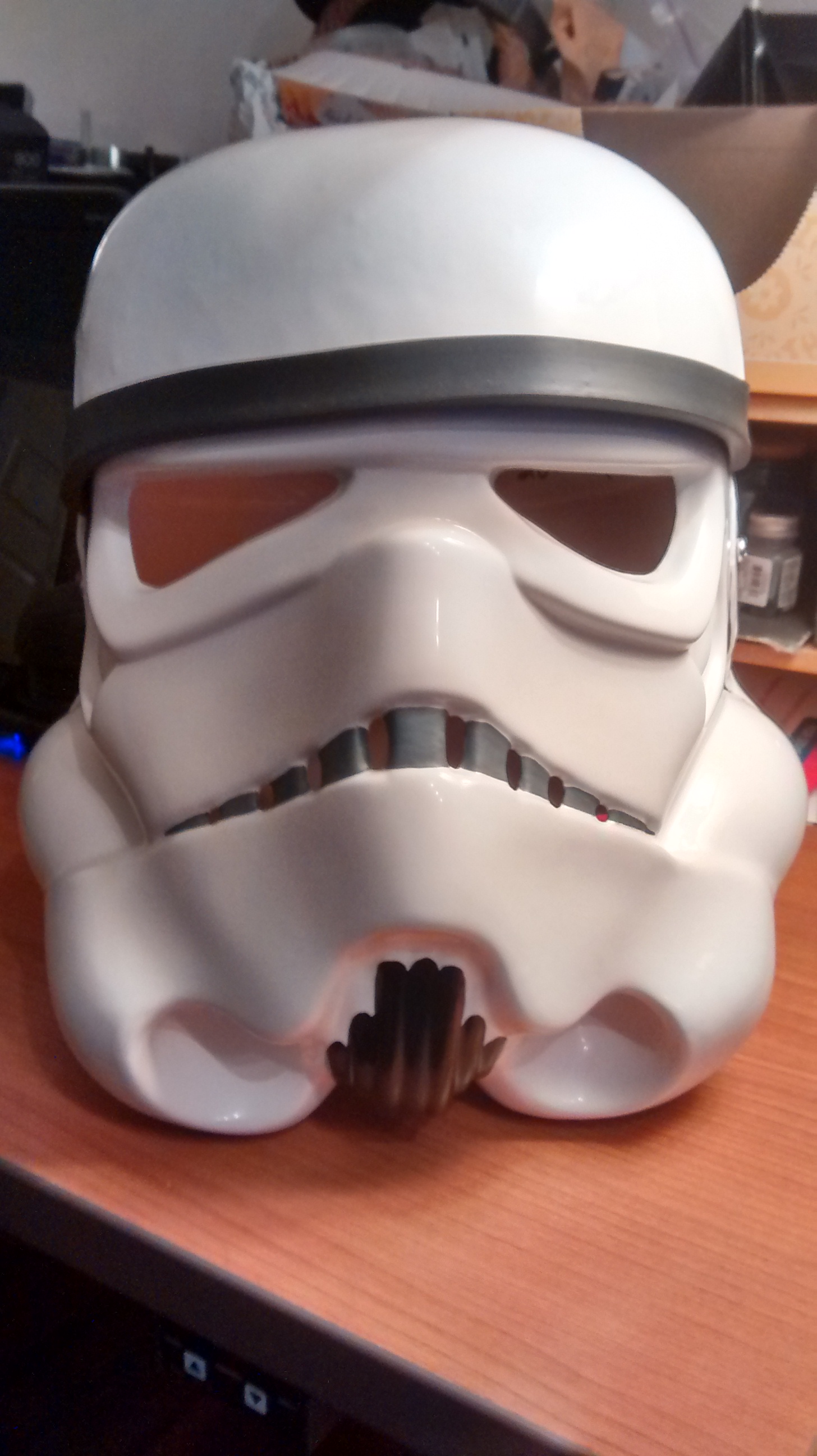

I painted the frown and the chin, how does it look?
I noticed the grey is flat and not glossy, does testors have clear gloss enamel to make it glossy? or is it ok to be flat grey?
It should be glossy. I'd have a look at trooperbay to see the grey that they have from Humbrol. It's a good match. They also have the correct blue for the tube stripes if you plan on hand painting them. One word of caution on the ears. I know you're not there quite yet, but leave plenty of excess on the ear details to allow for fitting them to the sides. Especially the back of the ears.

Well it's taken a while But I've painted everything except the blue stripes and the shape on the ear.
Does the picture look good?

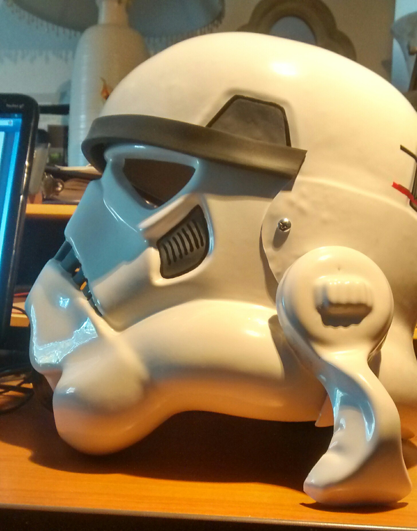

The Ears are starting to be a pain, The back lines up well but the front wont get close enough, sadly this is a lot of work lol.
