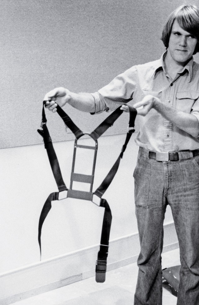

I have pics saved of them being done 2 ways. One where the belt is sewn on both sides at the lower pack rings and another with only the one side being sewn and the other just looped thru with a triglide. Is there a " correct" way? Talking about the part with the actual buckle on it , not the part going over the shoulders
Sewn both sides , tri glide is for the belt that passes through the Buckie
I currently use the one side sewn with the other looped through the triglide method. I'm going to be changing it though since the belt worked its way out of the triglide at a recent troop and which caused me to lose the triglide, and even worse...I had to end my troop early. I'll be sewing the other side now.
