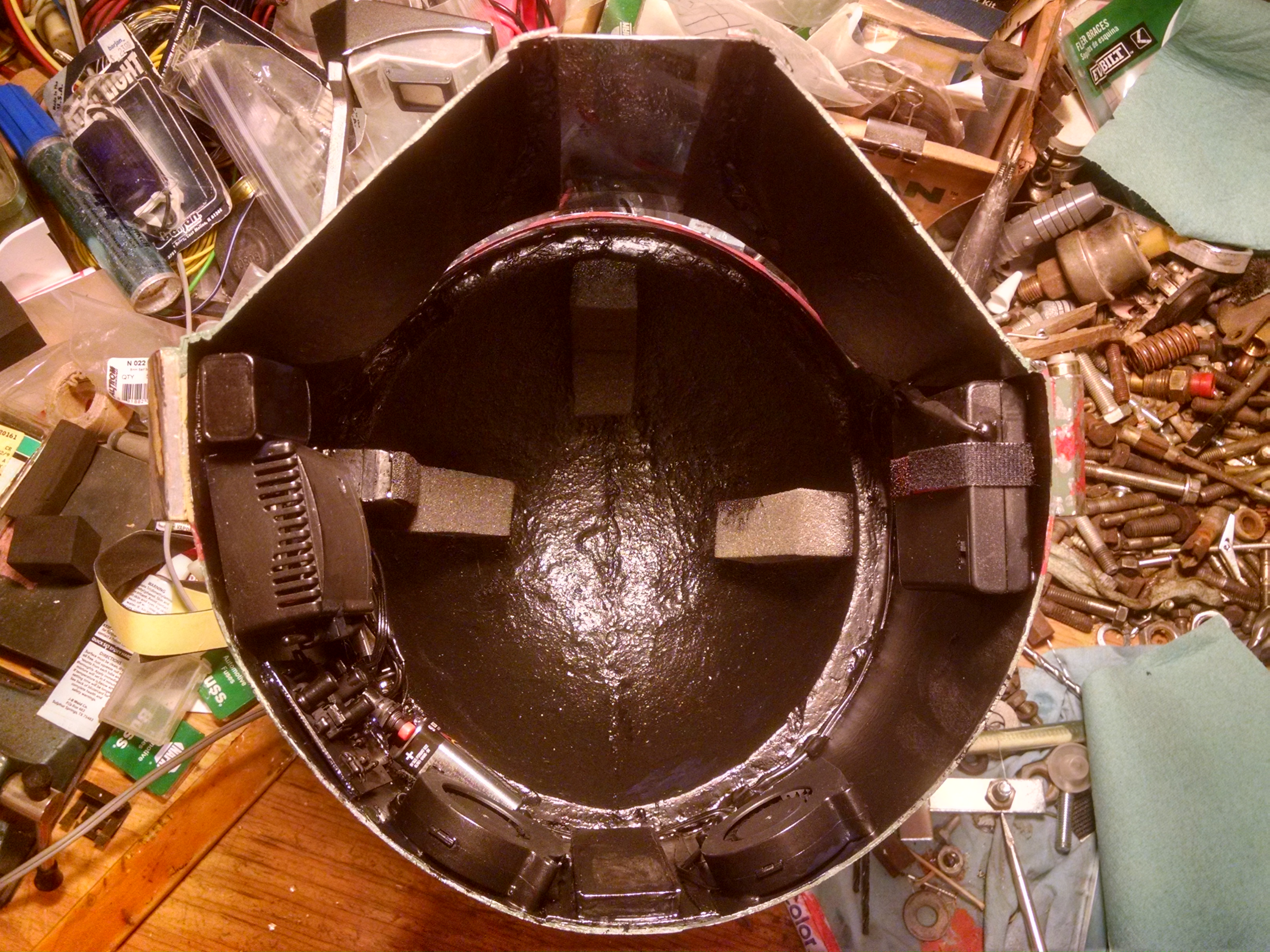

I have 2 fans from eqdizzle here on TDH. Mine are powered by 4 AA batteries in a switched box all mounted in the helmet, which balances the weight of the rangefinder servo relay/radio receiver and batteries:
I experimented with different placement of the fans while running to lessen their affect on my hearing. I settled on the back panel location with the fans outflow aimed up the back. In this way the airflow passes over my head and down the front to defog the visor. Also the intake is at the nape of my neck as add additional cooling sensation, all with minimal impact on my hearing. Only needed in short bursts in my experience, since the helmet is so open around the bottom. Helps to exhale out your nose instead of your mouth, especially in cold weather.
Good info Greg, thanks for the bucket pic, nice setup! The hearing part is one of my concerns too. The wife already says I have selective hearing for some reason....

Nope, mine's a snug fit. If you look at pic, you see I have 3 1" thick open cell foam pads to hold it forward, otherwise my nose presses hard against the visor. It's light (scratch built) but the batteries and motors add heft. Never have worried about wind, but haven't really experienced any either, I've only been trooping for a year. A chin strap/cup would be the thing if that is a concern. It would certainly make it worry free and also allow sudden/action movements.

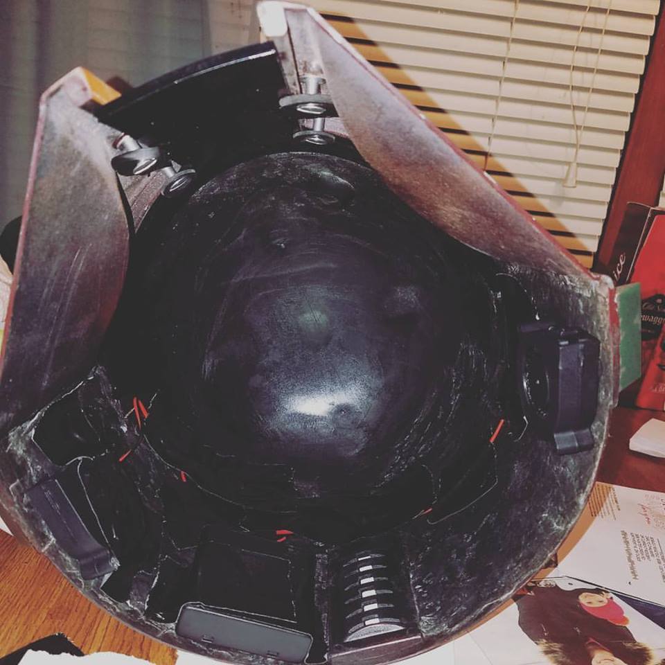

I have a set from eqdizzle, I highly recommend them. I glued the fans in and the battery pack attaches with velcro so it can be removed and batteries replaced. this is a pic of when I just had them duct taped in
Looks good, I do like Drax's idea about velcro on the fans. I'm wondering if fans and packs mounted with neodymium magnets might work out too? You could put magnets in a couple of locations to move fans for different conditions and they might be easier to get out of the way to clean inside? ?
