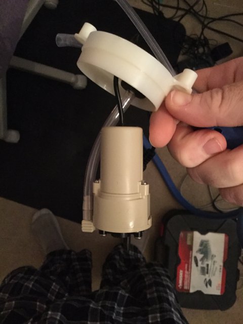

I'm building a water cooling system in my jetpack. Tore apart a Kodiak ice therapy kit, then I'll run the lines out the bottom into the suit. Found a battery pack from a chiller backpack that will last 4 hours, and an insulated bladder to hold the ice better/longer. I've already tested it and it works beautifully [emoji41][emoji106]. The last pic is the pad that circulates the ice water through it. I'm adding a splitter to run lines up into the helmet.

A couple of serious drawbacks with the above approaches.
1) With the water cooling system you are talking significantly adding weight in the jetpack. This affects both how long you can troop (trust me heavy jetpacks suck after 2 hours of trooping) and lifespan of the jetpack (significant increase in cracks from weight stress appearing).
2) The ducting method would cause issues with head movement and wouldn't do much for air circulation.

Yeah, I thought about the weight thing, figured I'd find out when done. I'm sure it has more drawbacks than not, but we never know until we try, right? Thanks for the info though [emoji106]

The water cooling system needs a place to dissipate the heat. There really isn't a good place to do that anywhere on the jetpack. If you put it inside the jetpack you wont be doing any cooling. Far more effective would be wearing an ice vest...but that only cools for about 45 minutes and adds a good chunk of weight to your chest area.

That's where I was going to get the battery pack. If it hasn't been so expensive, I would've looked into that.
