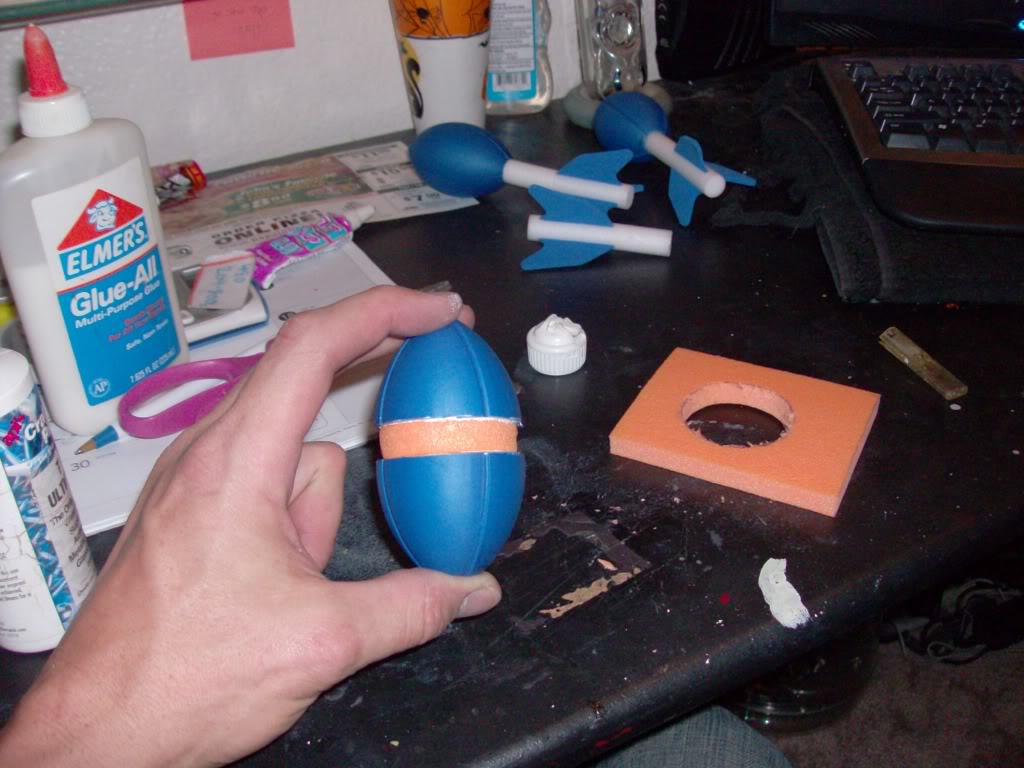

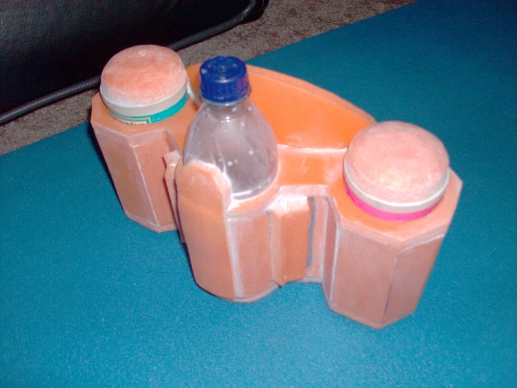

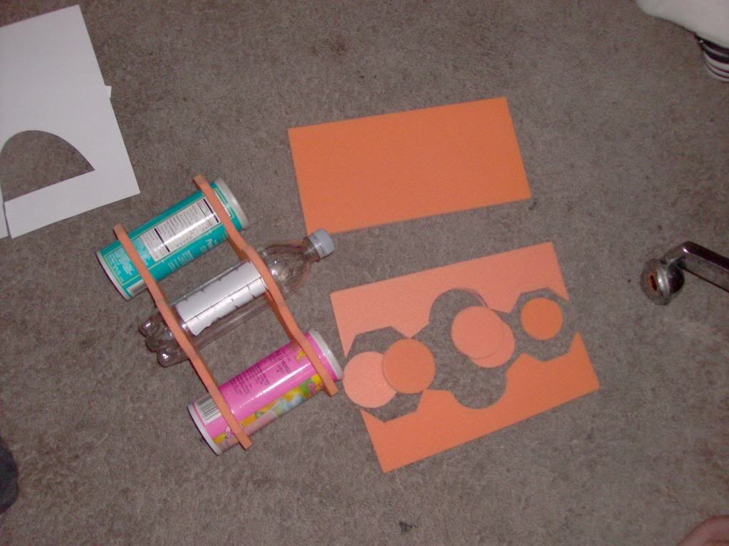

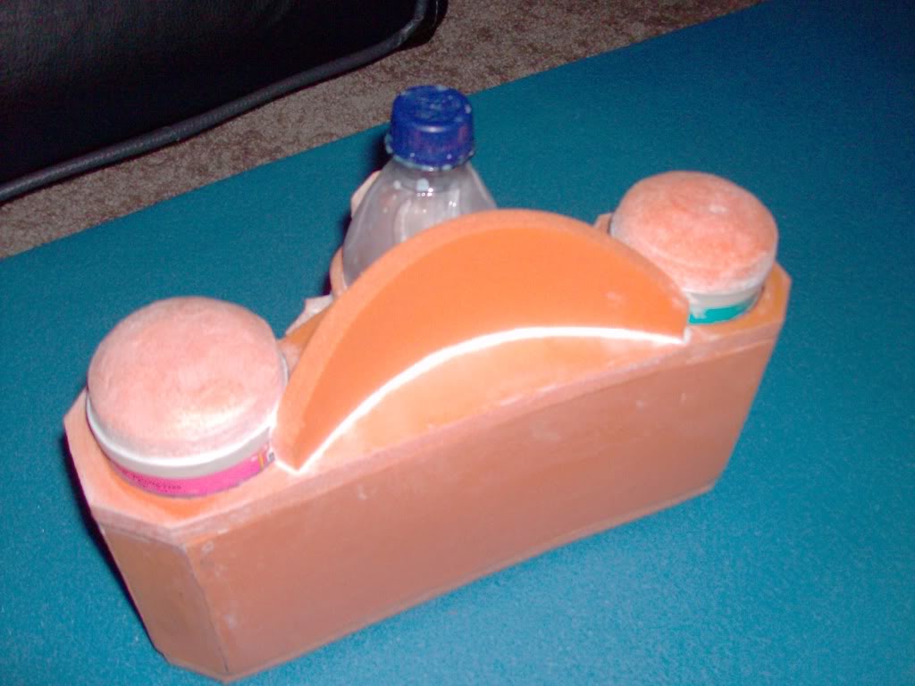

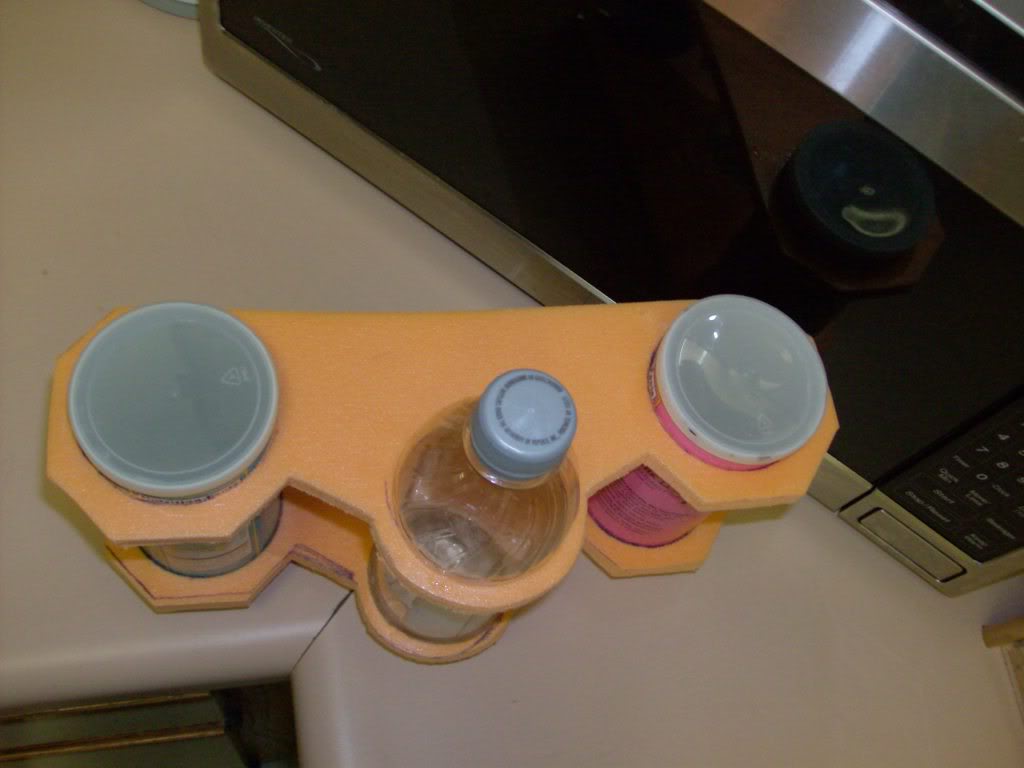

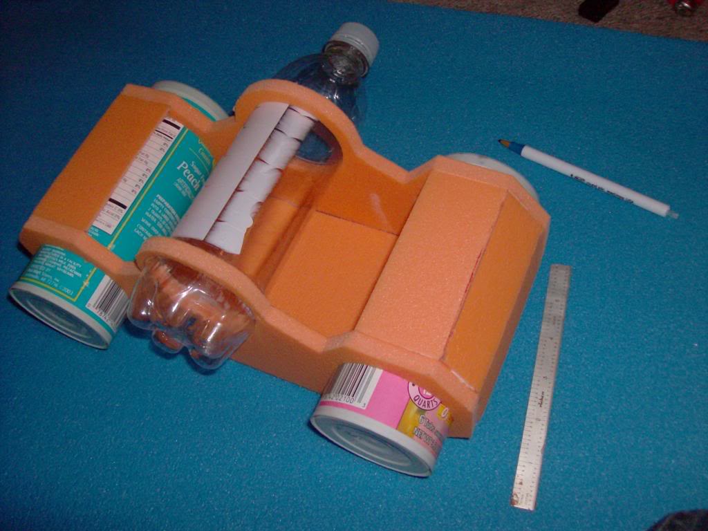

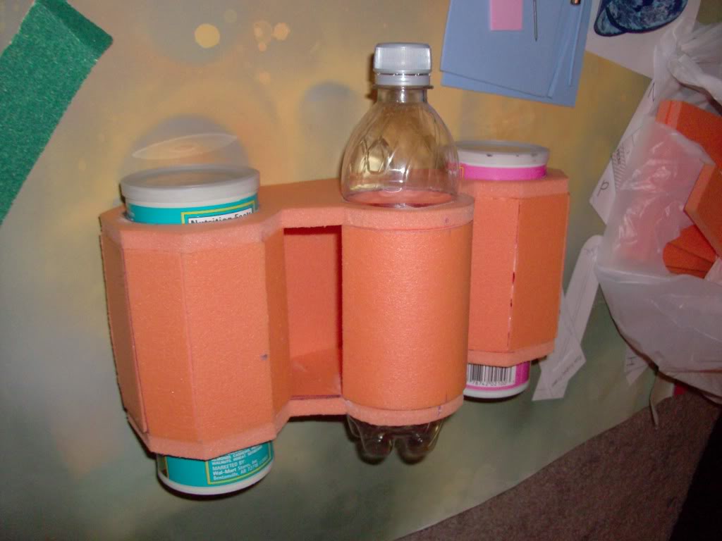

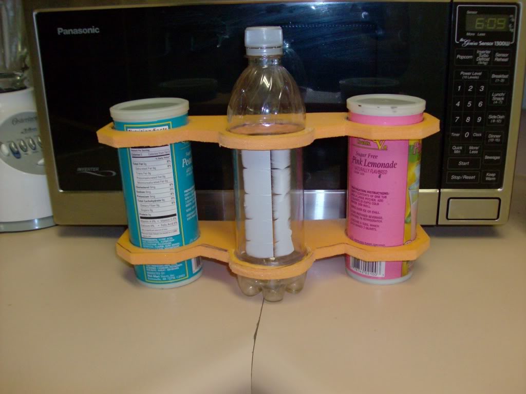

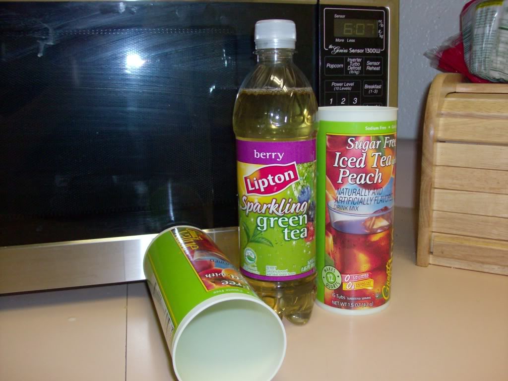

OK! I'm far enough into the Jet pack to post some pics...
I've had so much fun building this!

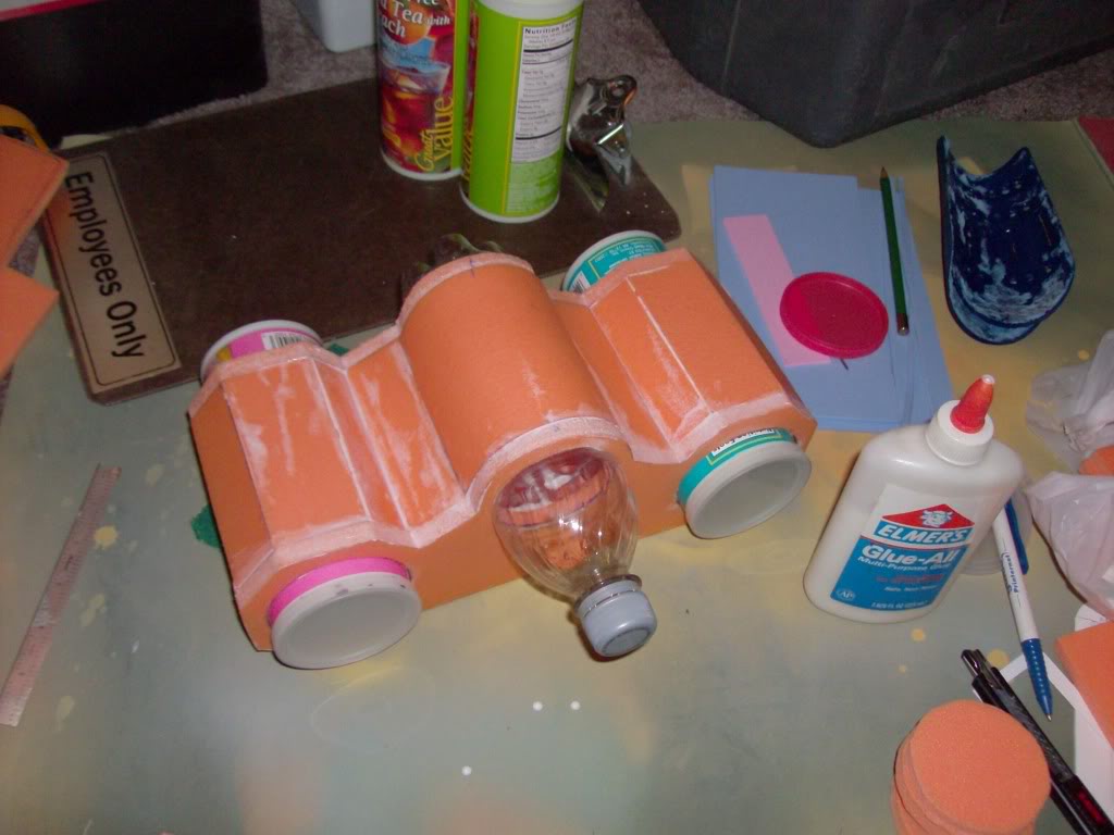

Again taking the things around me and using them to my advantage...
Gluing some stuff...

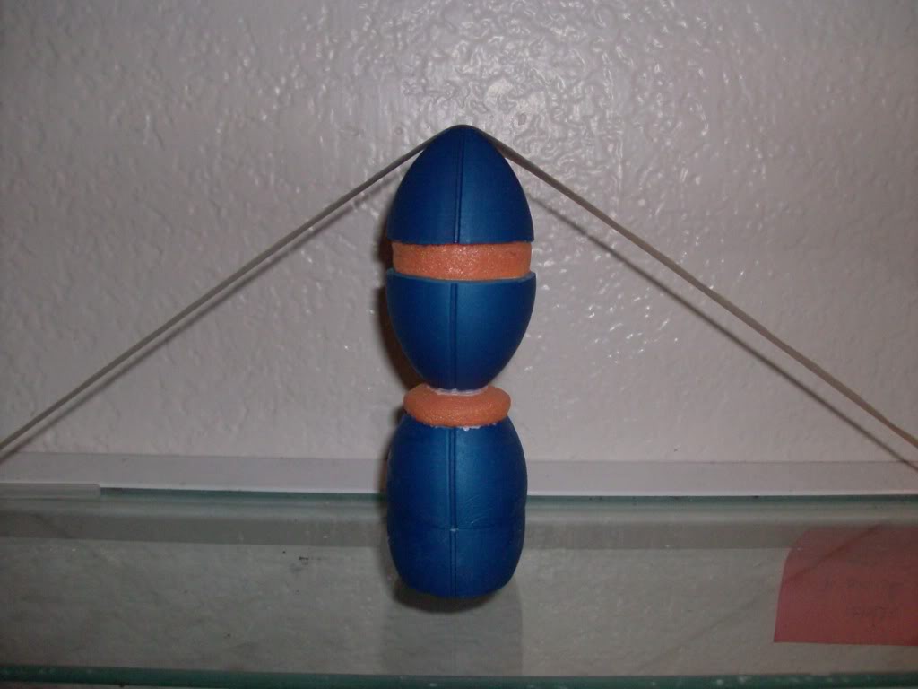

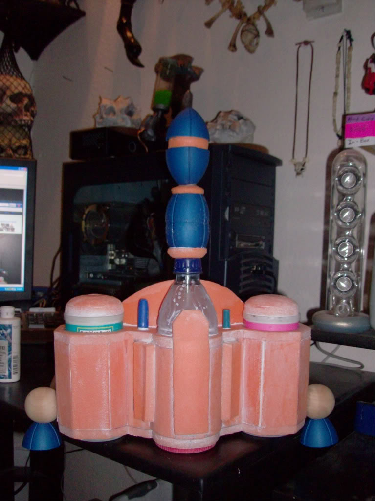

Trimmed off tubes and capped off. Also capped tops with sculpted foam toppers...
Put this top thing in...

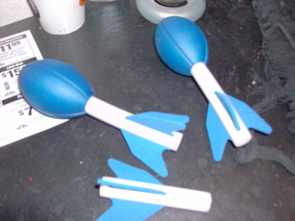

Then I put the Directional thrusters, stabilizing gyro & missile targeting range finder...
Using $ store foam foot balls...

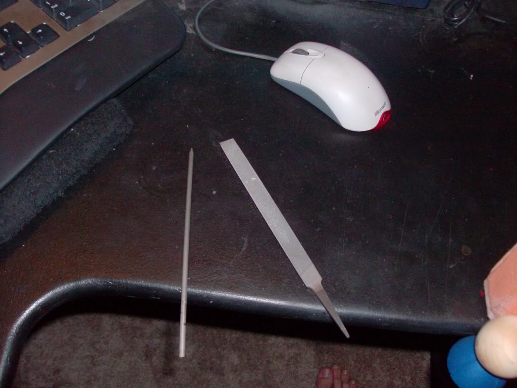

Then I took a metal rod and filed it sharp and shoved it through the Missile so it would be sturdy.

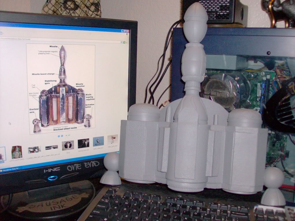

And after all is said and done...
a Miniature Jet pack...

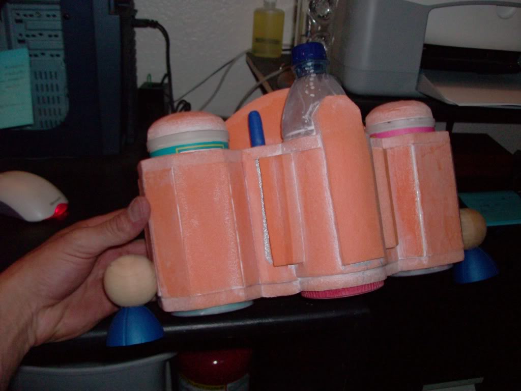

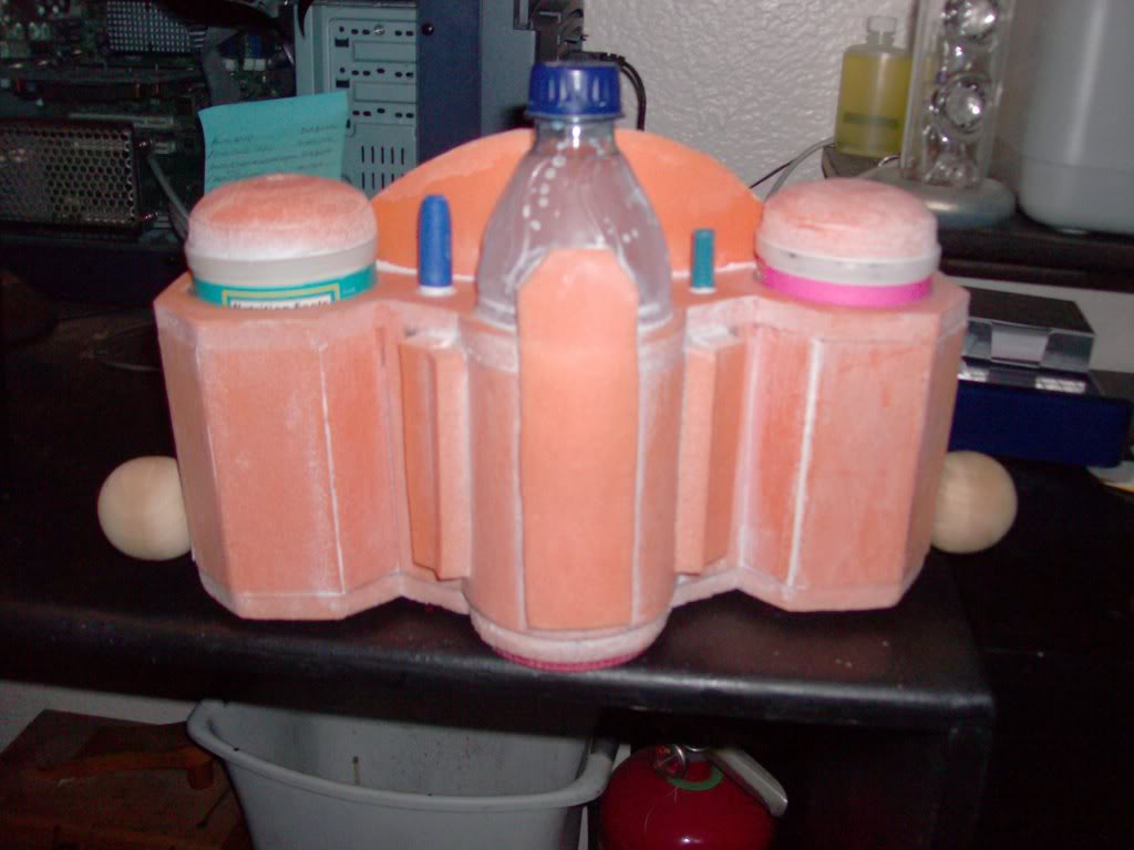

I'm going to give this a few coats of a caulking wash "just a mixture of water, elmers glue & silicone caulking" to fill in any gaps and give a strong shell.
=) Thomas.

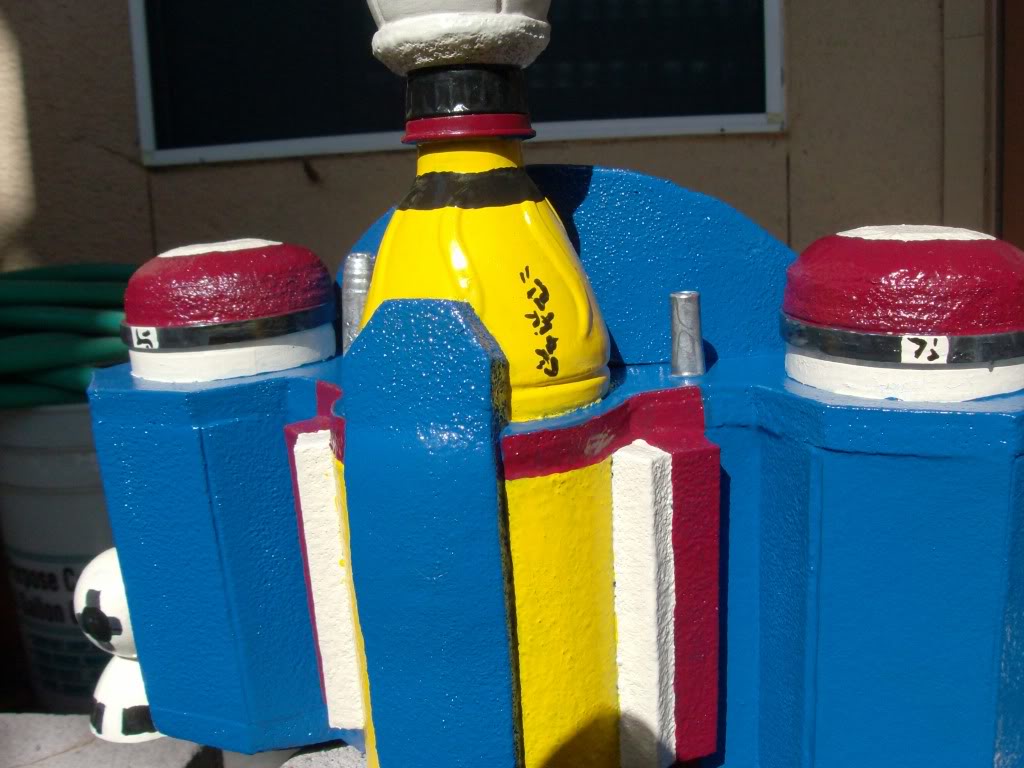

It's blue with yellow and maroon.. I went with what I thought was the original look with the blue jet pack.
Your son´s jet pack IS an original, whatever you paint it! ;-)

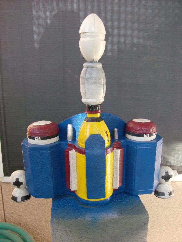

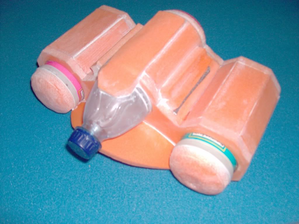

Completed the Jet pack!
index.php
Hope you guys like it! I had the best time making this!
Now on to his Bucket... Then his Gauntlets... And somewhere in there I'm working on putting it on an outfit...
