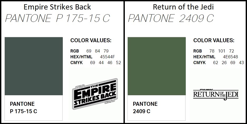

NikTrooper
Is it the same Weyerhauser green for ESB, misted with Grime?
The ESB and ROTJ are indeed different greens as far as the armor goes. The 501st states that they are:
-Iron
