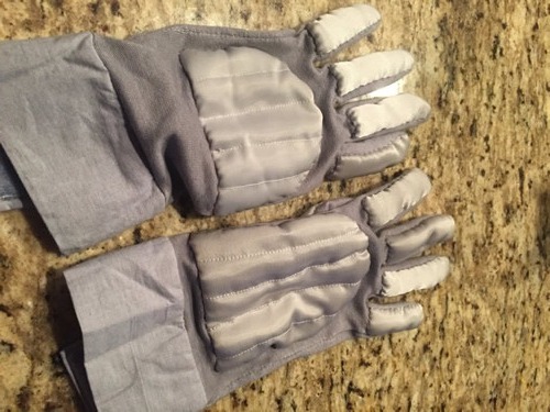

Gloves - fit great, love em. Gotta weather them, but will probably wait until I get the flight suit to try to match up the technique.

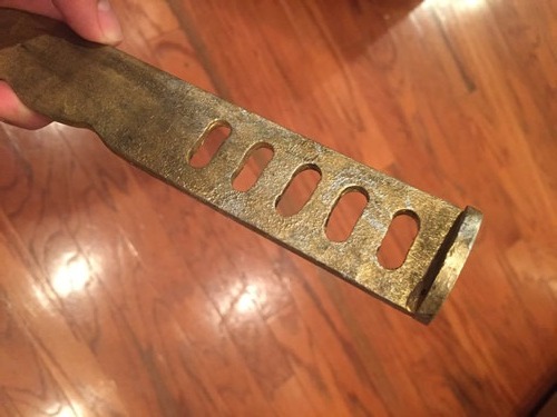

For the survival knife, I used a dremel to cut the holes. The cap is held on with CA glue. Gave it all a rough sanding, then shot it with some self etching primer. Two coats of gold Valspar paint, then weathered with acrylics: Pure Gold, Latte, Brown, Black and Pure Silver.

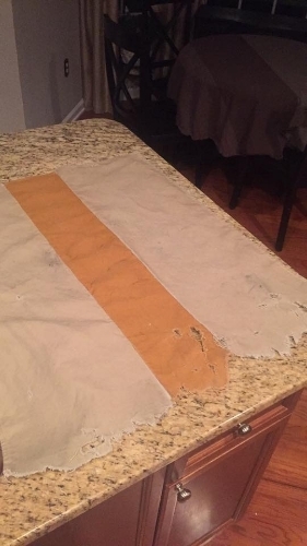

Cape time. Went to Joanne and found duck cloth on sale. Grabbed one yard of "medium taupe" and a half yard of "sepia" and matched it up with some photos, it looks pretty good.
Went off RafalFett's dimensions and sewed it with heavy duty thread using a few different stitches.
This stuff started out really, really stiff and heavy. To weather it, I used scissors to cut approximate holes according to the pattern, then I took an orbital sander with a 80grit disc on it to give the frayed look. I then went over the entire cape with the 80 grit to make it look older. Additionally, this sanding made the cape much softer and hangs much better now. Afterward, washed it cold water with vinegar and dried it on high heat with a couple tennis balls for about 30 minutes.
It's pretty soft now, and the sanding has definitely made it look "worn" - a small application of black wash and tossed it into the washer/dryer one more time, and I think it's ready to go.

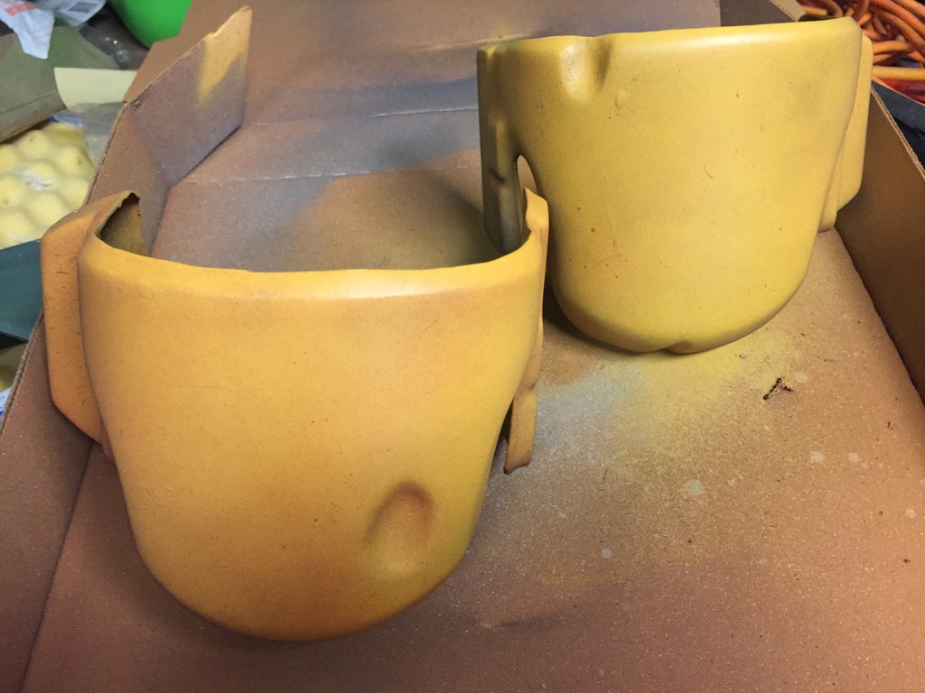

Worked on the knees this week. Progress! Can't wait to peel off the masking fluid. This was done with Rustoleum silver paint & primer in one on first layer, dried for two days. Then used masking fluid for silver damage. Yellow striping paint was first layer, then used the Valspar orange mist (heavy on right, lighter on left). Final coat was misting of gray primer. Each coat got a rubdown with #0000 steel wool to knock down the sheen and smooth it out.
Will follow this up with blackwash and final flat poly coat.

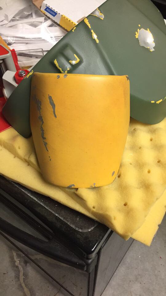

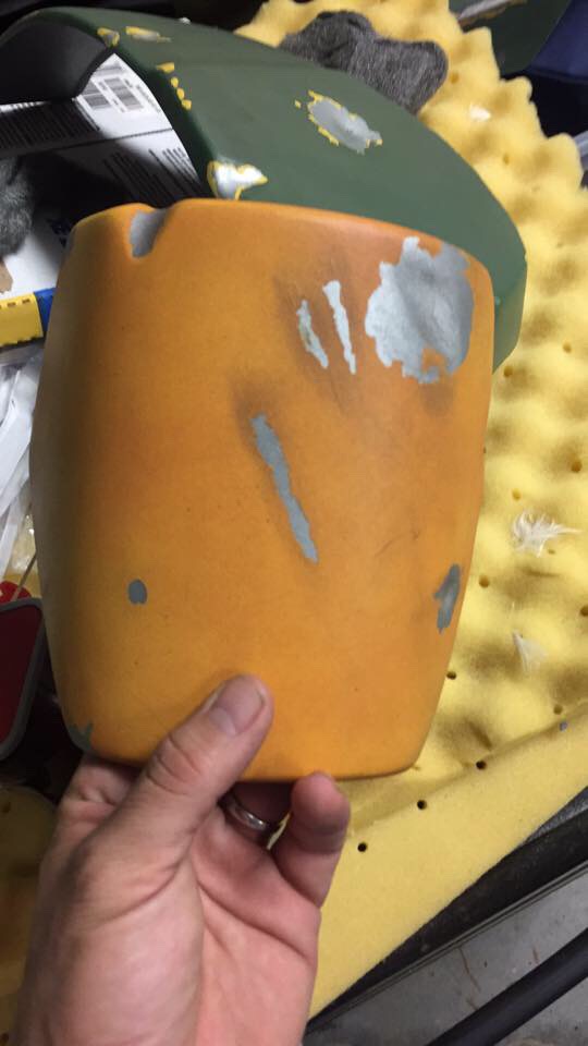

Finished all the yellow/orange parts up... and took a sander to them all. I went by the CRL images on 501st, and after some discussion and review of images, I'm a little confused why those are up as the CRL images. They look quite different from the screen caps from ESB in the Gallery.
Got a lesson on weathering from BobaFiend and they looked awesome... just not the accuracy that I want :)

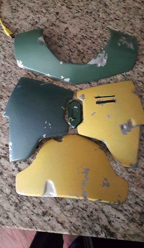

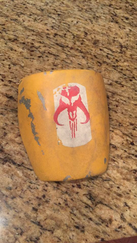

Finished up the left shoulder plate using Rafal's decal template and tracing paper. Painted the skull by hand (Chevy Red Orange on top of Ivory), then hit it with steel wool to dull the glossy coat. Here it is after being weathered with black, gray, white, and brown acrylics.

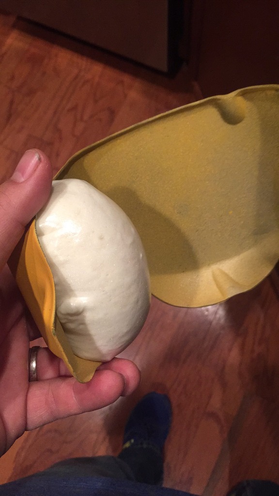

Yeah, so... used a little too much foam on the knees :D
Thankfully this stuff cuts and sands really easily, haha! Hoping this helps stabilize the aluminum knee darts (and gives it something to glue to).
