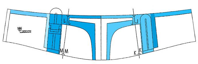

To spare some styrene material and to simplify the gluing of those big parts, I cut the mask in many simple parts. Here you can see my way I cut the WOF temps. Each blue color shading represents a single new part:
Starting with the right mask part -the biggest part- I began at the exact middle of the eye area using first super glue for about 1cm, before be very sure the mask is perfectly aligned !! The rest of the mask I glued with the polystyrene cement, being patient and glued and pressed each cm one by one... Be sure you use a lot of the polystyrene cement, when it comes out a little on each sides, then it is perfect. Keep the cement becoming hard and later on cut it off with the scalpel.
With all other mask parts use the same applying method.
See here, with the mask applied the Boba bucket slowly wins its characteristic charm ! The visors rim is now twice as thick.
