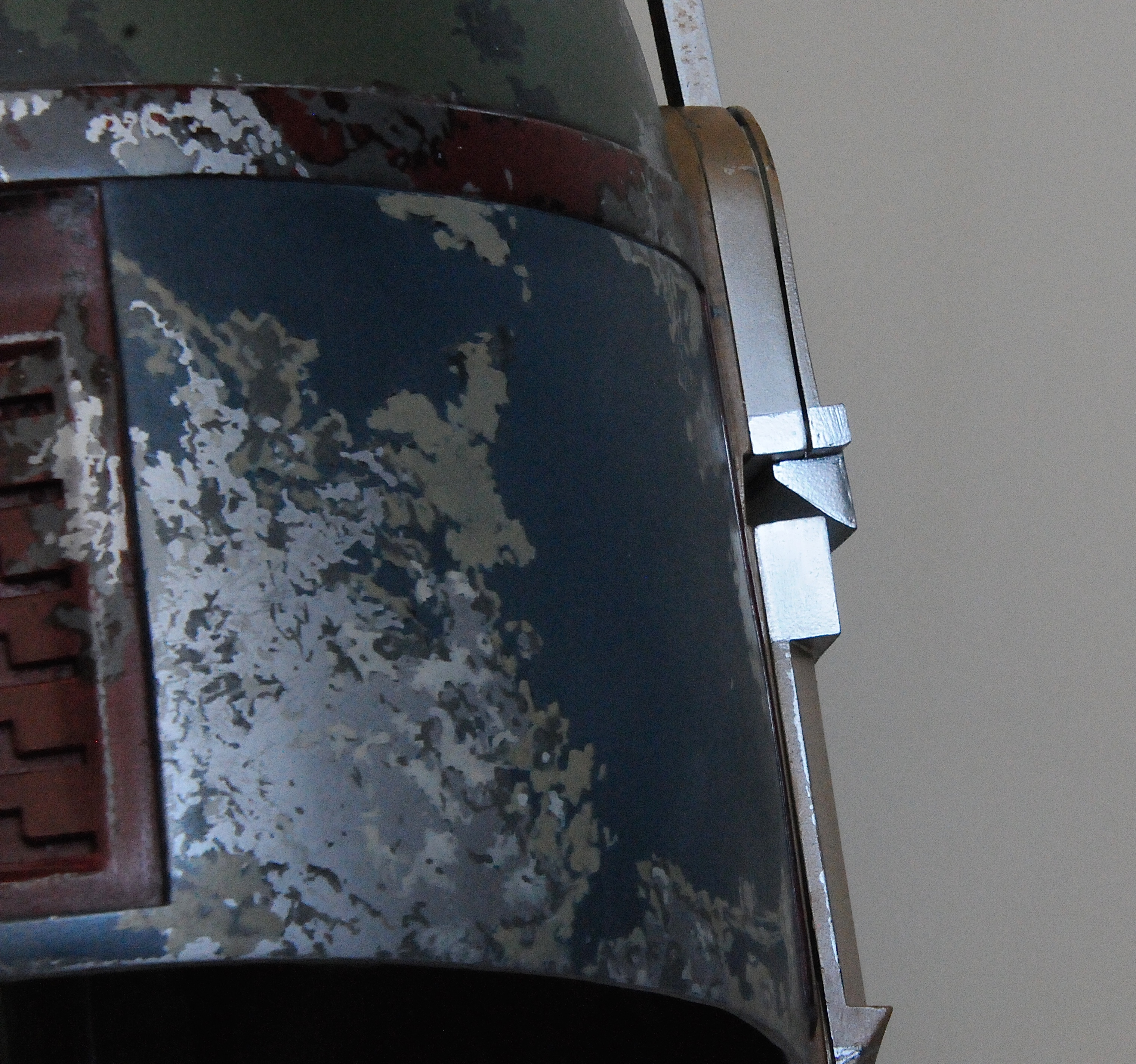

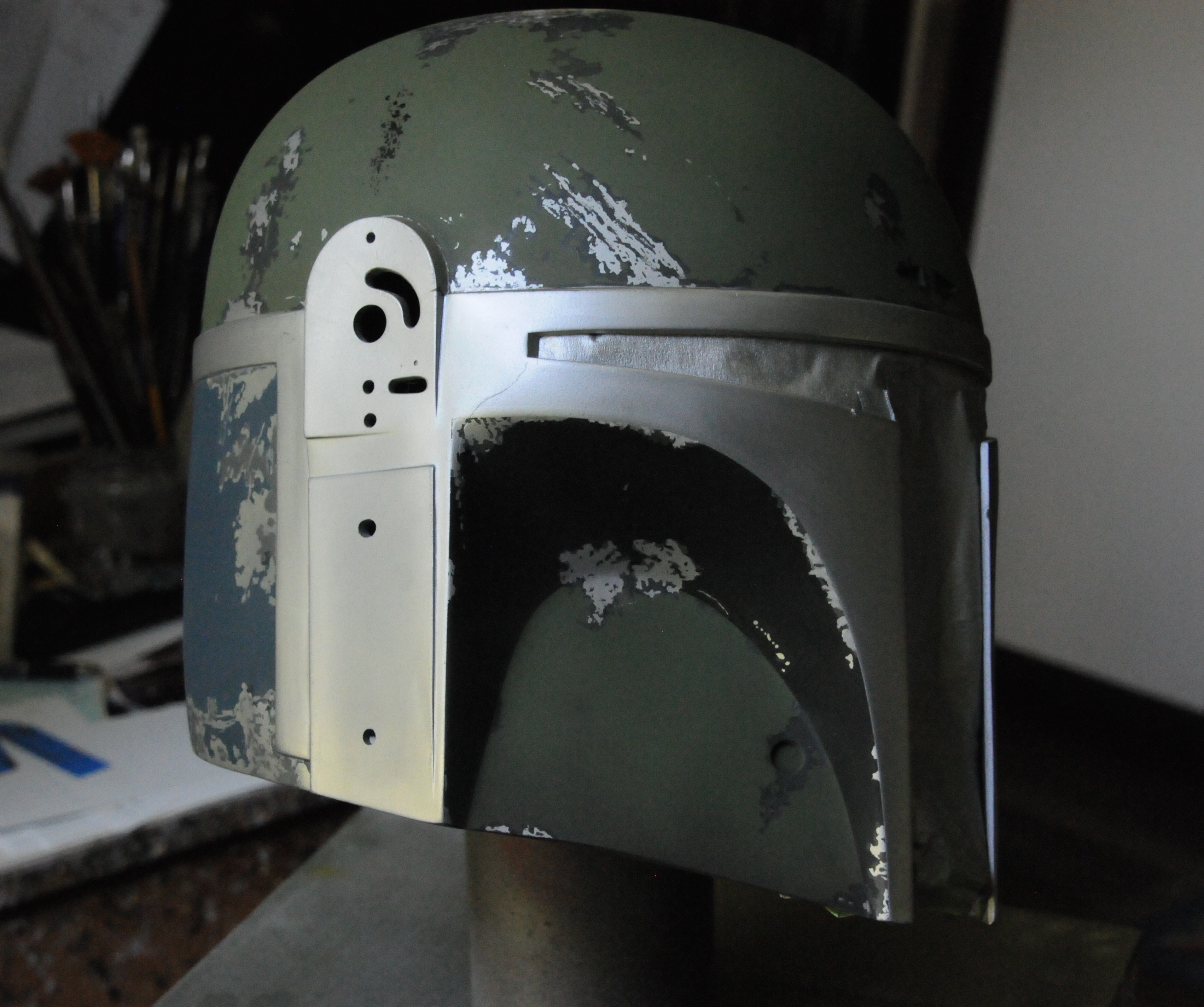

Rangefinder ear piece.....Wondering if anyone else noticed that in Post ESB Helmet pictures that the upper back half of the ear piece appears to be gray or silver and blends with the yellow tone at the top of the piece. In any case I painted ours that way. Just an observation.

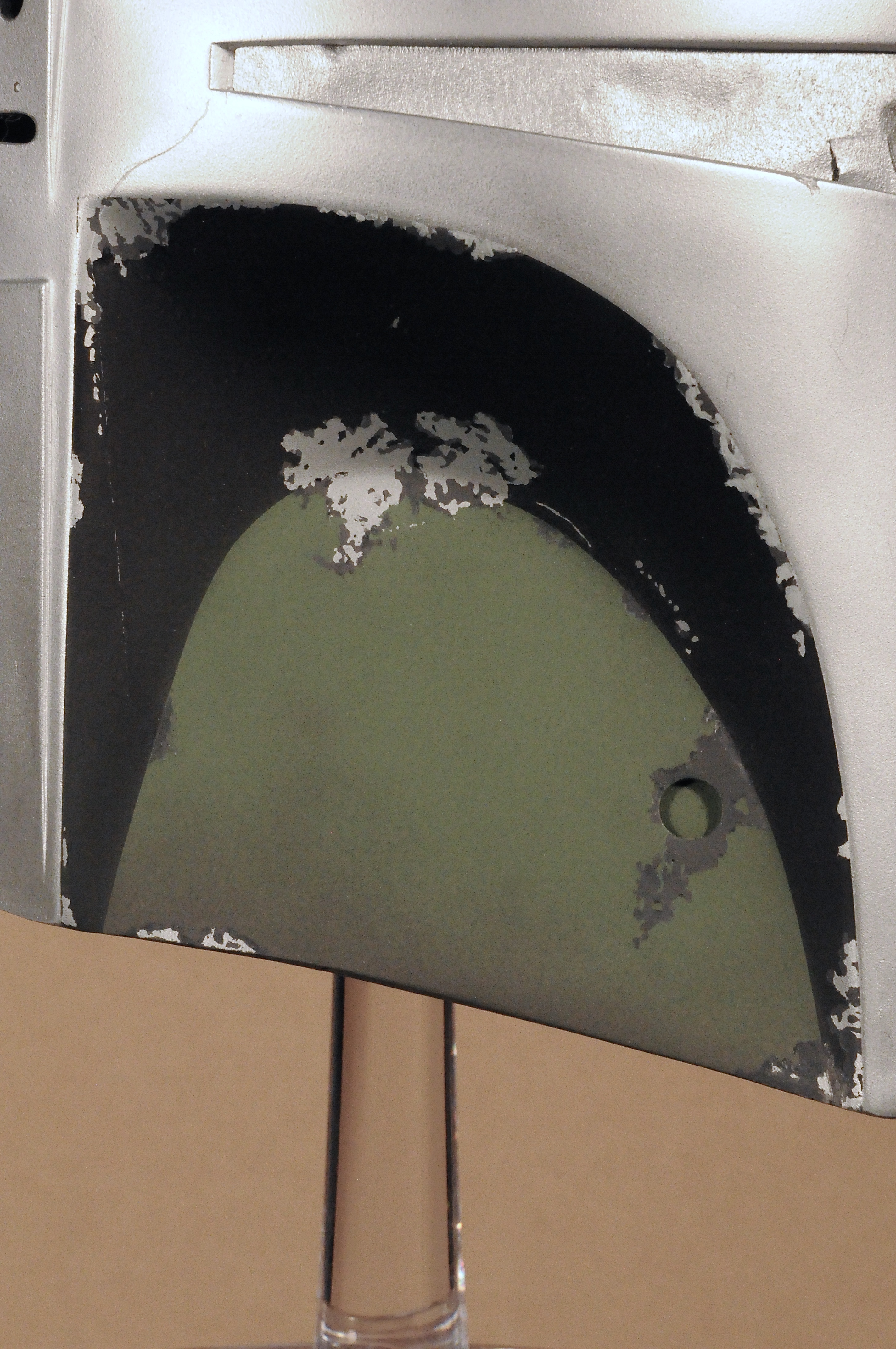

These two extreme close ups do show how the extra edge work gets rid of a lot of the liquid mask look. In person the weathering seems pretty natural to me. At least it was fun to do.
I never noticed this detail, but found it in both ESB and SE (post-ESB) pictures. It looks like it is not a blend of the silver into the ear piece, but a grey weathering that is a different color than the aluminum underneath (and the ear pieces do look actual aluminum and not paint based on the pictures... you can see some machining marks, which I think is interesting).
If it's good with you I'll throw out a couple of other thoughts on the color of this area of the ear piece.
If you look at the very bottom of the ear piece next to the rim in the SE picture you can see the worn edge (shiny) of the aluminum and a thin slightly yellow paint layer over the rest of it.
That yellow layer is also on the top section as well (very faint) but fades into more yellow as it moves upward to the top of the piece. This very thin paint over the metal changes the reflective quality
of that area and quickly makes it look gray in the light you have in the ESB shot. The combination of the thin transparent silver that I airbrushed over the yellow on our helmet did a good job of mimicking
the original thin yellow over metal that ends up looking gray, and non-reflective, when the two blend together.
You can see this blend,at least thats what I think it is, as non-reflective gray on the top section and the bottom point of the ear piece in the ESB photo.
If our ear piece was made of metal I think that I could have worked it out better.
With a little more thought I may try to do something about it . We'll see.......Great close up of the area...wish I had seen it earlier. I guess the main thing is to give it a gray blend one way or another.

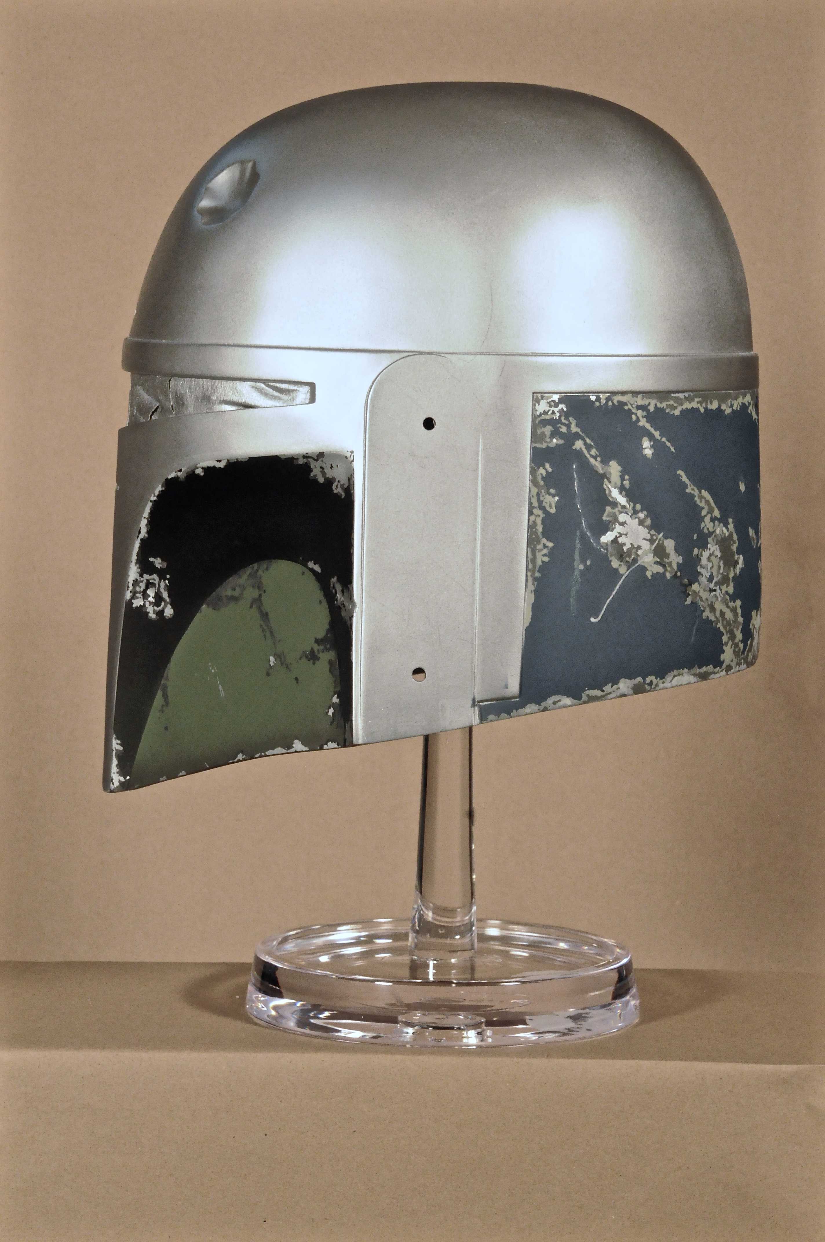

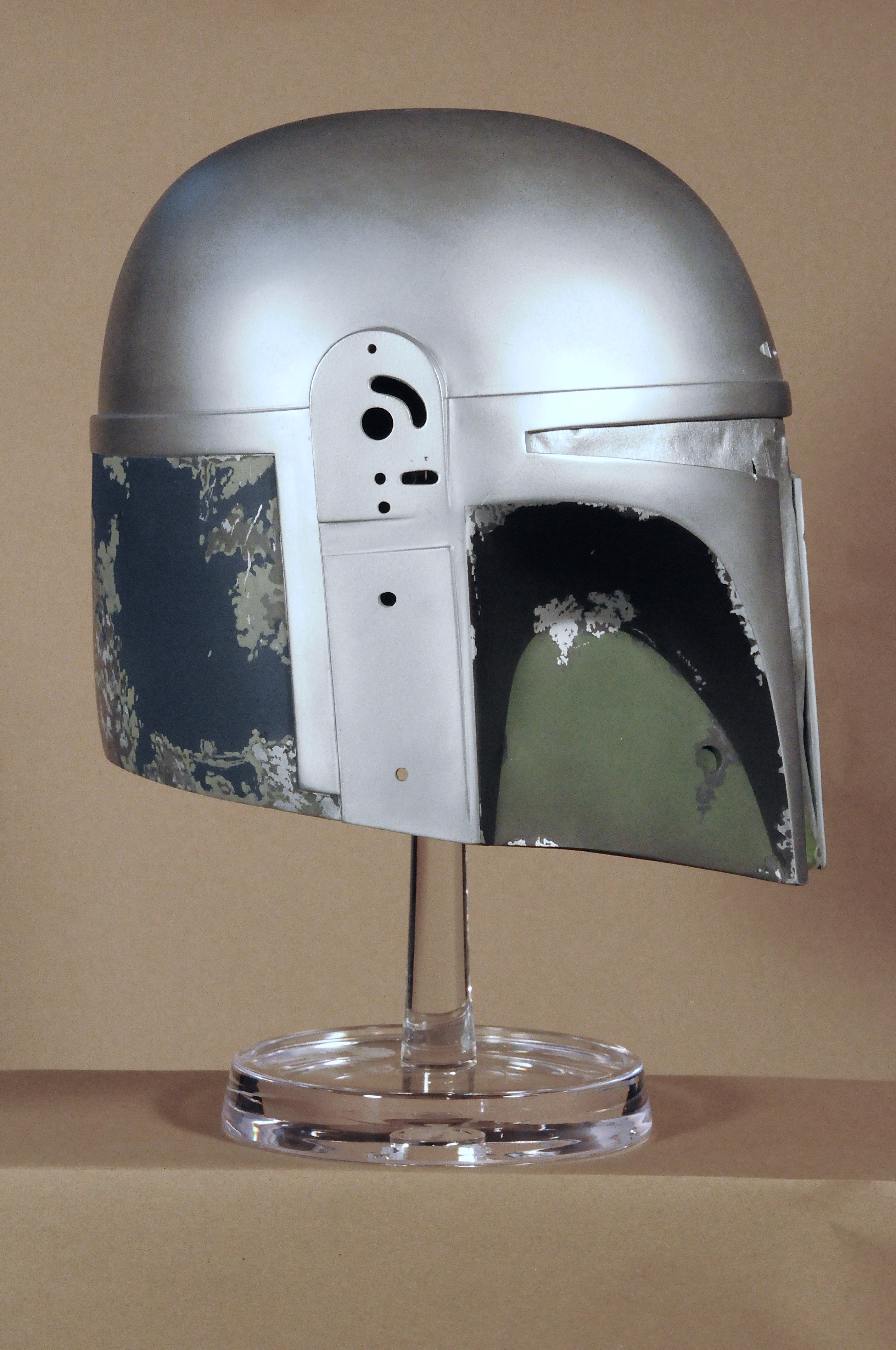

I'm one of those people that can't stop thinking about something. So I thought that I would try a little experiment with our helmet to see if
I could replicate the lighting in the ESB photo and what it would do to prove or disprove my ideas about what seemed to be gray on the back of the
ear piece.
Here's what I came up with...
Next to the reflective plain metal the silver dusted over the yellow looks very near gray in photos.
Because I'm just working with paint I used some chrome silver on the ear piece to represent polished metal. I'm going to leave it as I think it adds a little something
to the look of the helmet. Maybe an even more unpainted plain metal look like in the reference photo. For now anyway.

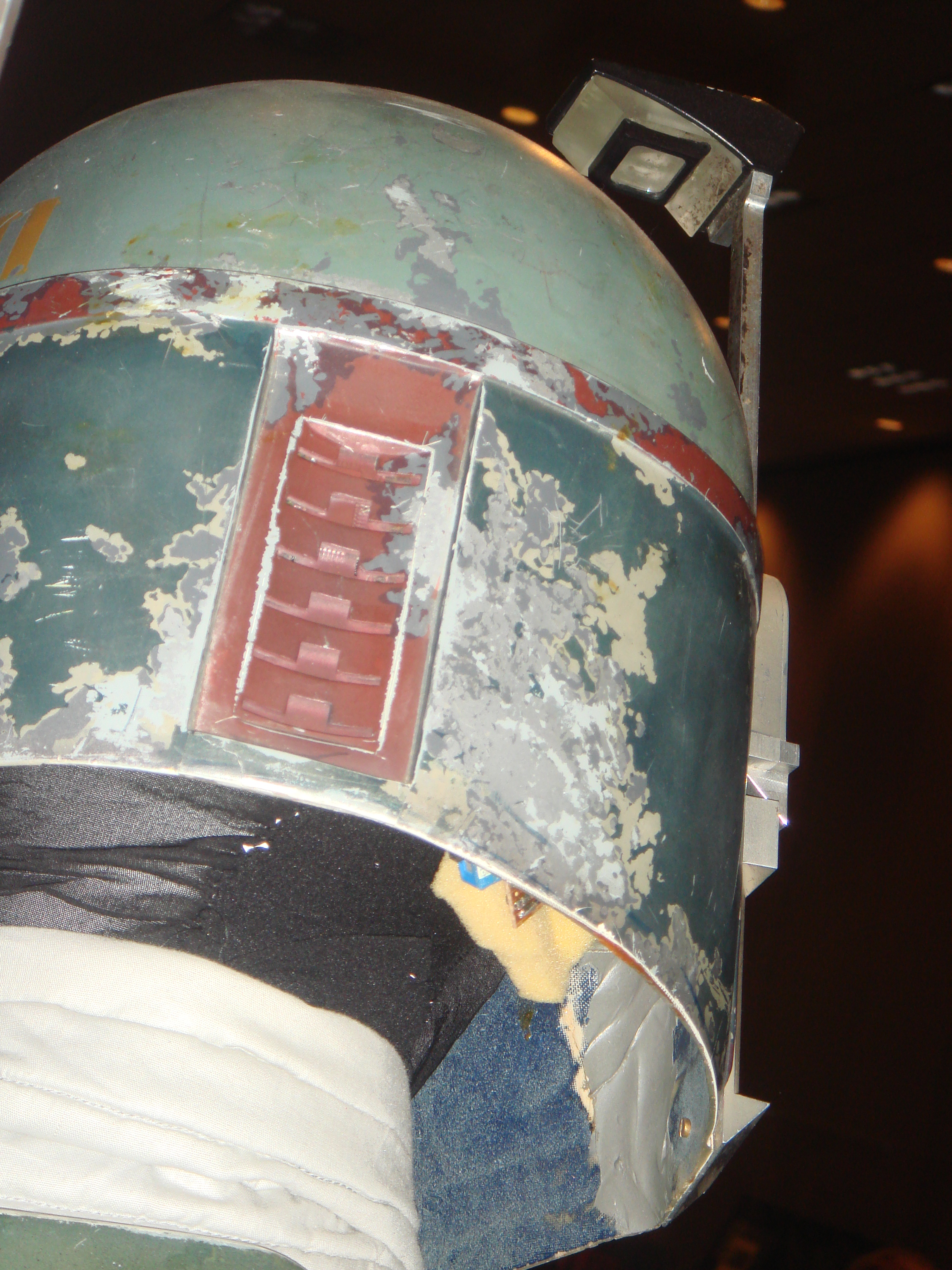

That whole area NOT just the ear has dark grey weathering over it. Look at the rear panel area of the helmet in the corner. Its not thin paint.... its weathering over top.
you can see this here, The ear paint is layered... dark grey under the beige.... and probably the same grey misted over top with the ear attached to the helmet while misting as it carries over into the back panel area

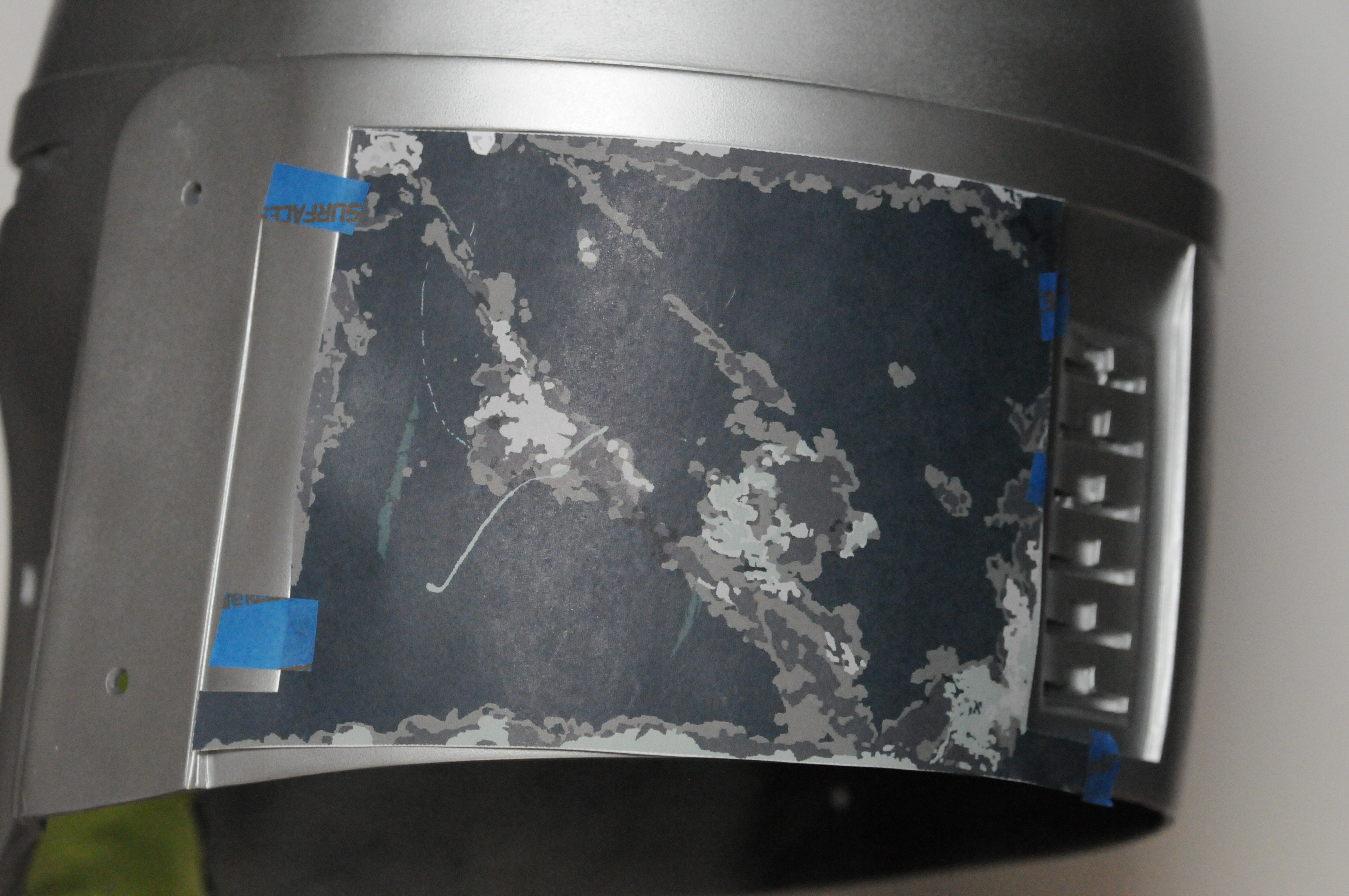

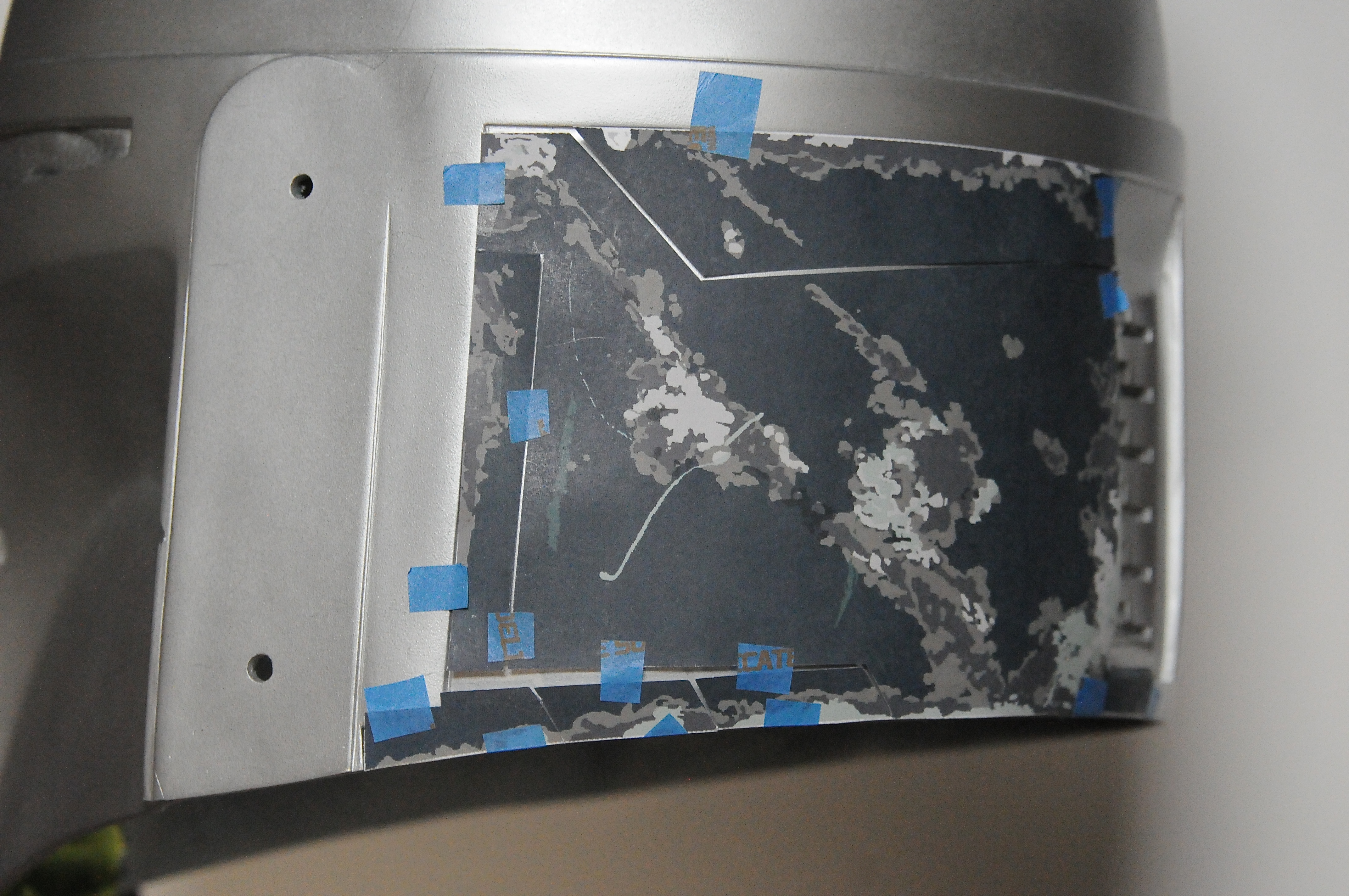

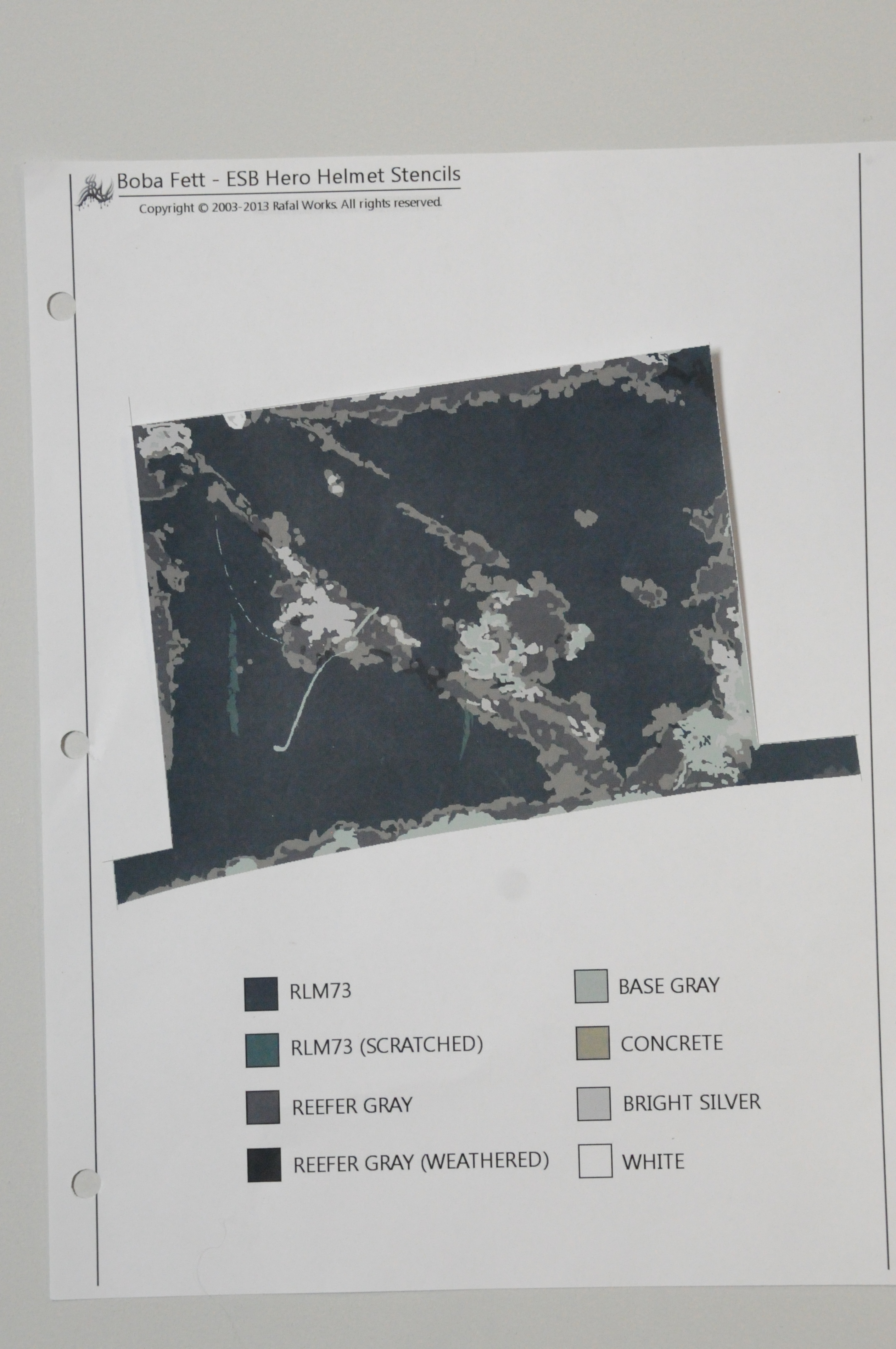

Like most I used Rafal Works Hero Helmet Stencils.It's buy no means the only way but here's the method I used to fit them to my helmet. I'll use a back panel as an example.
View attachment 160900 First size the printout as near to either hight or width as you can, keeping it inside the working area.

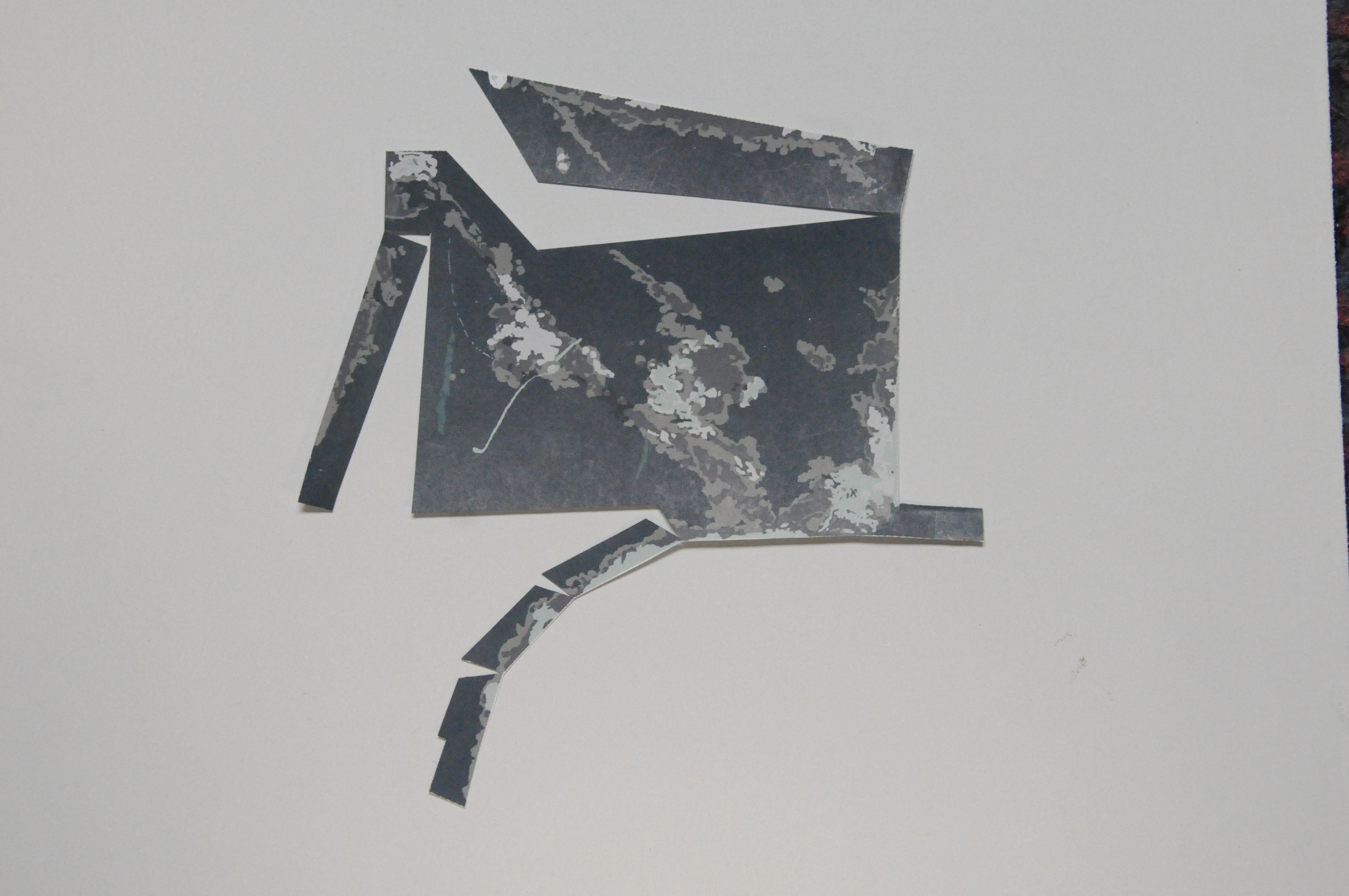

View attachment 160901 Once cut out it did not fit very well to the panel edges, especially the bottom edge.
In order to improve the fit I made cuts through the broad areas of the background,in this case the blueish tone, so as not to disturb the smaller details of the stencil.
View attachment 160902 Here they are opened up View attachment 160903 and now fitted to the panel.
Now it's an easy matter to transfer the cuts to each layer of the other stencil colors to match the panel you're working on.

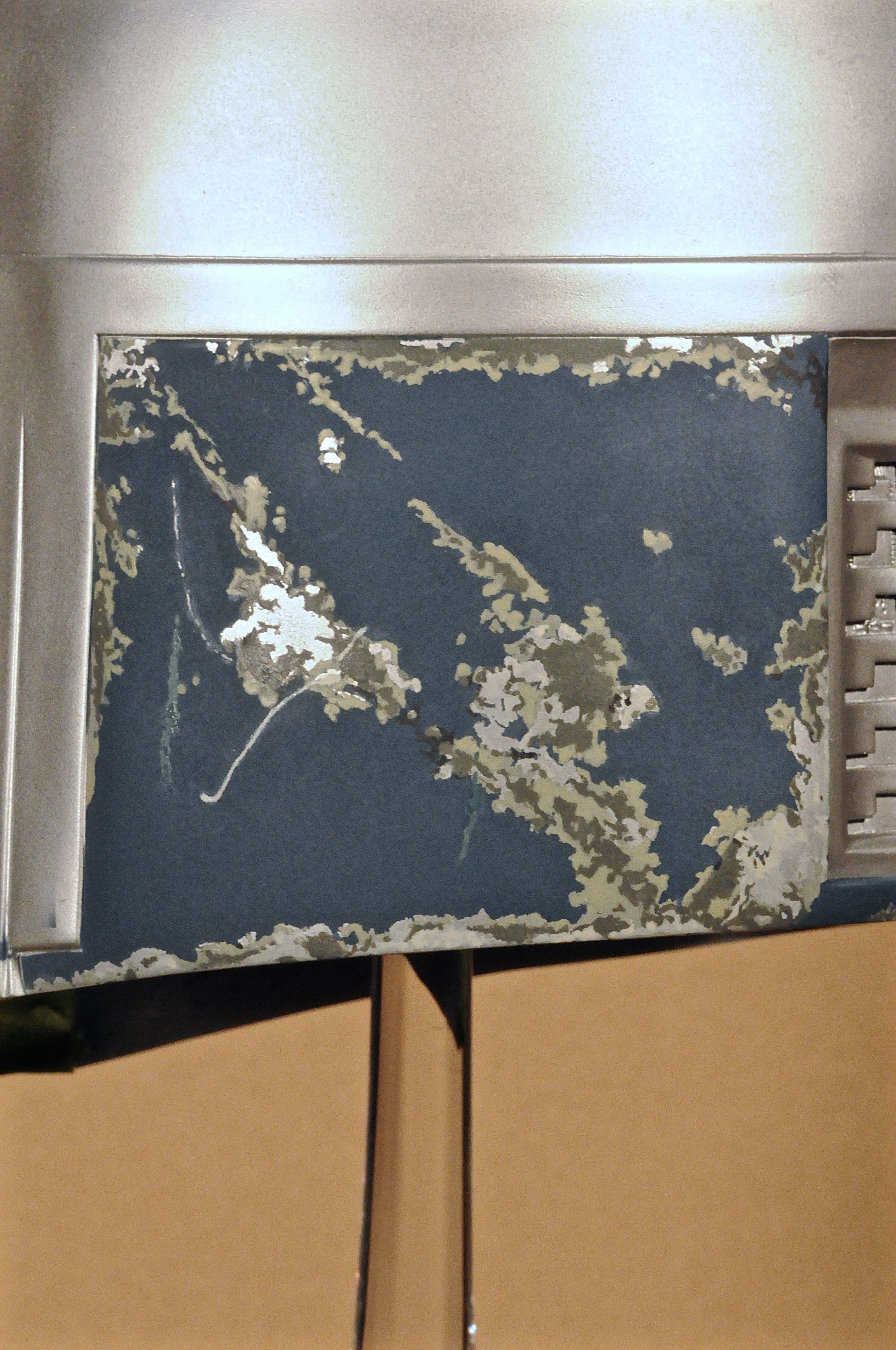

View attachment 160904 These are the first paint layers before the wash and other topical work.
I used this method on all of the stencil work. Made my own transfer paper using a soft graphite drawing pencil on vellum drafting paper....tracing paper will do.

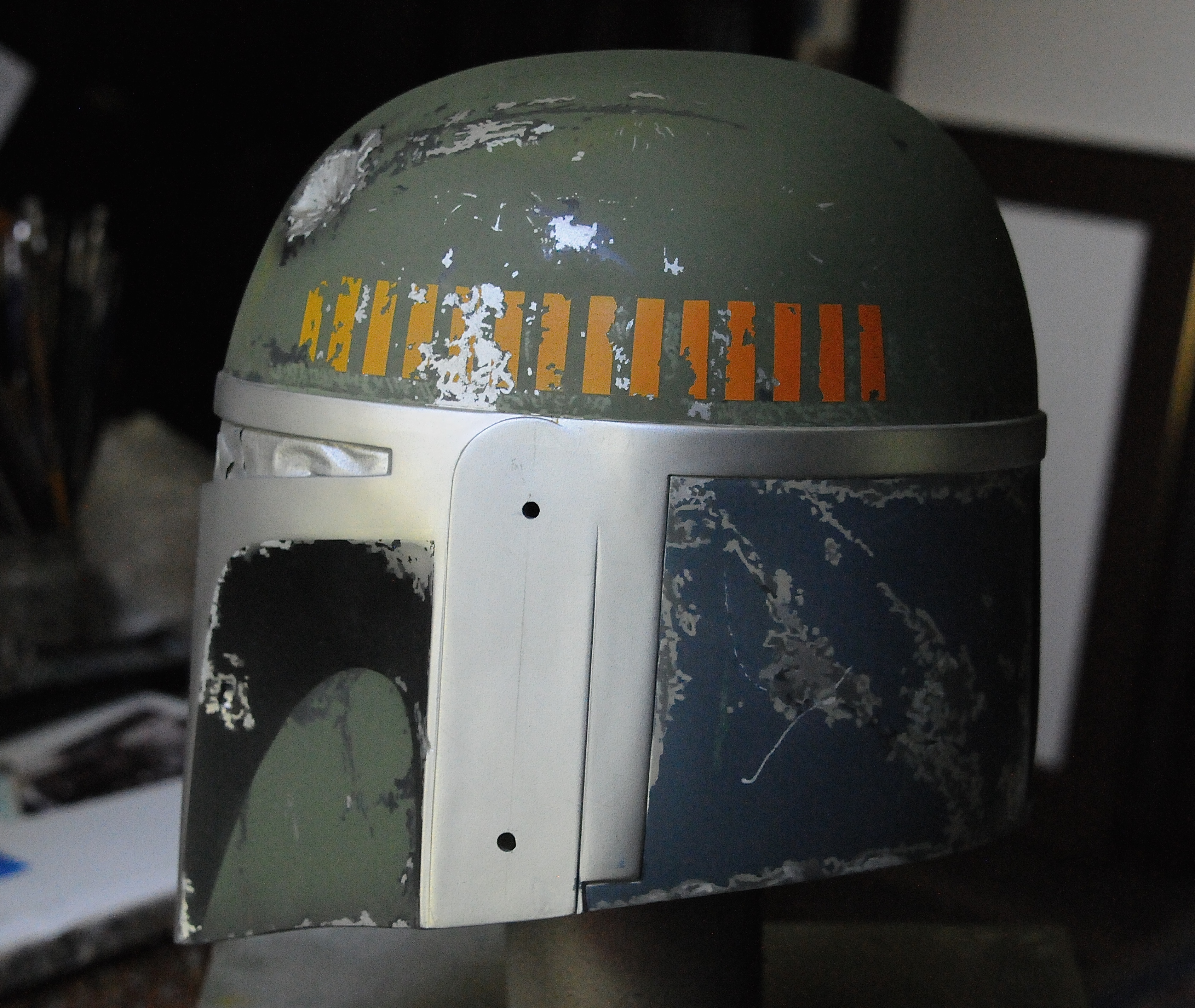

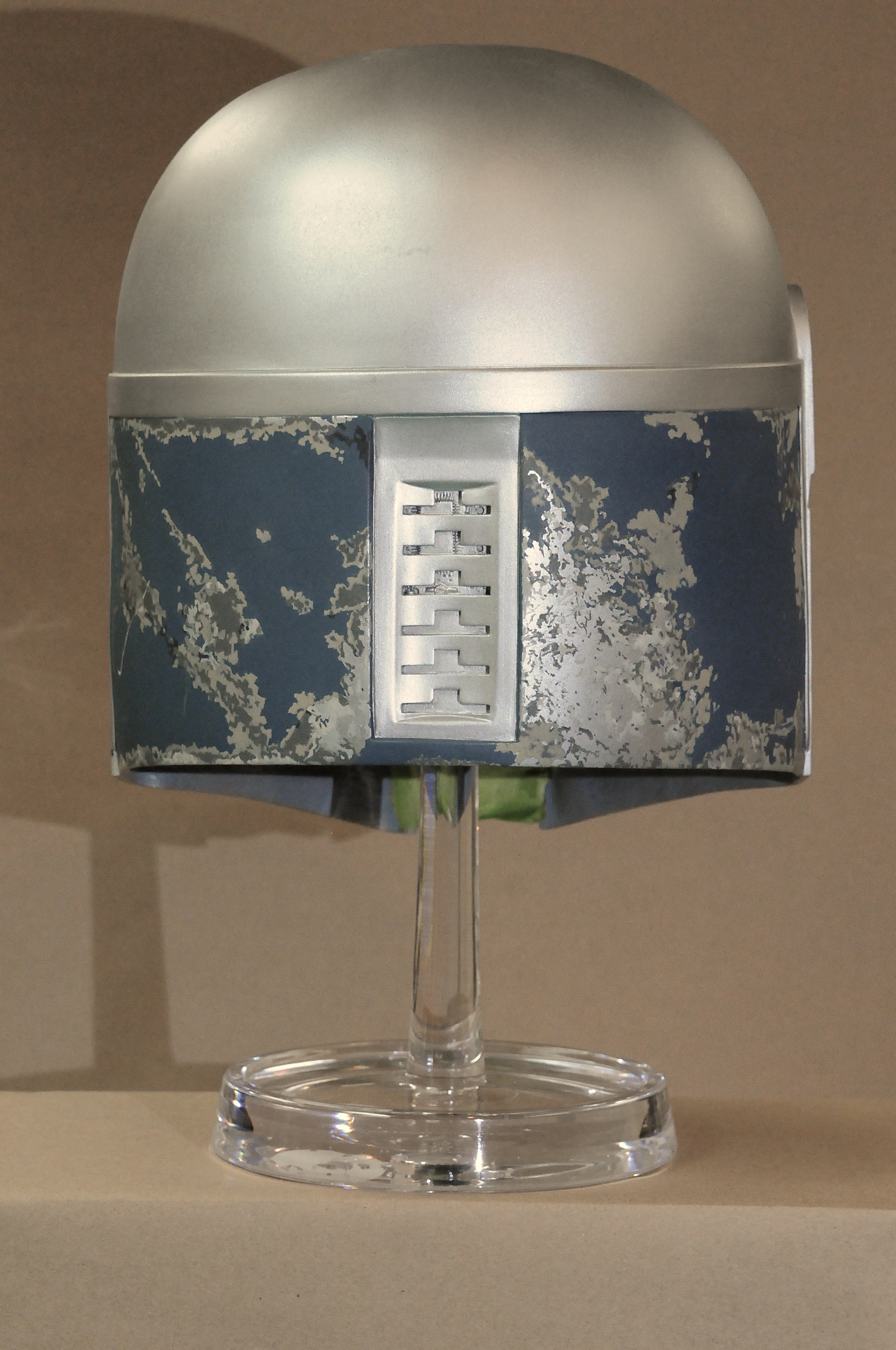

Some work in progress....nearing the half way point of the paint up.
View attachment 160905 View attachment 160906 View attachment 160907 View attachment 160908 View attachment 160909 View attachment 160910 View attachment 160911

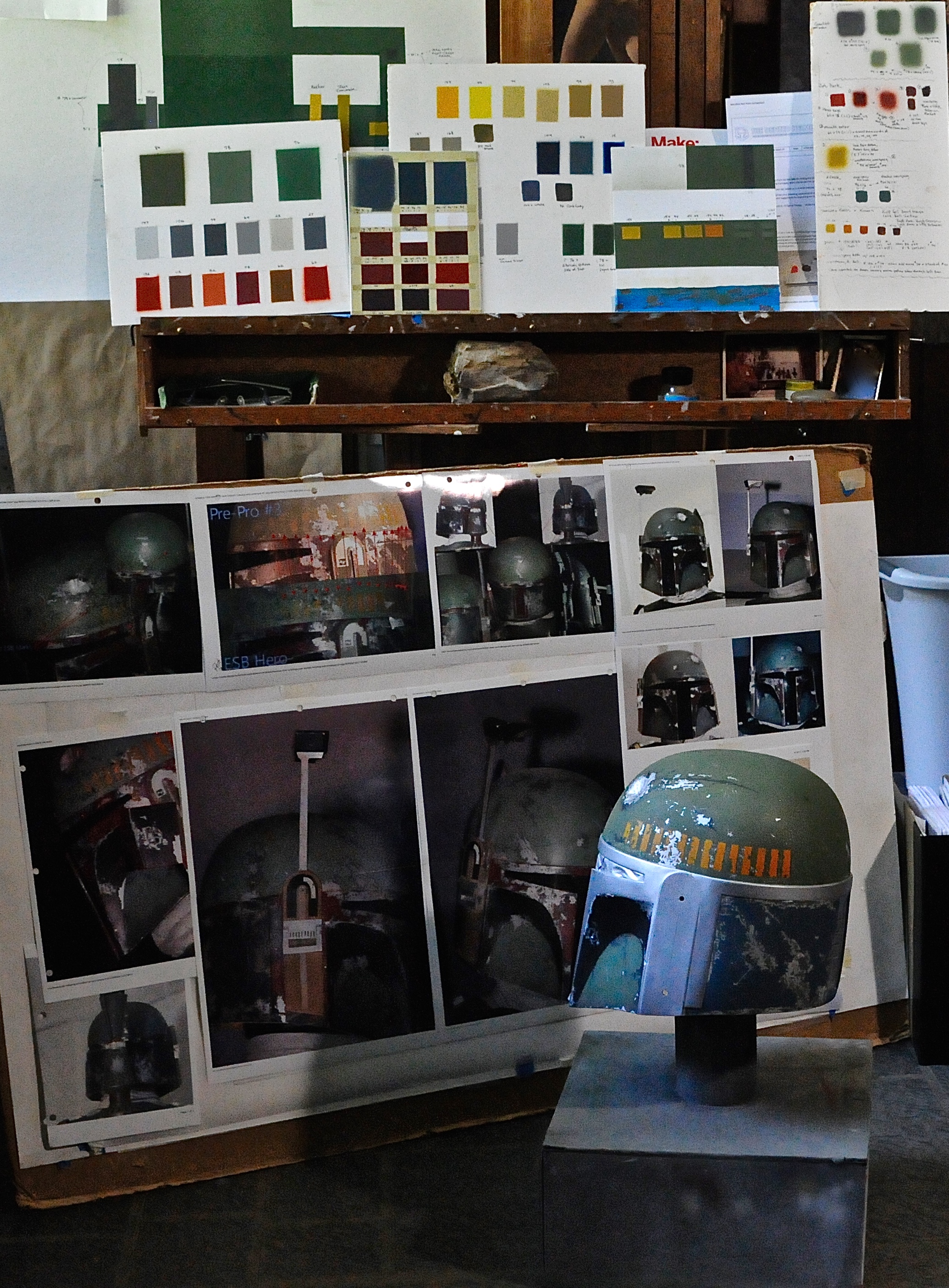

This shot shows some of the prep work research photos and color testing that kept me inspired. Been at it about a year and a half at that point.
The helmet was the final piece of the build.
