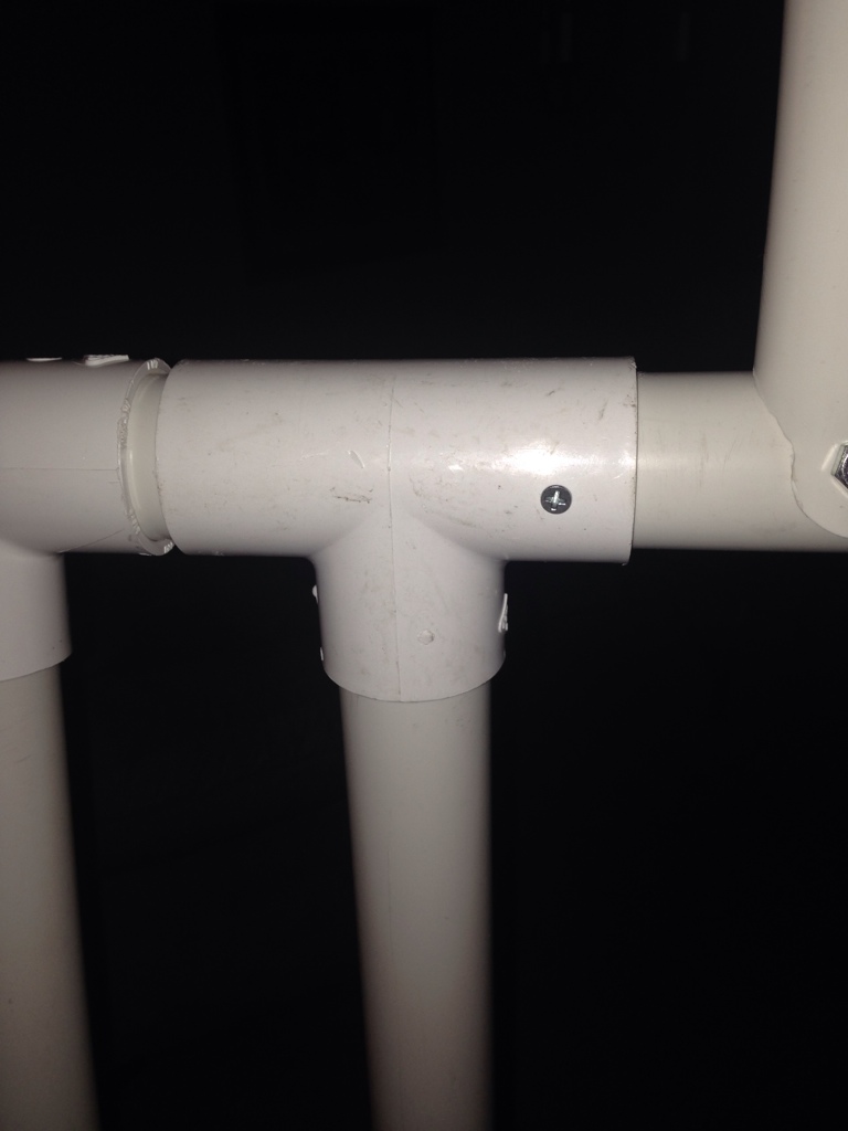

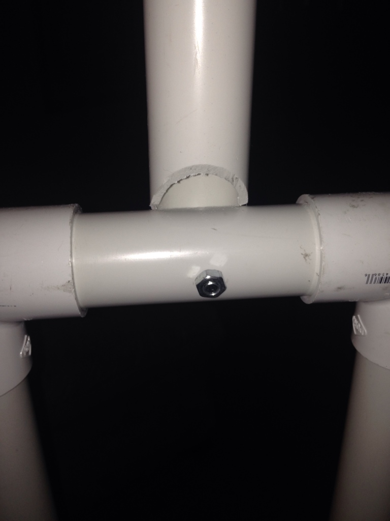

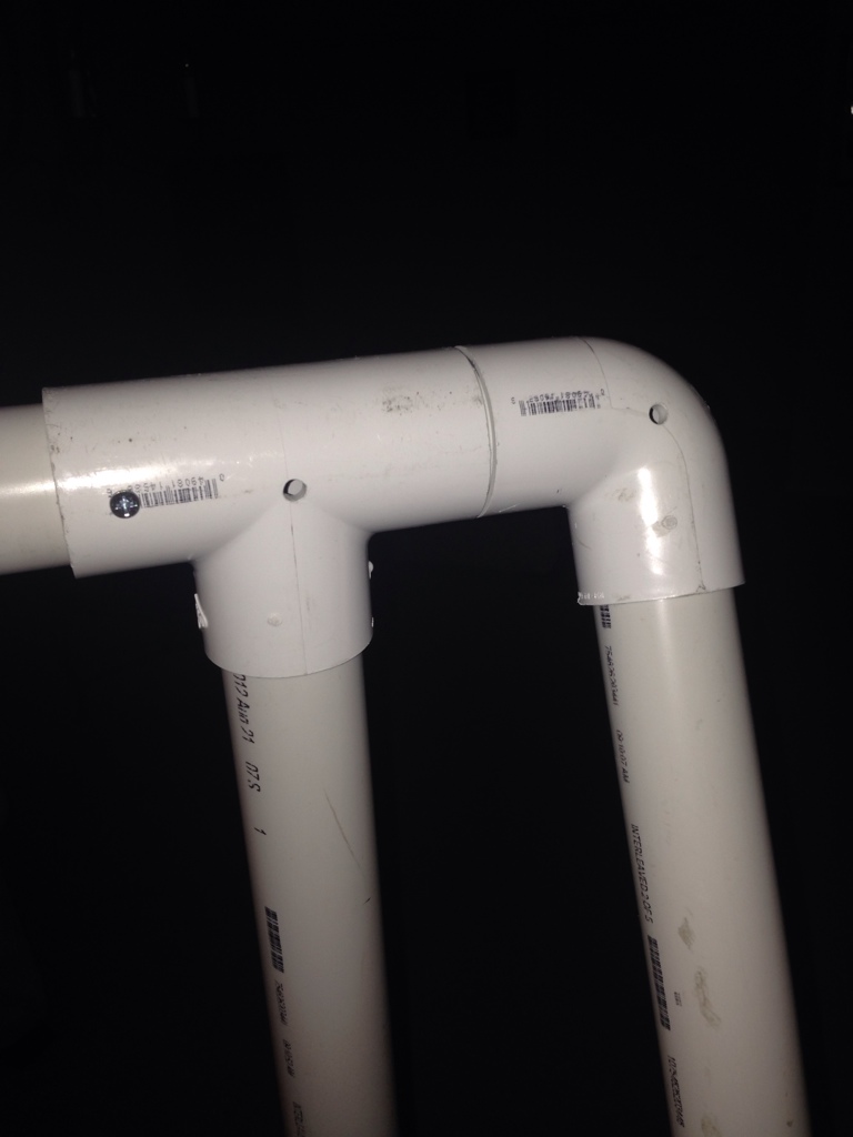

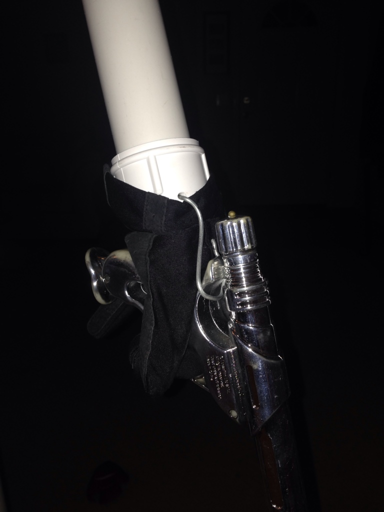

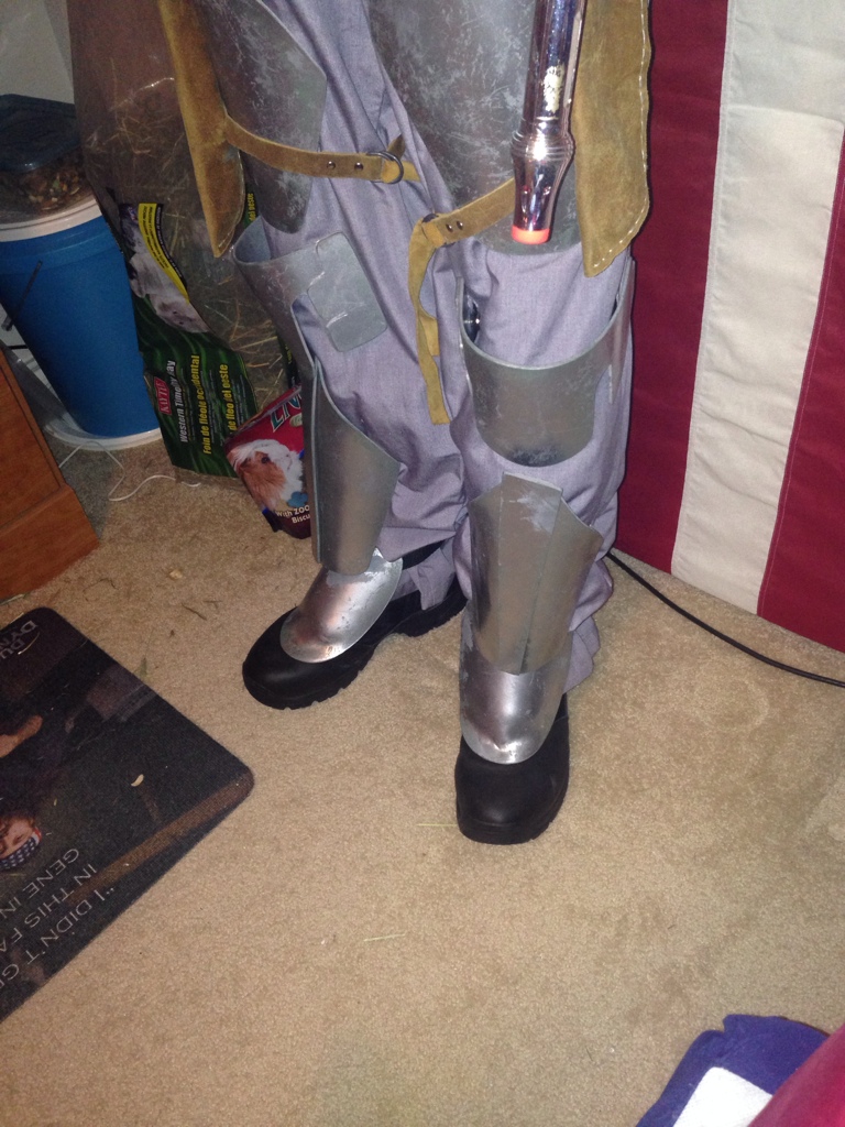

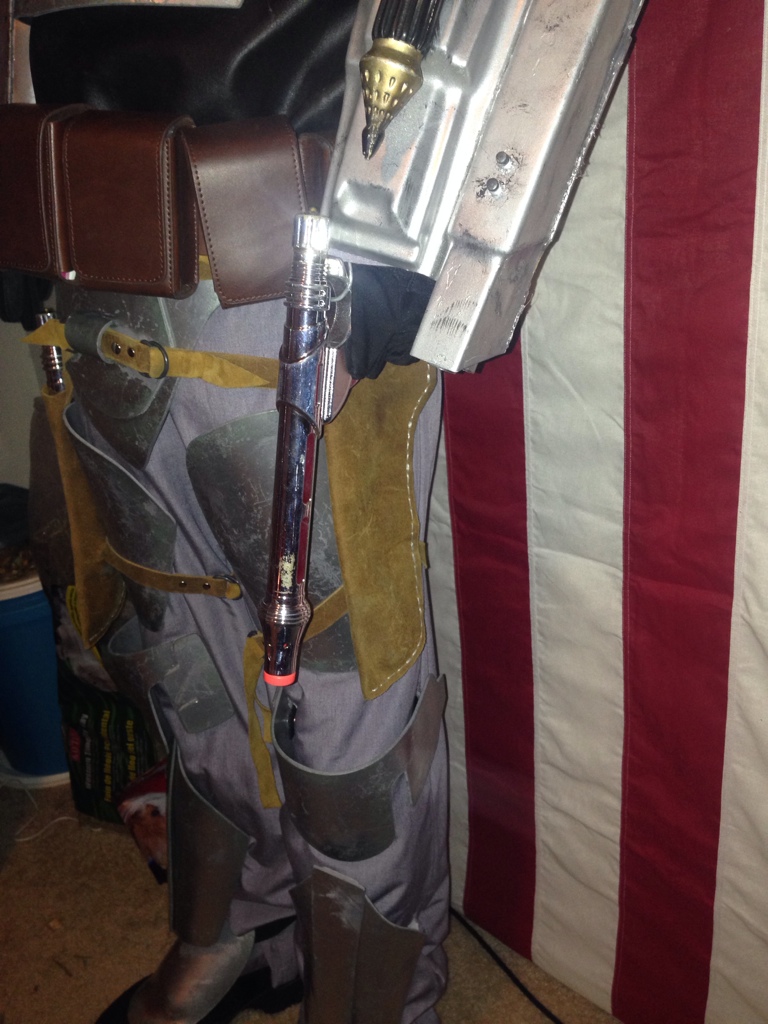

Now that you have most of the cutting work done it's time to assemble. At the end of the two longest pipes put the "T" joints (you'll use 4 of them) have them facing opposite direction on each pole. Choose your favorite end of each pole then add the 3" pipes to each side of the "T" joint. The ends with the 3" pipes add the other "T" joint connecting both poles. On that same end add the "L" joints for the arms then add the helmet measured pole to the top. Attatch the arms and end caps to the helmet pole and arms. And hopefully through my babbling nonsense of a tutorial it should look like the pictures. Now for the hands bend the wire coat hangers to the shape of your hand then attach them to the ends of the poles. Use the screws or bolts to make some set screws to hold the pose of how you want your mannequin. (Especially where the neck is or the helmet will fall off and you will have a national crisis on your hands!) and if you want bent arms for a different pose just add more angle connectors. I have mine leaned up against a wall because I have not yet found a way to make a base for it. (That's why this isn't a good idea if you have children) and as far as the helmet if it seems a little too far from the shoulders just trim down the neck pipe until you achieve the desired height. To stuff your kit I used towels in the legs and a pillow in the chest.
Now if your wondering why there's one big bolt in the neck I used some parts laying around the garage and didn't have the 5th "T" joint so I had to jerry rig one. If any of you find a way to make a base please feel free to post it here.
