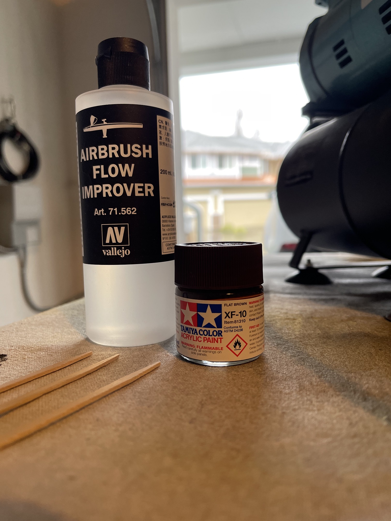

Based on other Boushh successes that I've read from some of the other members, I do believe the recipe calls for an initial Dark Brown, which consists of a mixture that is:
Tamiya Flat Brown (XF-10) = 60%
Tamiya Flat Black (XF-1) = 40%
Using a cheap 35ml mixing bottle I approximated the ratios and mixed er' up! I also used a tiny bit of Vallejo Airbrush Flow Improver.
And here is the end result!
Weather permitting tomorrow I'll give it the first layer of sprayed on Flat Brown, followed by the subsequent layers. My hope is to have the helmet in a position so that I can begin the leather work next weekend! More to follow!

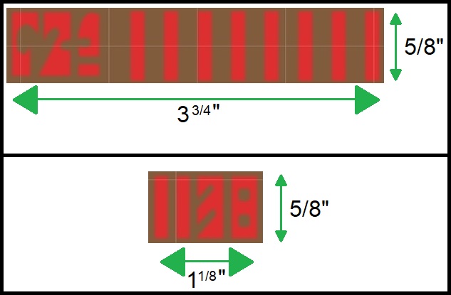

Next step will be to scribe in those areas and expose the chrome silver paint, and then I'm also eagerly awaiting for some stencils from my good buddy ShortFuse I hope to see them in the mail today or tomorrow. And those two decals are for the side of the helmet....
(photo credit to merkava74 )
These measurements should work out nicely for the Sandman Boushh helmet. Special thanks to merkava74 for providing the graphic! I guesstimated on the measurements.
I also need to mask up a ring that goes around the top of the helmet as well as the 10 black vertical lines in the back of the helmet. But I'm loving the way this is shaping up!

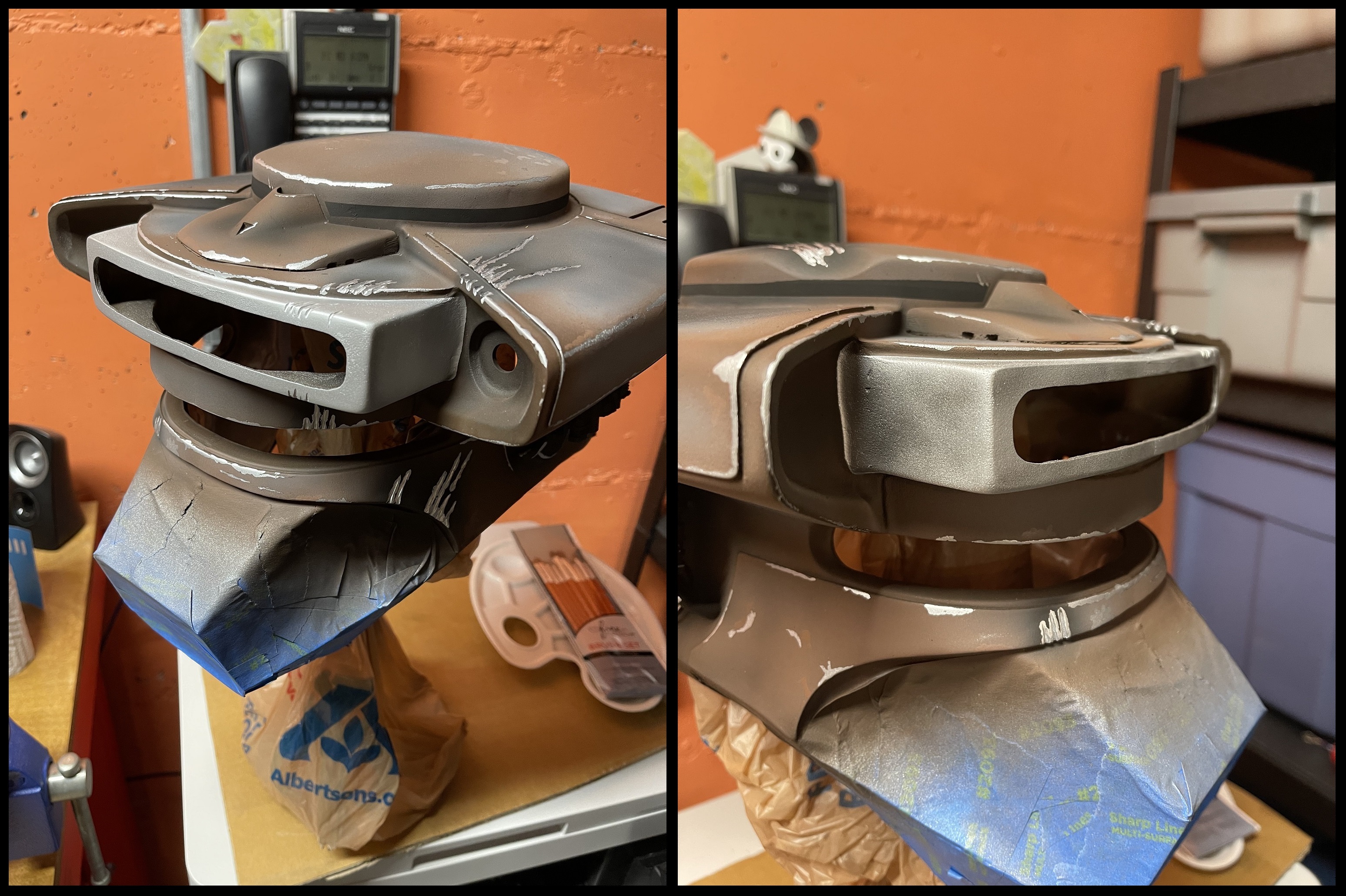

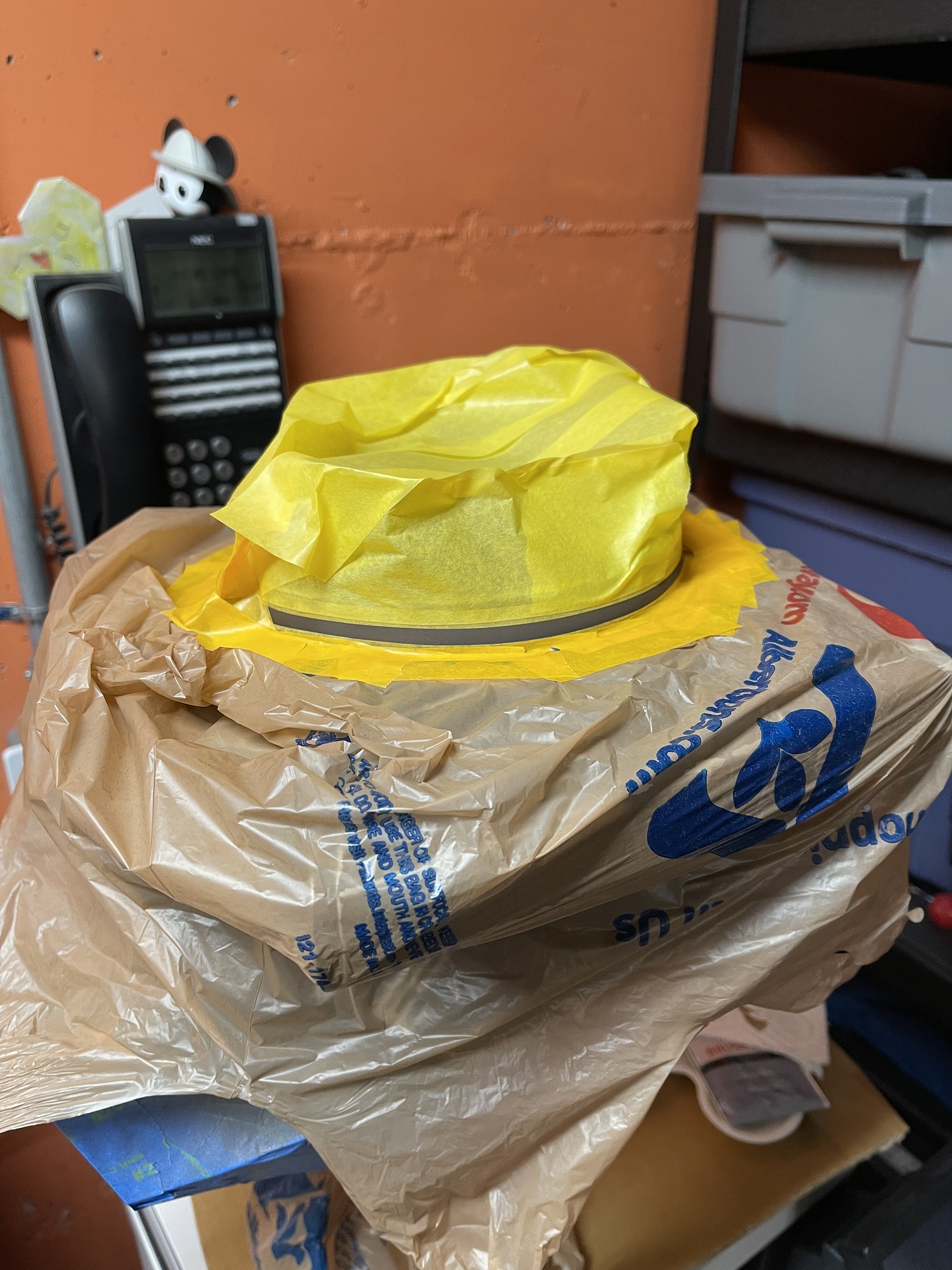

Today, I got the top hat piece taped off for a small black band that wraps around. If there is one thing I absolutely hate about painting is taping, some of those corners are absolutely terrible to deal with - and then overspray.....I'm always worried about that.
You can see that black band work below, but also, the LED Housing, I got that taped off and sprayed with Tamiya's Flat Aluminum (XF-16) and then weathered with some fine Tamiya Flat Black (XF-1) misting work courtesy of my airbrush....
From there I took to the rear of the helmet and taped off my own 10 vertical lines - again using Tamiya's Flat Black (XF-1)....

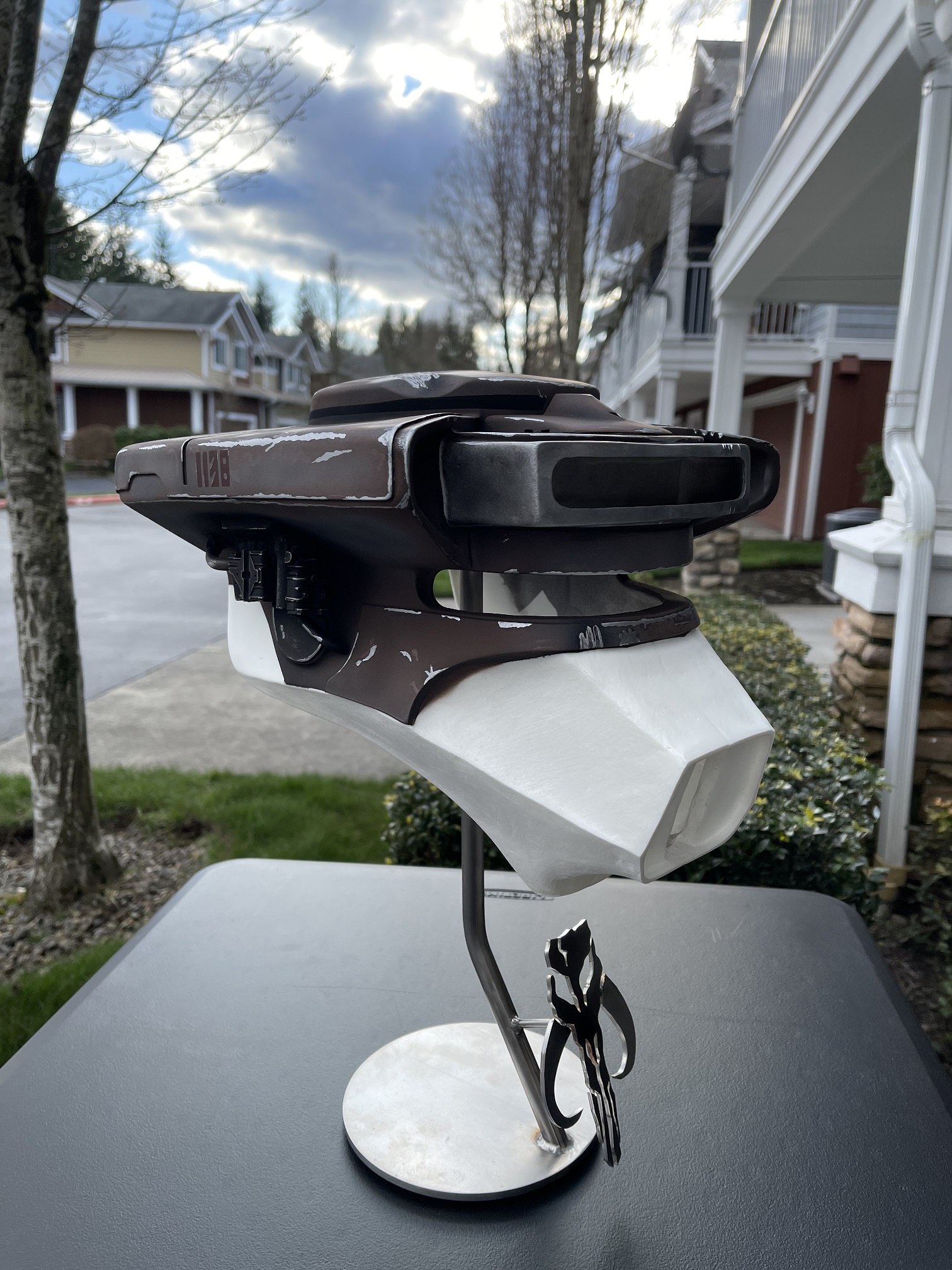

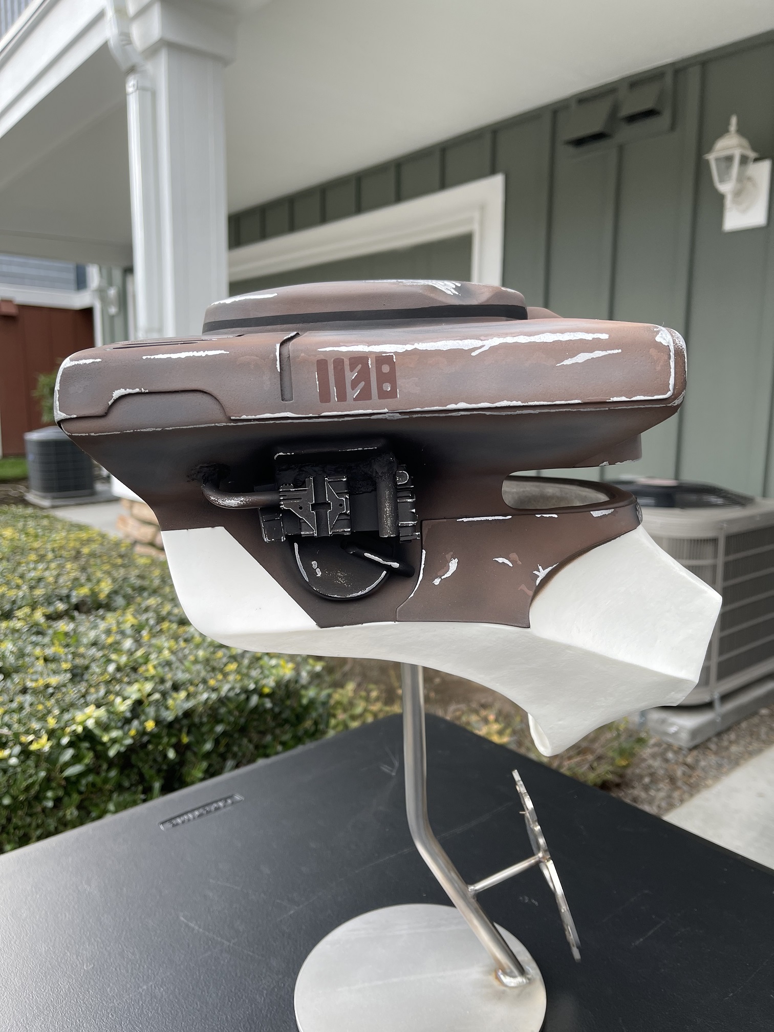

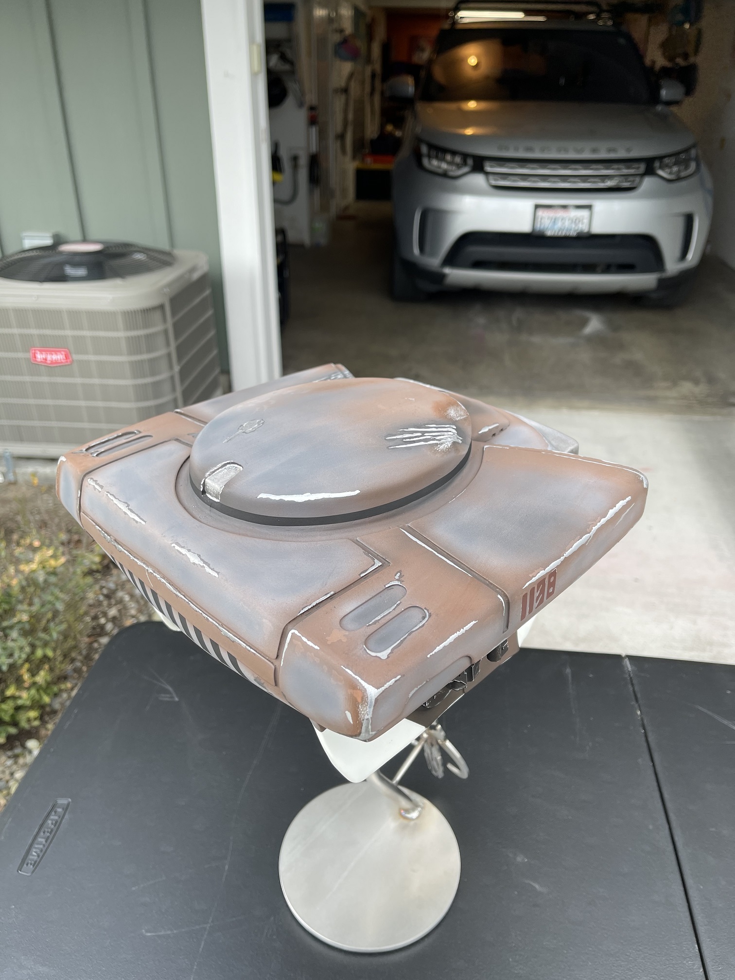

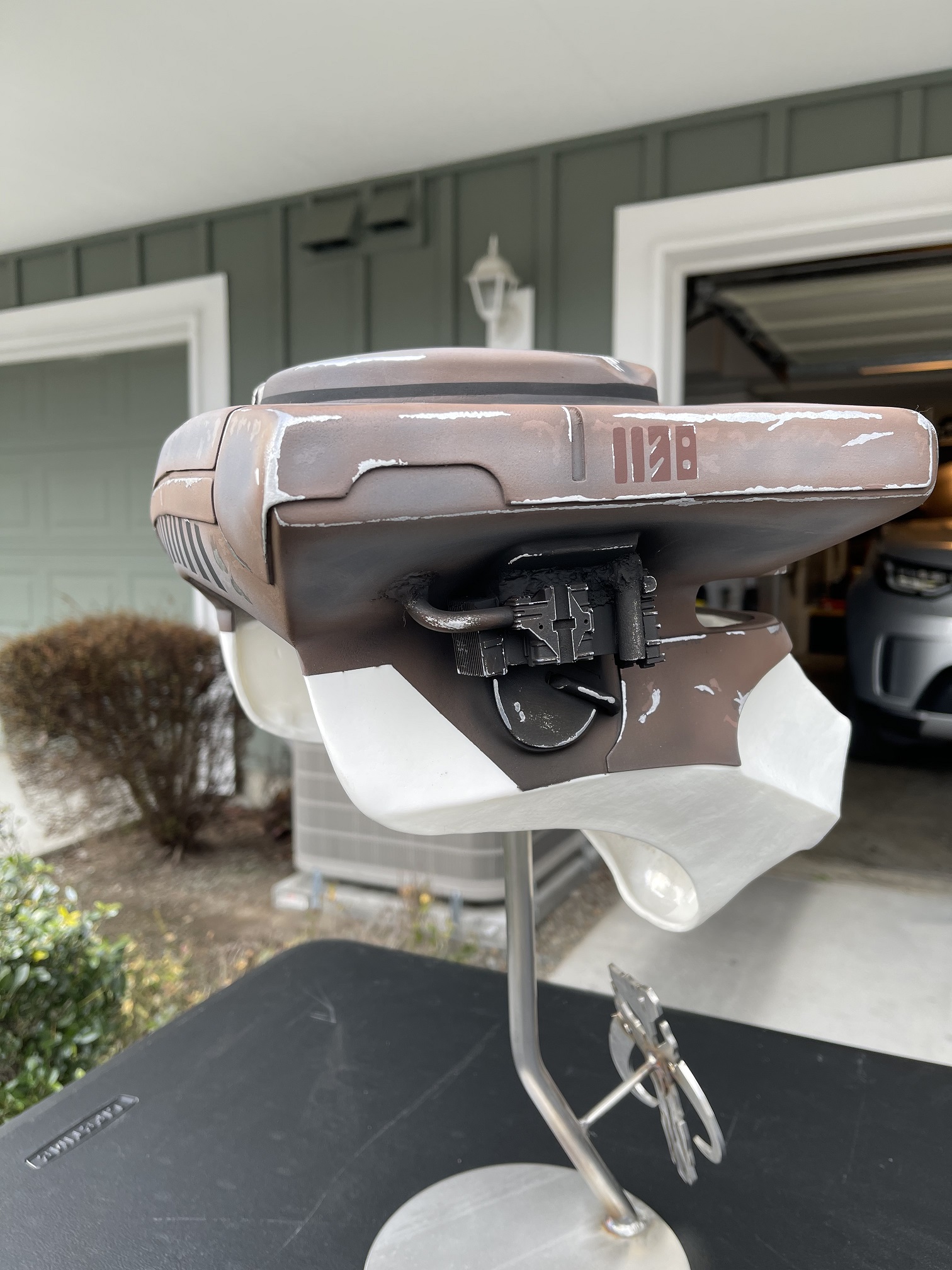

But I gotta say I'm really enjoying this paint up. This is really starting to take shape, just a few things left to do regarding weathering and etching in some additional scratches as well as a wash. Then I can get crackin' on that leather work. I have something very special in mind for the antenna piece - but more on that a little later!
-Iron
Another Update!

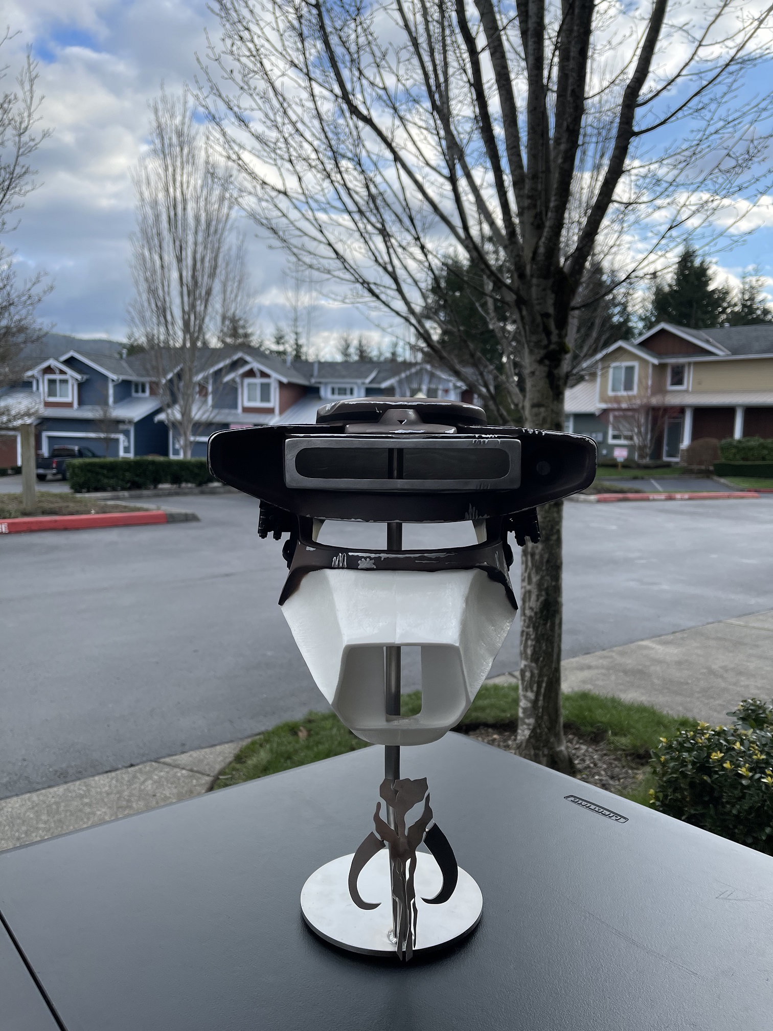

Some final weathering before I call this helmet good to seal. First off, it is pretty amazing what a little #0000 Steel Wool can do to further weather an area. Take for example the ear greeblies....
Once again, another benefit of spraying the entire helmet with Tamiya's X-11 Chrome/Silver and exposing it underneath the black paint. This took me all of 60 seconds to achieve. It was my intention to dry brush this area, but it seems this was just as effective if not easier to do.
I further weathered it with some more scratches and then gave the scratches and exposed chrome/silver a wash with Vallejo's Model Wash 76.518 (Color: Black), this wash dulled it down and gave it a grimey and greasy look to it. I also used Vallejo's Game Wash 73.203 (Color: Umber) to a few key locations which gave off a brown dirt like element to it as well! And here is the ending result of my hard work....
(Warning: There are 10 pics ahead of you!)
For those interested the ROTJ Mythosaur stand is from David Neth I'm presently talking to him about getting a stand with the Rebel Alliance symbol on it for the Boushh Helmet.

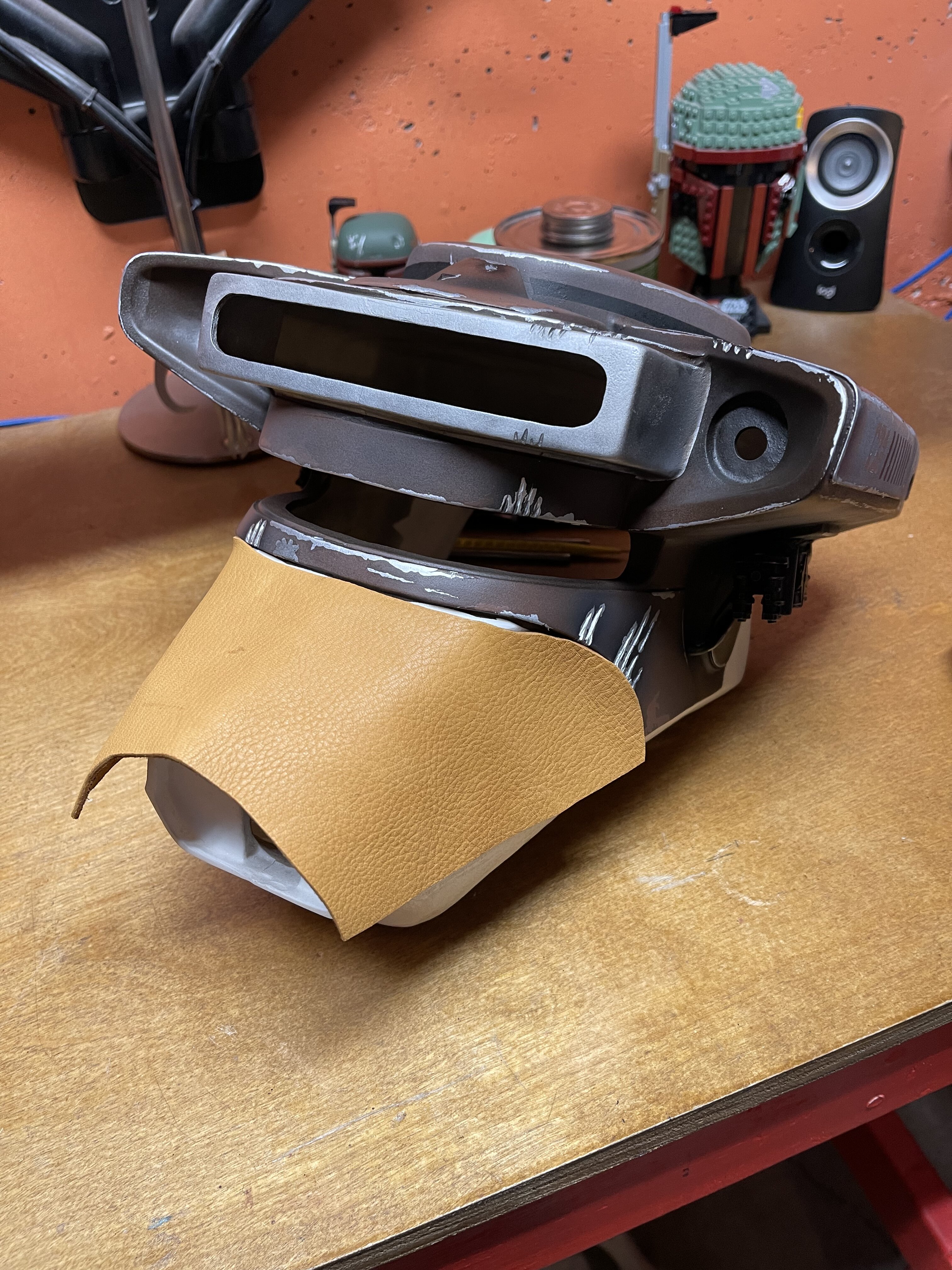

Nothings done....yet, but I'm getting setup!
As a recap, this leather kit was purchased from "Boushh Build" on Facebook (Also known as "Alvomedia" here on TDH). I even went out and got a brand new pair of Fiskars scissors for this part of my build so I'd have something razor sharp!
Alvomedia also put a couple great YouTube videos on how to do her leather work, so that will be my reference. Those links are:
