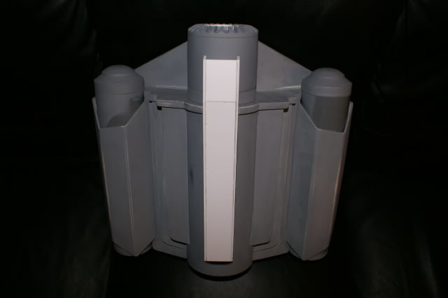

Hi Dents. Not updated this for a while due to putting the finishing touches to my Fett. Anyway, I have been working on this recently and thought I would post this for all those who have shown an interest.

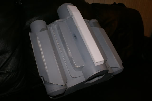

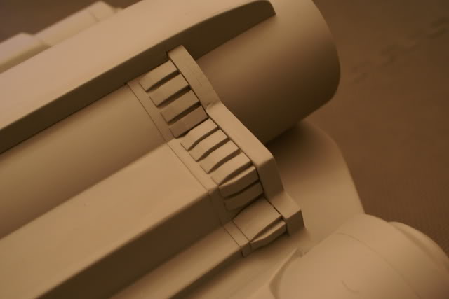

Cheers Joe. Just got the 'spine' added and got the end caps sorted. Piano keys next and the main body will be ready for the next stage!?

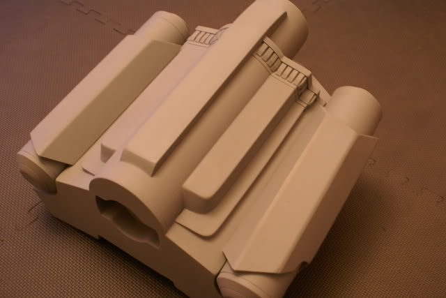

looks great bobby,alot cleaner than mine........ how are you getting the joints so smooth??do you have the rocket thrusters done yet??

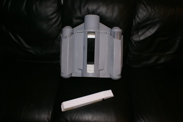

I have not got much filler on it. On this build I worked harder on getting all the bits equal and the correct size. After building the first pack I understood cutting and working with sintra (foamex). As an example, for the spine I have cut out the section in the centre of the curve and made the section to insert from the rear (the top part fits over the top shelf and sits infront of the wooden missile housing. The section was of a solid enough construction to not require the pack to support it. I will then use the hot glue gun to fix it into place.

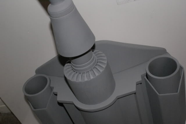

The bottom of the thrusters are made, working on sculpting the ball sections next.
RD, you can do it buddy. Take your time cutting out your sections, it goes together so don't rush it. Check out Jango 72's build also, it inspired me :thumbsup:

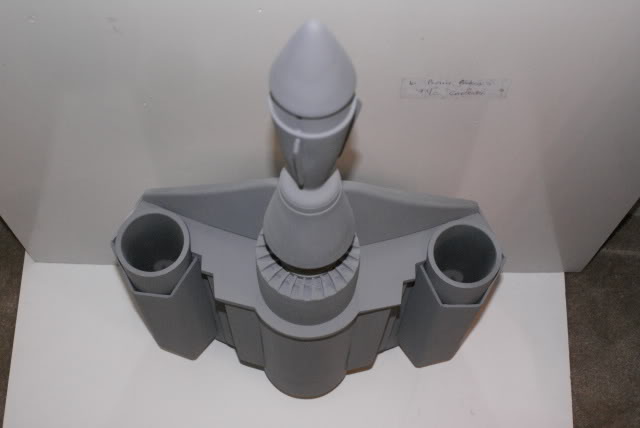

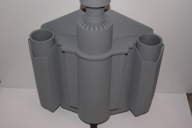

Ok, a few (poor quality) shots. The pack has had a quick sand since the first coat of primer and some areas identified as requiring renforcement to make sure it will not sag or loose shape if it is to be molded.

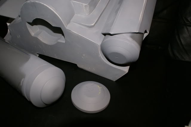

Here are a shot of the end caps too.

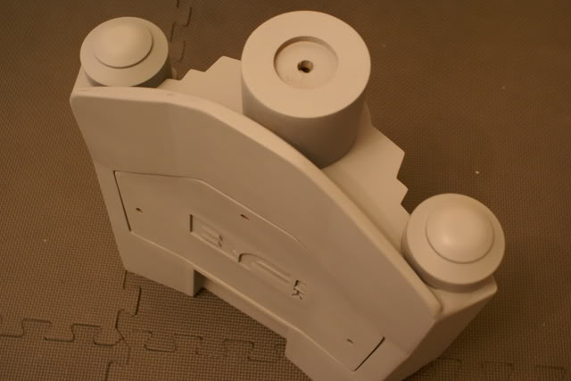

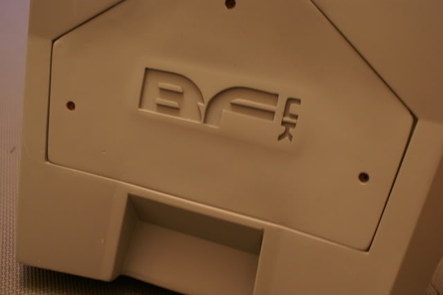

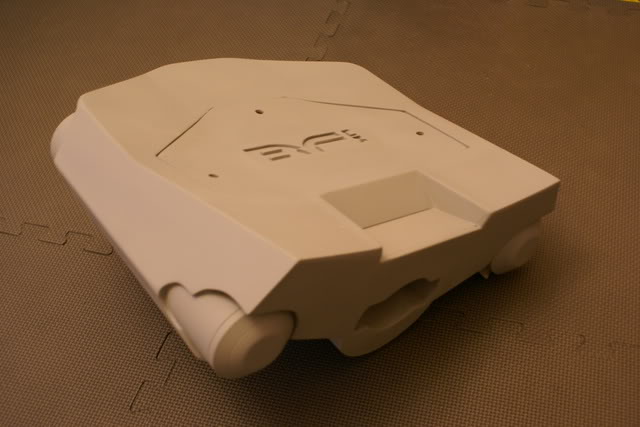

Still some rough patches but you get the idea, and yeah, so proud I put my name on it :lol: Working on the door closure and final fitting at the moment.

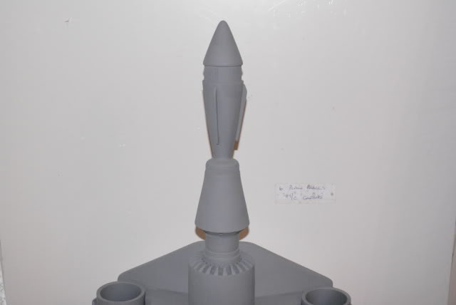

The missile is pretty much unchanged for now, but the missile housing detail is to be redone (more accurately).
