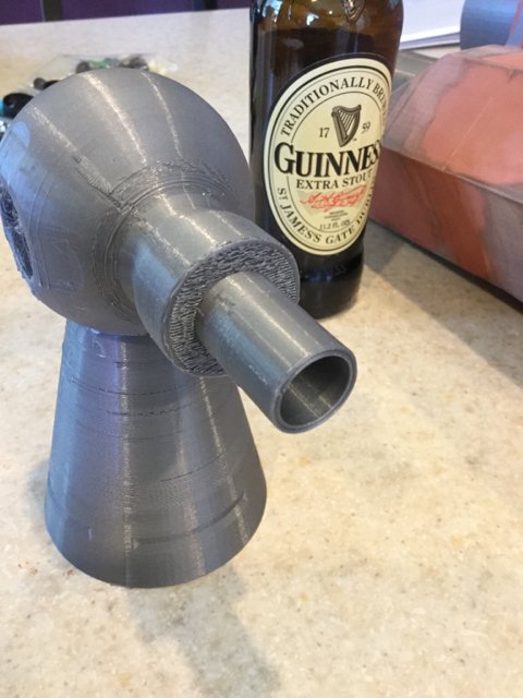

Raf, one thing to consider fixing, is where the thruster meets the cap. Gluing a flat surface to a curved surface greatly decreases the surface area to be bonded, making it more weak. Other than that, they fit perfectly together. Very pleased how this came together.

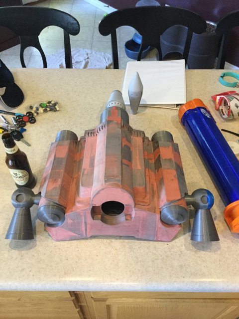

I started printing pieces off, and the rocket is coming along well !! (Though, I couldn't find the top rocket part in the files, I had my own I tried cleaning up, but do you know which file it is?)
Hope I can clean everything up as well as you have!! How do you sand inside all the notches? Like the base of the rocket? Also, do you think 10-15% infill will be too weak?

I apologize for that. I forgot that had to slice the two apart...I'll add em.
Sent from my iPad
The tank caps model posted on Shapeways already has the outer hole area flat, specifically made for the thruster:

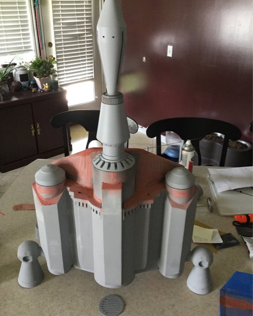

I've got pretty much everything printed, glued on, bond'od, sanded, and primered. I sprayed a coating of plasti-dip on the inside, as I'm installing a water cooling system for my suit. I just have a couple small spots to fix, and its off to my weapons painter. I'm so ready for this to be done lol. That reminds me, I need to find paint templates...

How's yours coming along?
Honestly not too great lol I've been trying to play around with the files, but the DaVinci slicer must be different than yours and I guess the couple of pieces (ie. The place below the rocket base , that holds the rocket) get sliced and then there are tears or it shoots random geometry. I tried cleaning it up on MakePrintable, but that was just as bad. I may try slicing the pack on my own maybe. Unless you have updated files? I could try the rocket and thruster files as mine were okay, could just be that one piece. Do you have the new files ready? I'm way too jealous of your pack to stop now xD
