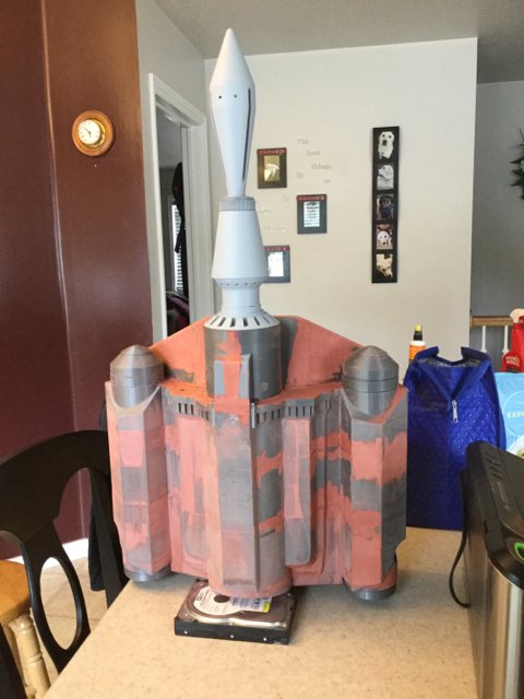

Here's an update for my jetpack. Almost got the main pack done :)

That jetpack looks more than great! Did you have problems inserting the tank caps or other main parts?
The only one I had trouble with, was the lower tank caps...they were a super tight fit. Everything else was just the quirks of splitting files and fitting them together. I'm lucky with the glue I used...bonded the parts within 10 seconds solid...allows me to work with corners and such while it hardens.

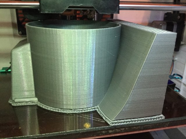

As promised, here's the files that I split. They're cut to fit on a 230X150X140 bed. If you need them smaller, just download the jetpack and load it into Netfabb like I did, and slice away. I believe these should all be cleaned up, but you'll have to orient them how you want. Like I said before, there's a couple of parts that use a lot of support...apologies, but I couldn't do it any other way. I've also included a pic for each file showing where it goes. If you have any problem with the files, let me know.

How much is this going to weigh?
Mine is about 6 lbs. You could probably drop it down to 4 if you did ABS, two walls, and 5% infill. I used PLA, with four walls, and 20% infill...because PLA is considerably more brittle, but you don't have the warp /shrink factor.
