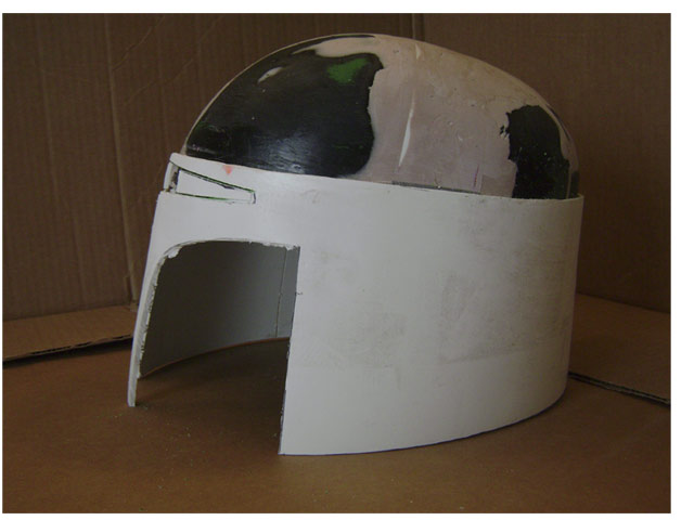

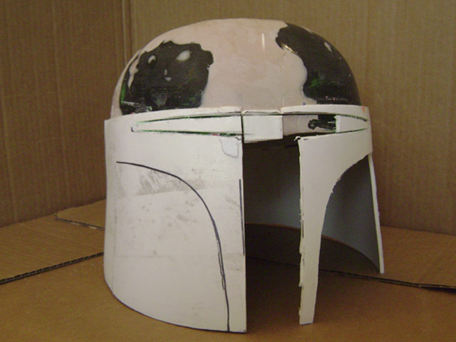

Here's the helmet as of right now. Three coats of primer, ready to sand down and bondo some details (right cheek vertical line needs to be straightened up, fill the seams in the front brow, and behind both ears)
Here's some of the detail work I put into the ear pieces.

Got some bondo work done today on my lunch hour. Trying to straighten up that right cheek line so it doesn't curve toward the ear pieces quite so much. I'll probably finish sanding and put one more layer on. The left cheek is very roughly sanded, I'm hoping to finish that one tonight.
I'm still going to put a light coat of bondo on the entire surface, just to fill in the little flat spots and pits where there were air pockets in the fiberglass. Probably end up doing that tomorrow on lunch... it's too cold outside to do it when I get home from work, and I don't want to stink up the house and **** off my wife. :-P
I still have to build up that curved flat spot where the RF earpiece mounts to. I'm experimenting with a way to do that, probably going to build a form made of the same plastic (similar to building a wooden form and filling it with concrete) and fill it with bondo, then sand it smooth and level. I might do the same thing on the left for the long ear piece, just not so pronounced. I'd like the entire brow line to be thicker than the 1mm plastic, so I might try something similar for that... or I might end up just laying down a layer of bondo, and dremeling it.
