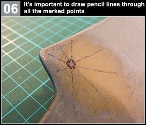

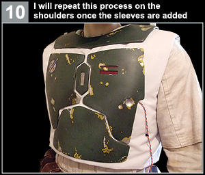

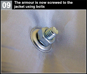

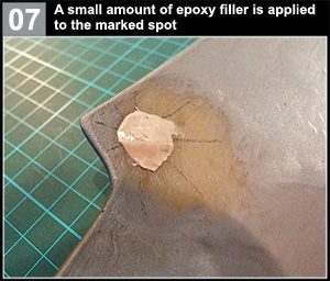

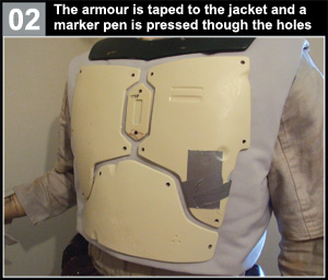

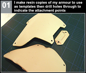

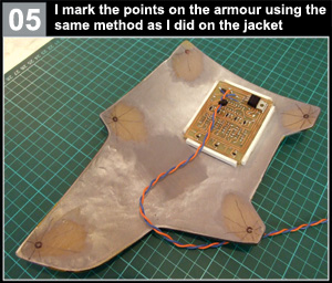

Just finished attaching my chest armour to the vest. i used steel eyelets, as can be seen on the ILM props. i bought the eyelets from a 'Hobbycraft' store, they are very easy to attach, everything is included in the pack except a hammer.
You can trace around your own armour onto cardboard for a template, but make sure that you keep the same curvature or the holes in your jacket won't line up with the bolts on your armour when finished.
Just a note: If you wish to troop in your armour you will need to cut off any excess bolt when finished (a dremel will do the job), get the bolt as short as possible so it won't dig into you.

Got a question for people trooping in the armor. After walking around and putting the armor on and off for multiple events, there may be chance one of the bolts may come loose. Would you recommend using a thread-locker (like medium strength lock-tight) to prevent this from happening?

Using a dab of hot glue on the end would keep it fastened and provide a little cushion from the bolt head.
Or, you could use a cap nut. It screws on, and has a rounded head. No mess, and it doesn't dig into you. Drop of Loctite Threadlocker, and you're good to go! ;)

Try these, they're called "locking end caps" or "star washers" these will be perfect :) These won't come off whilst trooping.

That's cool... I more or less did the same with the grommets on my ESB Boba. What I like is I can get the vest really tight up against the back of the armour, no gap like I had with snaps or velcro
