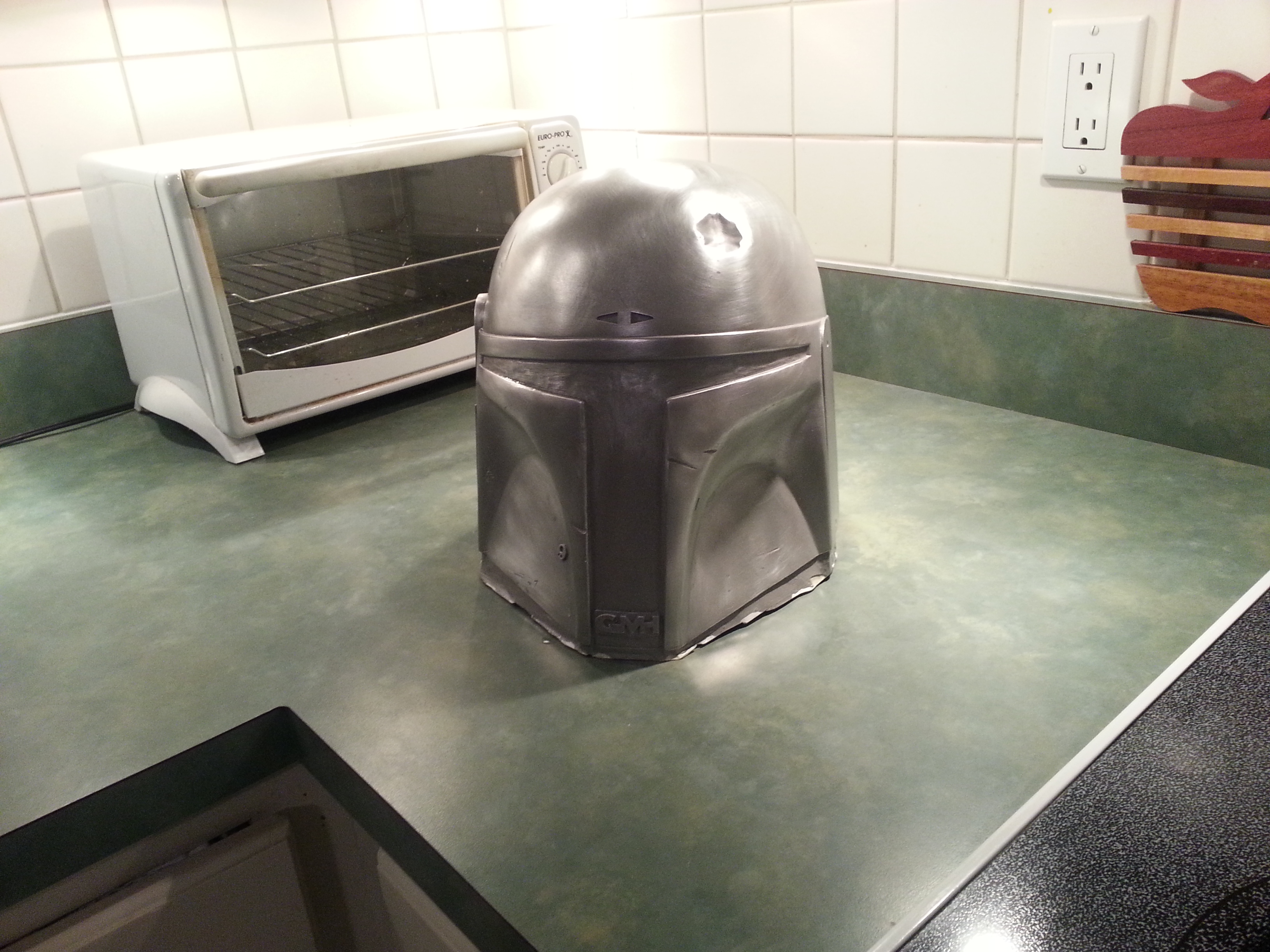

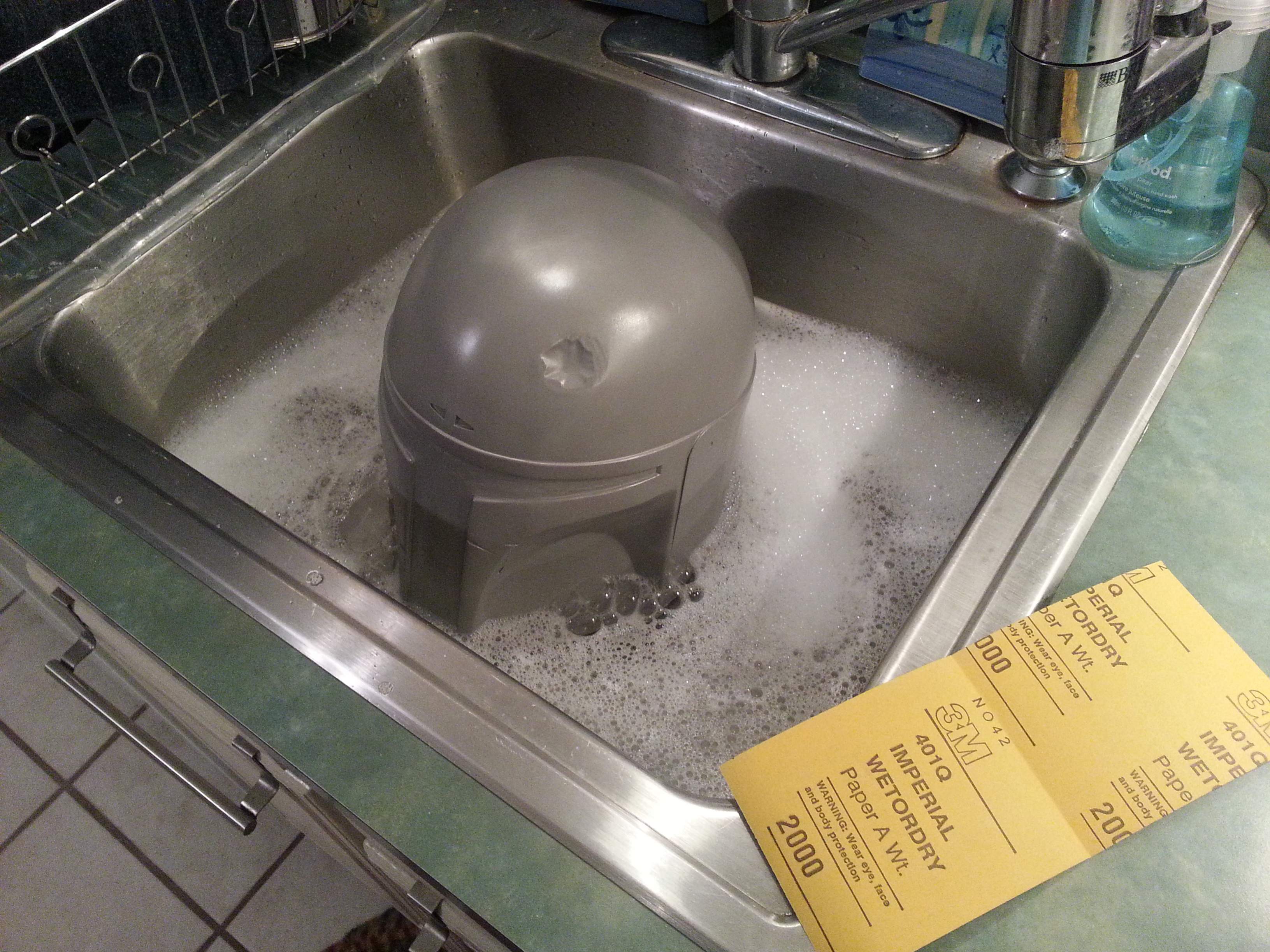

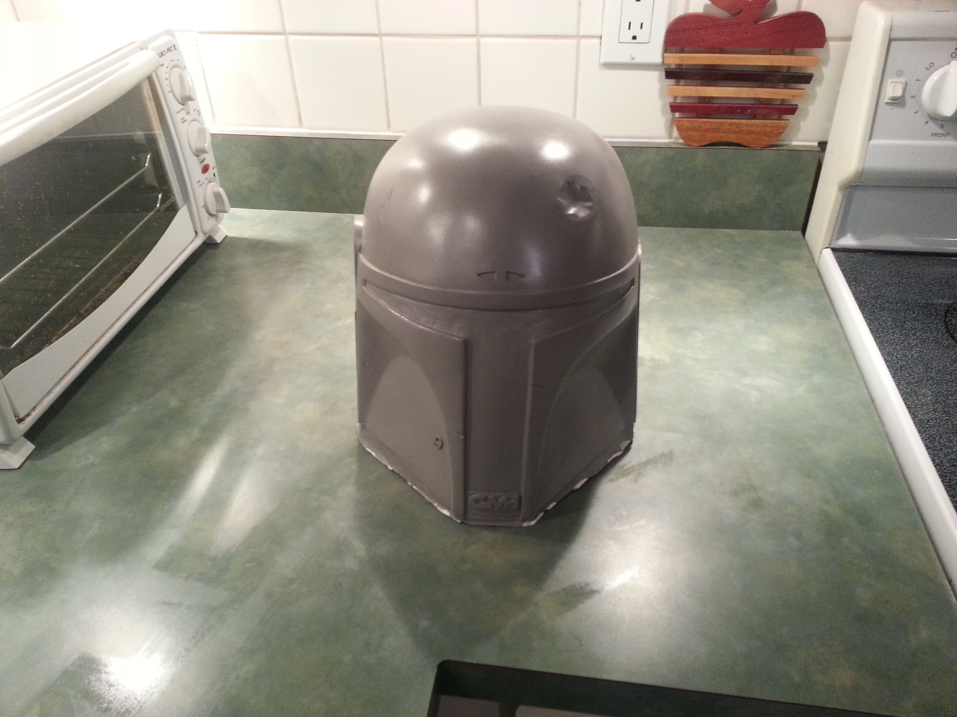

Starting my ASOK lid by washing the release and buffing it. Just thought I'd post some pics of me doing this. I washed the lid down and used some 2000 grit automotive sandpaper to start, it wasn't taking the agent completely off so I switched to the steel wool. It did well taking it off, but I have some swirl marks from the wool I used so I'm going to purchase some 0000 steel wool tomorrow and try to buff it up. Here's before and after photos! Any one who has used this, dry or wet is best? Thanks.

Bought the rihht steel wool, some 000 & 0000 grade. Before I dive in later today, can I potentially ruin the "metal" finish look by doing too much with the wool amd water? Should I be cautious? I basically want to use the cold cast layer for the silver damage spots. Or would people recommend against this?
personally it depends on how shiny you want it, I used a really course wire wool then used super fine, I didn't use any water, then polished with Mothers Mag and aluminum polish, but that really makes it shiny, you want it a bit dulled down but when u mask the area u want metal when u remove it it will take some of the shine away
