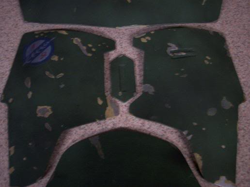

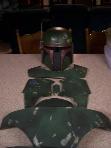

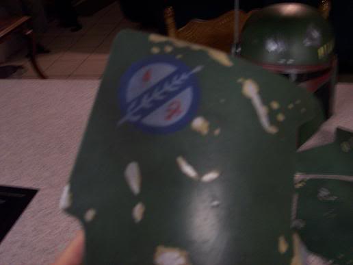

Haha, I think it's funny you guys are gonig out to buy junk to weather your armour with. I used mustard on mine. Yes, mustard, straight from my refrigerator. I first painted my armor silver, then I put mustard on the parts I wanted to keep silver, then I painted on the yellow. LET IT DRY BEFORE YOU PUT ON A SECOND COAT. Then let this coat dry! Then you run it under the sink and use your fingers or so to rub off where the mustard was, and magically you can see the silver!
Then I put more mustard on, so you can see the silver and a little bit of yellow, then I spraypainted the armour with Spruce Green, let it paint and then remove the paint in the sink.
After this I put on the decals, I went to Office Max and bought some adhesive paper, printed the decals and placed them on my armour, then gave it a soft mist of flat black paint.
