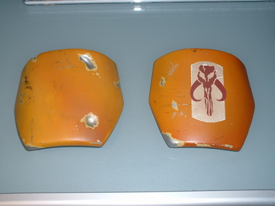

Here's the colour list i used for my armour, using masking fluid and air brushing in layers...
HUMBROL PAINT LIST
Shoulders/knees
- Halfords plastic primer, Grey
- 11 Metallic silver
- 74 Light yellow (around silver damage)
- 154 Yellow
- 82 Orange (added in tiny amounts to the yellow and over sprayed)
- 132 Orange/ red (added in tiny amounts to the yellow/orange and oversprayed)
- 79 Grey (added to the orange orange/ red to darken for weathered effect)
Chest/ back and cod
- Halfords primer
- 99 yellow (around silver scratches)
- 78 green (for small areas of damage all over armour)
- 76 green
- over sprayed with grey 79 and black 33 for weathering
- Seal with satin varnish
- painted using a layering technique with Humbrol Maskol liquid.
- small damage can be scratched through to the silver base coat before sealing.
Here's how the shoulder bells turned out...
