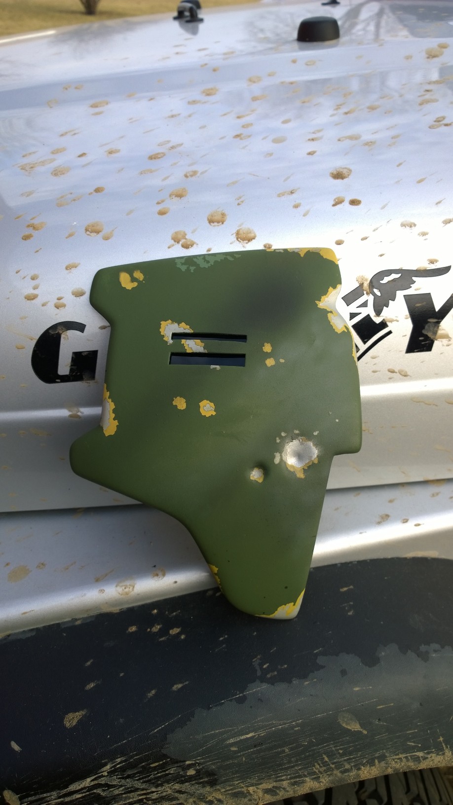

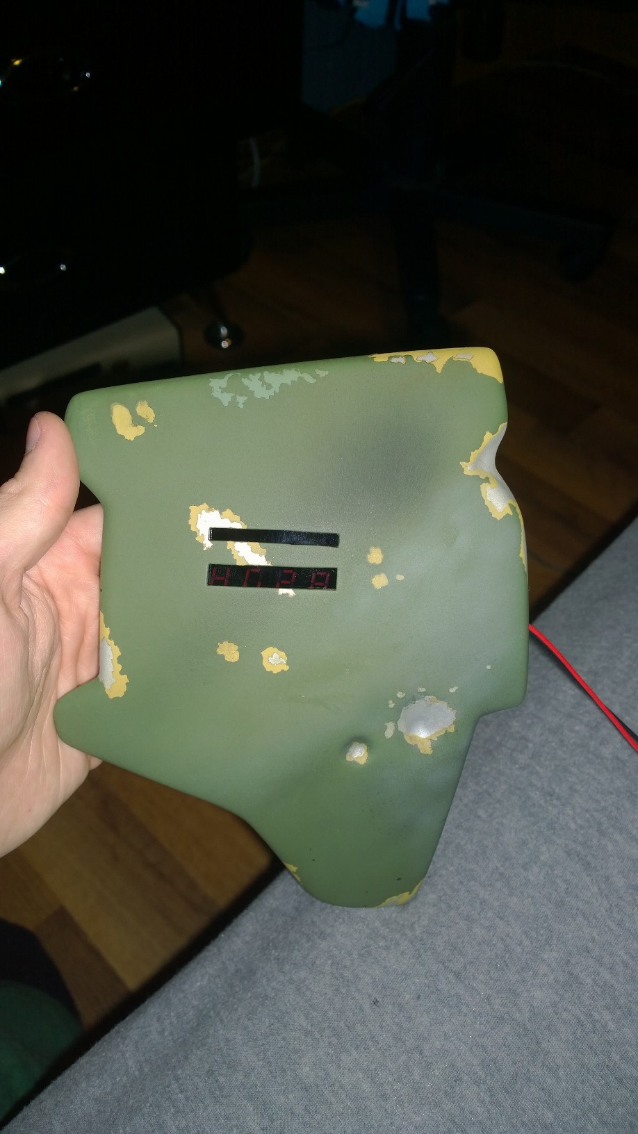

Sorry I didn't realize you had replied. Attached a couple pictures of my one chest piece (my test dummy) in some different lights. I am terrible at lighting and actually seeing how similar colors are. Let me know what you think. The last one is outdoors and looks the best to me.

Forgot to quote you. I followed your colors to a T with the exception of the clearcoat. I also used completely layered. I am currently working on my other pieces. Would anybody be interested in seeing these colors vs. AFFO$'s recommended spray paints? I have painted my armor in both now.
