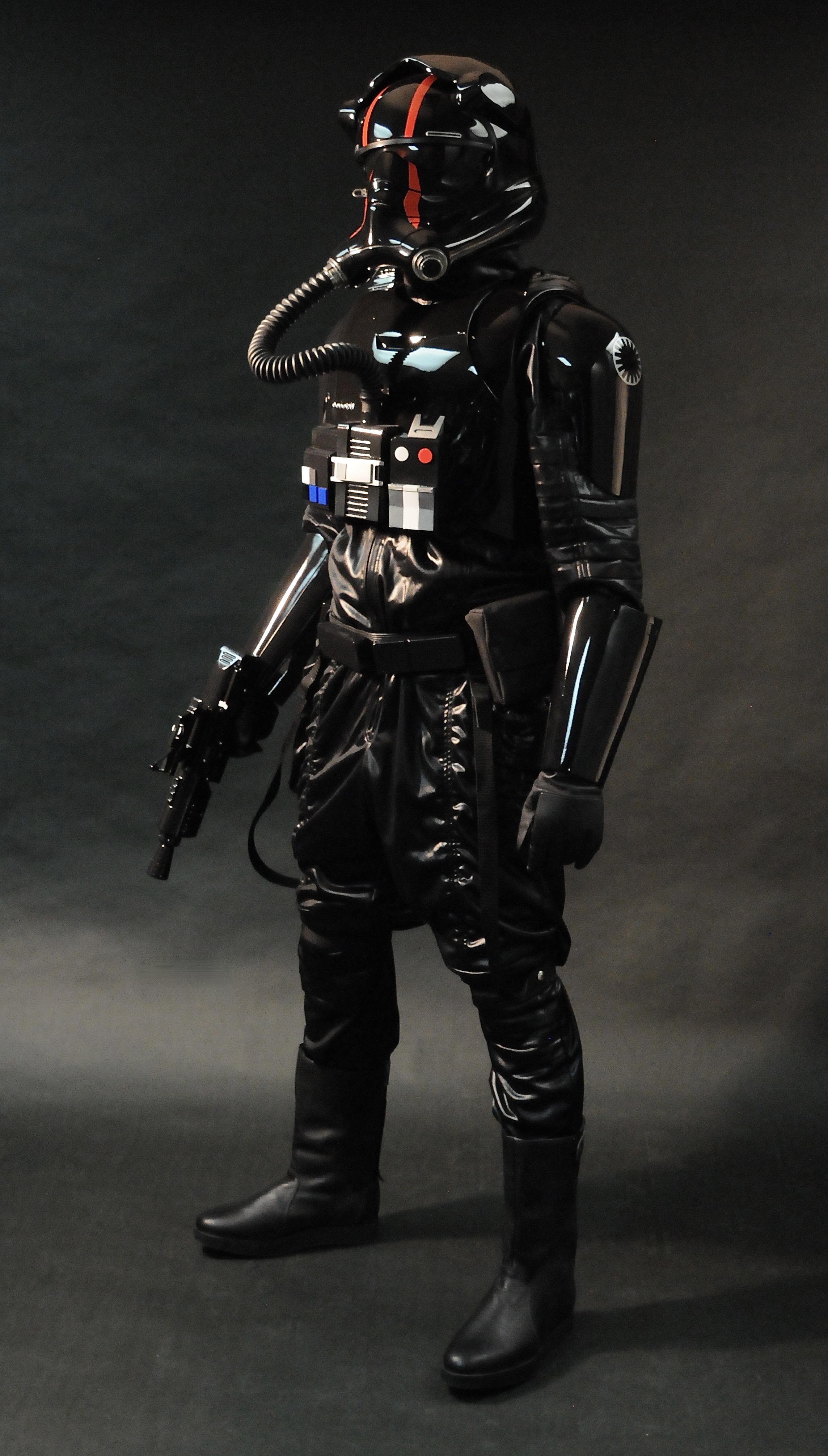

I know this will sound a little counterproductive but it was great advice from Mr. Mold Maker at RPF.
After your substrate is ready for paint spray first with Duplicolor black sandable primer ( yes flat black).
The 2K clear will adhere and turn it a beautiful gloss black. Let dry. Then add the Alumaluster at around 70% coverage
to keep a deep rich metallic look. Don't touch and let dry thoroughly. Then final 2K clear.
This worked absolutely great and I even used the first two steps to repaint a First Order Tie Pilot to a really nice
black gloss. Everything was painted with a Badger two stage airbrush. Yes you use more 2K clear this way but
the result was sure worth it.
