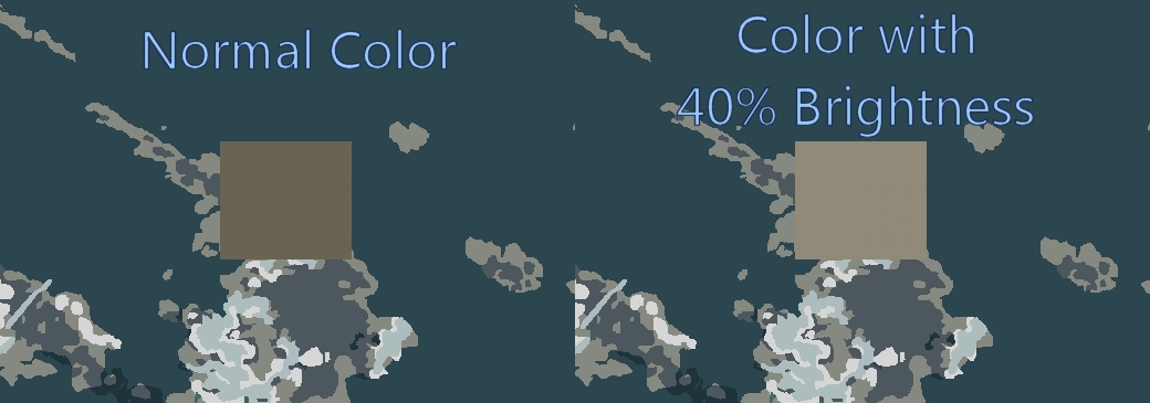

The color is somewhere in that range, but too dark. I did a test with my ESB stencil and if I increase the brightness with 40%, your color looks better:
So in theory, if you add 40% white to your paint, you might achieve that color.
Perfect! I wanted to confirm that I was on the right track. I've got plenty of paint so I will experiment with ratios until it's right. Thanks!

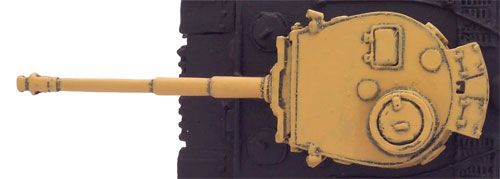

Now that the acrylic floodgates have been swung wide open i've been digging through my paints trying to match up as many colors as possible. I dug up some reaper aged bone
When dried it looks very close to the sample provided by RafalFett

The bone color may be close...but looks light on the screen at least looks closer to earth (ear color)

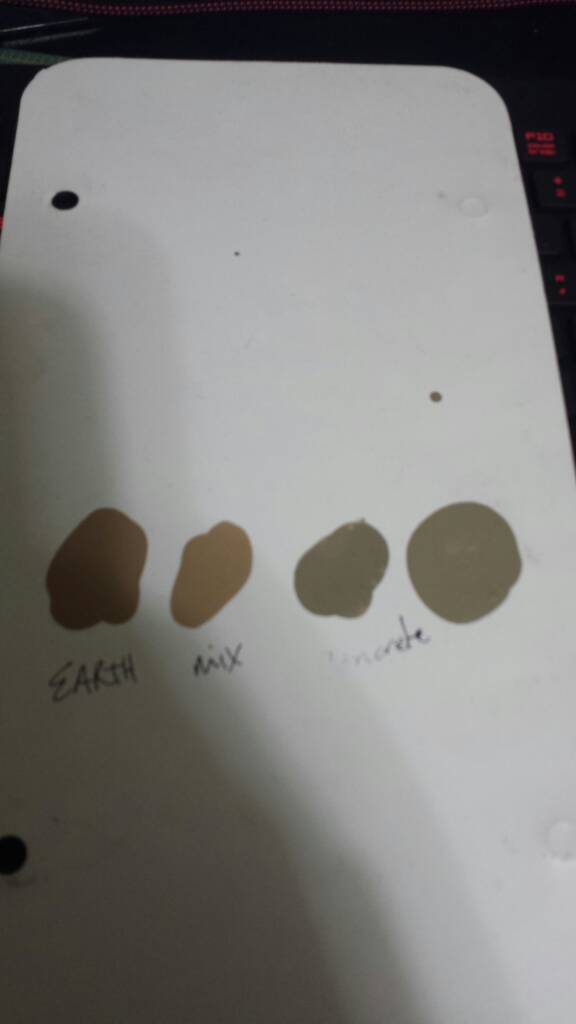

I thought the buff was to light....its very close to the earth color Lee recommends for the ear though....I have swatches I'll show next week...When testors mm concrete gets here...
