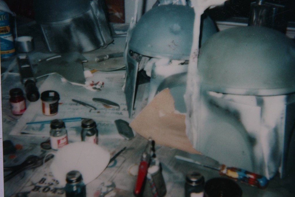

There are some shots of helmets being painted and you can see the floquil and pollyscale bottles. There is no way to be 100% sure if it was enamels or acrylics being used. But my guess is enamels as i recall seeing thinners on the table in some shots. i'll try and find some of the pics im speaking of.

Interesting to note with that pic posted above that the two relatively central jars appear certainly to be Floquil enamel RR colours that the one rear left has a label more commensurate with the Pollyscale acrylic line. Hopefully DVH can do me a massive solid and dig out some more shots like that one.
