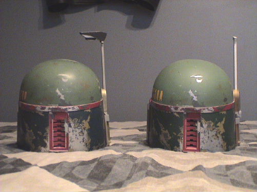

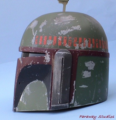

The two helmets are a MS1 and a BKBT Jango I converted to a Boba. The picture is an optical illusion. From the angle I took it at, the BKBT helmet looks alot bigger because of its placement. The MS1 helmet is actually slightly taller, while the BKBT is bigger in diameter giving it a little more flared appearance. The thing I fell in love with about the BKBT helmet was the 'squintiness' of the visor. I know it's not screen accurate, but its a One of a Kind helmet and it's soooo Clint Eastwood. Here's a pic of the two helmets from a better angle, MS helmet on the left, BKBT on the right.
superjedi
Sr Hunter
Cool comparison pics!
Is the vertical part of the visor skinnier on the BKBT helmet as well? It looks that way. (Don't know too much about Jango helms)

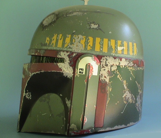

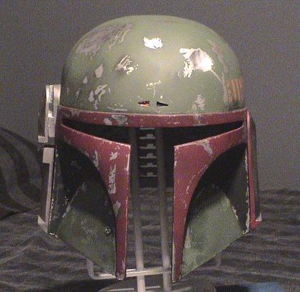

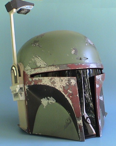

Yes, I have. I will amend the list at the top to include the ROTJ Colors also. Here's an example of the one I have painted.
Rat Fett
Excellent, thanks much!
Now off to the shops!
BTW, would love to also see front and rear shots of the RoTJ helmet.
AFettFullofDollars

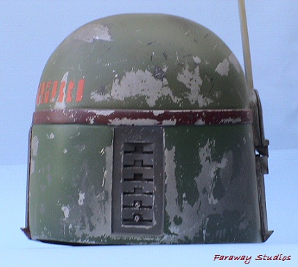

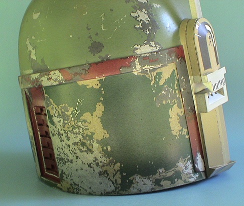

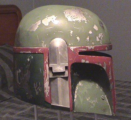

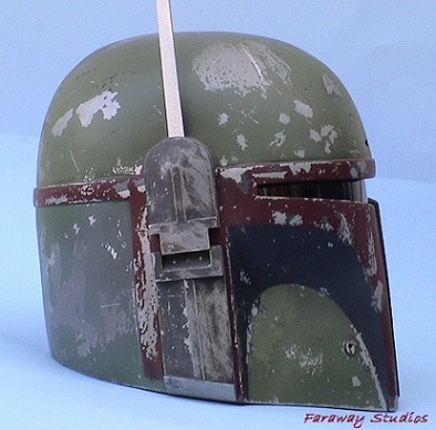

Here ya' go.;)
By the way, the color on the back of the helmet in the pics is NOT 'Kelly Green'. I found the Kelly Green color after I had painted this helmet and I feel that it (Kelly Green) is a more accurate representation of the color on the back of the film used helmet.
Thanks,
Paul
