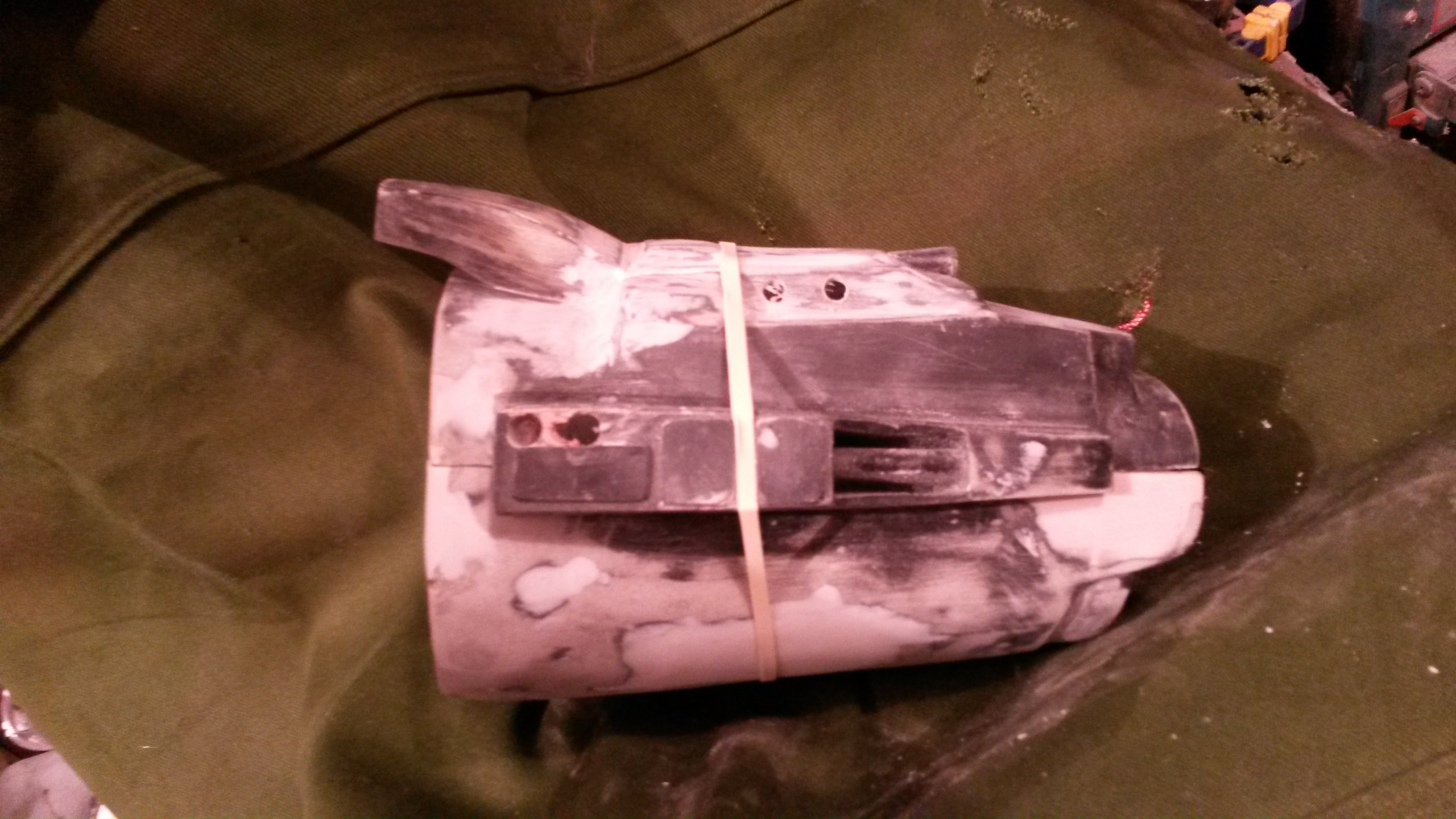

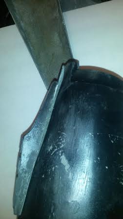

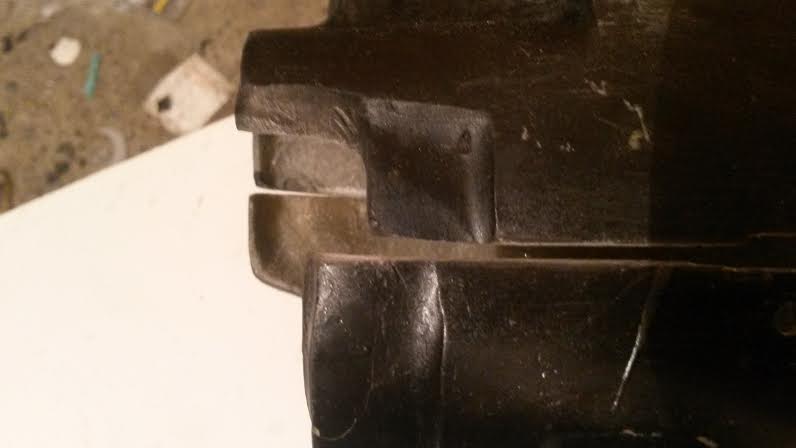

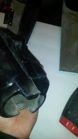

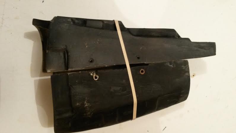

These pieces had been "prepped"... Well, here's a pic of the left gauntlet from the back. Keep in mind this is already hinged.
...and the right... The first 3 are before I heated the fiberglass and reformed it. You can still see the absurd amount of disproportion.
So, after cutting off the hinges, reforming them back into a relatively close shape... we get this.
Still uneven, notice the back edges and front grooves. These were lined up "even" on the opposite sides. Still, the seams where the hinges will eventually go are wobbly at best.

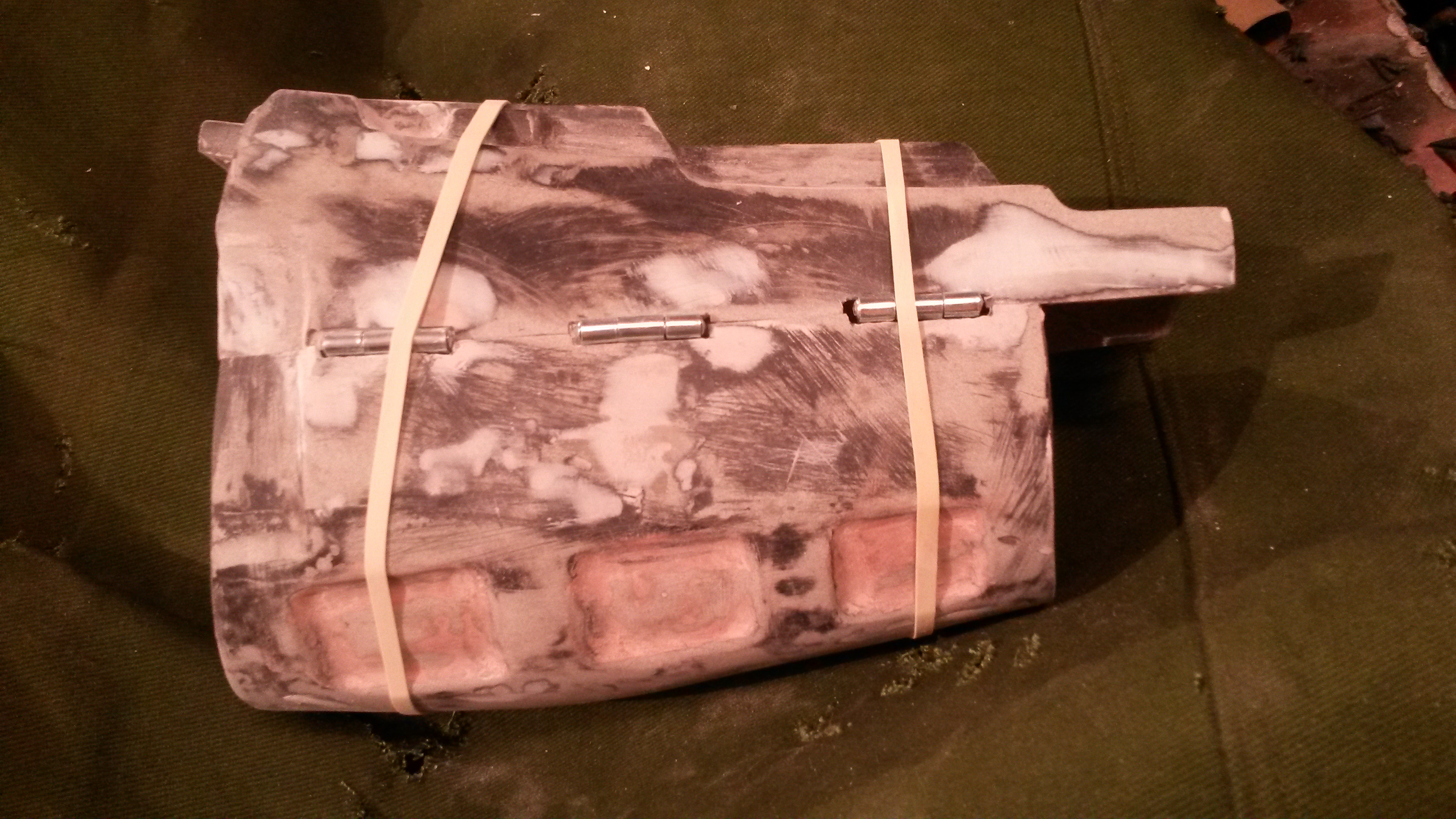

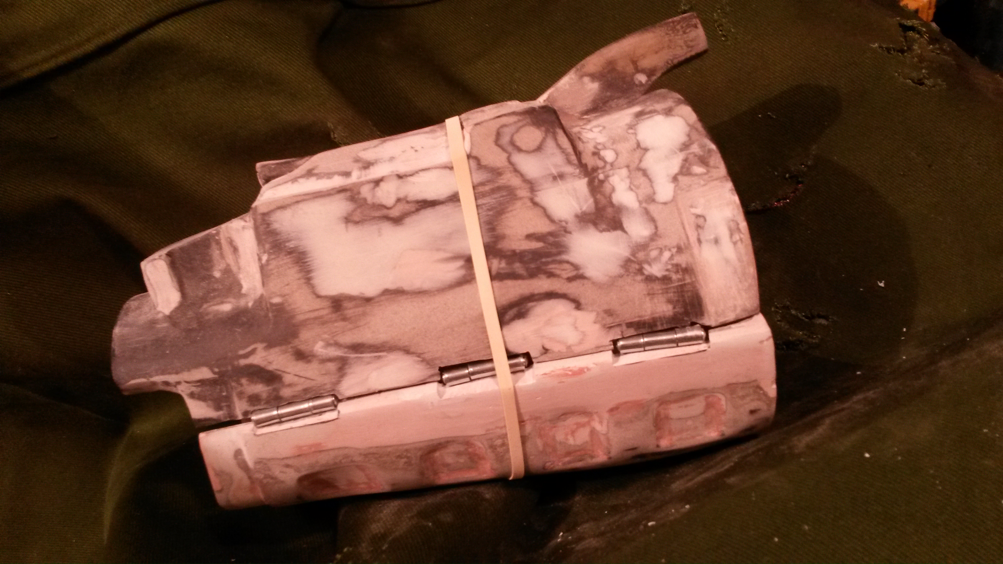

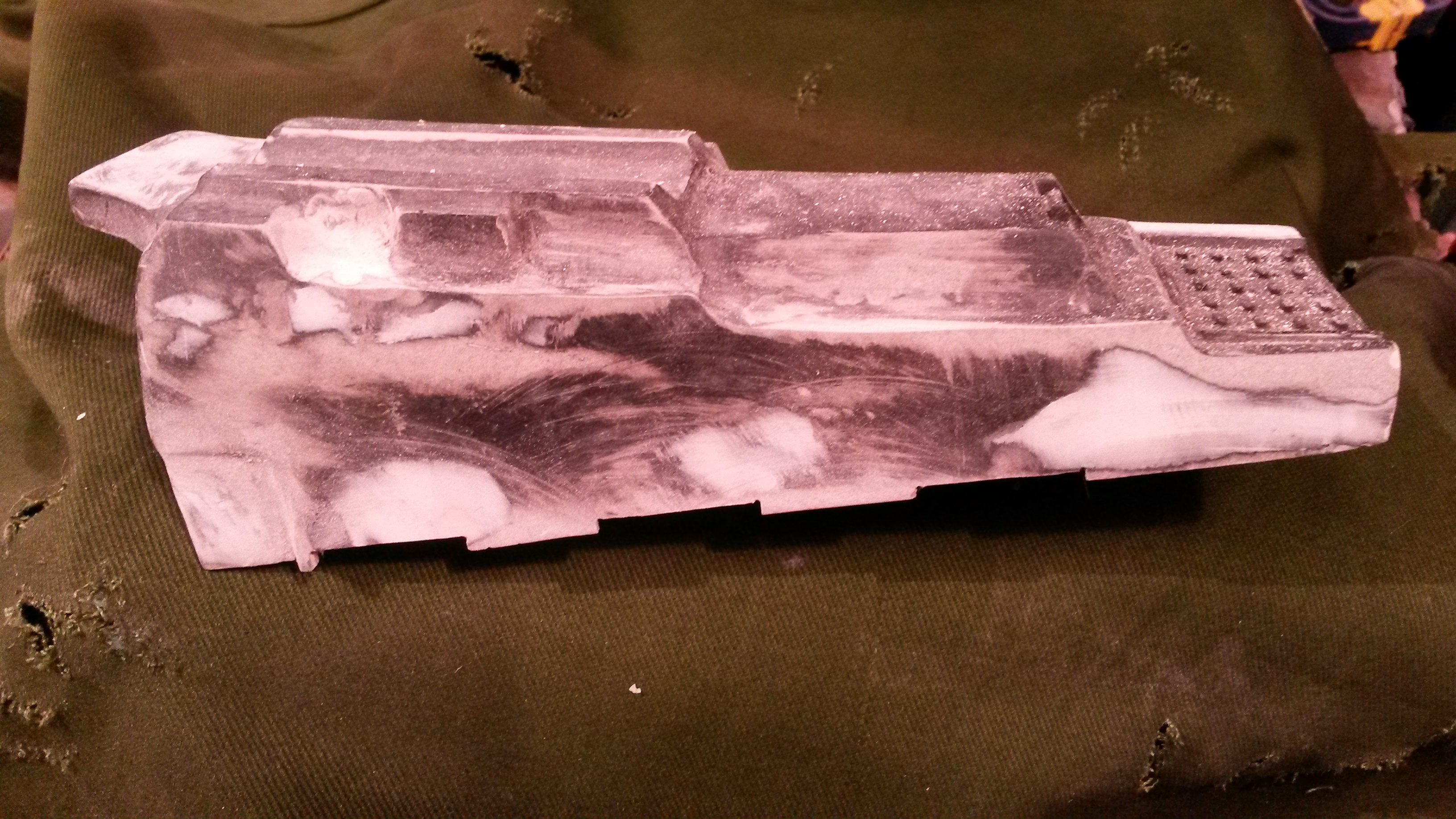

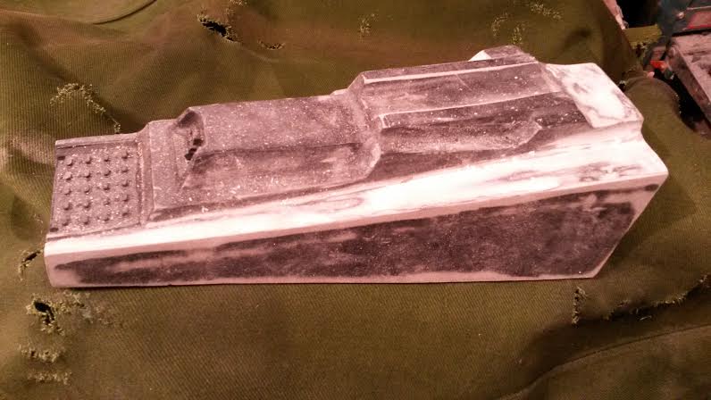

Too many layers of filling and sanding... and filling... and sanding.... and shaping... and cutting... and adding... and sanding... and filling... and shaping... and cutting... and making new sides that line up.... and adding edges that line up.... and sanding... and filling... and sanding... Do you get the point? The "prep work" consisted of gouging the pieces with something along the lines of a grinding wheel, and spraying a semigloss black on them pieces.
These are some pics I took toward the end of the work before paint.

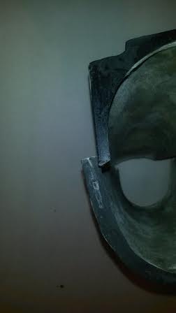

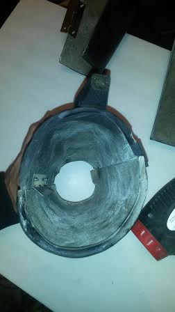

I thought independently hinging may be a good idea considering the wobbly nature inside. That didn't work. The hinges bound up and were fighting themselves. Every inch of these pieces needed work. the backsides were angle cut to fit, the grooves were cut/sanded into the pieces (having to add filler to the inside as not to sand through the piece). You get the point...

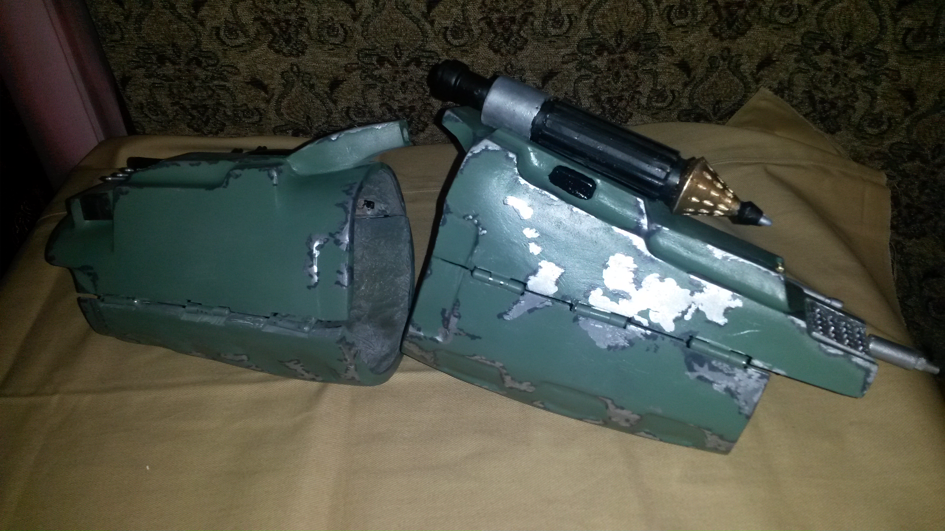

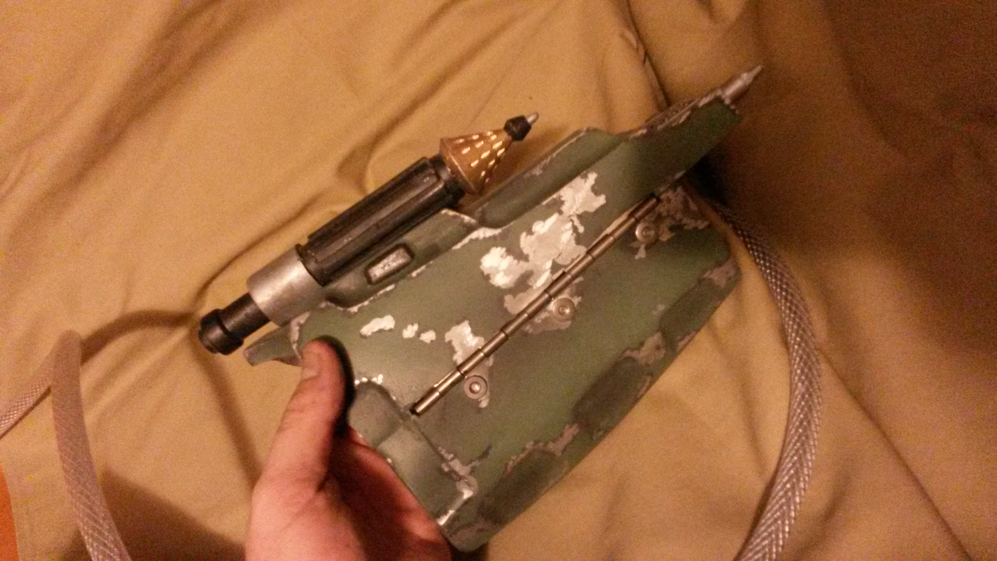

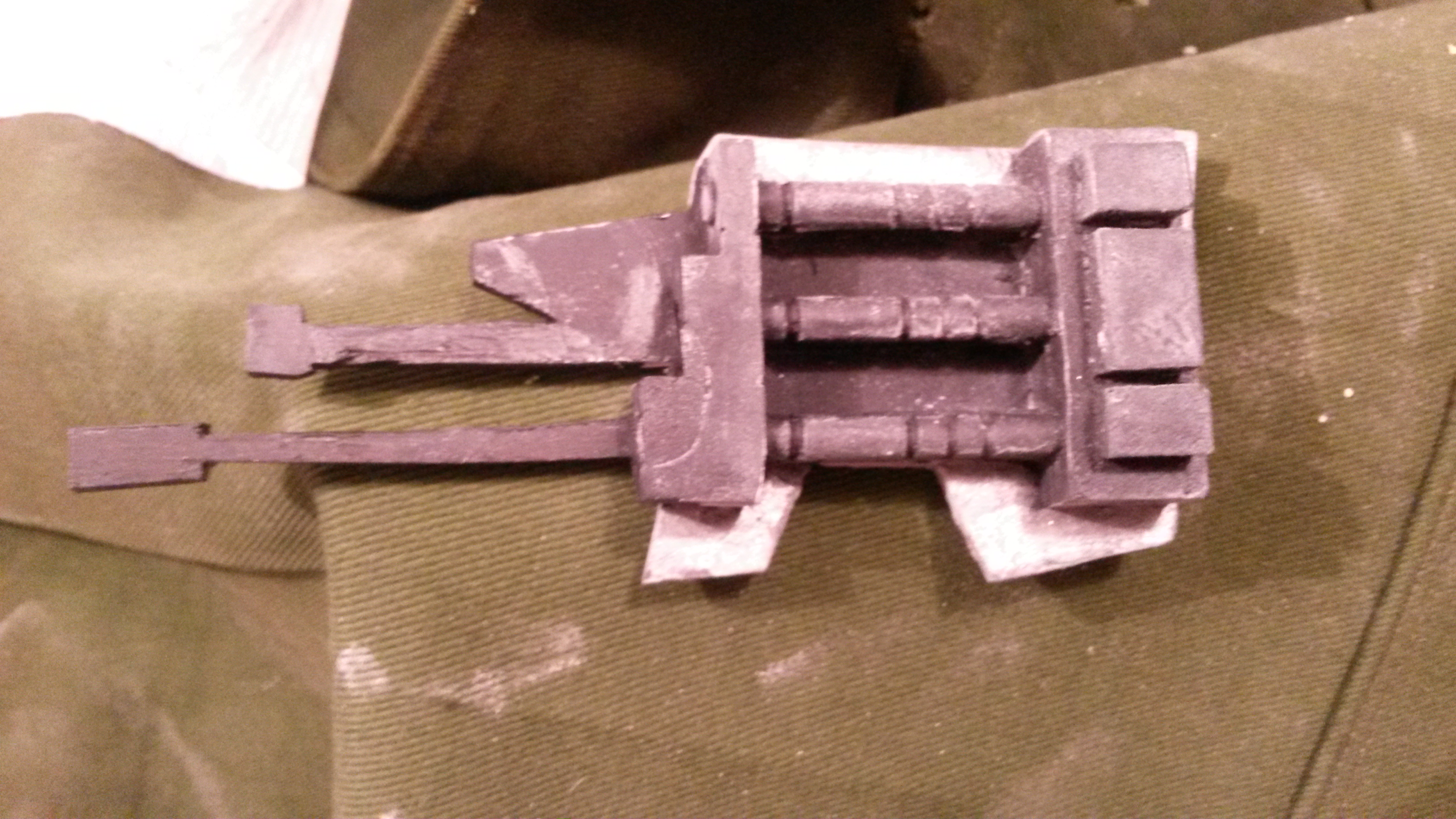

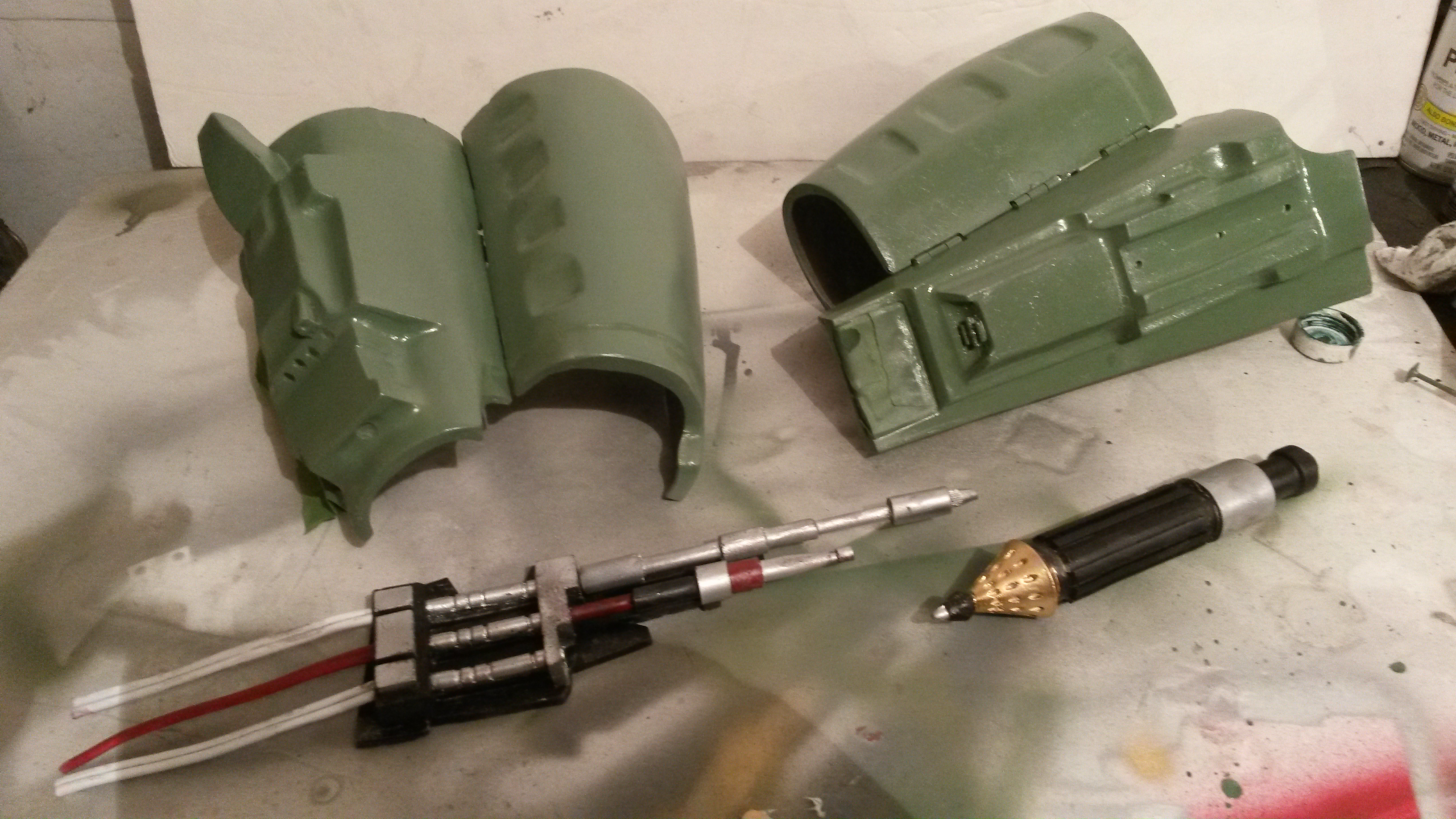

With the prep work "done", I sprayed my primer. Then backtracked and resanded and filled, and sanded some more. Content with the work. The metallic coat went on, the liquid mask, and the RLM 62 Grun applied. Also, the flamethrower and missile that were supplied. Still independently hinged, I hadn't yet revisited that monster...

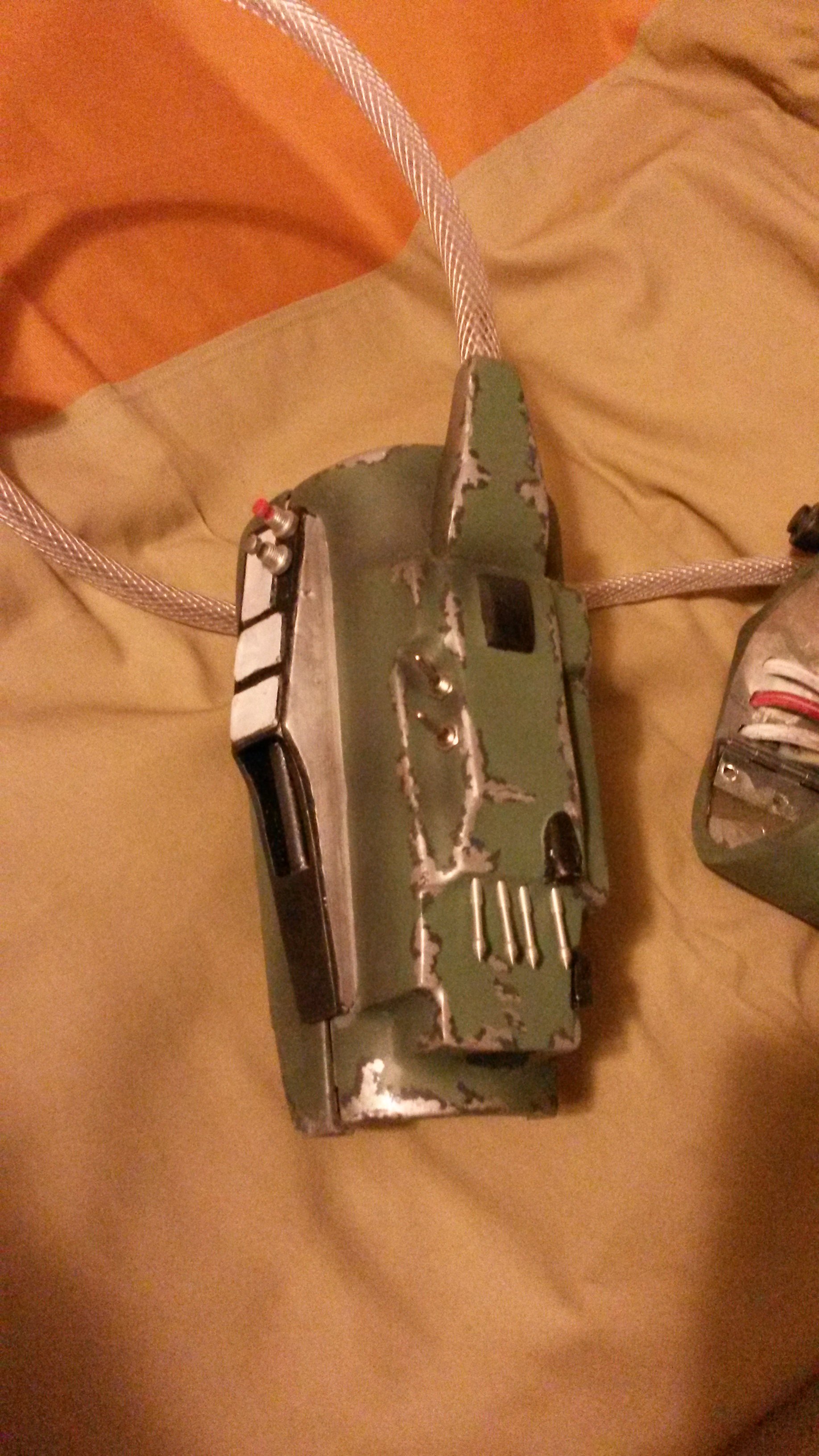

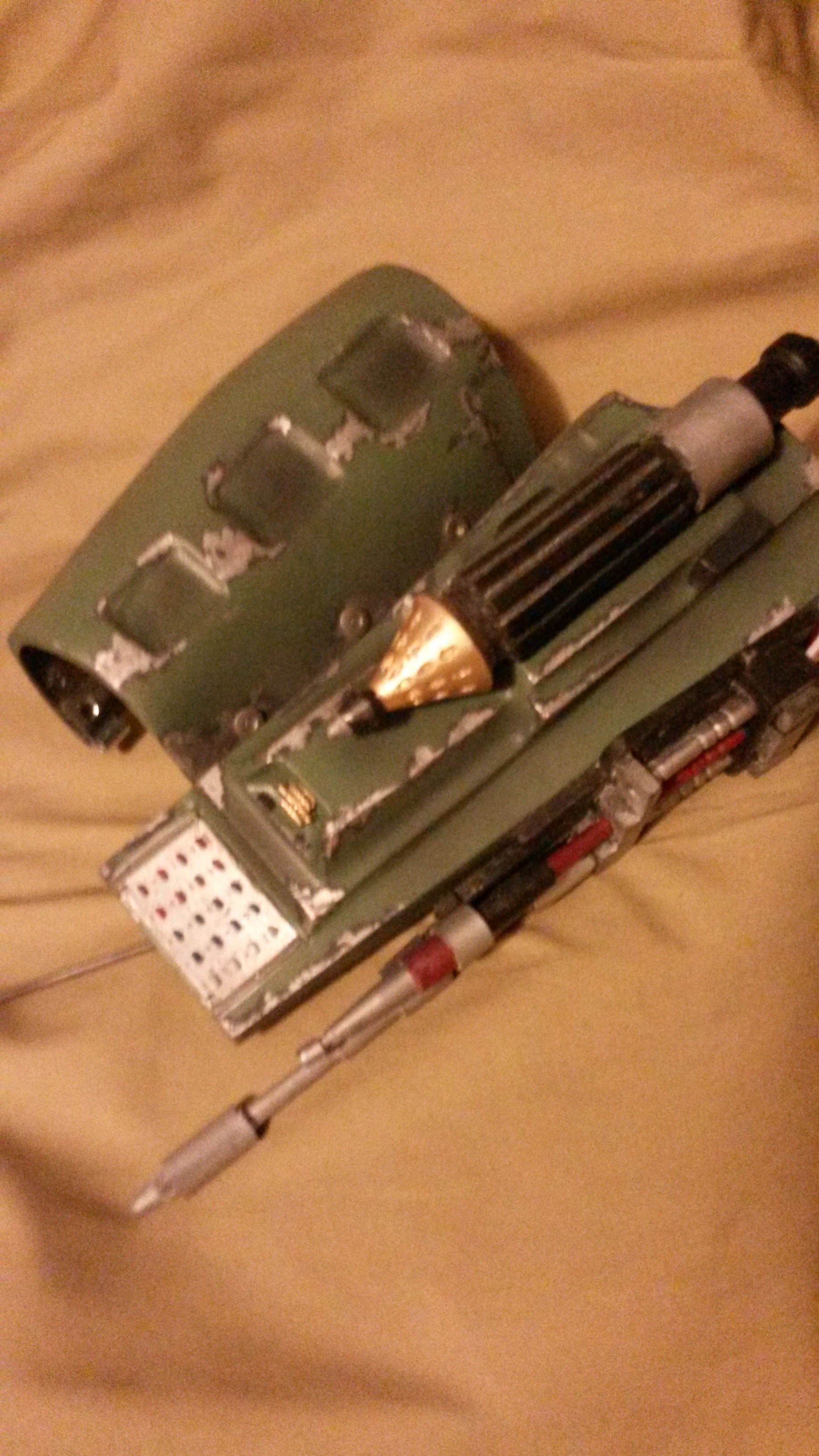

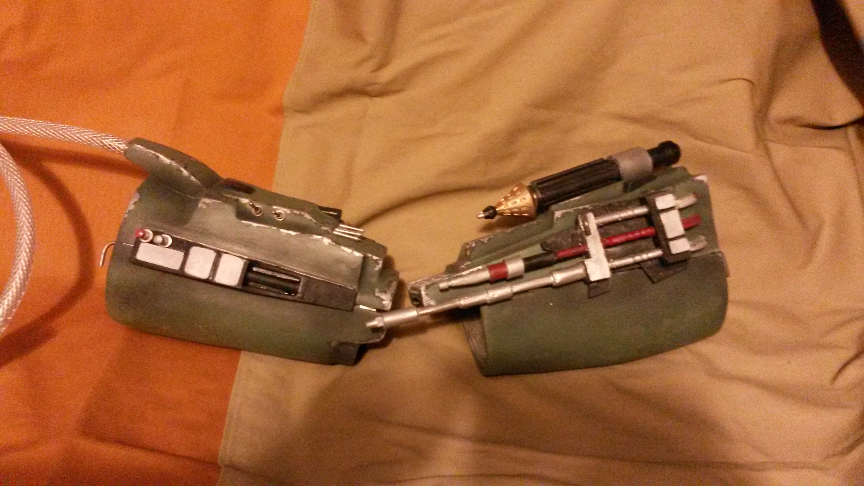

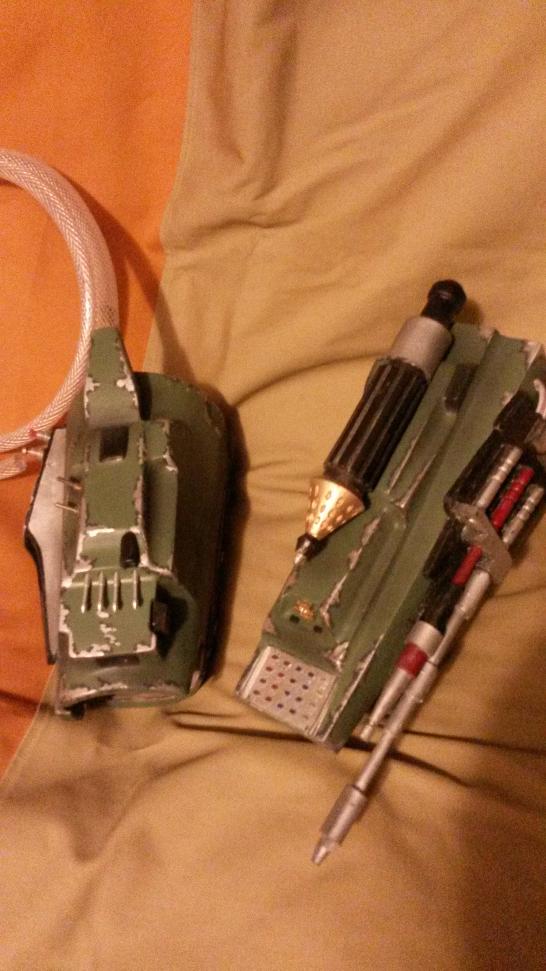

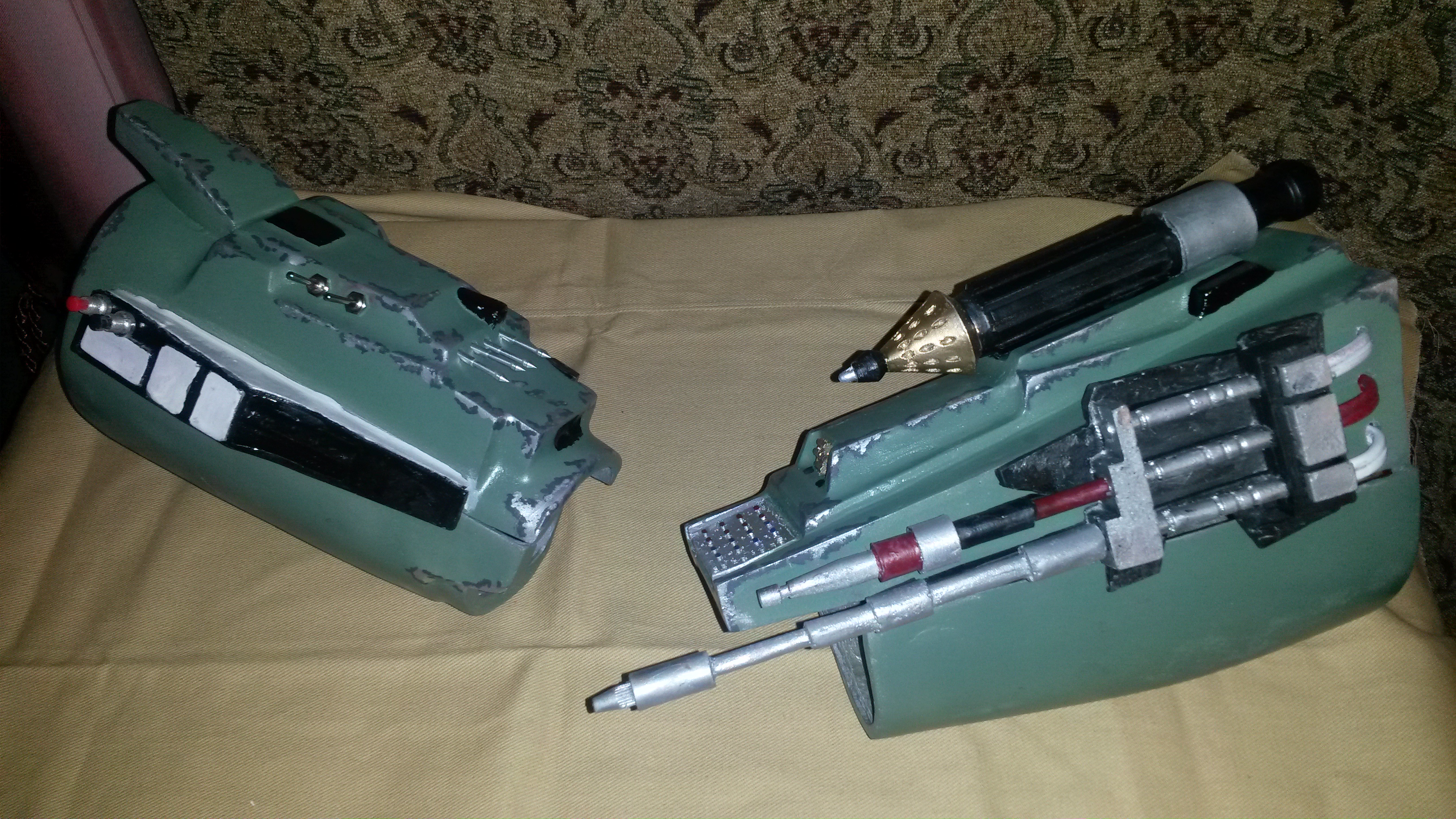

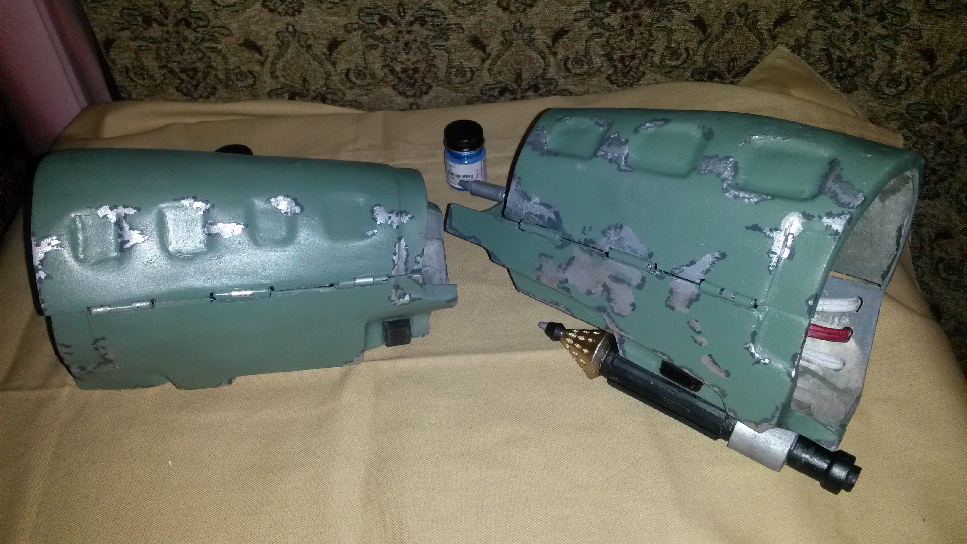

Pics after the initial paintup, masking removal, topical lark dark gray, and some assembly.

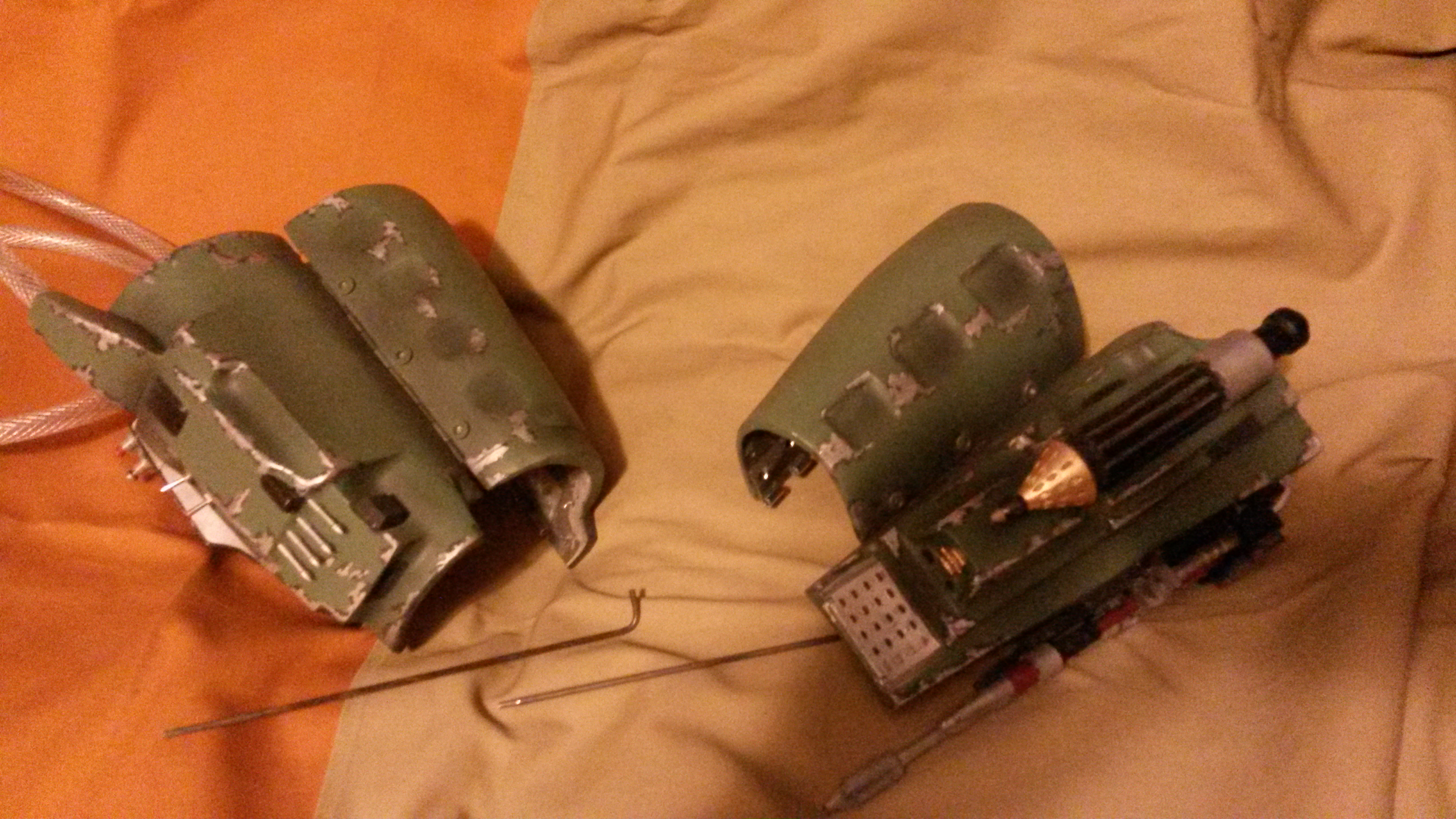

Attached the hose with a brass fitting, rehanged with piano hinges, and installed pin closures. Magnets, wouldn't hold these closed. They wanted to keep falling back to their original shape.
20141217_051050.jpg20141217_051133.jpg20141217_051225.jpg20141217_051658.jpg20141217_051715.jpg20141217_051846.jpg20141217_051817.jpg
The piano hinges had to be Chicago screwed in, they wouldn't sit inside the gaunts due to the wobbly nature.
