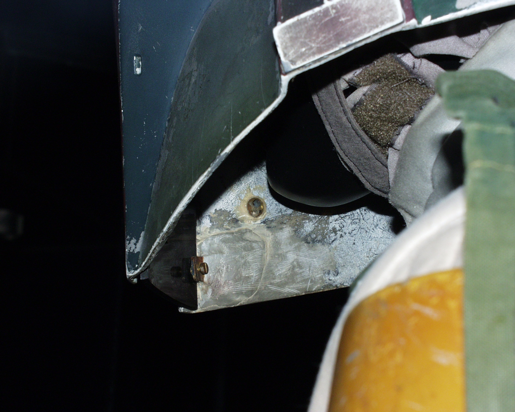

Lower clips:

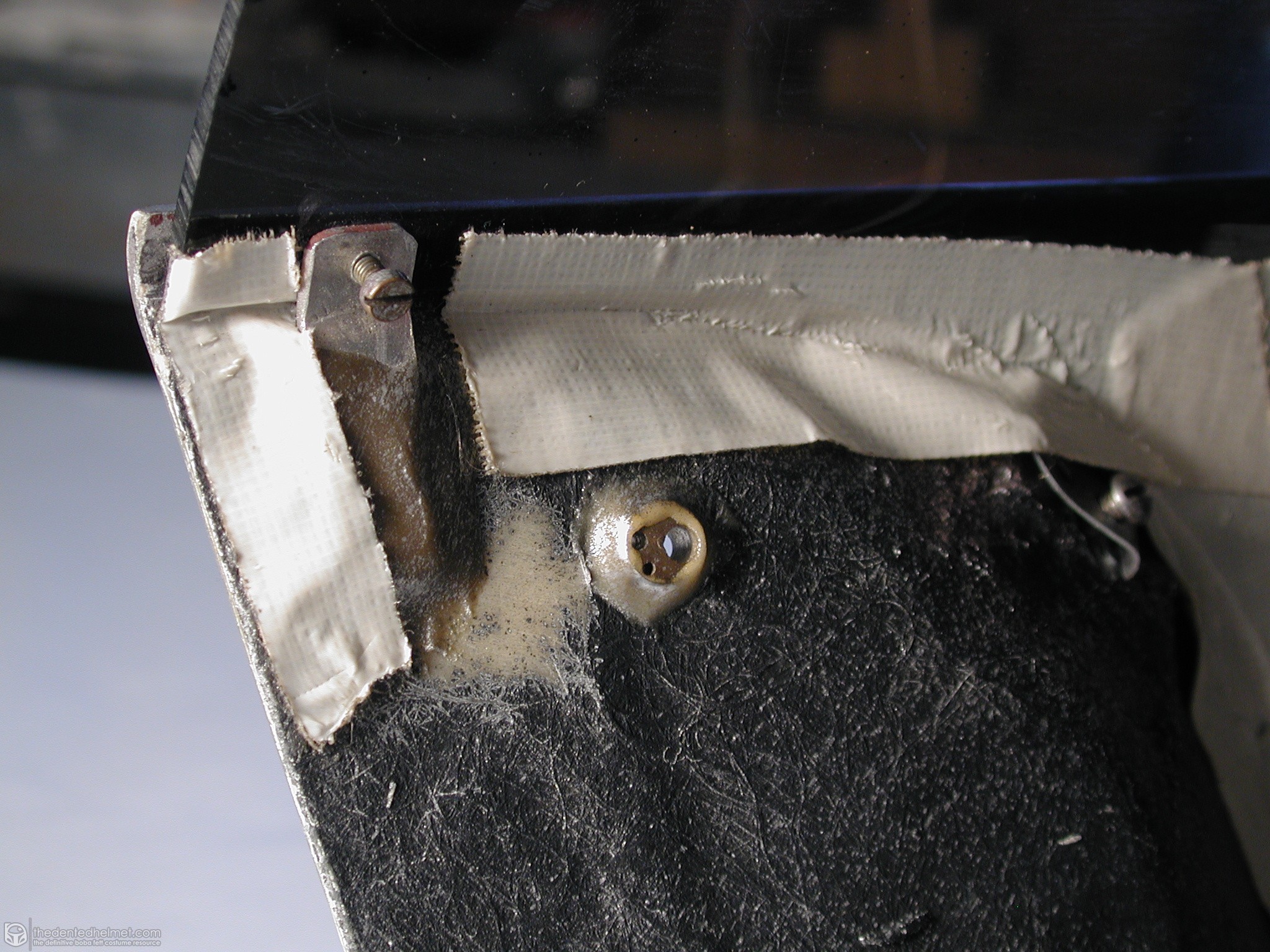

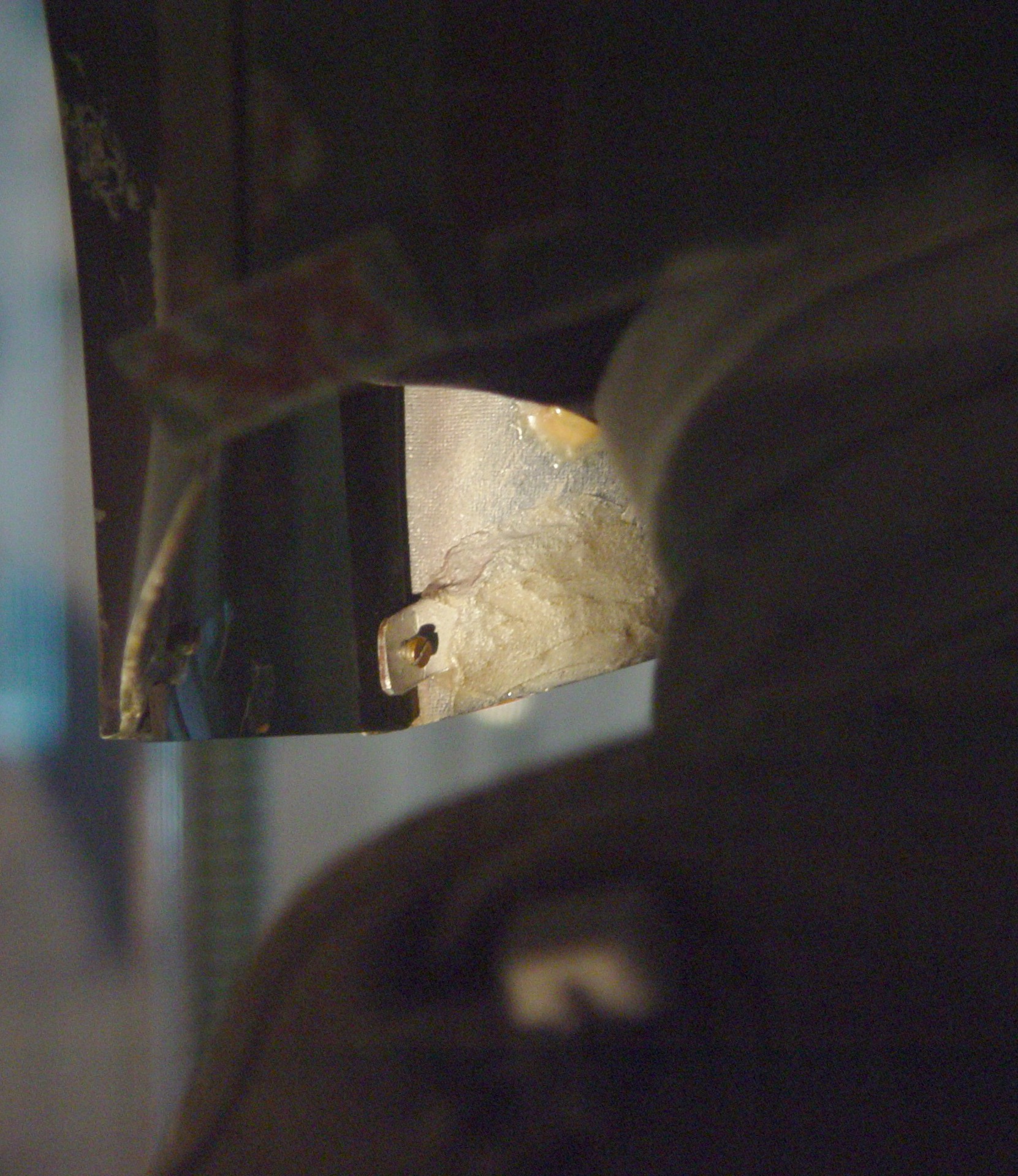

Upper (and lower) clips:

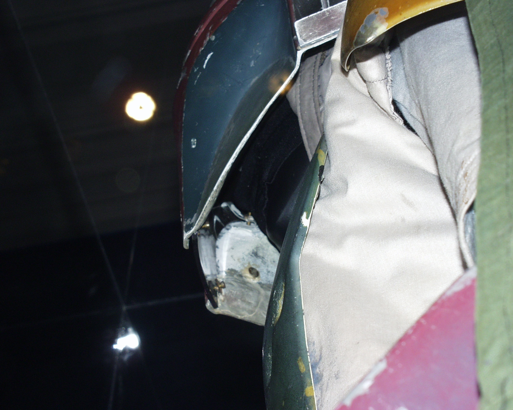

WOW Thank you!! So are we sure that visor was 2mm not like 4mm? It appears to be a bit thicker...Also it looks like there were 4 main clips holding it in with epoxy putty and by screw tension, was there anything that filled in the gaps around the visor on the inside?
Definitely 2mm on the ESB helmet. If done right, you need only those 4 clips. But in time some of the original helmets were padded with tape around the visor to maybe better secure them (the last image I posted above is one example).

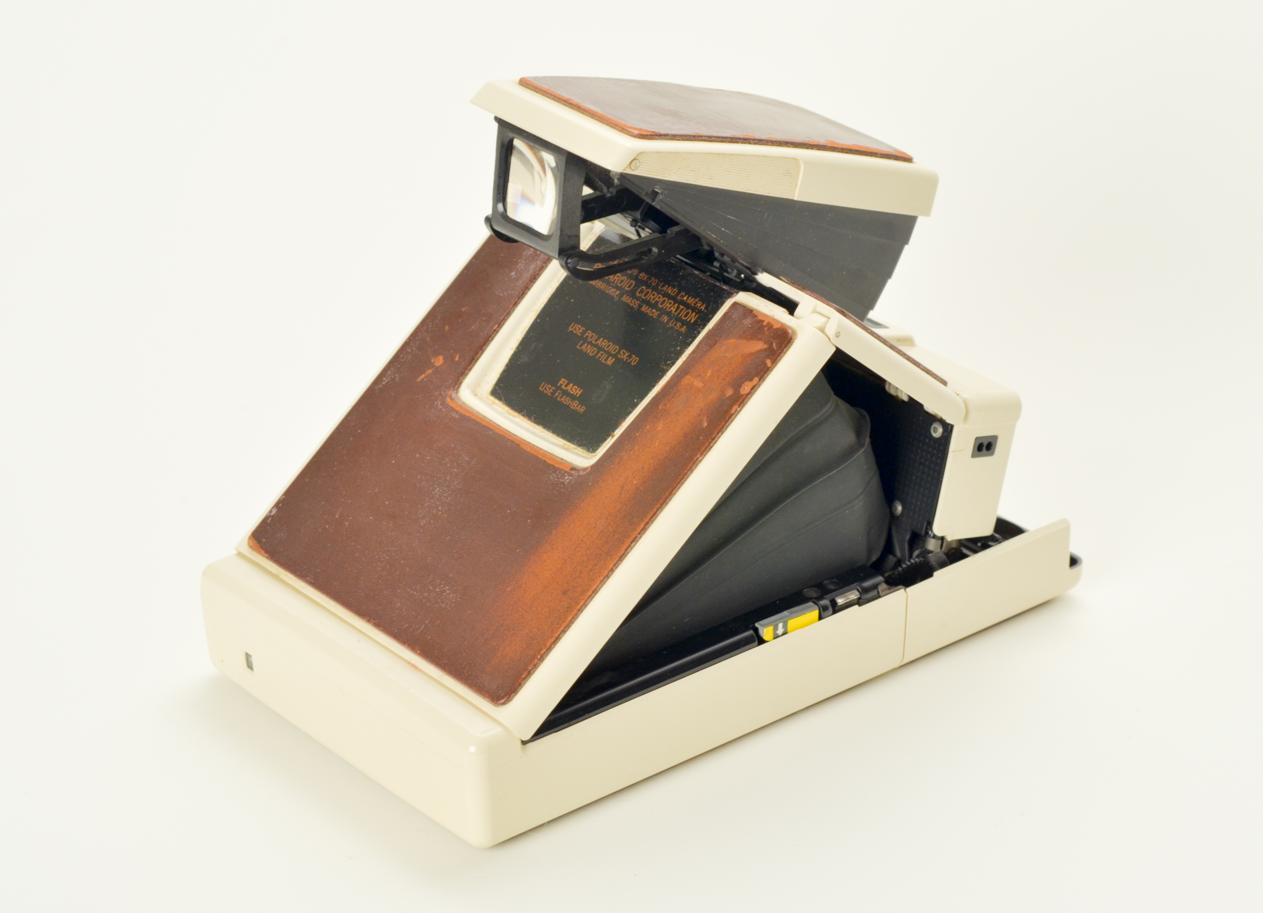

I found a decent price on a Polaroid SX-70 model 2. It appears to have the same lens as the first model. Can anyone confirm this? Here’s a model 2 for reference
