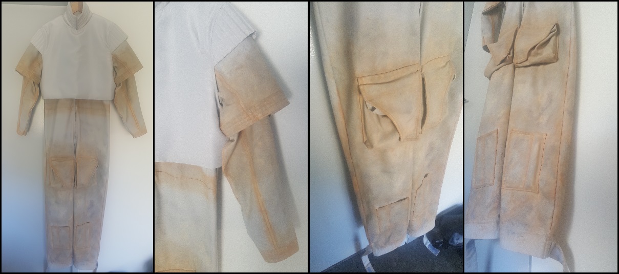

The suit is much darker in person but the lighting in the photo was a very bright white, which makes the suit seem lighter than it is. Now onto the weathering. Below are the key reference photos I used to guide the weathering process.
I approached the weathering with a layered methodology.
Firstly I added black shoe polish brush to add oil and soot stains that Boba would have built up from use on Slave 1. The marks are very subtle but were key in adding depth as the weathering process continued.
Secondly I applied Brasso around seems to replicate a build up of dust and sand. Brasso, when dry, turns to a powdery compound which allowed me to rub it in to the seams and gives a more realistic feel to the weathering.

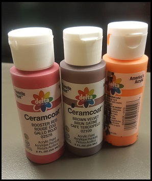

Thirdly I used mix of acrylic paint to match the colour of the desert sand/mud and applied it to the seams, placing it on top of the Brasso. I have a craft store down the road from me and lo and behold they had Delta Ceramcoat paints! I used Pumpkin Orange, Rooster Red and Chocolate Brown to create the right colour.
After that dried I hit the seams and raised areas with 280 sandpaper to add some physical weathering. I tried not to go over the top but there were some parts that I wore down some stitching – nothing to worry about thought.
I did a second pass of the desert sand/mud colour but this time I watered the paint down even further to give me more control over the saturation in some areas. Watering the paint down also lightened the colour, adding to the spectrum of muddy red/brown colours, which in turn helped to make the weathering more authentic.
After starring at the suit in its current state for a day I decided to tone everything down by brushing over a dark grey (slightly darker than the flight suit’s dyed colour). In my opinion it tied everything together and gave it a truly worn look.
Finally I needed to add the dark ‘low lights’ to the lower half of the flight suit. I stayed away from using straight up black acrylic and decided to use a mix of grey and purple. The colour was a little light to start off with so I added a touch of black to bring the tone down to the appropriate level – it only took two small drops to achieve the tone I needed.
